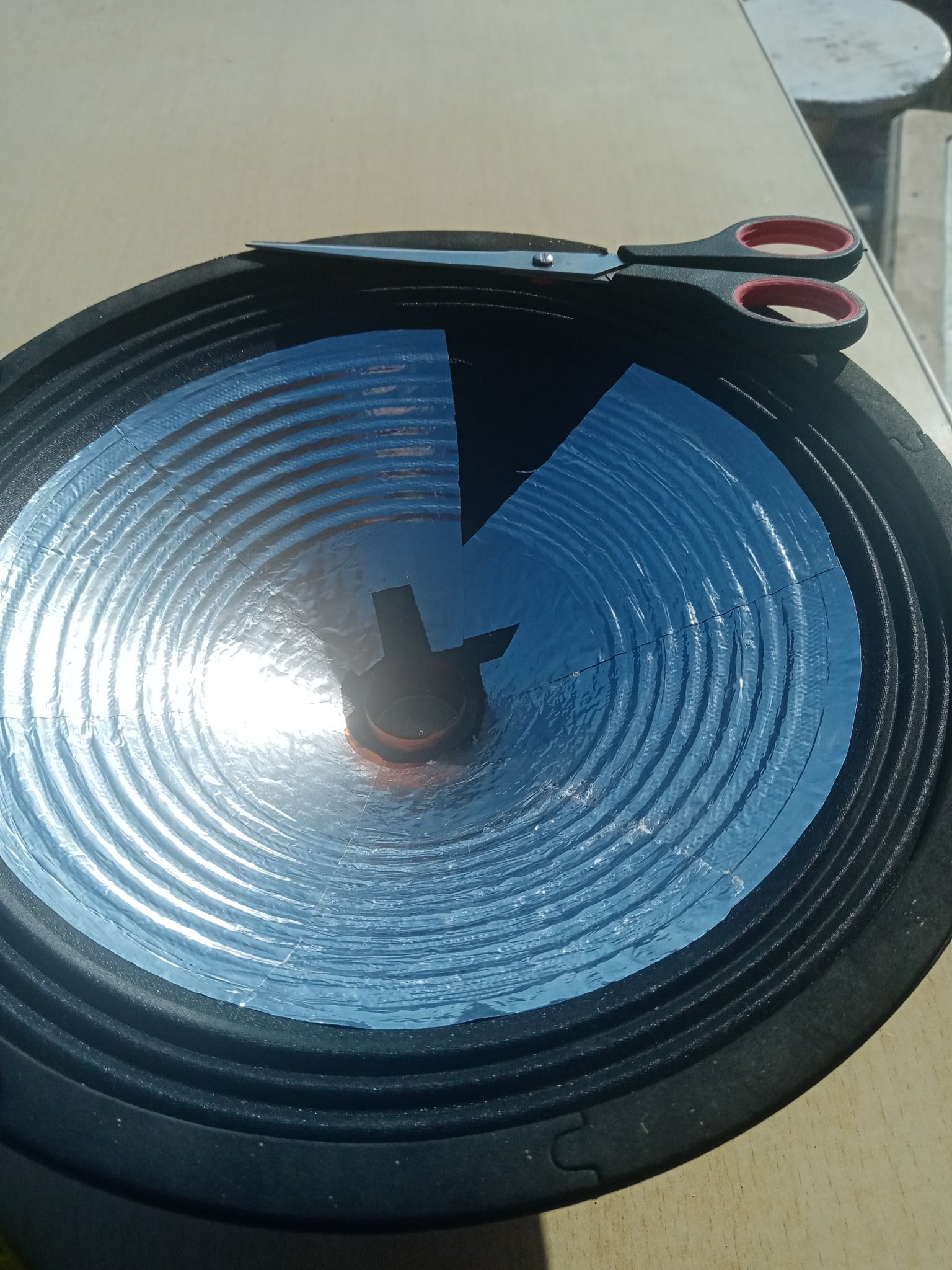

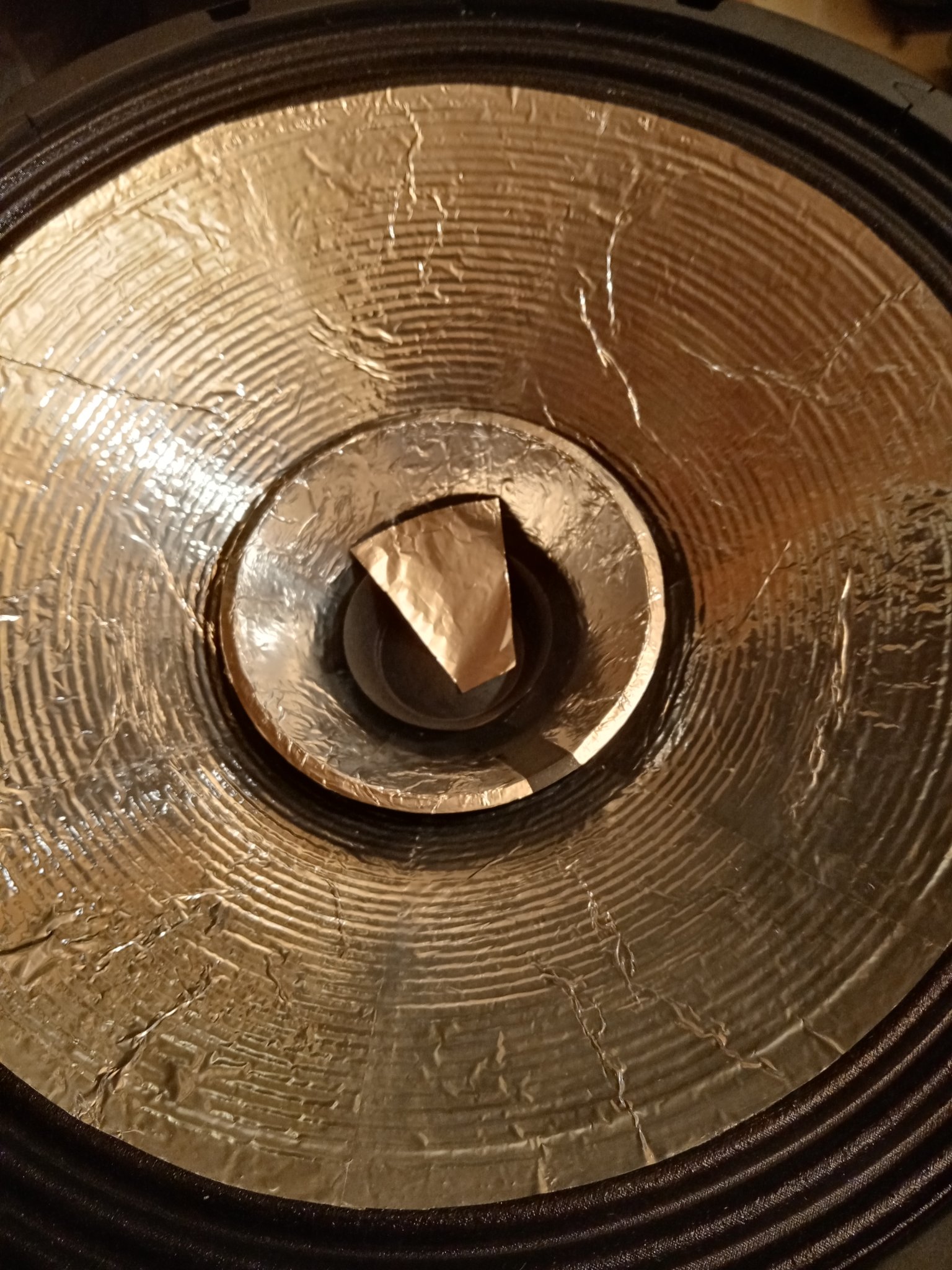

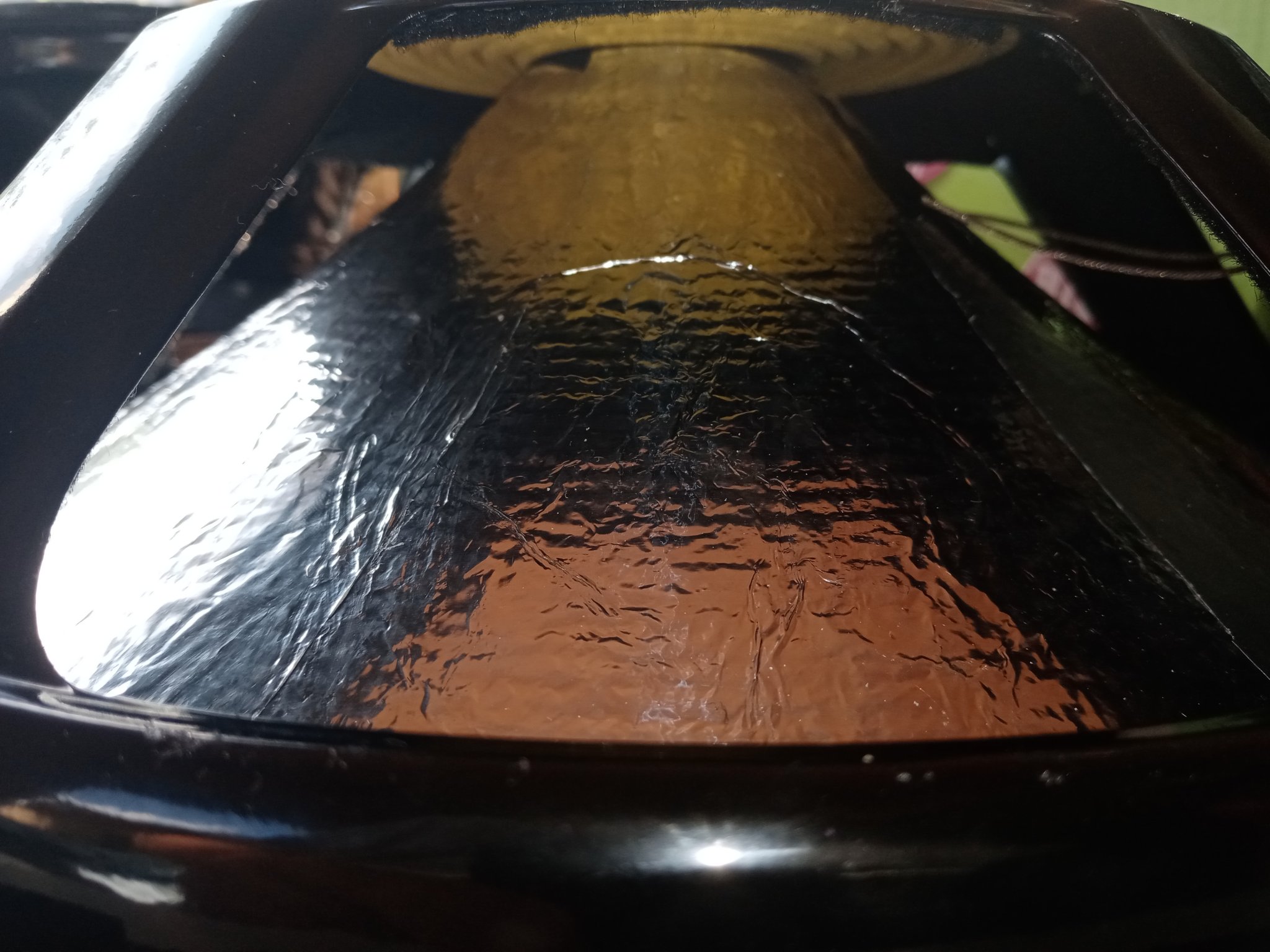

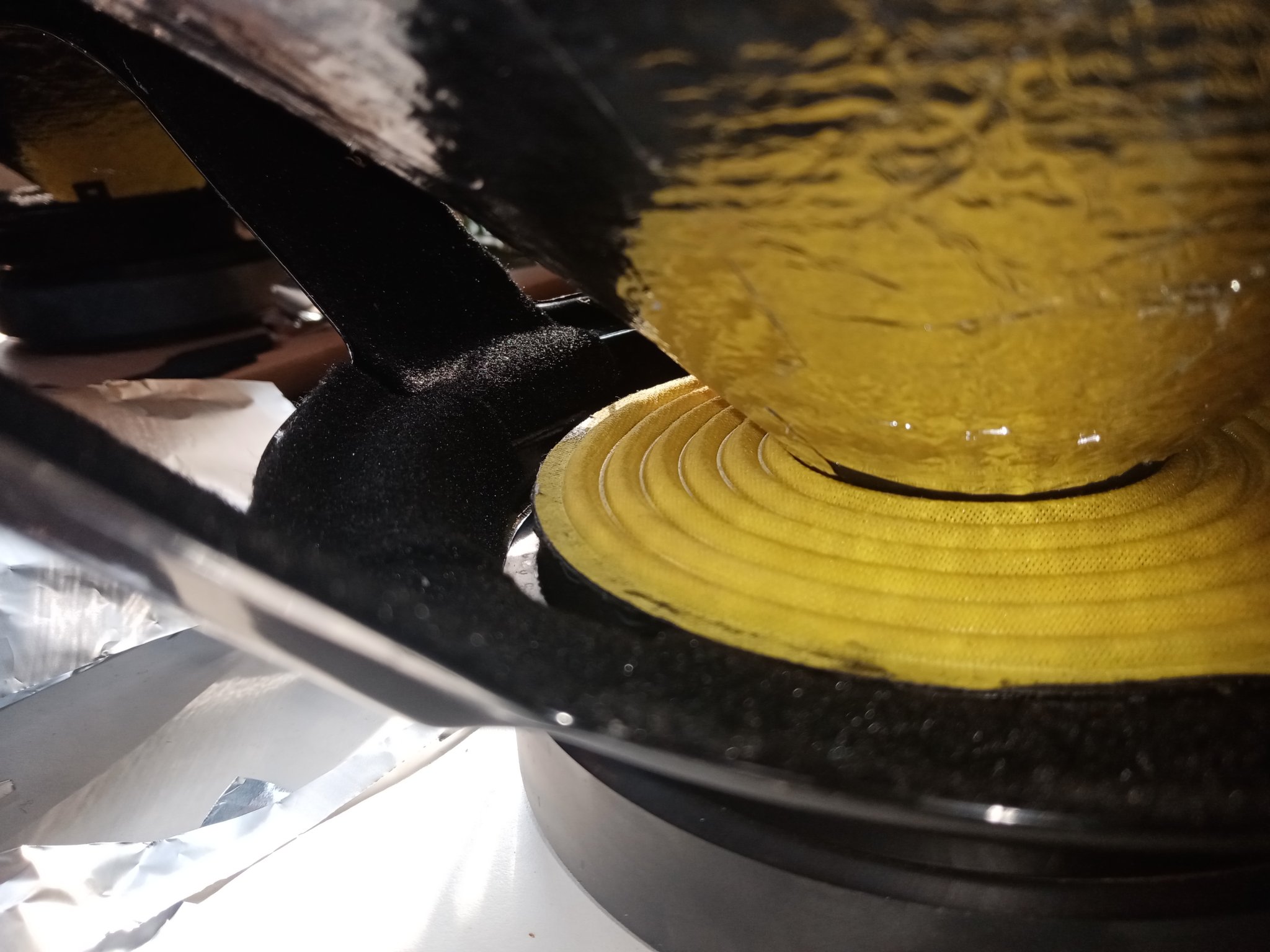

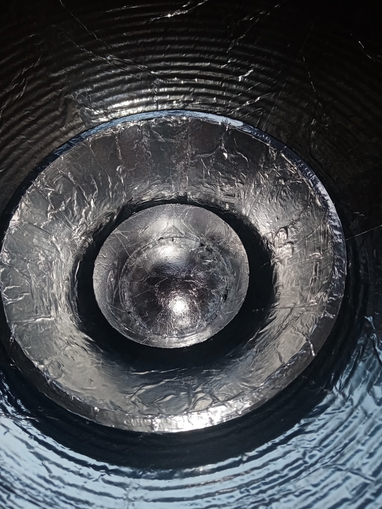

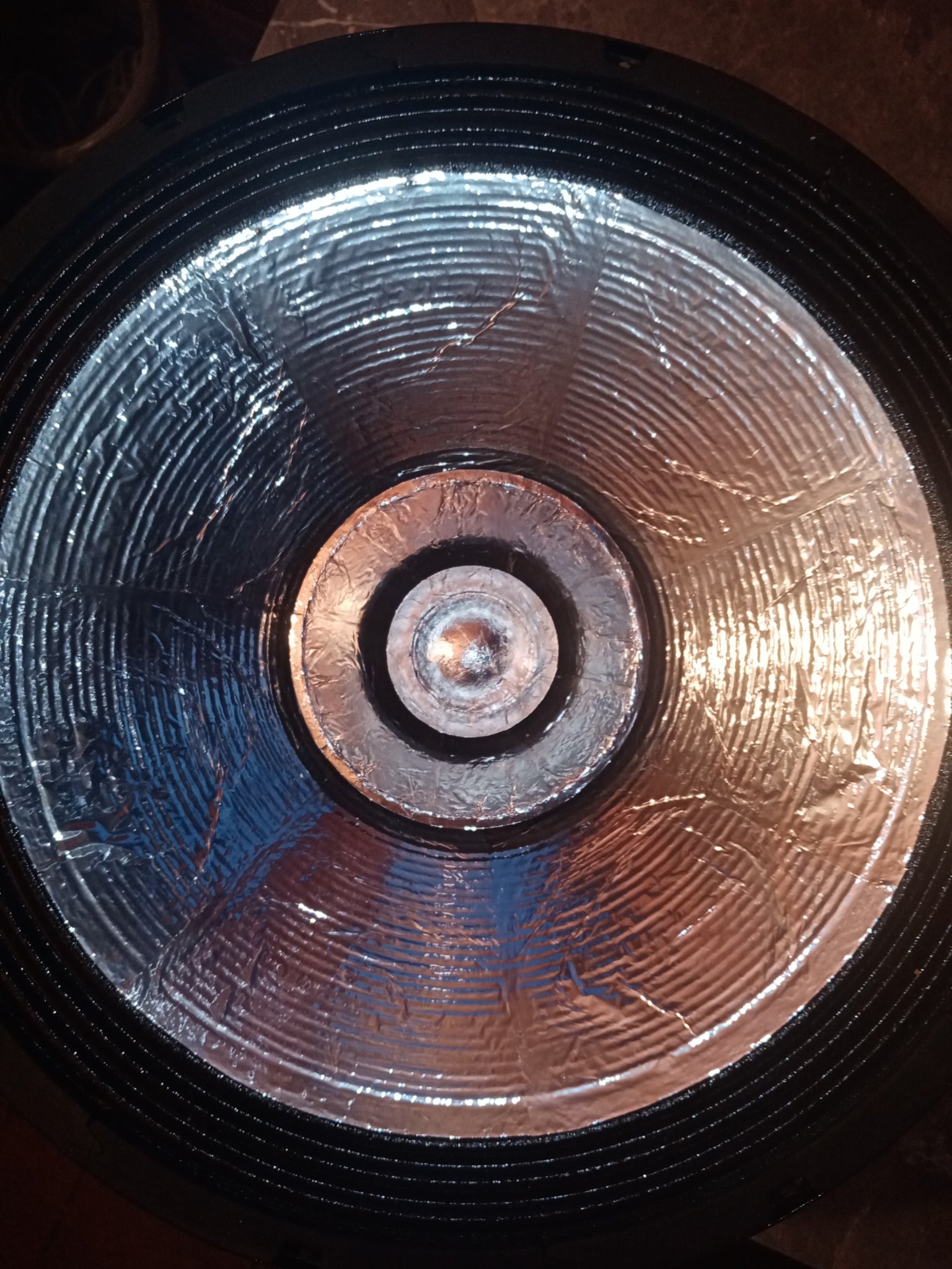

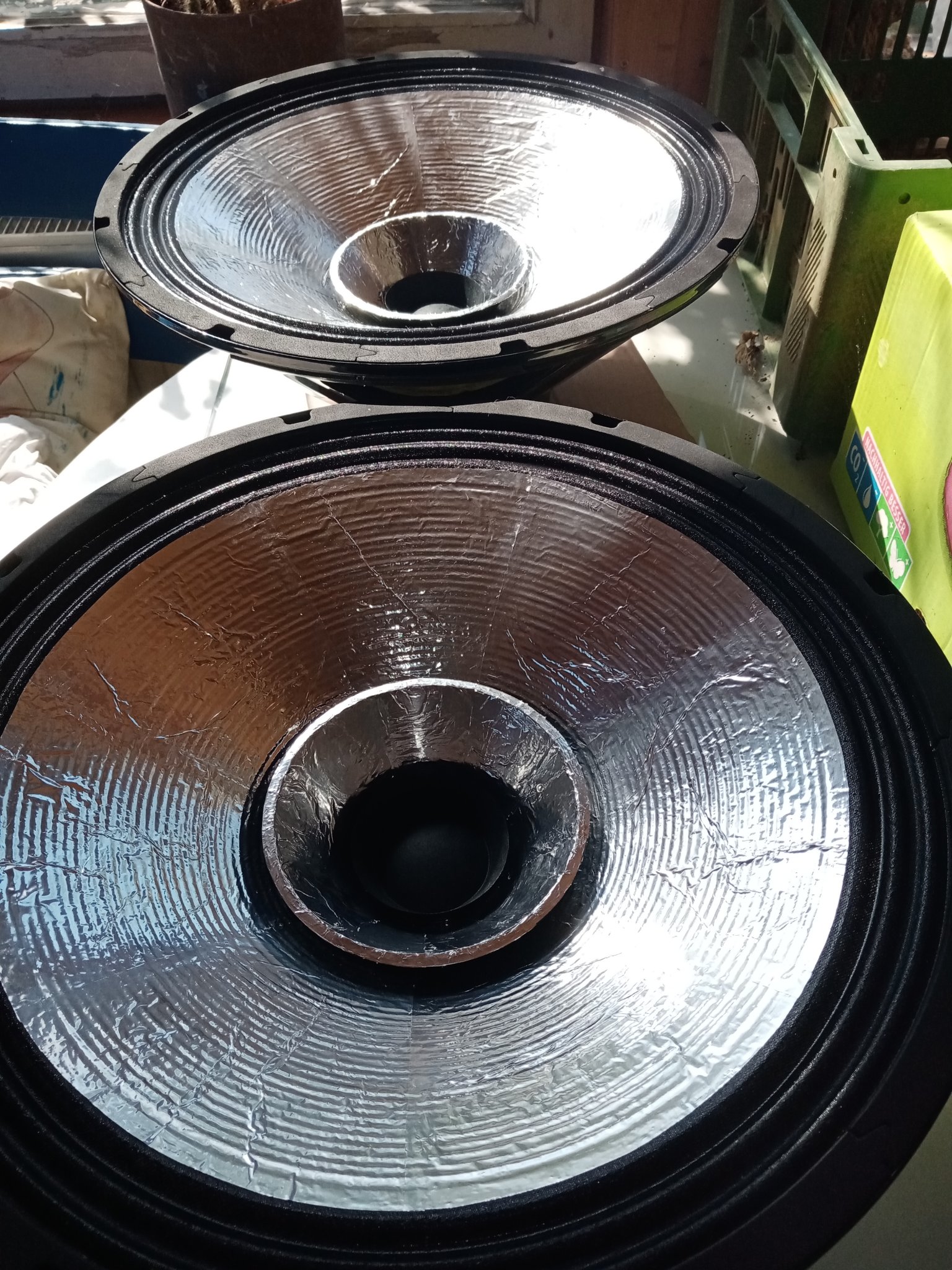

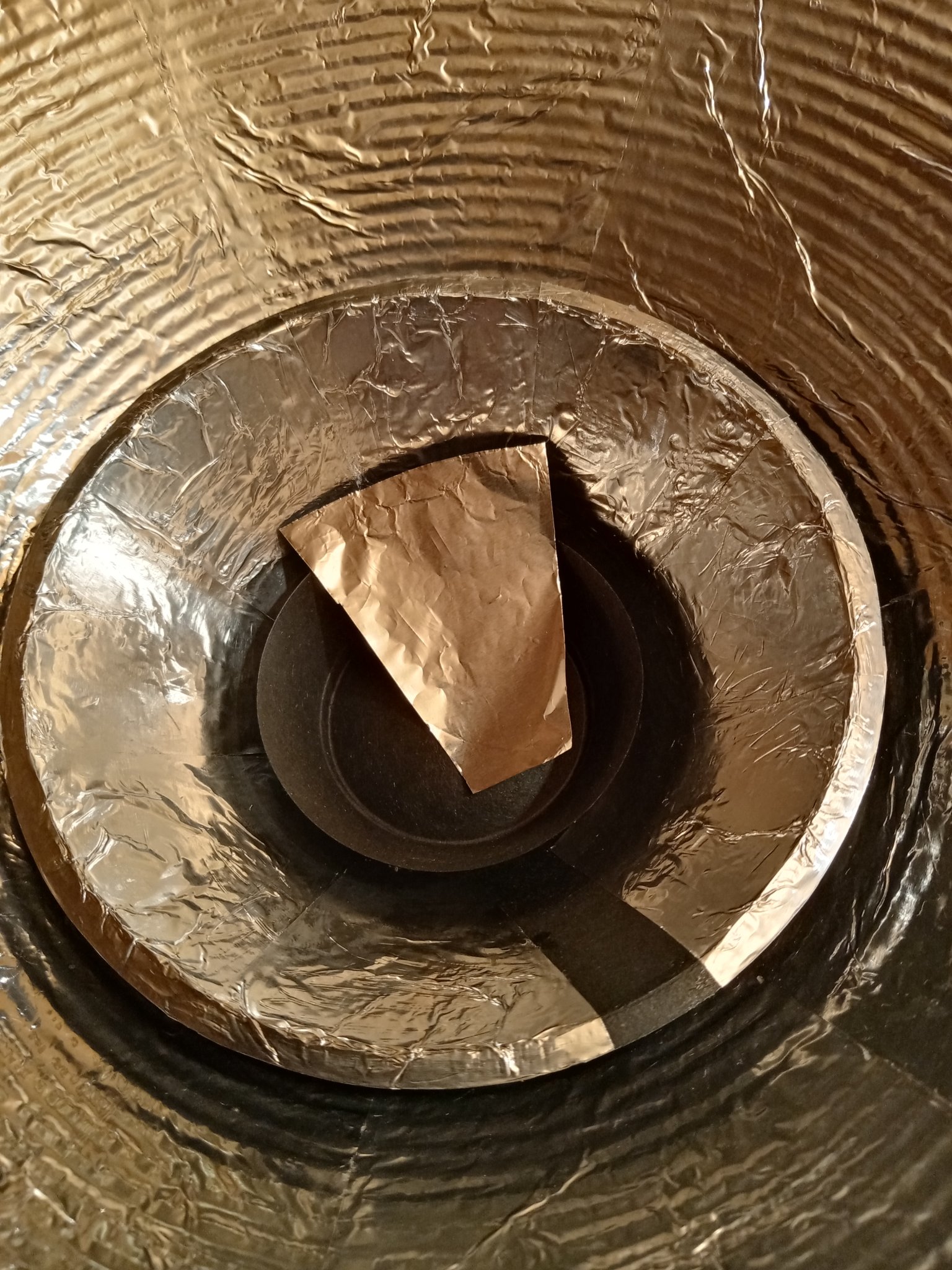

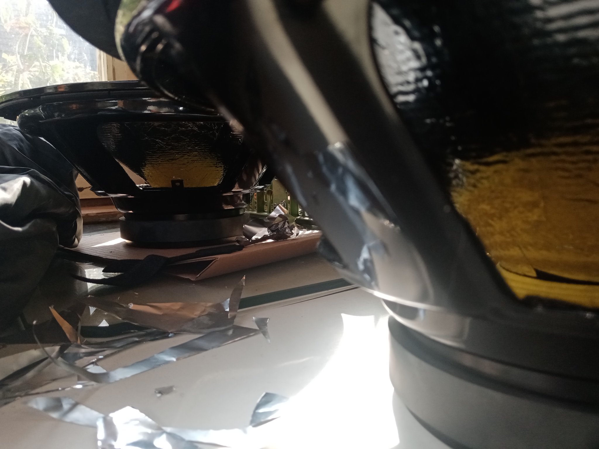

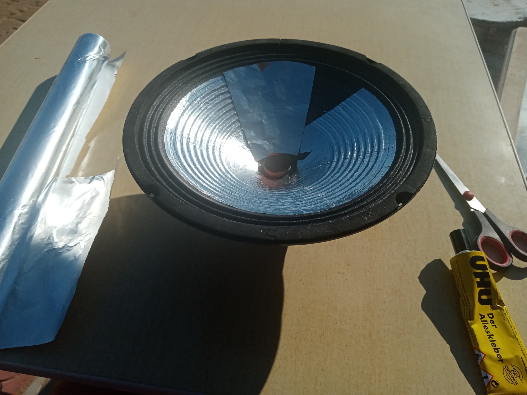

Now back sides of the stereo pair Fane Sovereign 15 300 tc are covered with aluminum foil.
It is now a sandwich cone alu/paper/alu. A double magnet same size will be added.
Also all metal surfaces of the basket behind the cone got some textile dampening first reflections.
Don't you think world best driver manufactures would do this if it has benefficial effect?

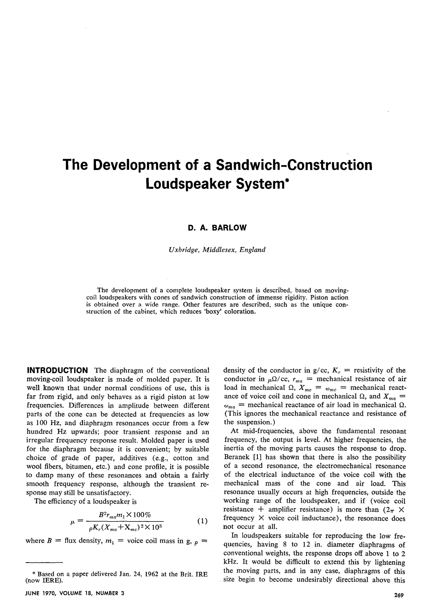

This is what D A Barlow wrote in 1970:
A method of obtaining still greater stiffness is sandwich construction. ... In bending, the maximum stress and strain occur at the outer fibers, the material at the neutral axis being unstressed.
Better use of material can thus be made by concentrating it at the outer fibers. A familiar example is the tube. In the case of large areas, the same effect is obtained by using a thin high-modulus material for the outer surfaces, and a light-weight material or form of construction for the core. ... This sandwich will of course be much stiffer than the same total weight of either material used separately
https://www.aes.org/e-lib/browse.cfm?elib=1505

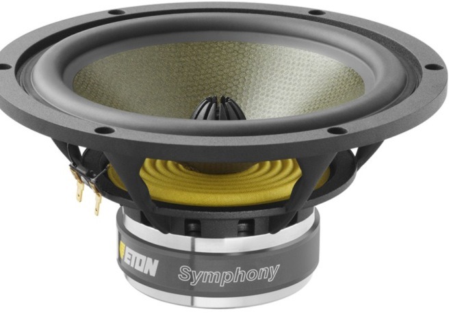

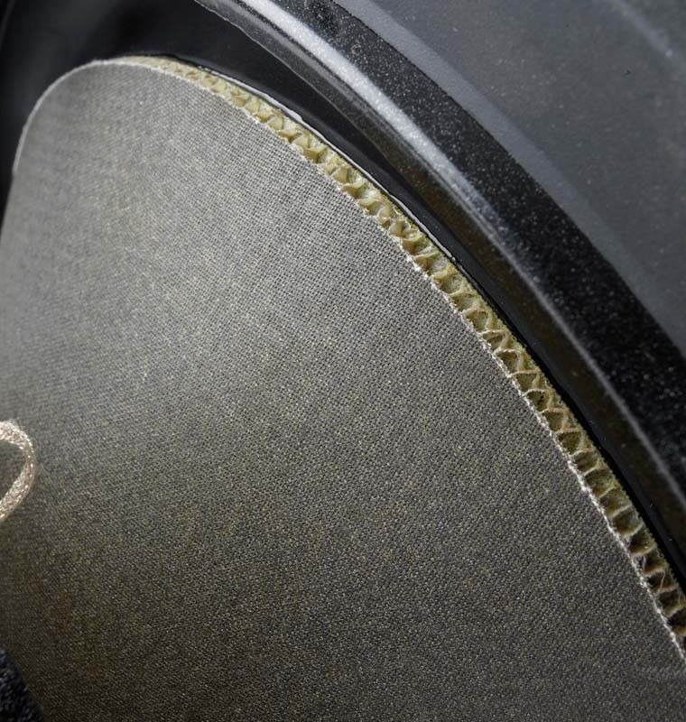

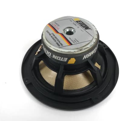

Similar technique is Kevlar on honeycomb cores. The newer Eton drivers managed to tame the hard cone resonances I think due to elastic glue. Their waterfalls look nearly perfect, too.
I would be so glad to see a fullrange driver using this cone.
Once I DSPed an Eton and it was quite good sounding. It had a metal dust cap which was directly fixed on the voice coil. Only pity was the voice coil was not for fullrange with low enough inductivity. So too much correction had to be applied.
It was this one
It was this one

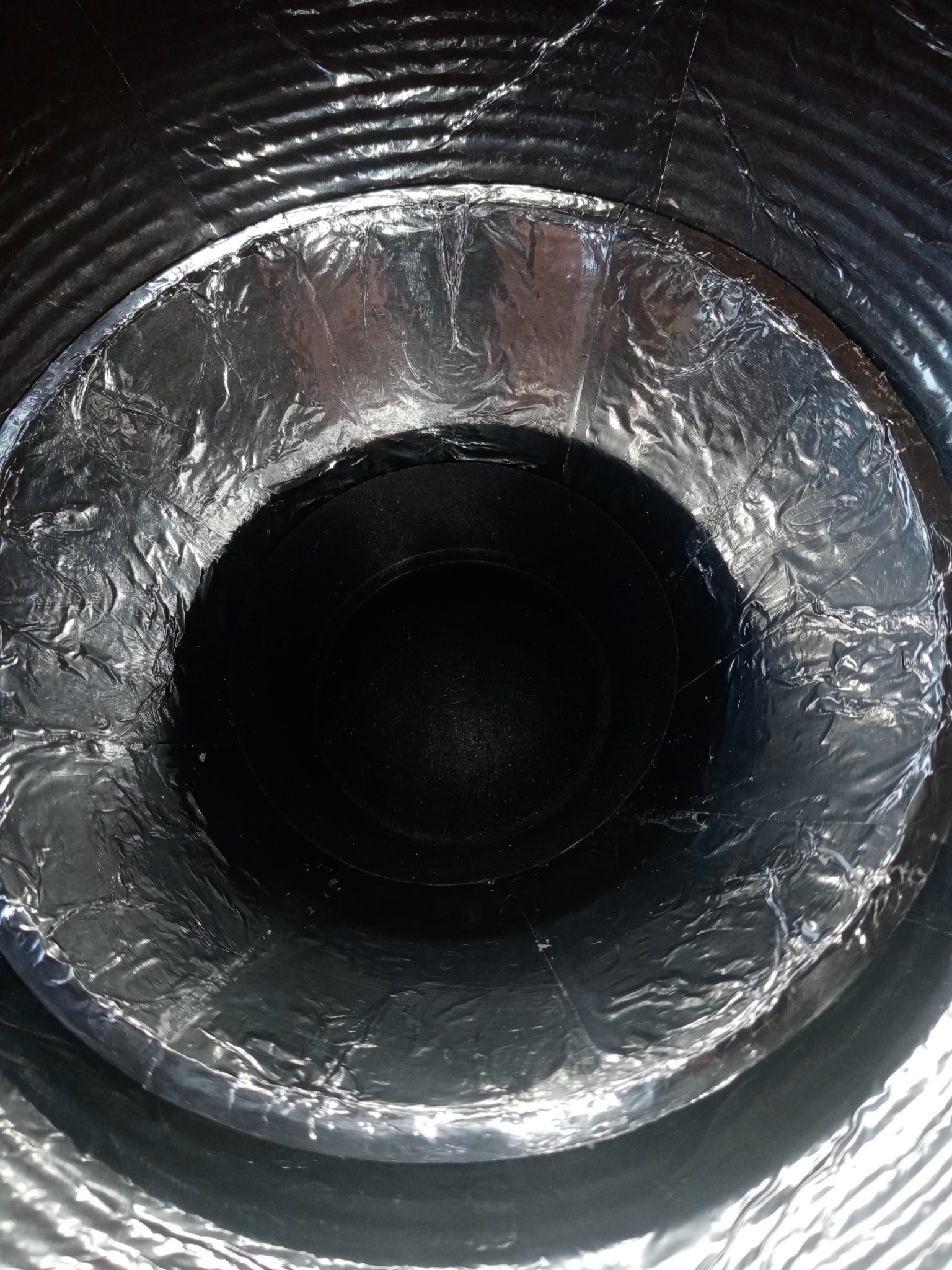

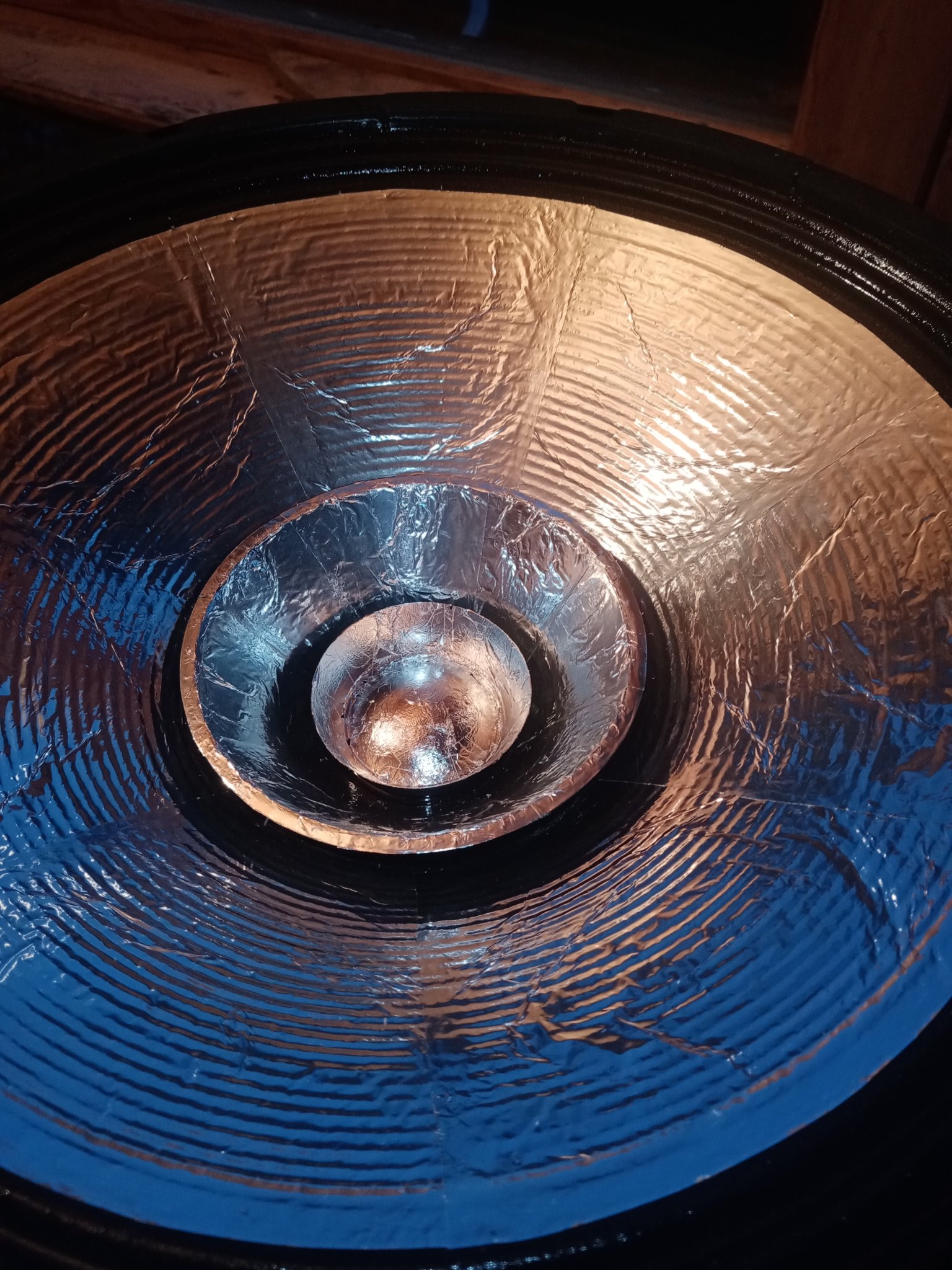

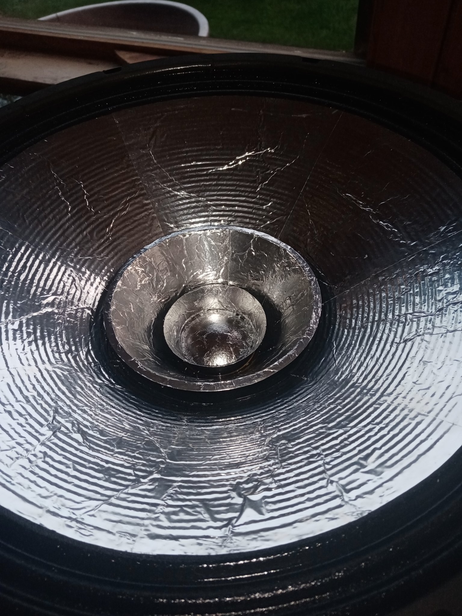

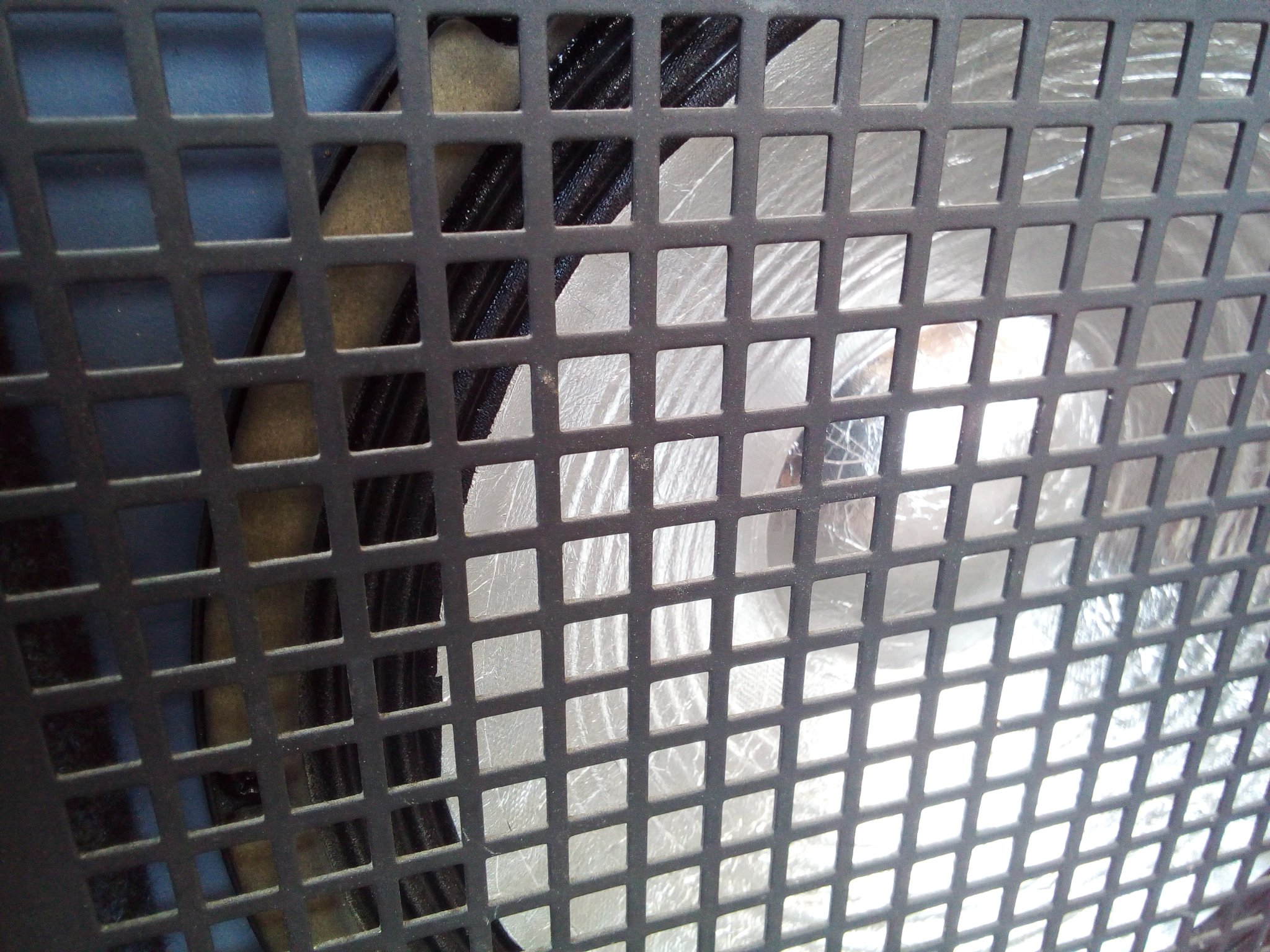

Now the big whizzer cones / double cone are covered one sided with aluminum metal foil.
In the evening with different light the aluminized loudspeaker diaphragms shine golden....
The drivers are ready. Will see if I manage to install them and make measurements.
Aluminized small double cone with thin foil from the goldsmith.

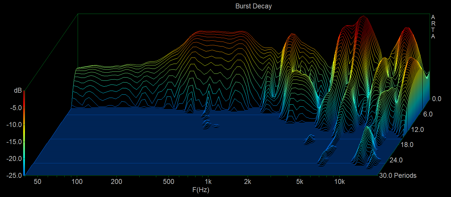

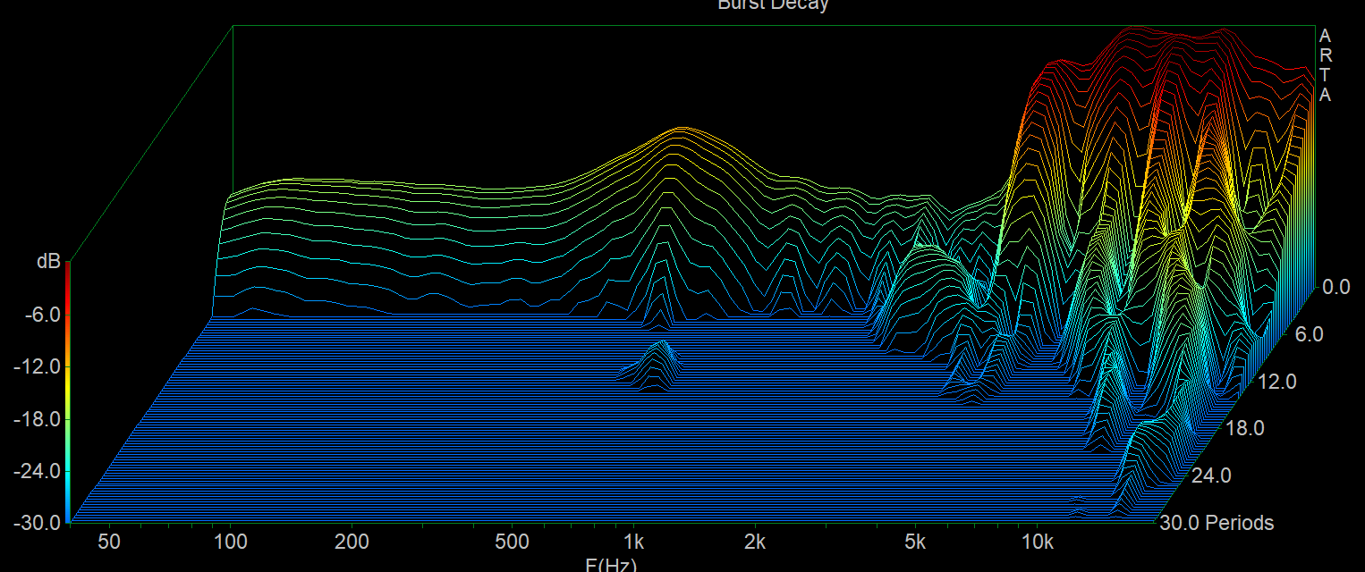

Quick waterfall measurement without enclosure / box. Fane Sovereign 15-300tc with aluminized cone both sides, sandwich, whizzers only one side.
Nearfield 10cm on axis. Measurement with ATB PC 501 measurement system (amplifier and microfone linear).
Headroom 30db
Do not know if this measurement is perfect done its just a first hint

some better measurement with damping with cloths around the driver, driver laying on the floor, off axis measurement 30 degrees, 15cm, aluminized cone from both sides, the whizzers only one side.
These are only first hint measurements as there is no real box.
As in the first measurement the highs on axis are so loud you cannot well see the lower frequencies. Therefore off axis measurement just to see more in the low region.

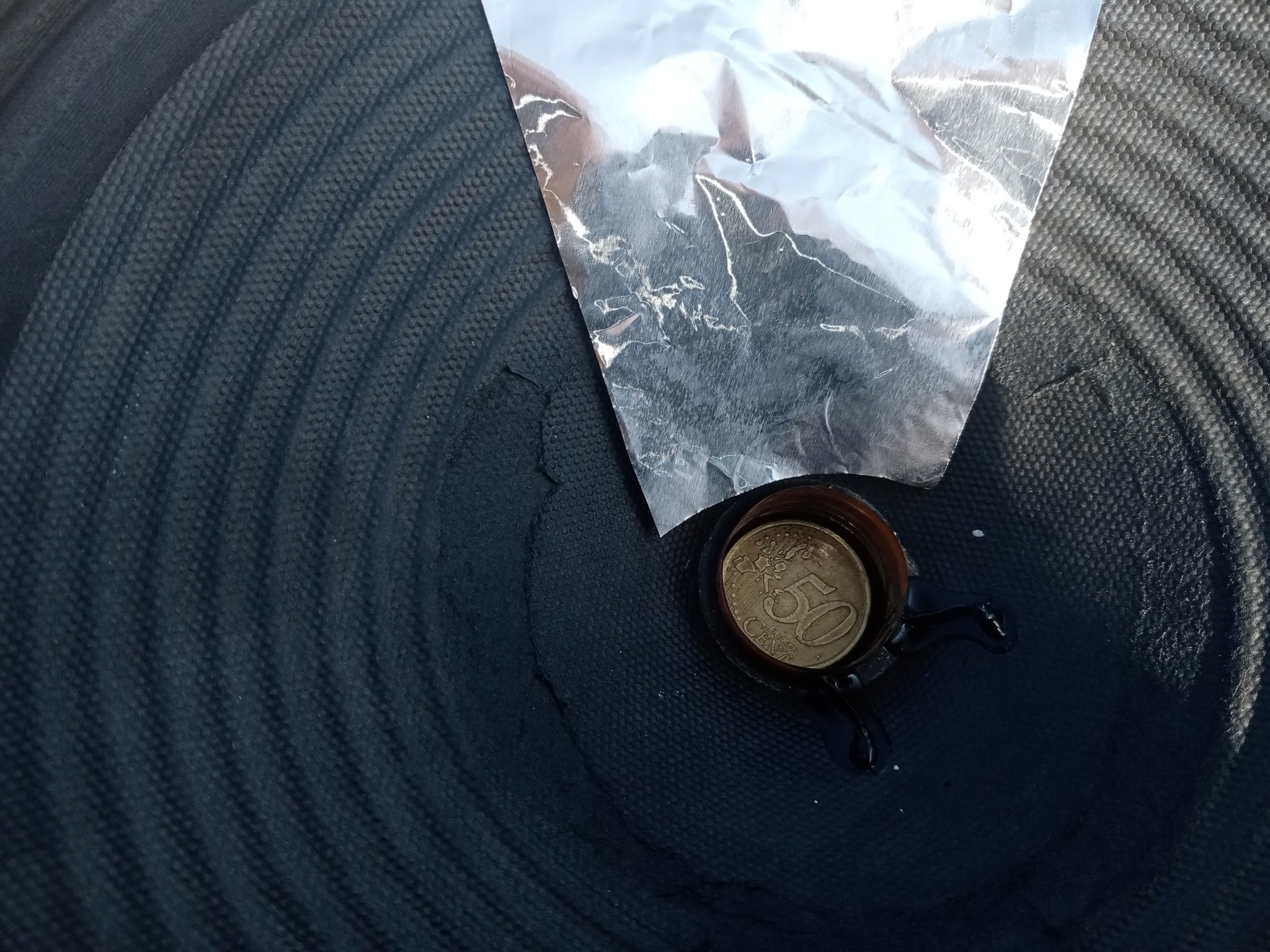

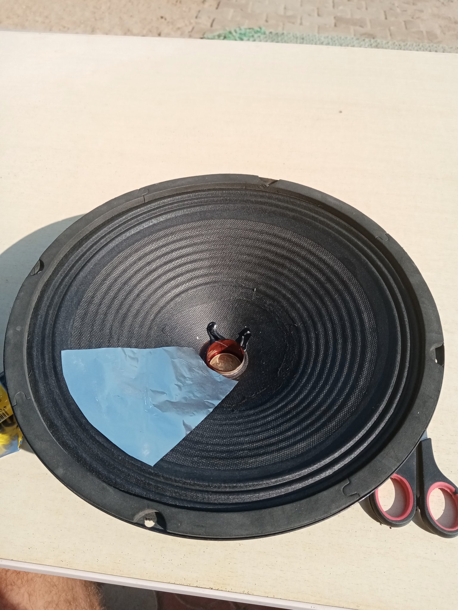

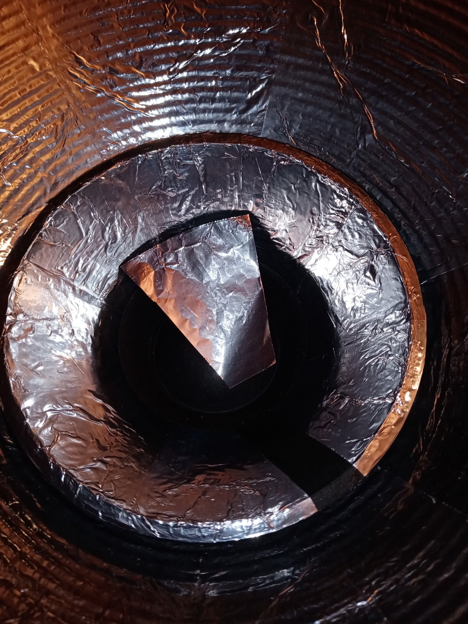

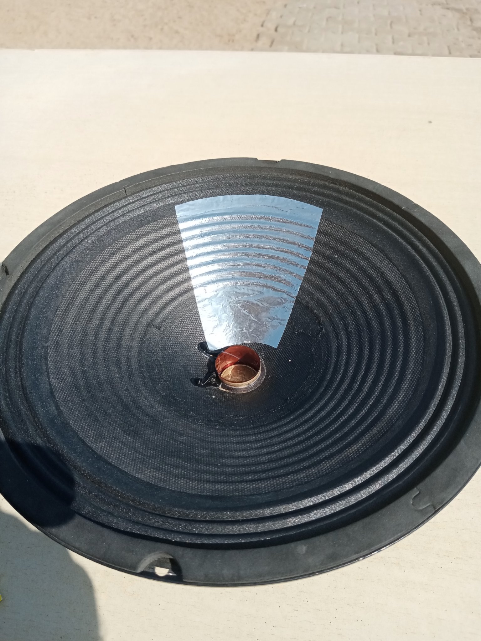

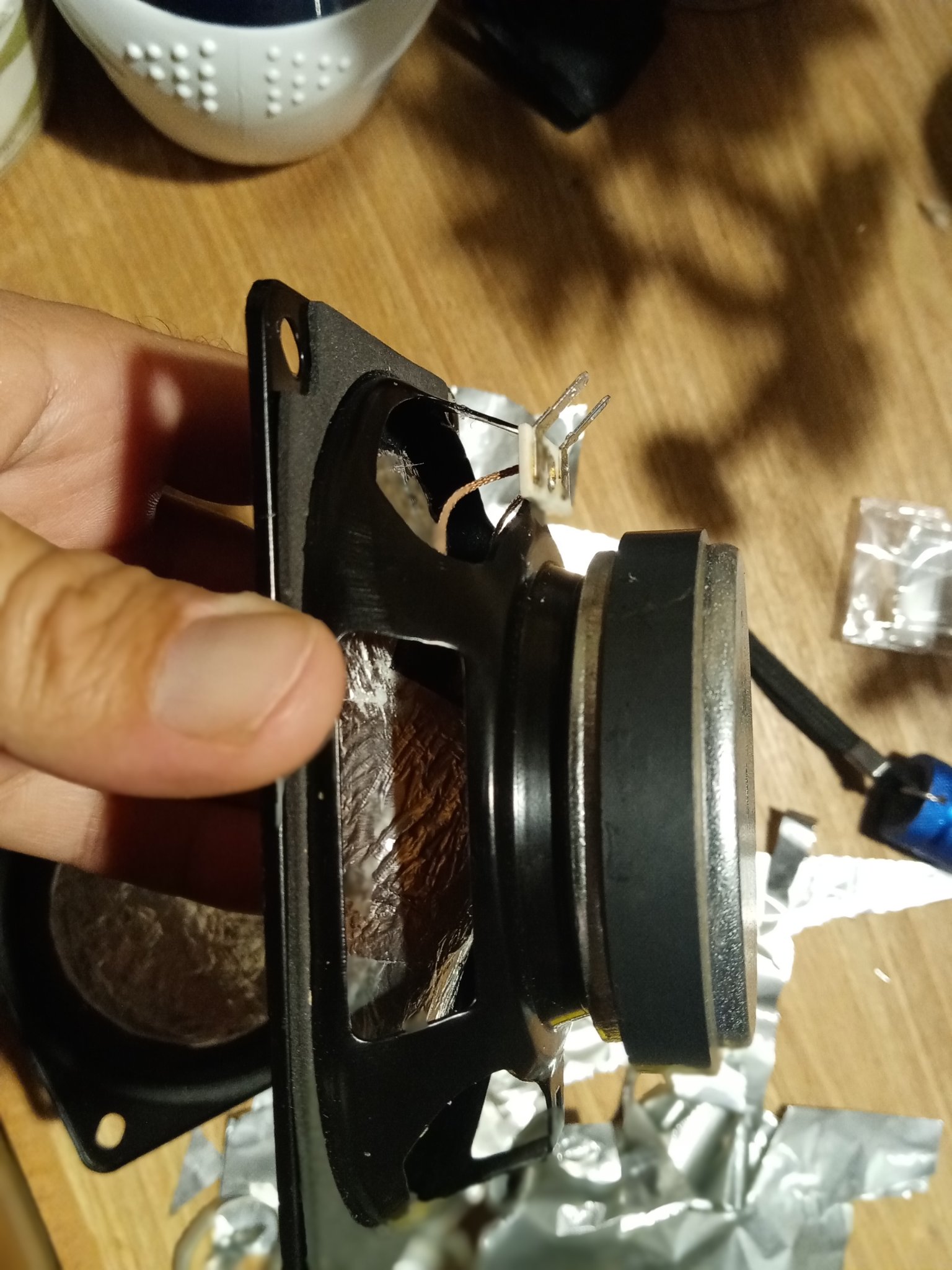

One side nearly completed - metal foil on loudspeaker paper diaphragm.

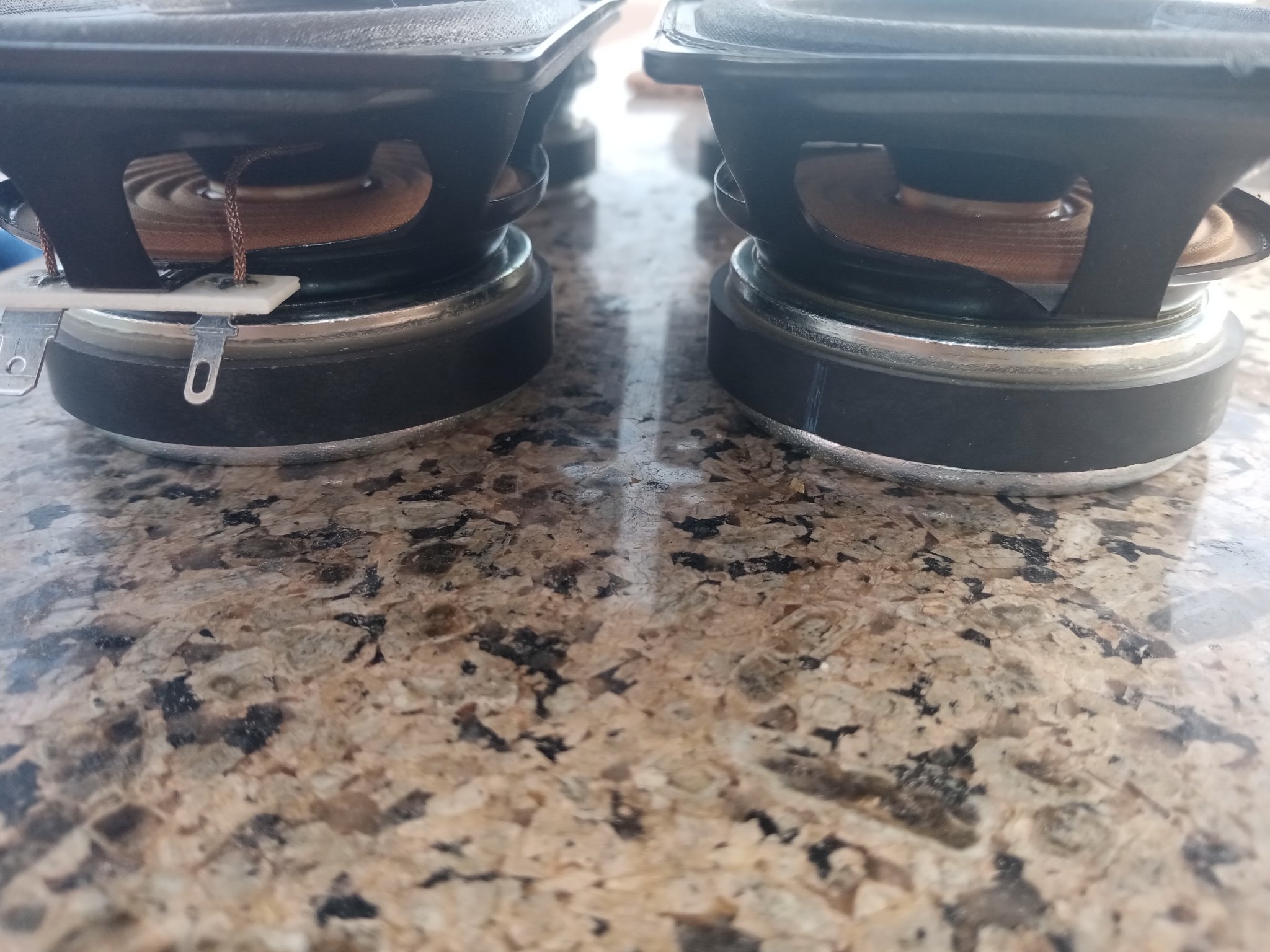

"50 cent trick" applied to top of the pole piece. 50 euro cent contains copper and is usable as Faraday ring reducing distortion of the driver.

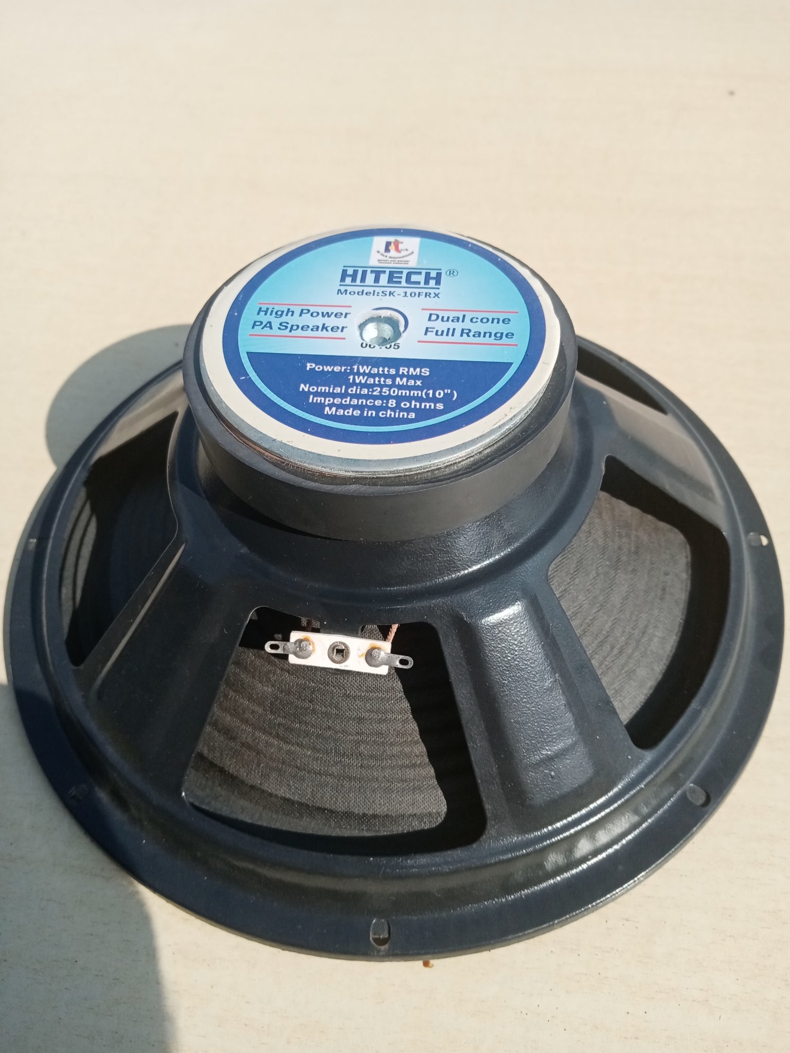

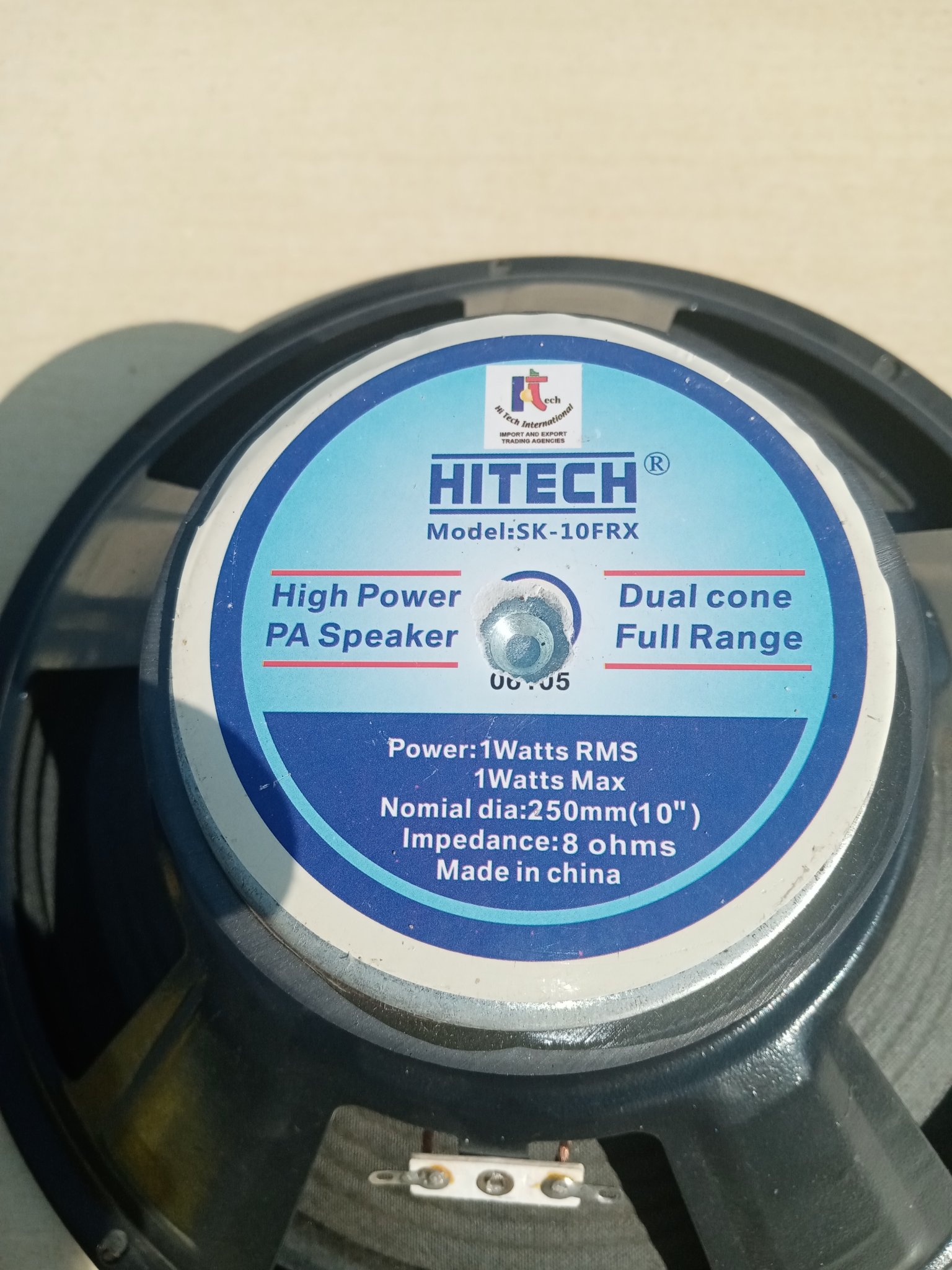

Driver is a cheap 25cm bass converted to a fullrange driver by removing the dust cap and putting a Diy whizzer / double cone on it.

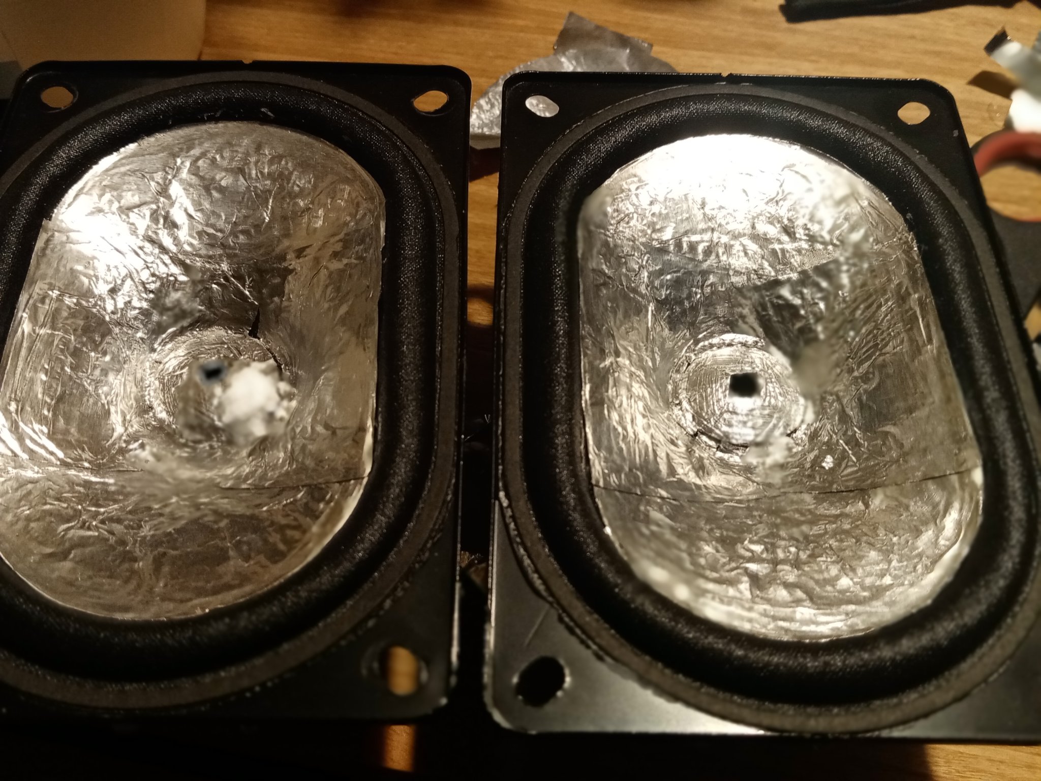

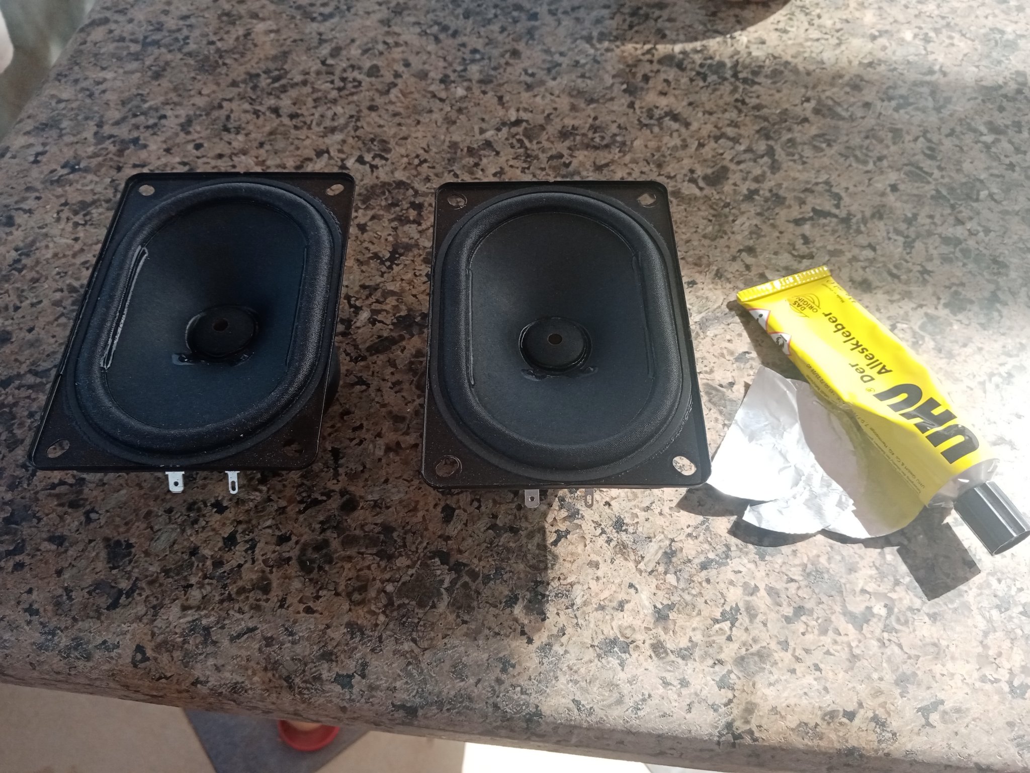

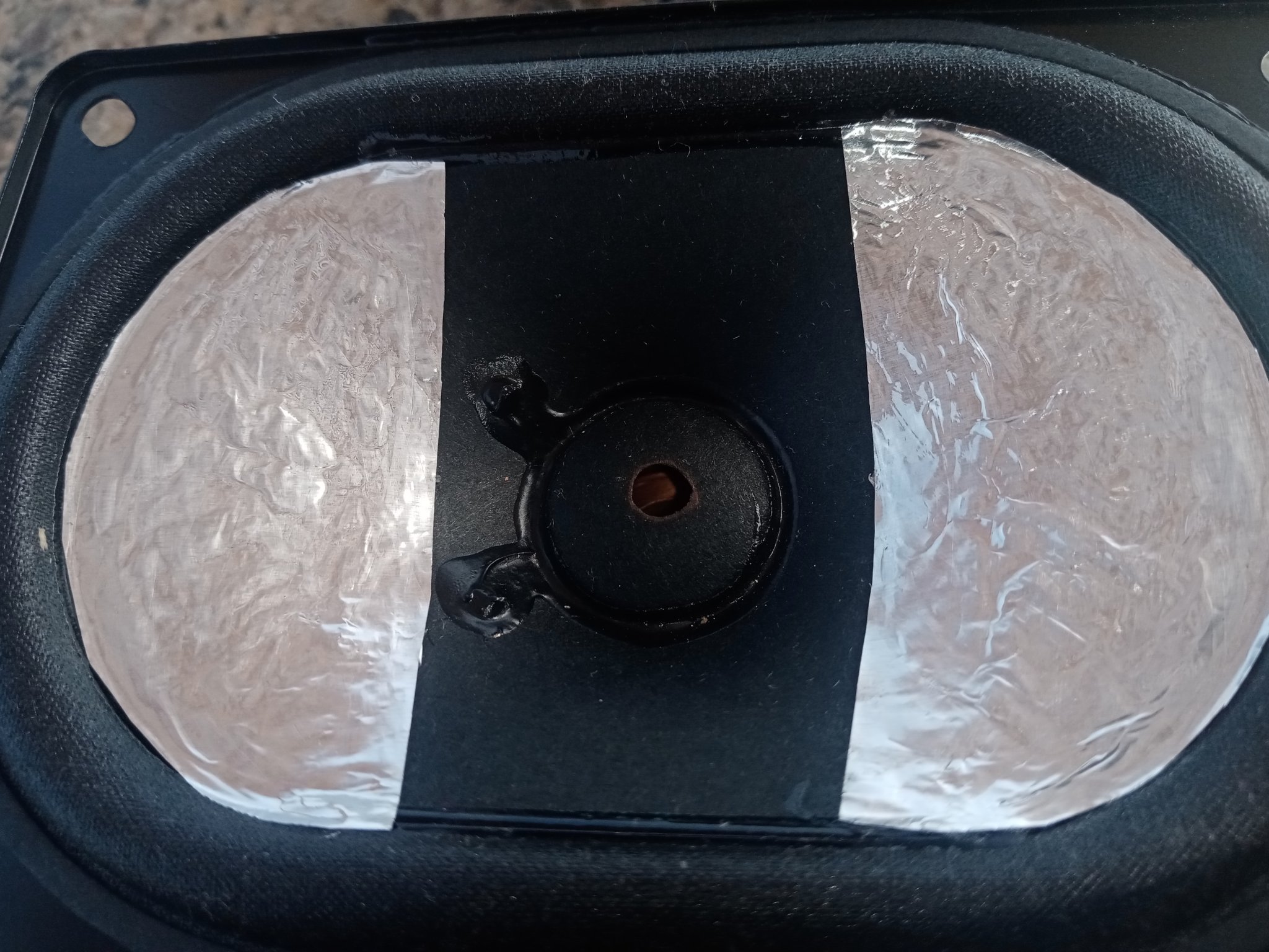

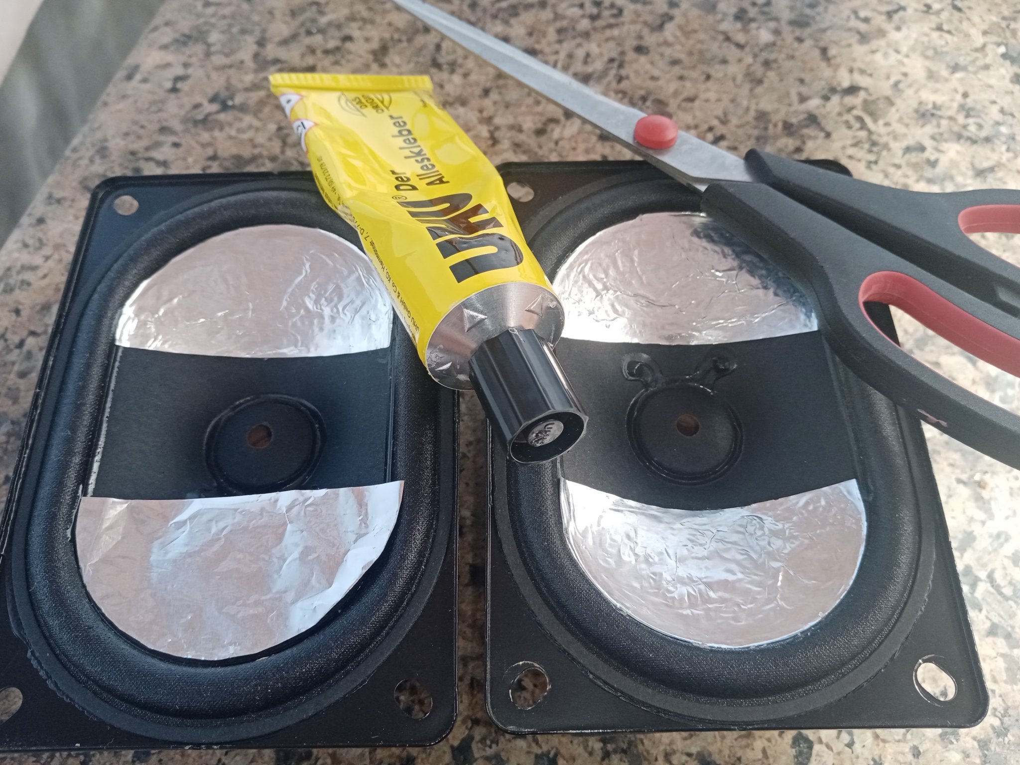

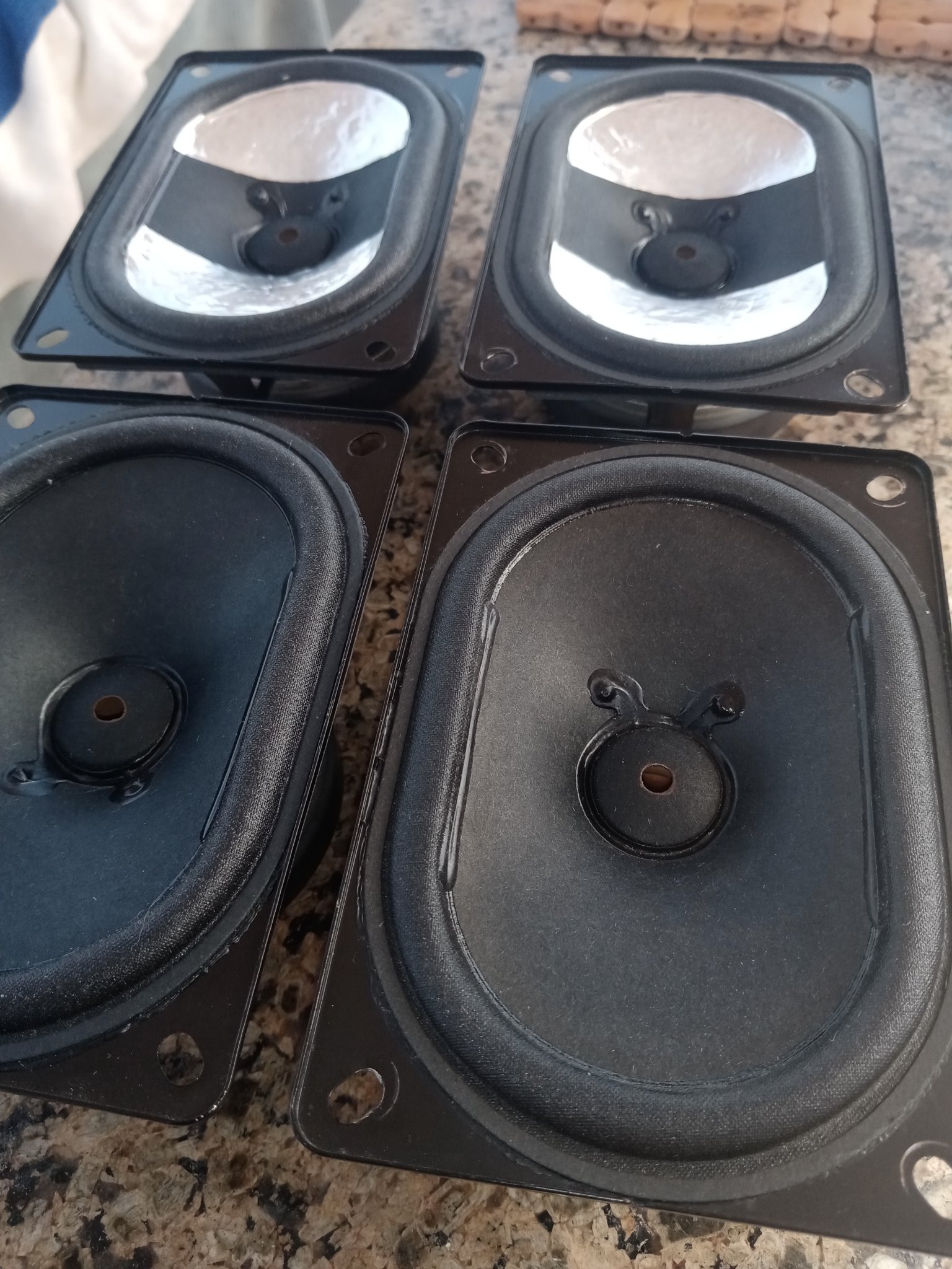

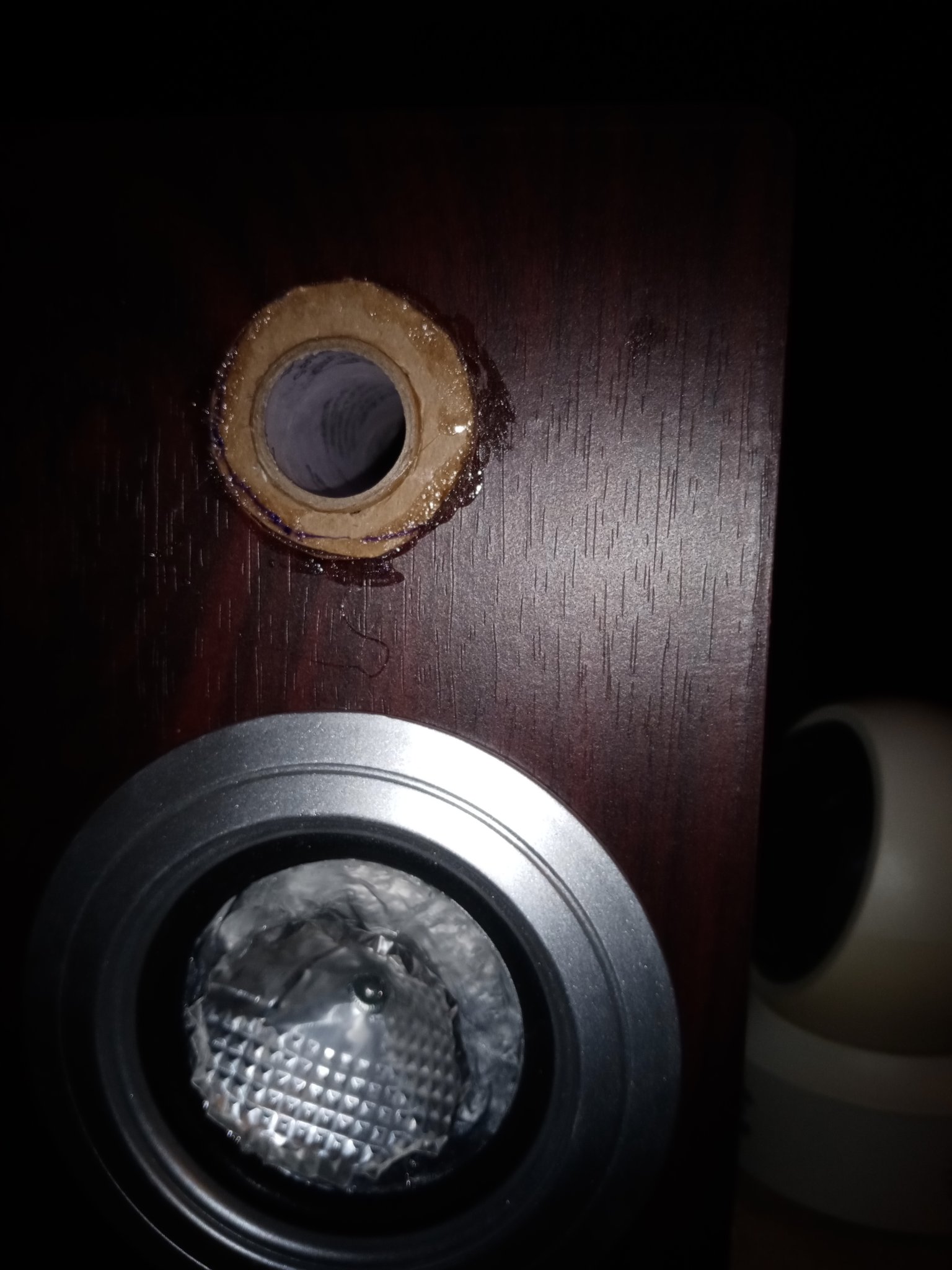

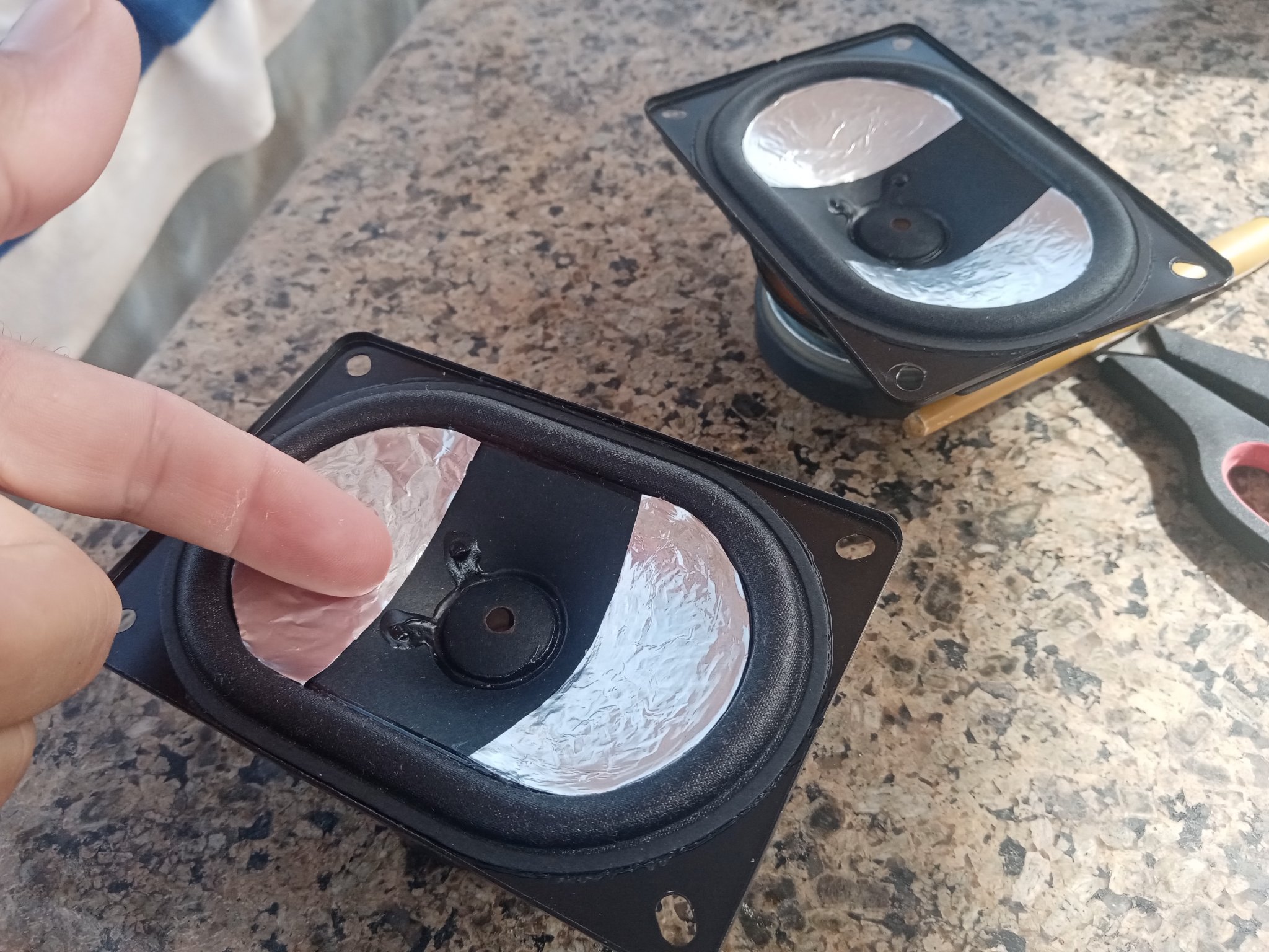

Oval fullrange drivers with tinfoil tweak

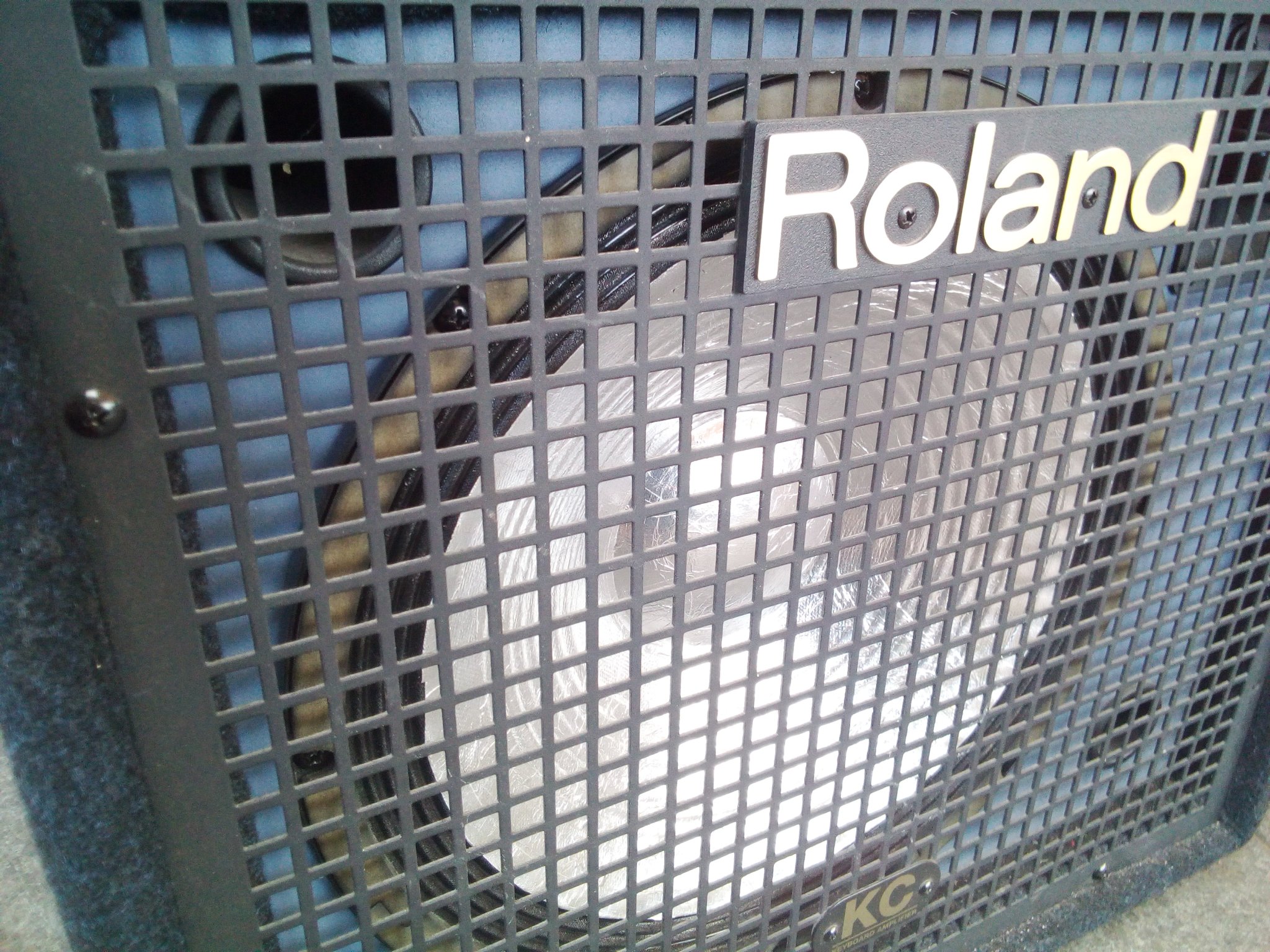

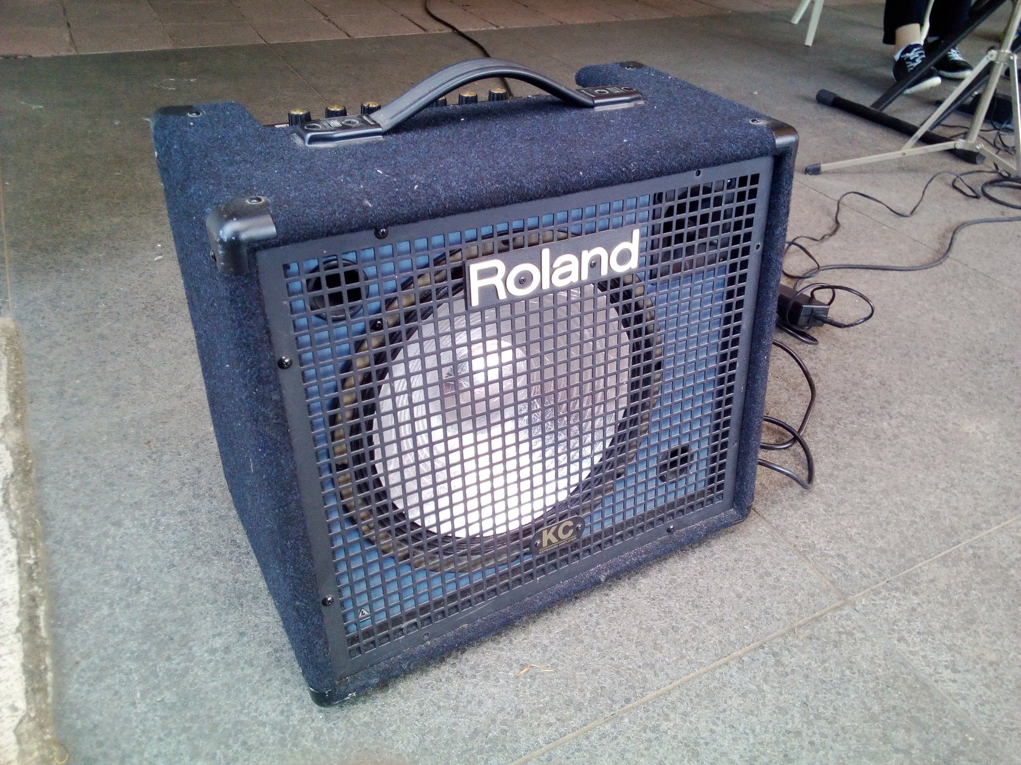

Professional loudspeaker from Roland with one sided aluminium foil on fullrange loudspeaker diaphragm / papercone of thin quality from the gold smith ("Schlagaluminium" = "beaten aluminium")

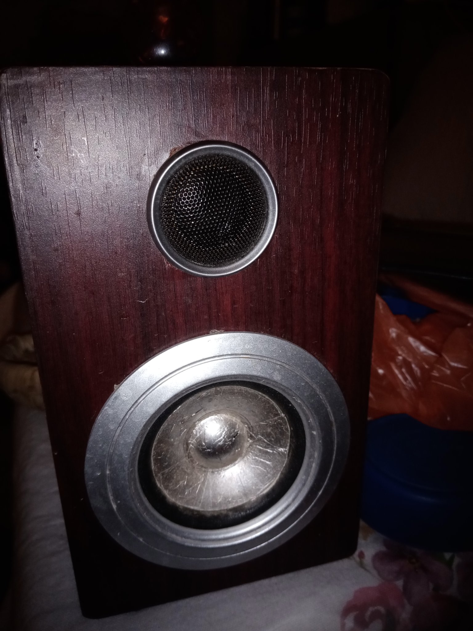

Tweeter got a crossover and the undamped box got damping foam inside on all sides. Reflex tuned lower.

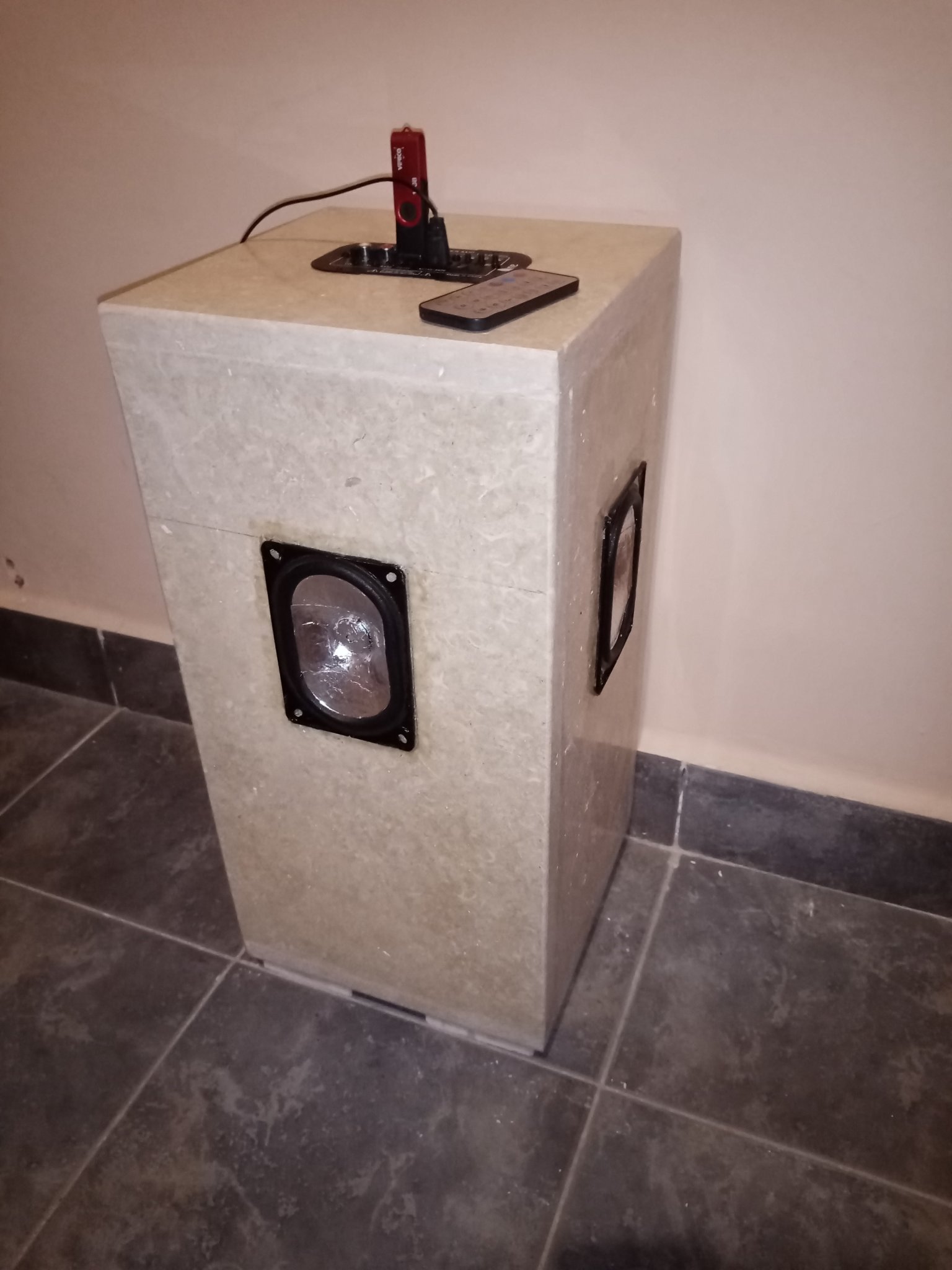

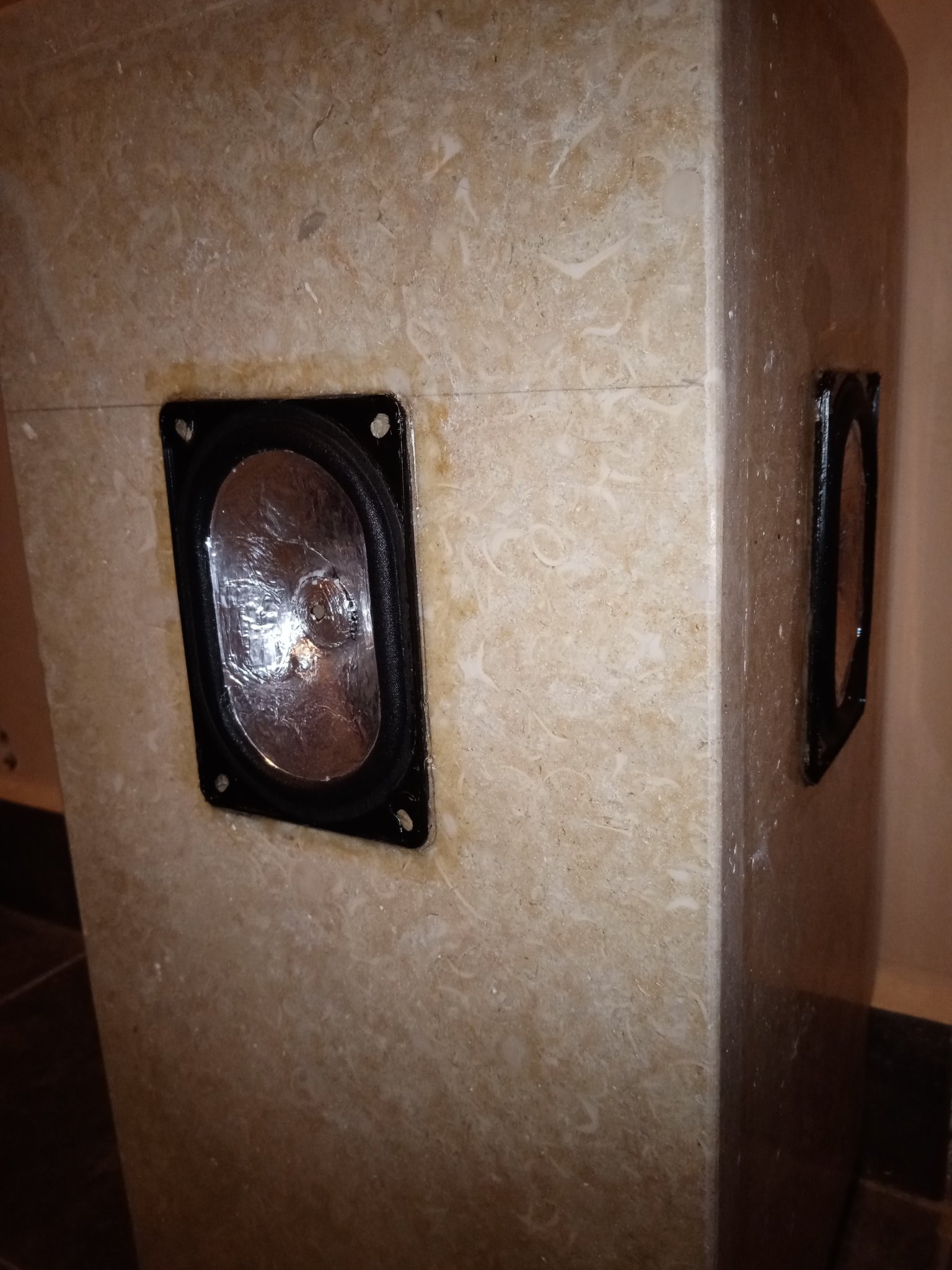

Finished second mono fullrange loudspeaker in box enclosure made of Galala marble. Down fire bass reflex.
Oval fullrange speaker drivers (with copper Faraday ring on the pole plate) with sandwich aluminum tinfoil. In series to the paralleled drivers is 0.8 ohms with 1.5uF C in parallel augmenting the highs. And reducing a little bit the distortion with Esa Merilainens simple resistor method.

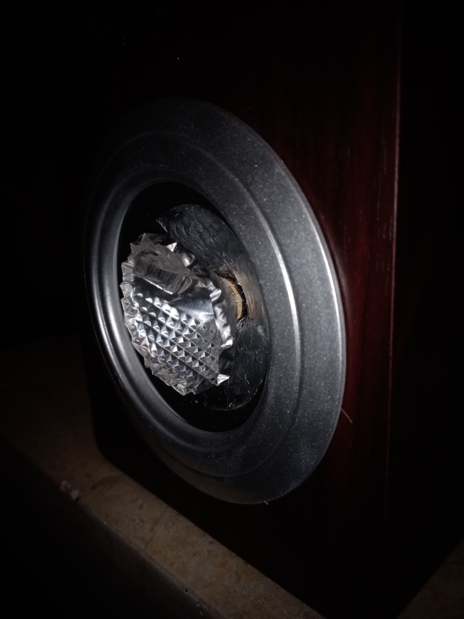

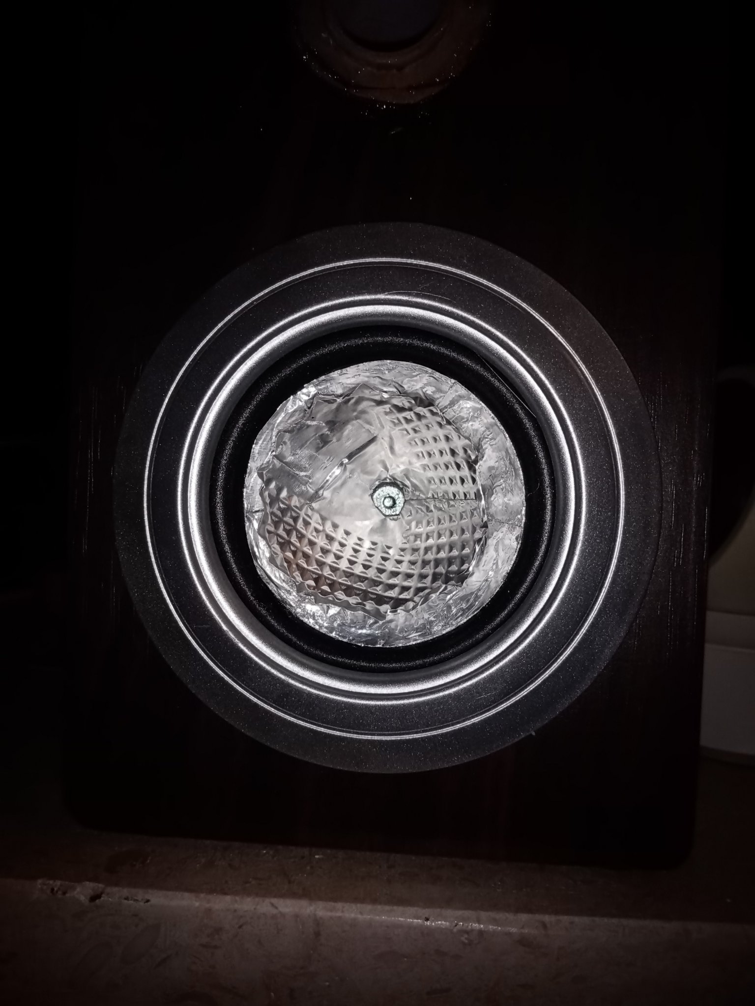

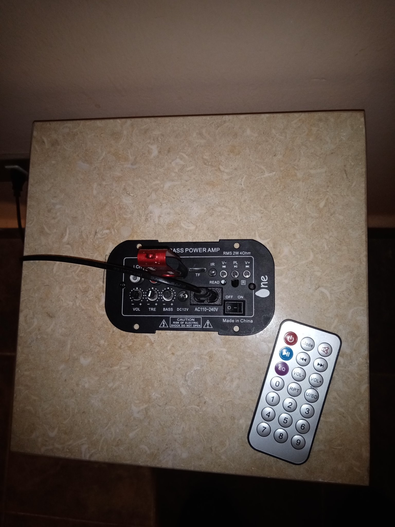

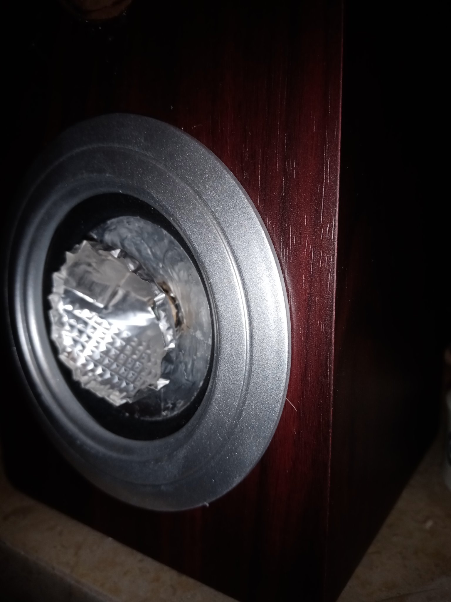

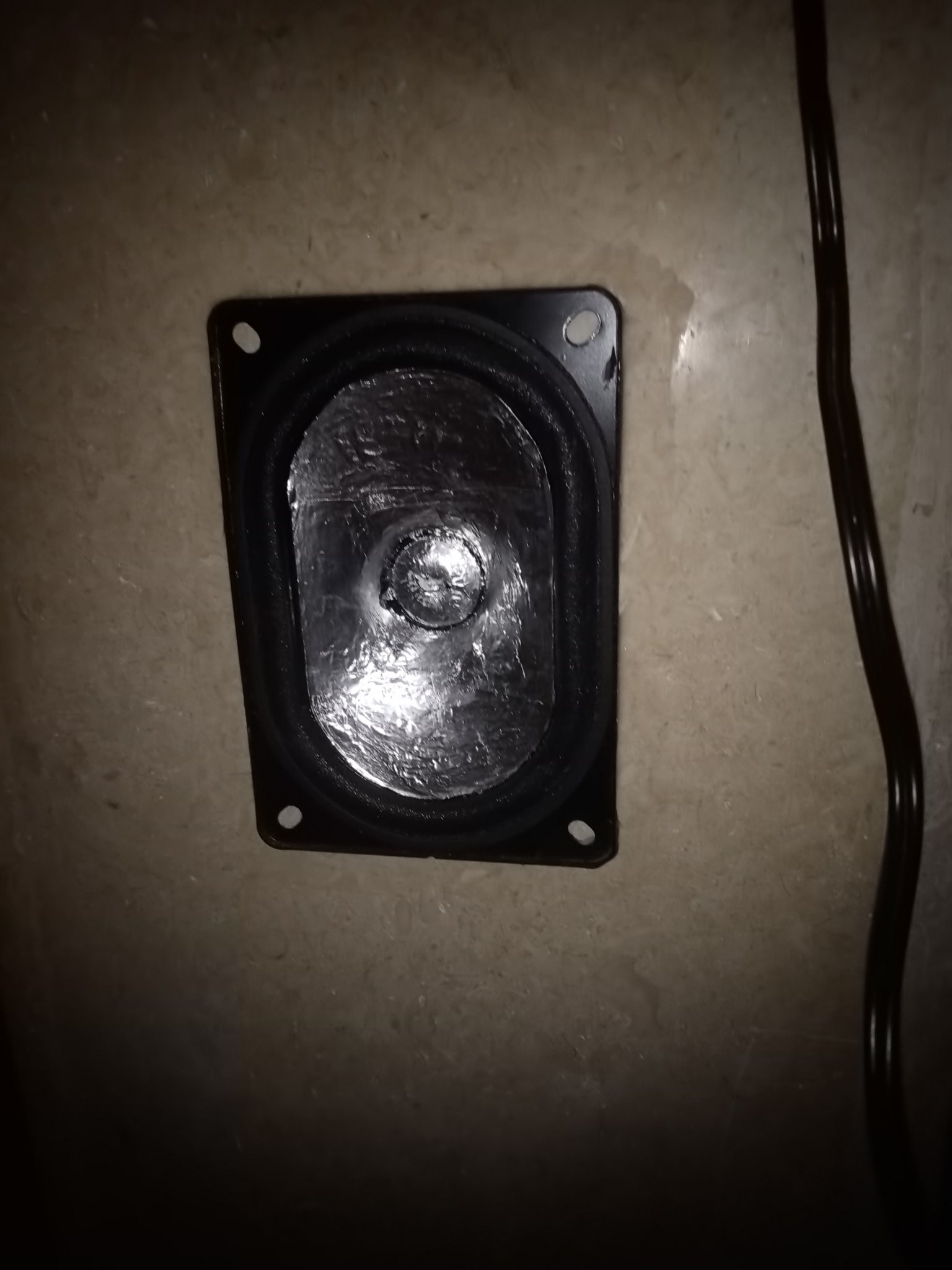

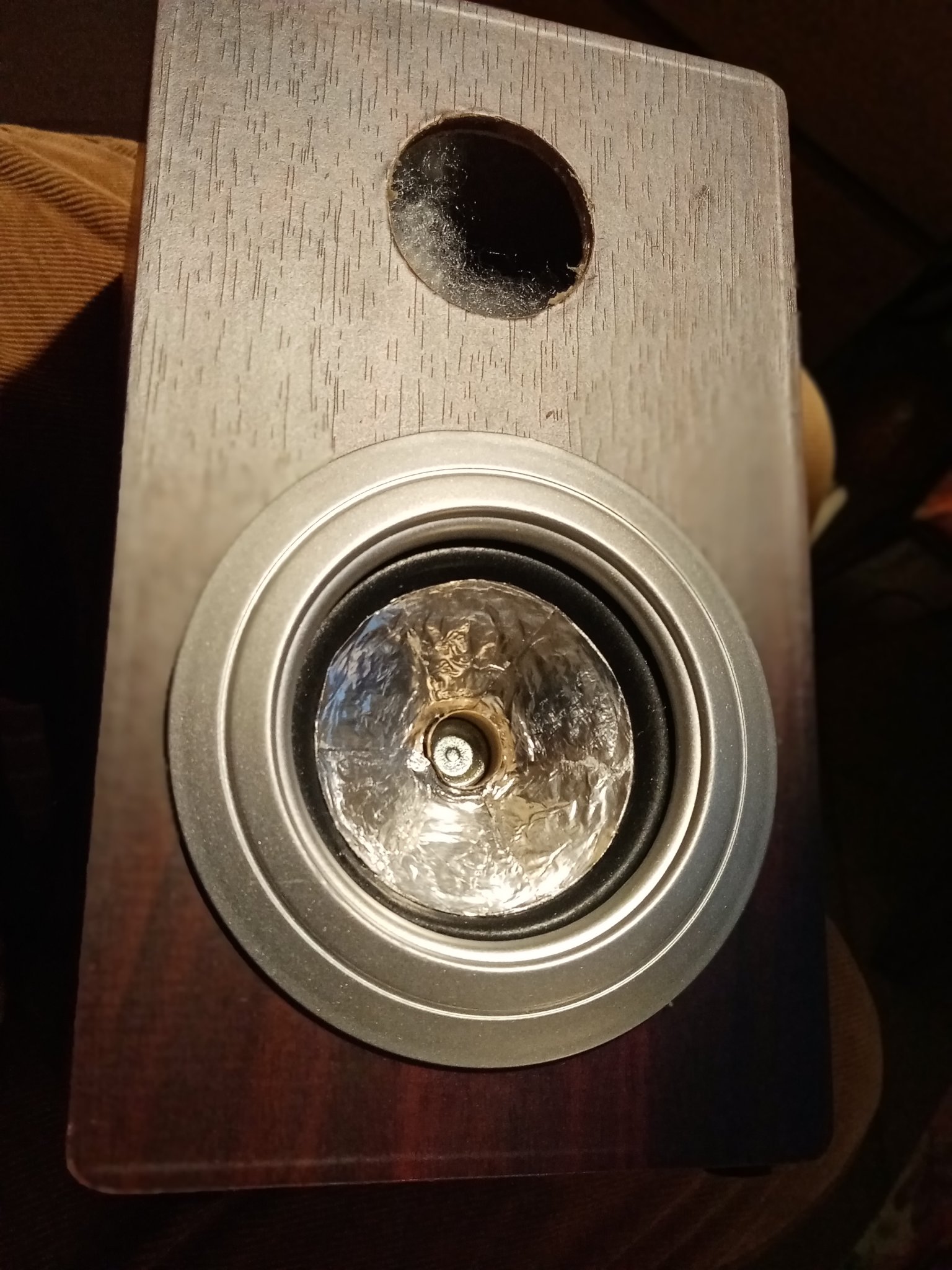

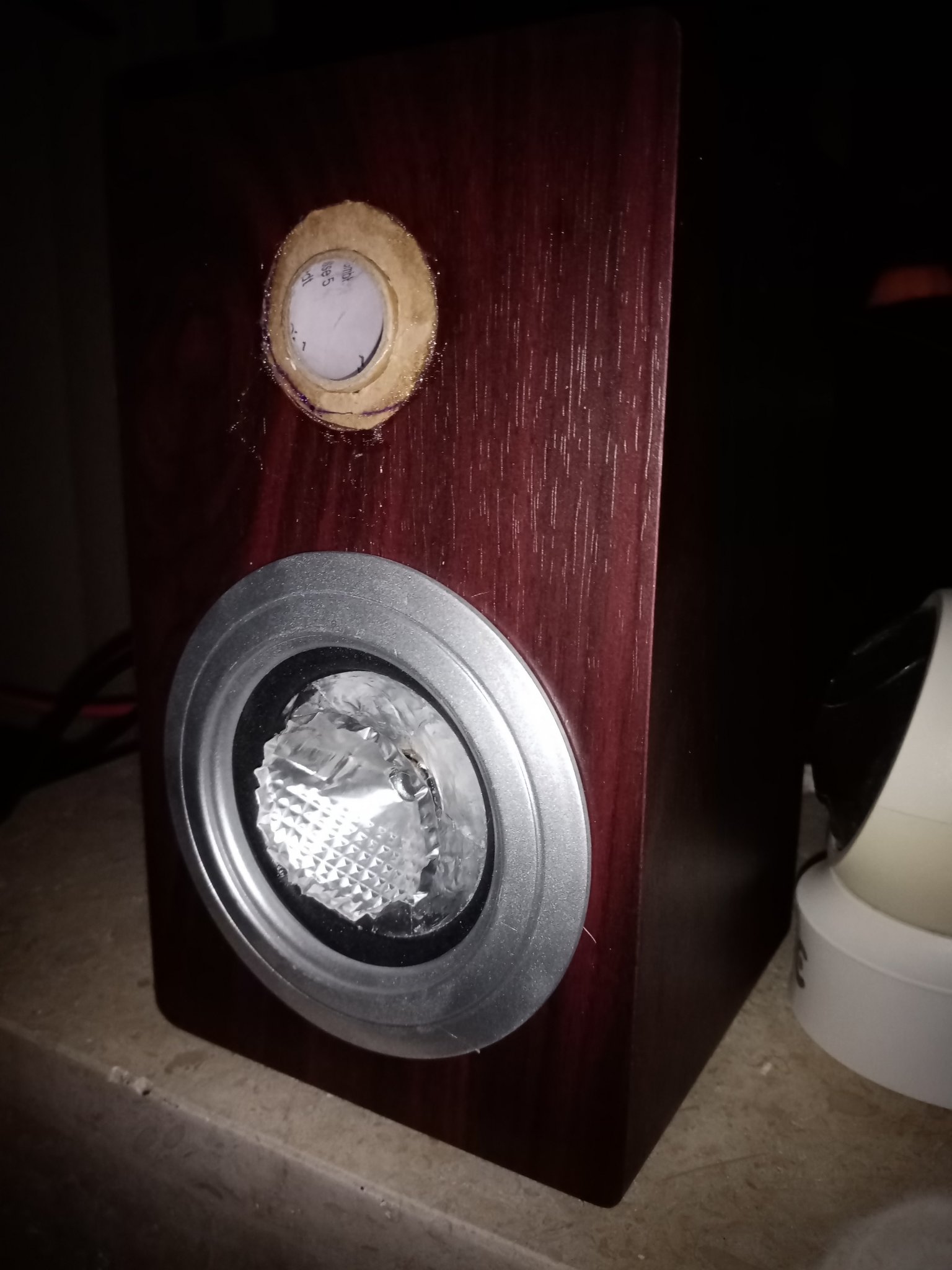

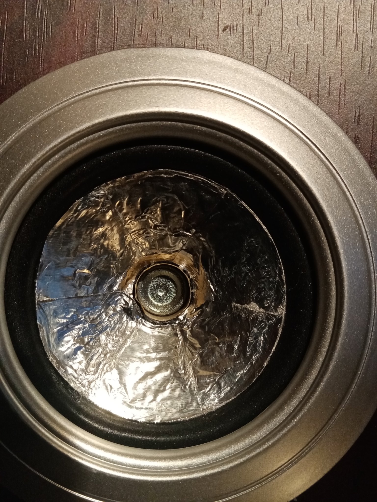

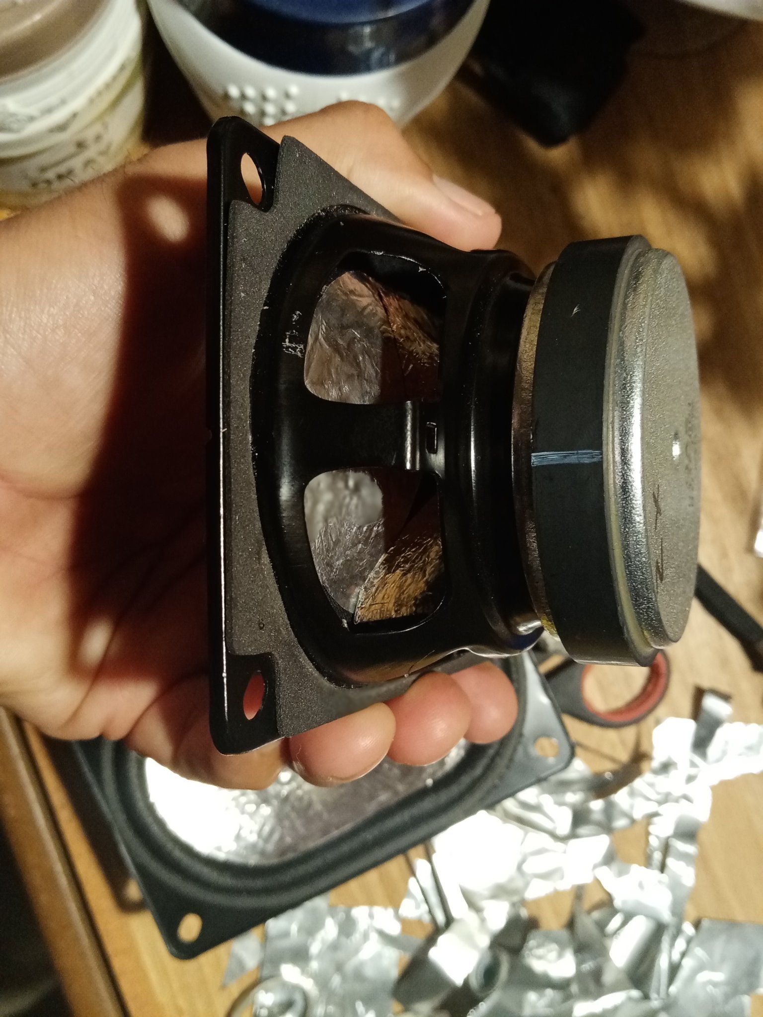

Metal foil tweak applied to a small Bluetooth box.

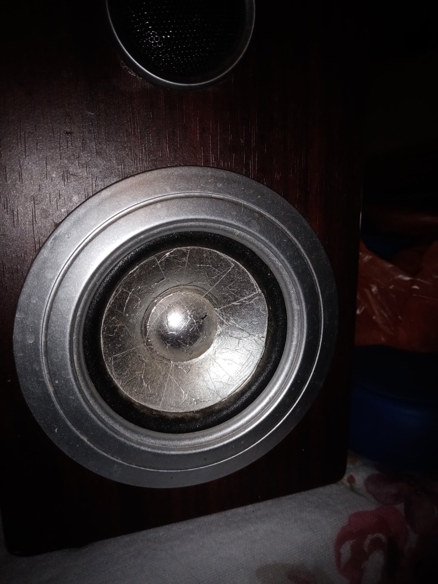

One box with thin foil from the gold Smith.
The other one with household aluminium foil.
Sounds different: Clearly the driver with the thicker foil sounds more correct.

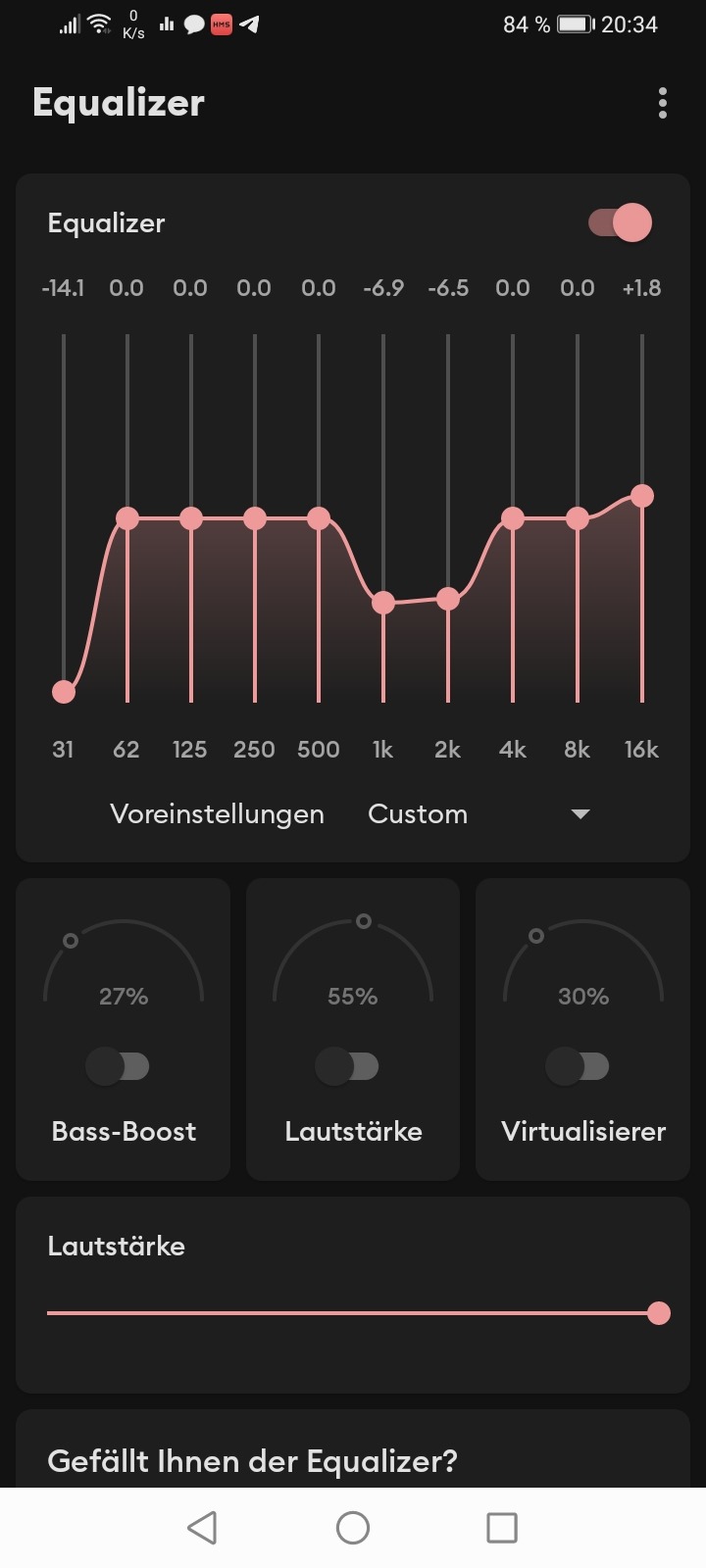

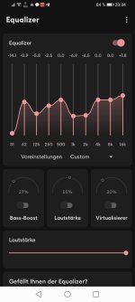

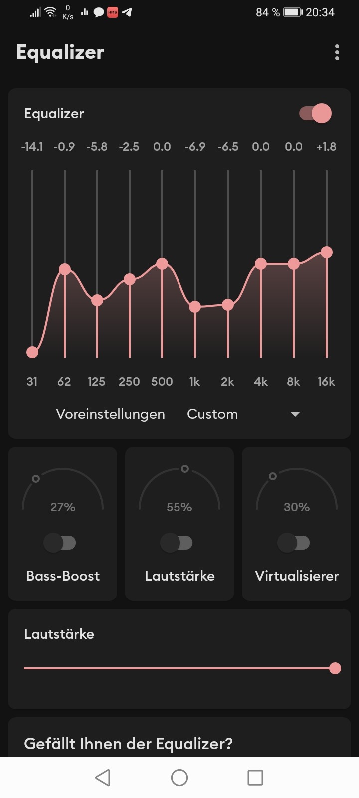

With added diy whizzer / double cone I apply smartfone app EQ with 1 and 2khz reduced by 7 decibels for linearization.
Added inside damping material and added bass reflex pipe. Original was no damping at all in the box and closed box design.
The box can be also EQed for close to floor and wall placement (reduced 250 and 150hz. For real corner placement the bass can be reduced even more.)
