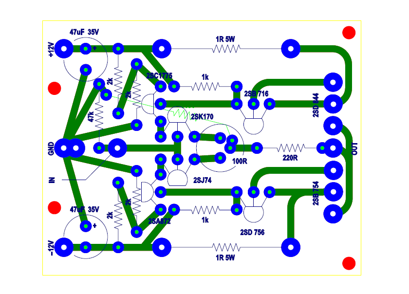

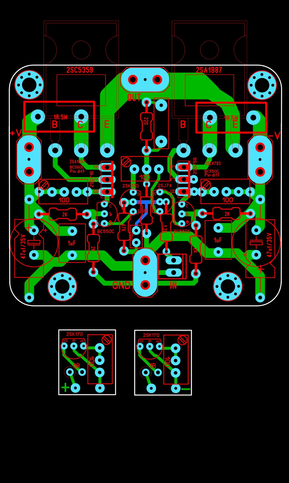

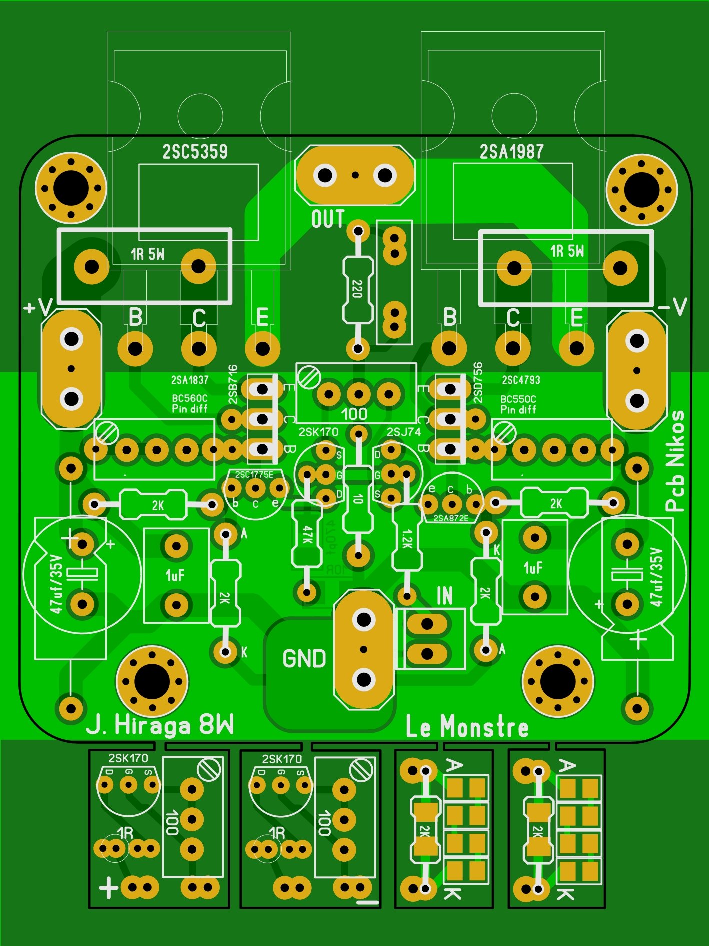

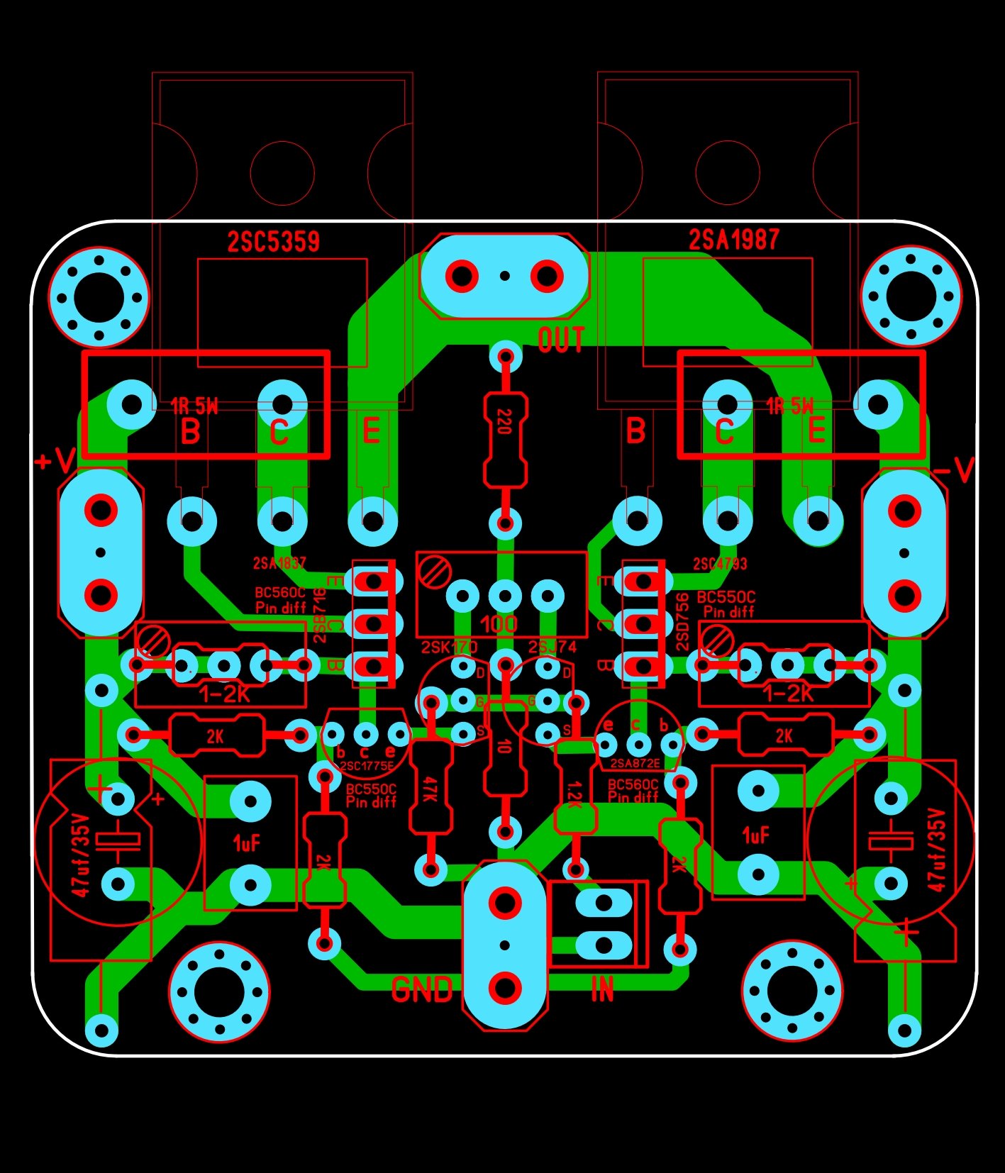

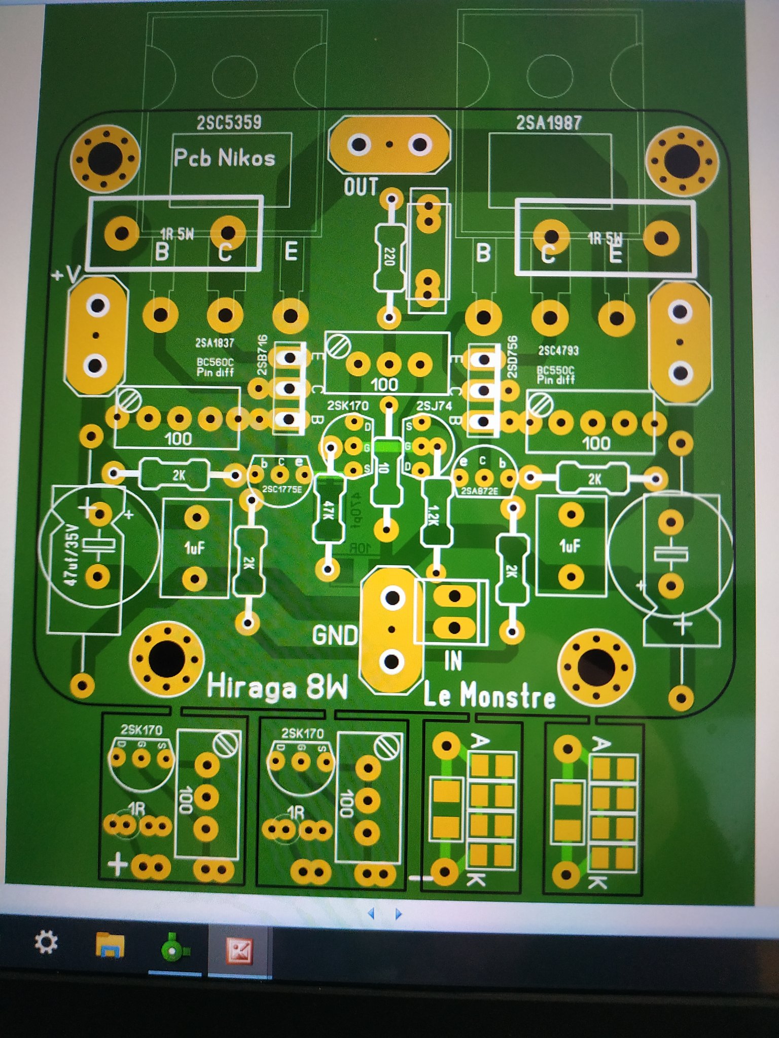

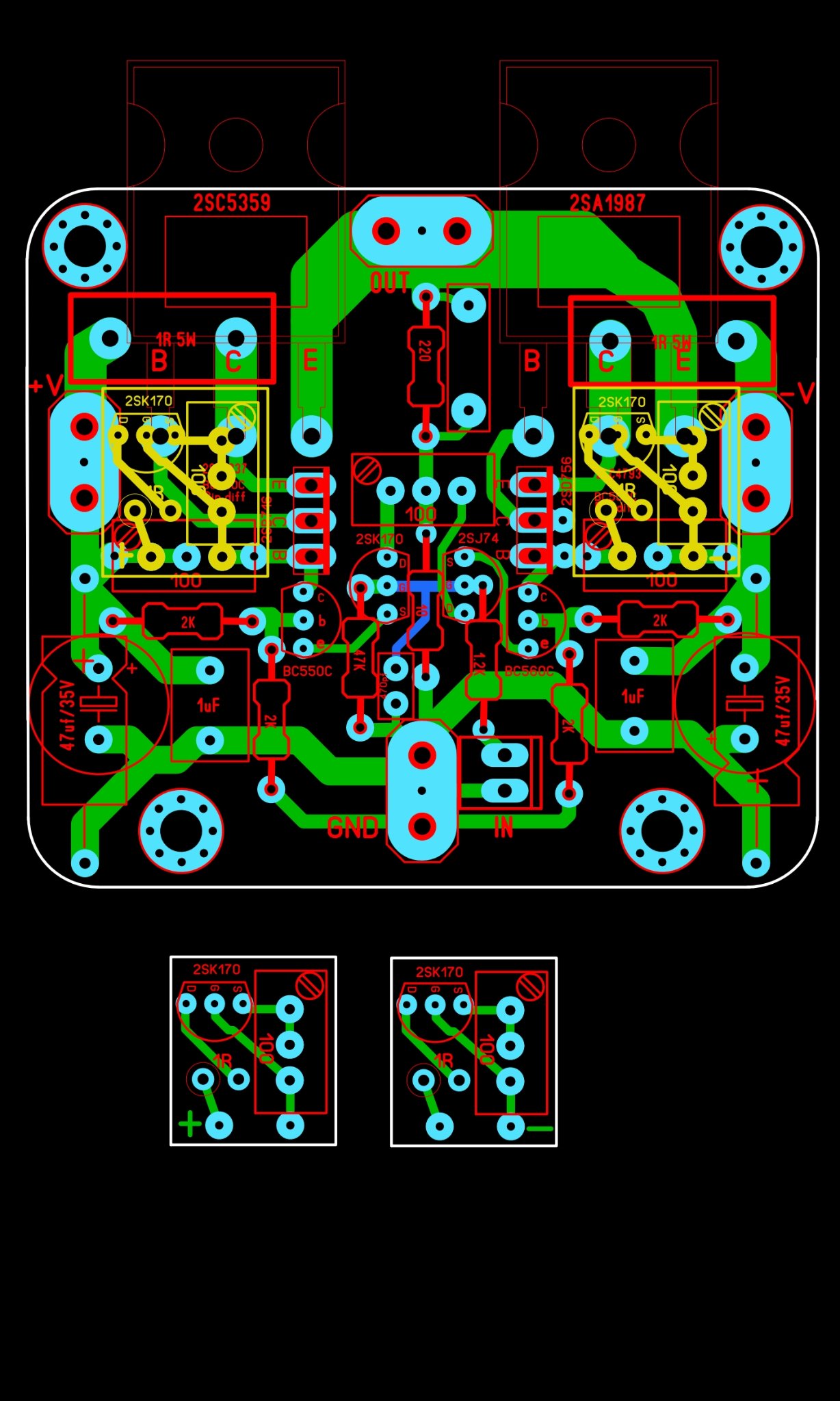

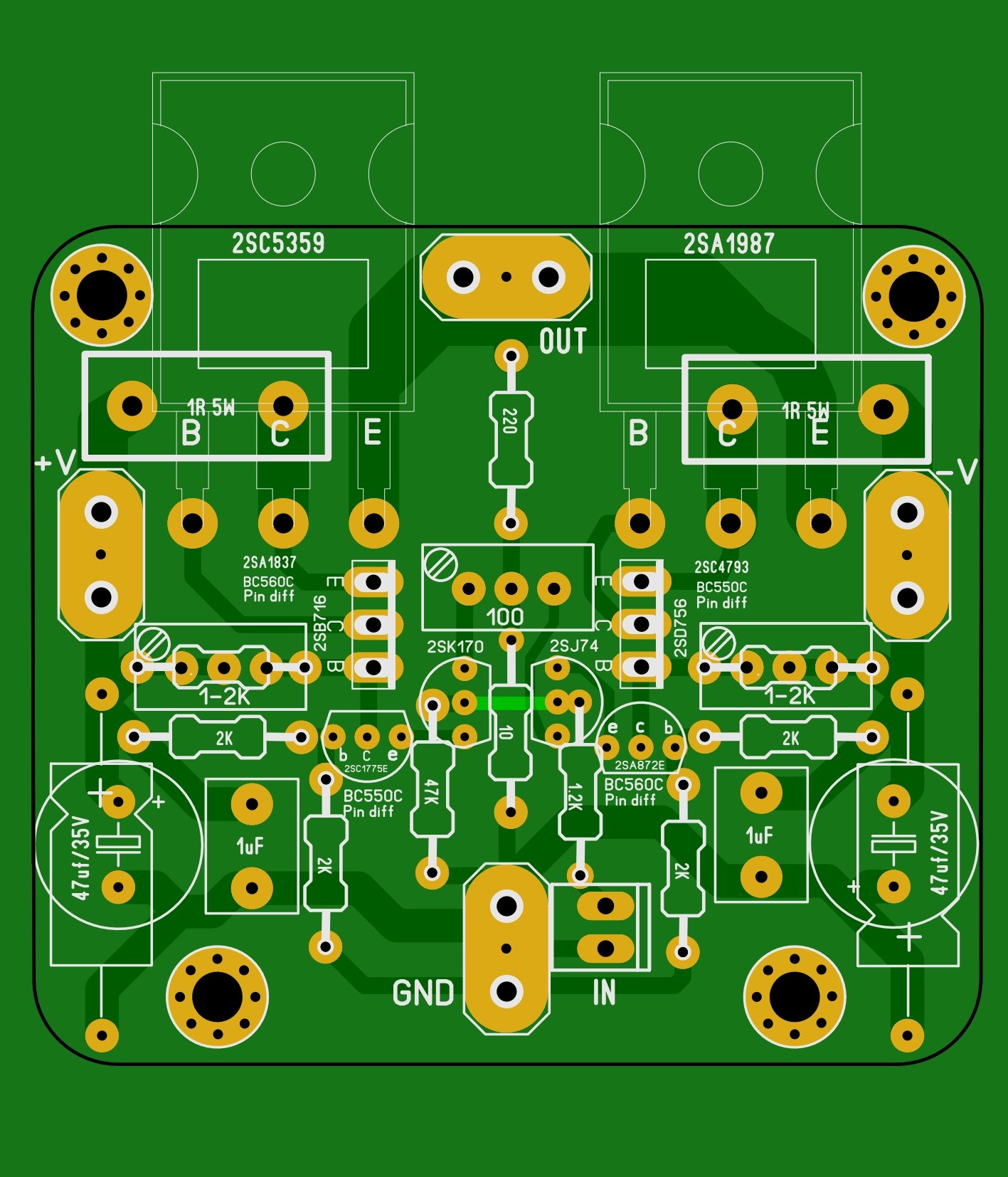

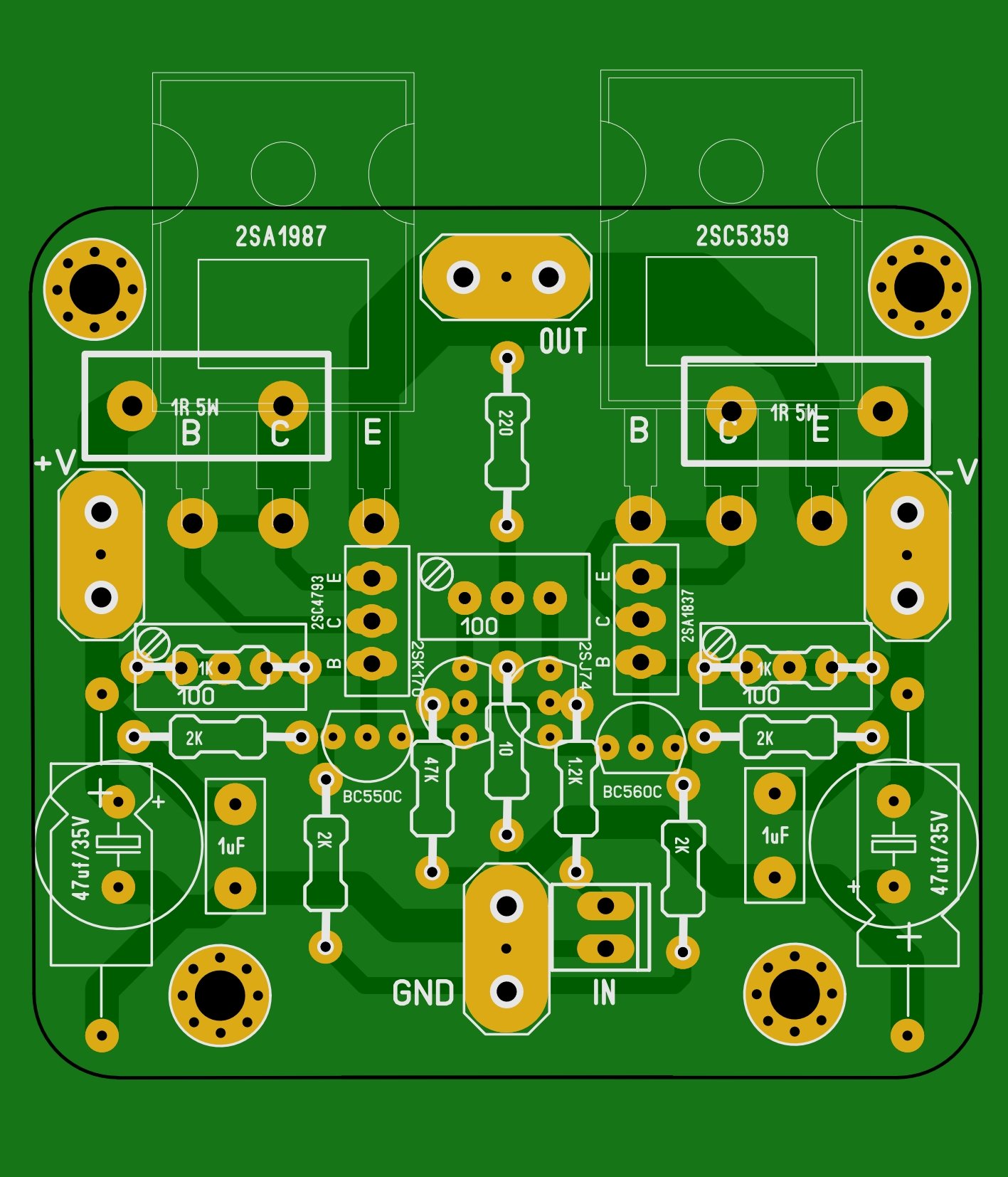

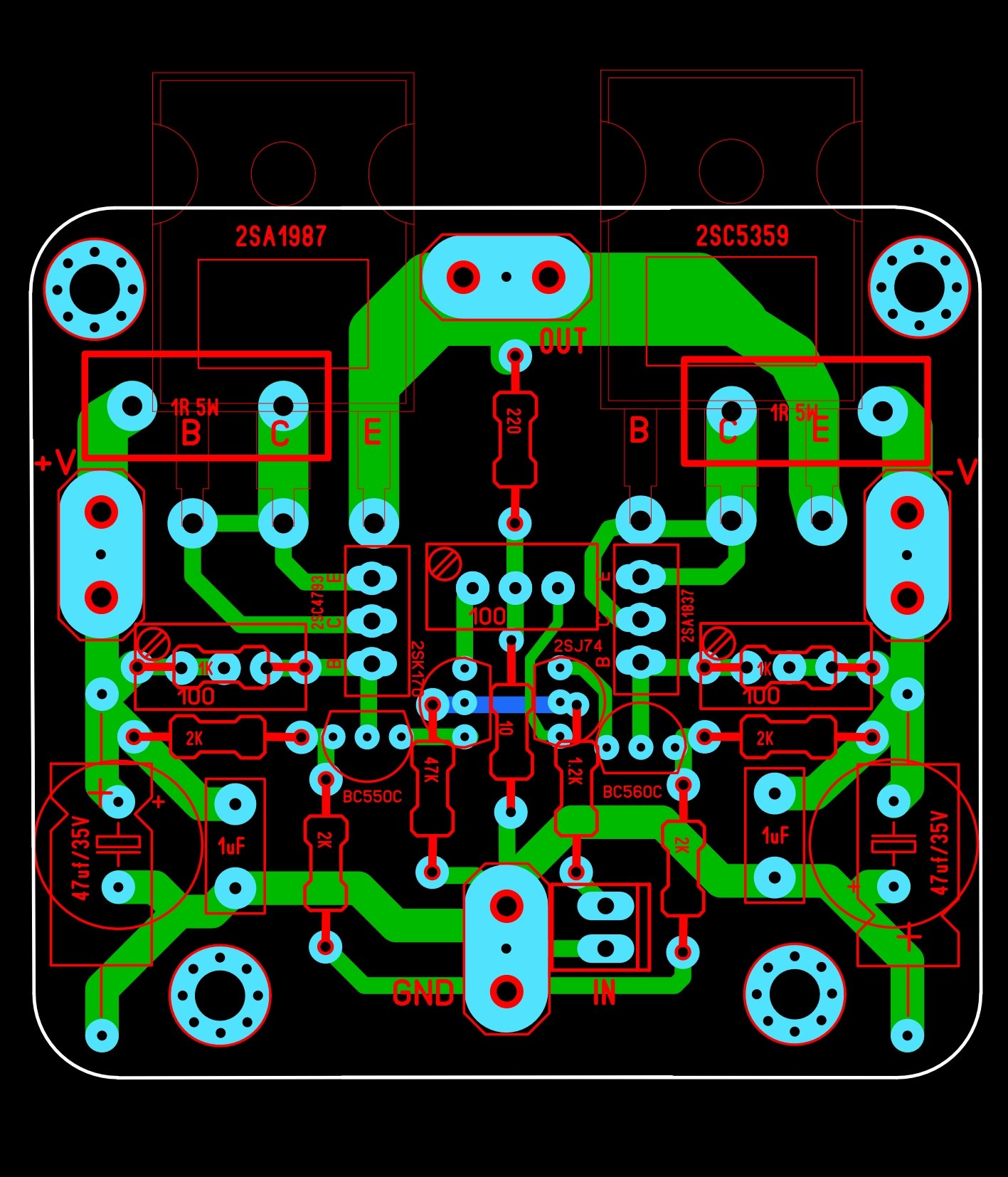

Hi my friends
here my pcb Hiraga 8W untested....
and the other pcb with the jfet gace to face but double layer.

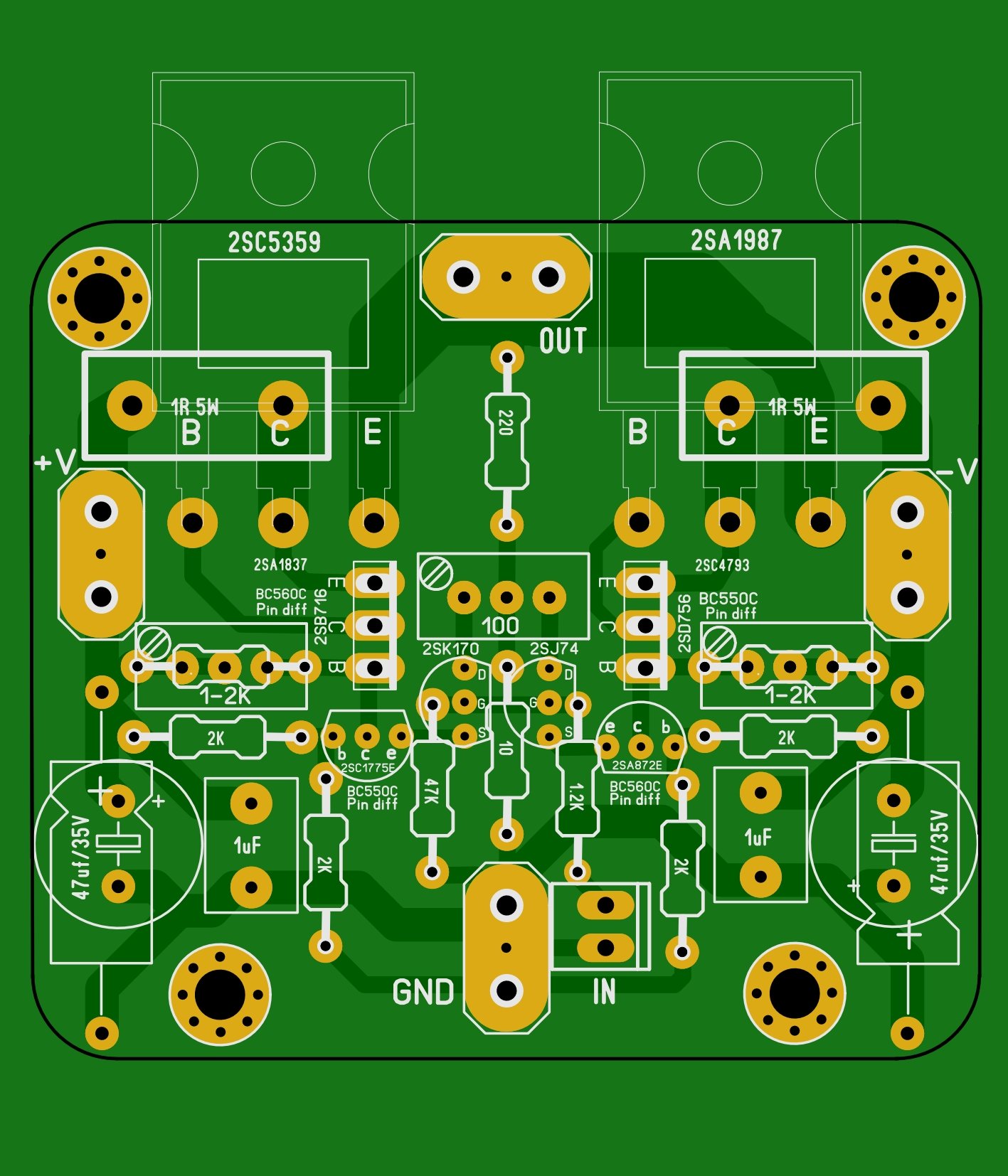

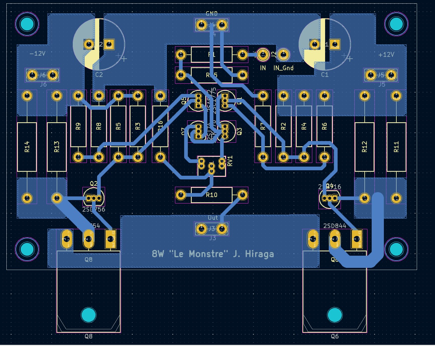

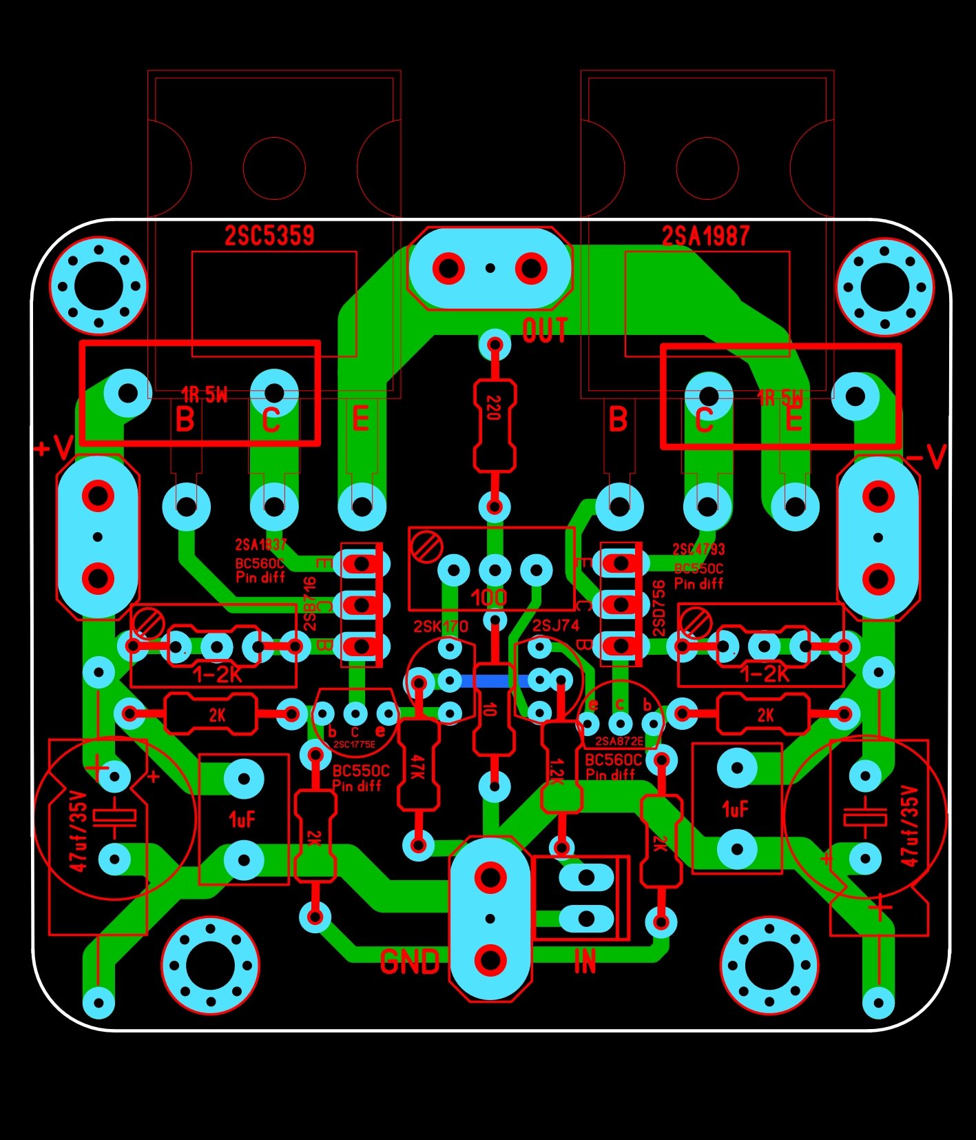

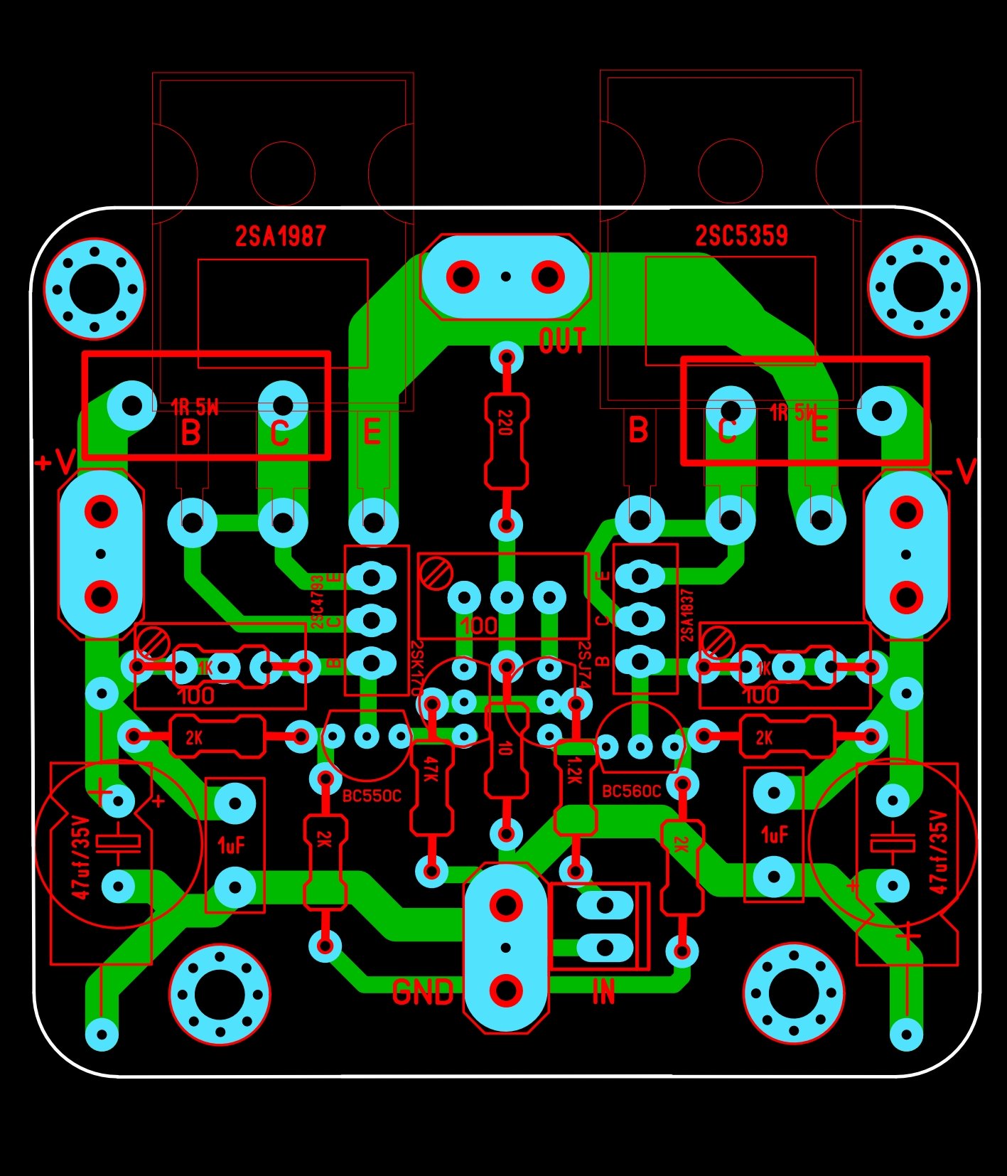

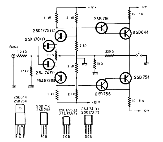

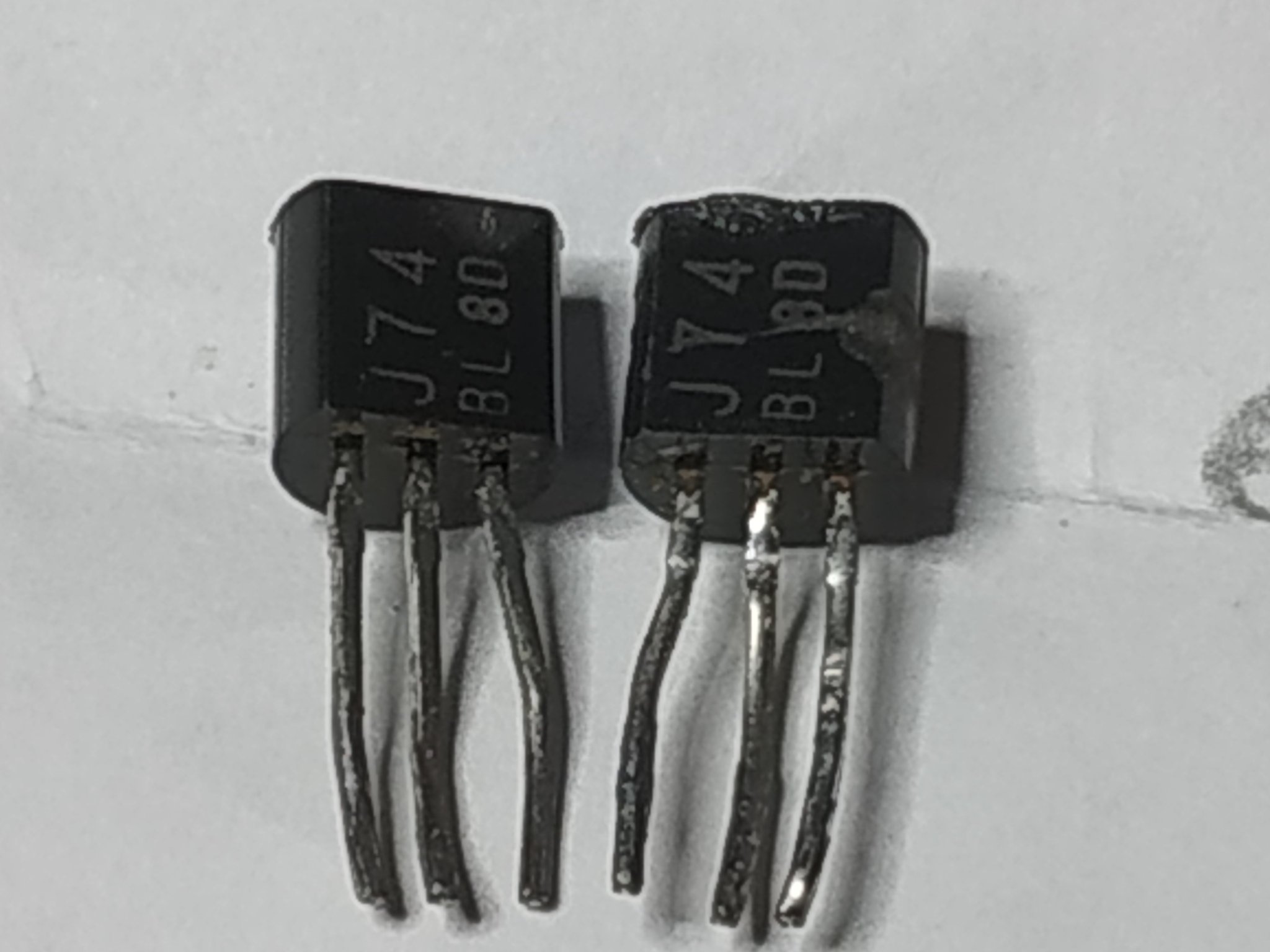

Hi ,...after good check .
Dimensions are 56mm x 50mm
I haven't read many posts about this amplifier.
Could someone please let me know what about the bias ?
Has anyone built the schematic below?
and what combination of transistors can we use?

Hello Nikos, bias should be between 500 and 600mA. That will be a challenge if you use 2SK170 / 2SJ74 in the BL range, range y ist not realy existent, but GR is available and should be used. Matched to a IDSS as low as possible, if you manage to be around IDSS 3mA the 1k R has to be reduced to about 750R. Better to read a lot about this little amp, very good but there are some challenges while building.
Many users have a bias of 1A and more, the sound is not to my liking.
Reactions: Nikos
Hi thanks for your responce.
it will be a challenge due to high IDSS ? My fets idss = 7.4ma 2sj74 and 2sk170 9.6ma
Would you like to be more specific?
VR100 is only to balance out the offset.
R3 / R4 need to be changed to alter bias. Higher value means higher bias. Take a higher value for the potentiometer across R3/R4.
J1 and J2 should be selected for same IDSS, Original Monster has FETs grade y with IDSS of about 2.4 mA (9 V), but nobody has seen grade since 40 years. I use grade GR around 3.6 mA and R3/R4 around 750 ohm for bias 0.6 A, that means about 900 ohm for 1 A bias (only roughly estimated values)
Understand .....so in my case with fets BL idss 7-9ma must change the two resistors 1ΚΩ to lower value 470Ω?
Reactions: konst
Hello Nikos,
I don't like to me unfriendly but all of this is already writen several times in this thread, not only by me but also by others, just scroll 2 pages back.
IDDS of your Fets are not only way to high but also not matched, this will end in an offset, maybe you can compensate with the pot of 100R. But this pot does't alter the bias, only offset.
If you have problems with the Fets (to find some) please contact me by PM
Sometimes the amp oscillates, this may be solved with 47 nF over 200R fedback.
It's highly advisable to read this thread, there are so many information to avoid frustration by building this nice little amp.
Reactions: hbtaudio and Nikos

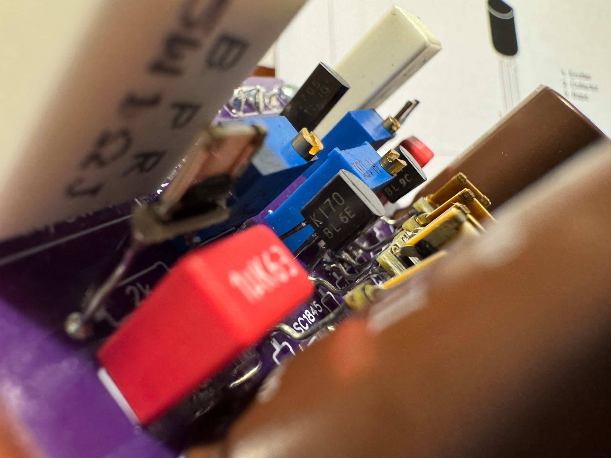

Yes I did use z-foil resistor. You can see them in the picture attached.
The difference is in sound quality. It is more precise and more detailed. Of course, this is not only the advantage of using Z-foil resistor. You must also use the other components as close to the original as possible. And make sure they are the original.
