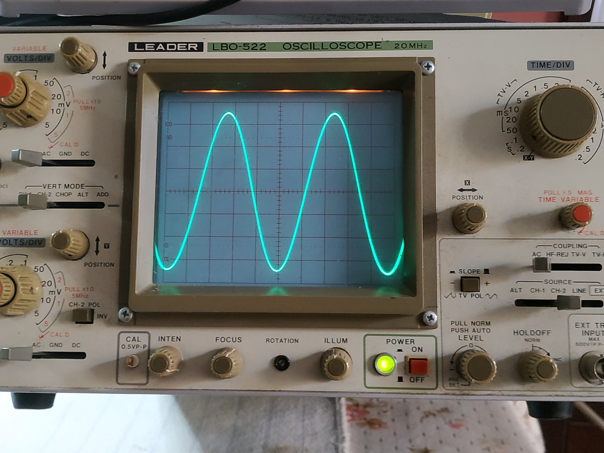

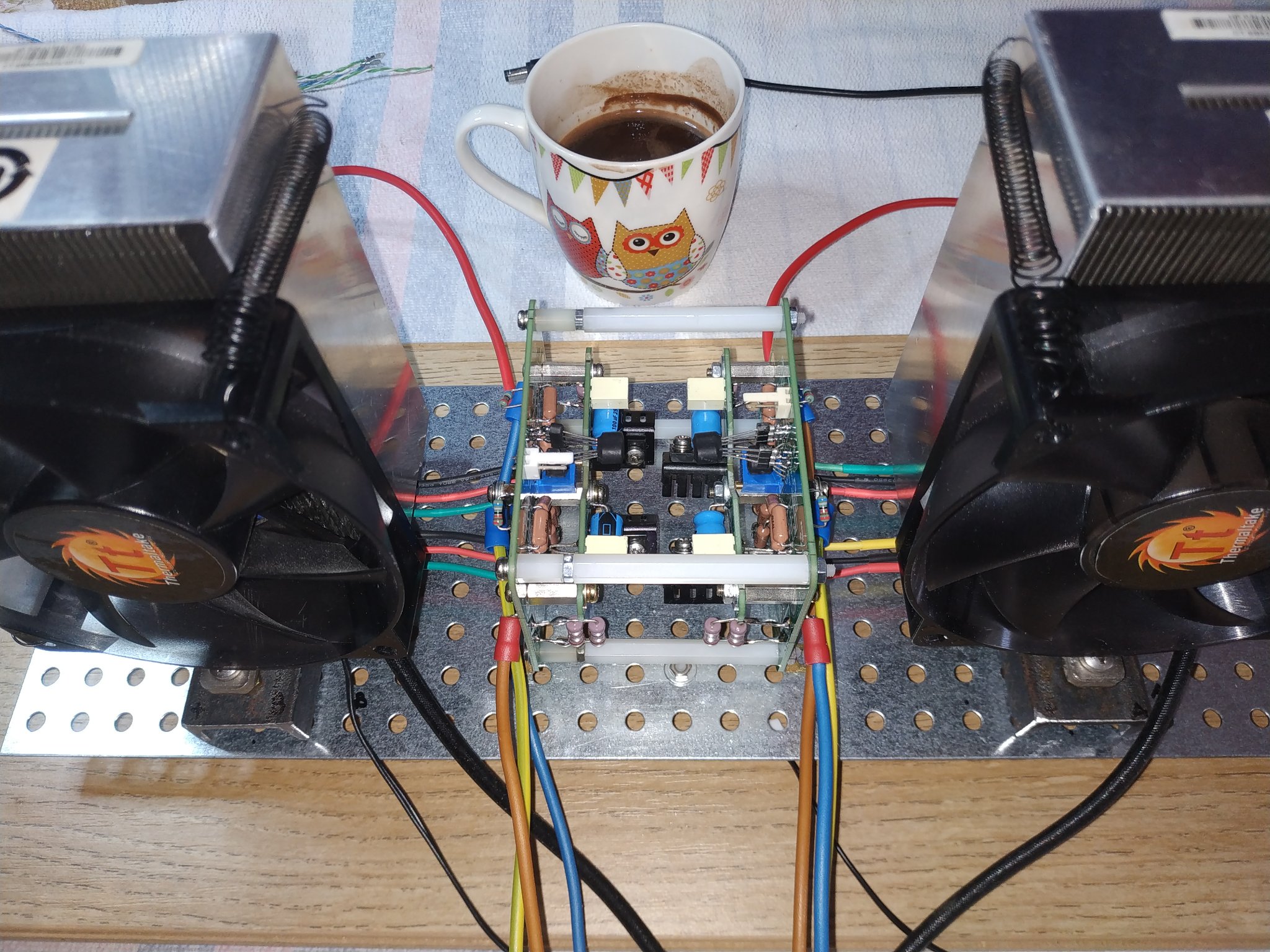

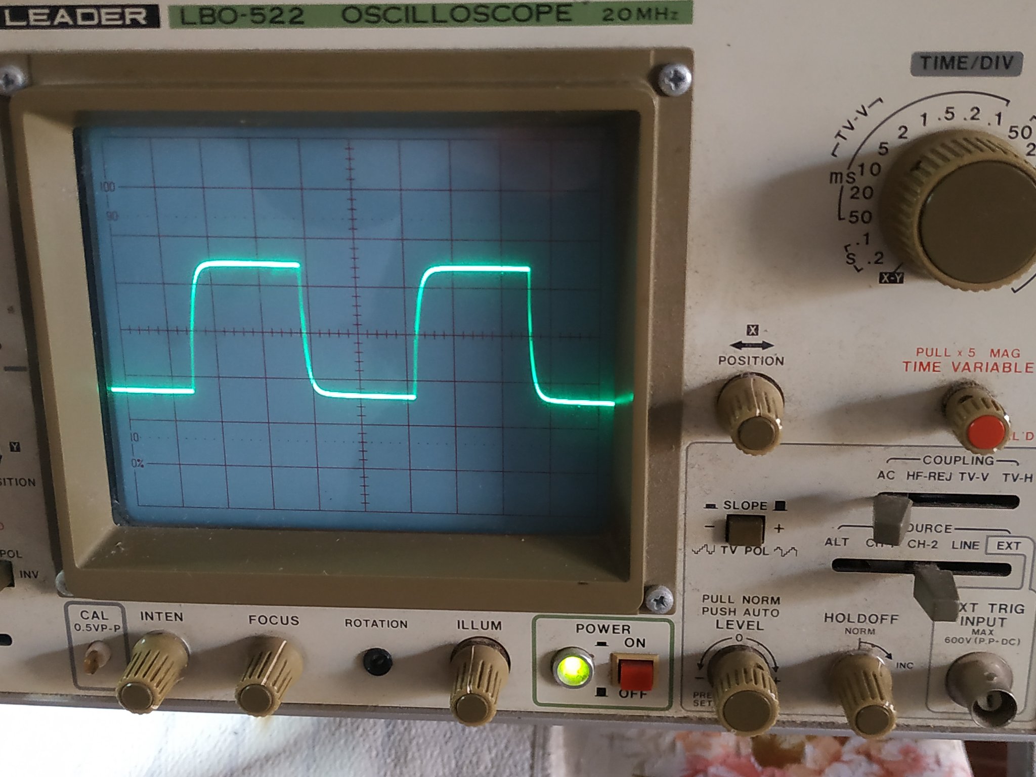

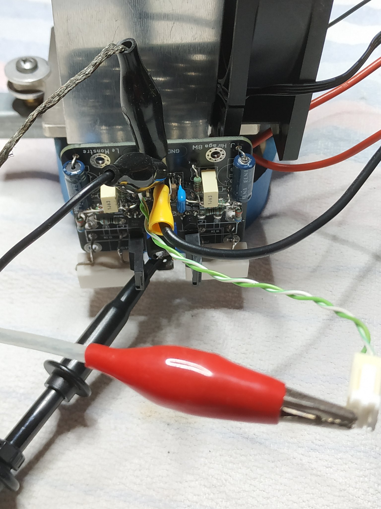

Hiraga "Le Monstre"

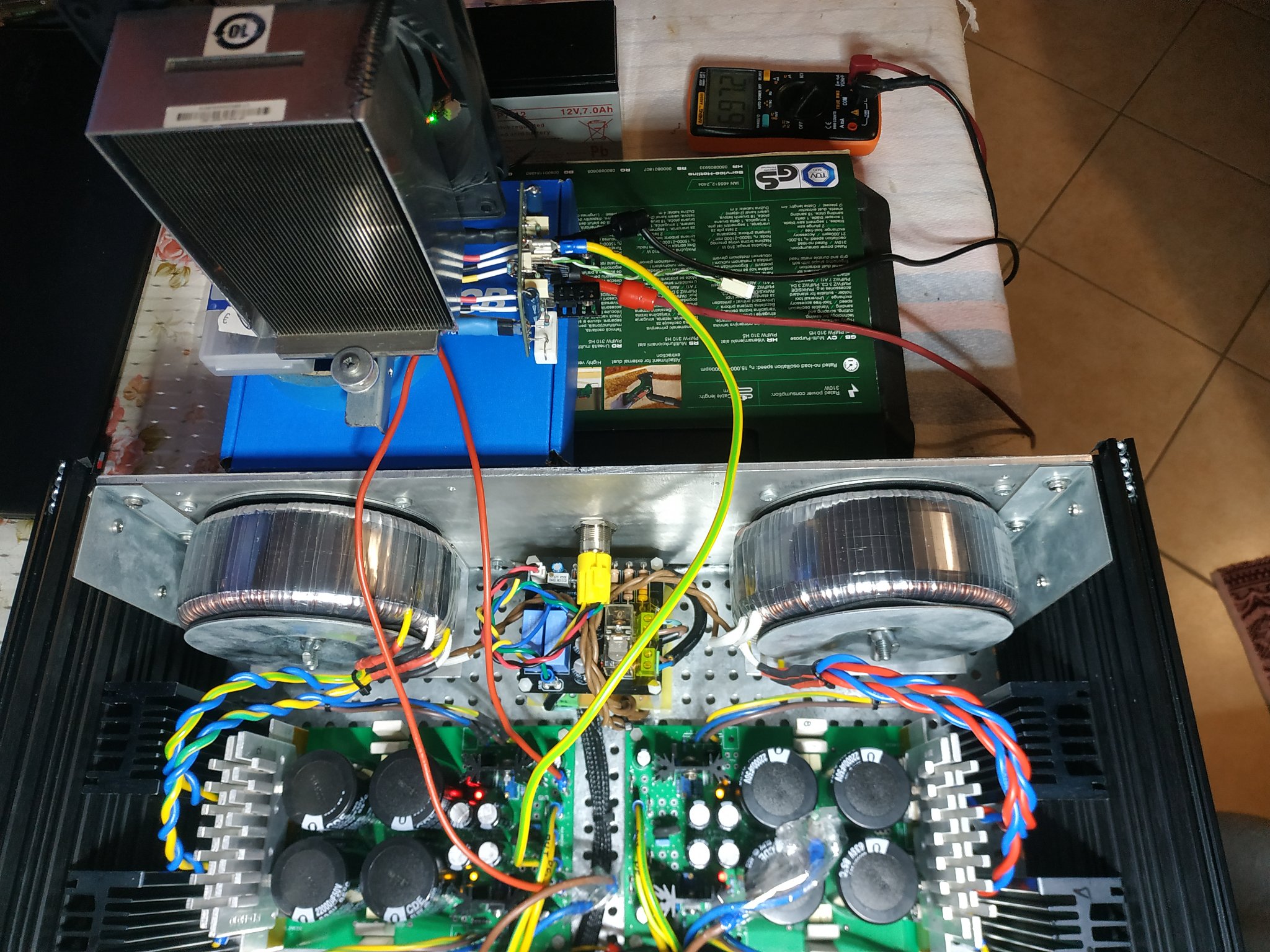

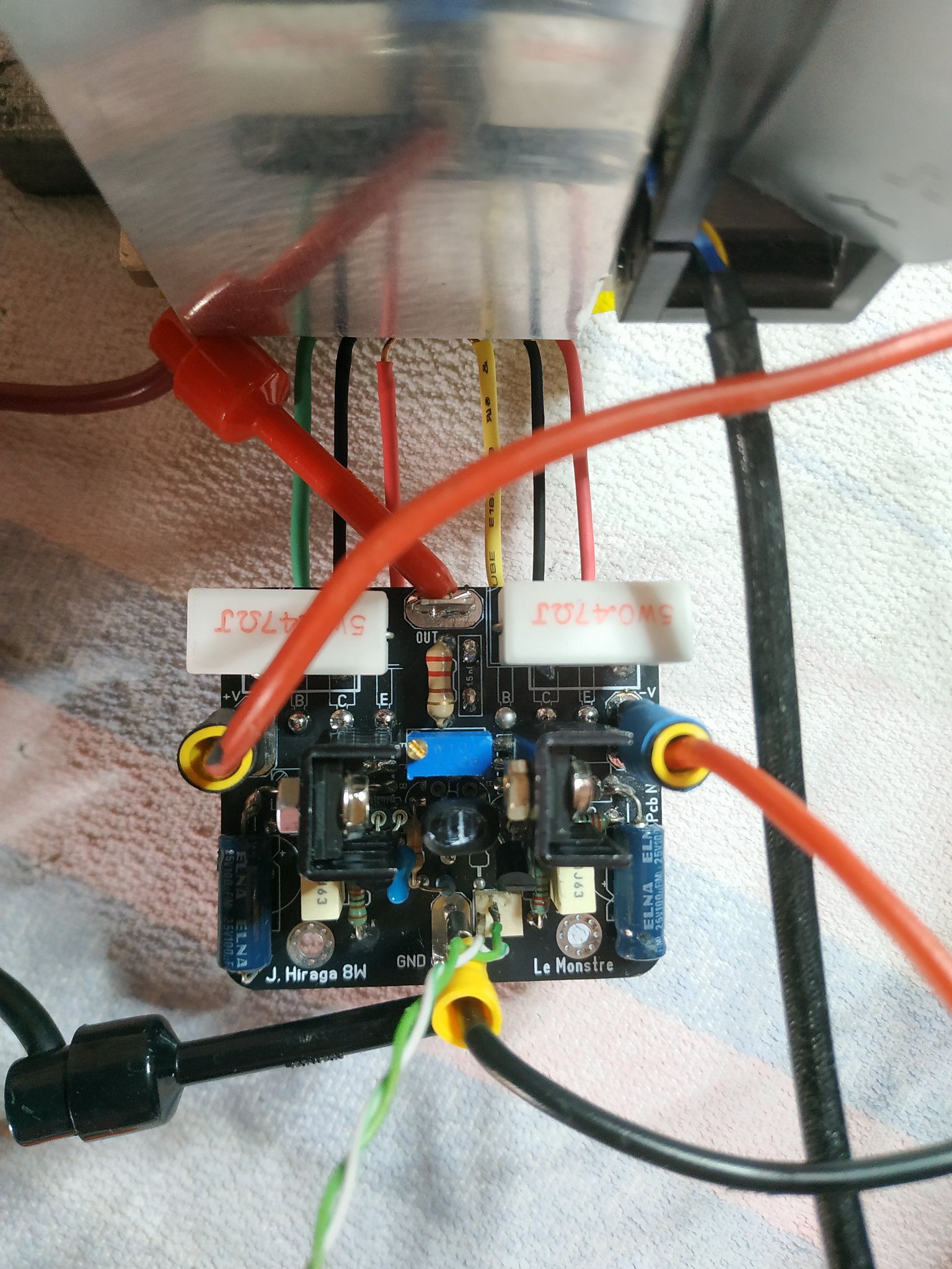

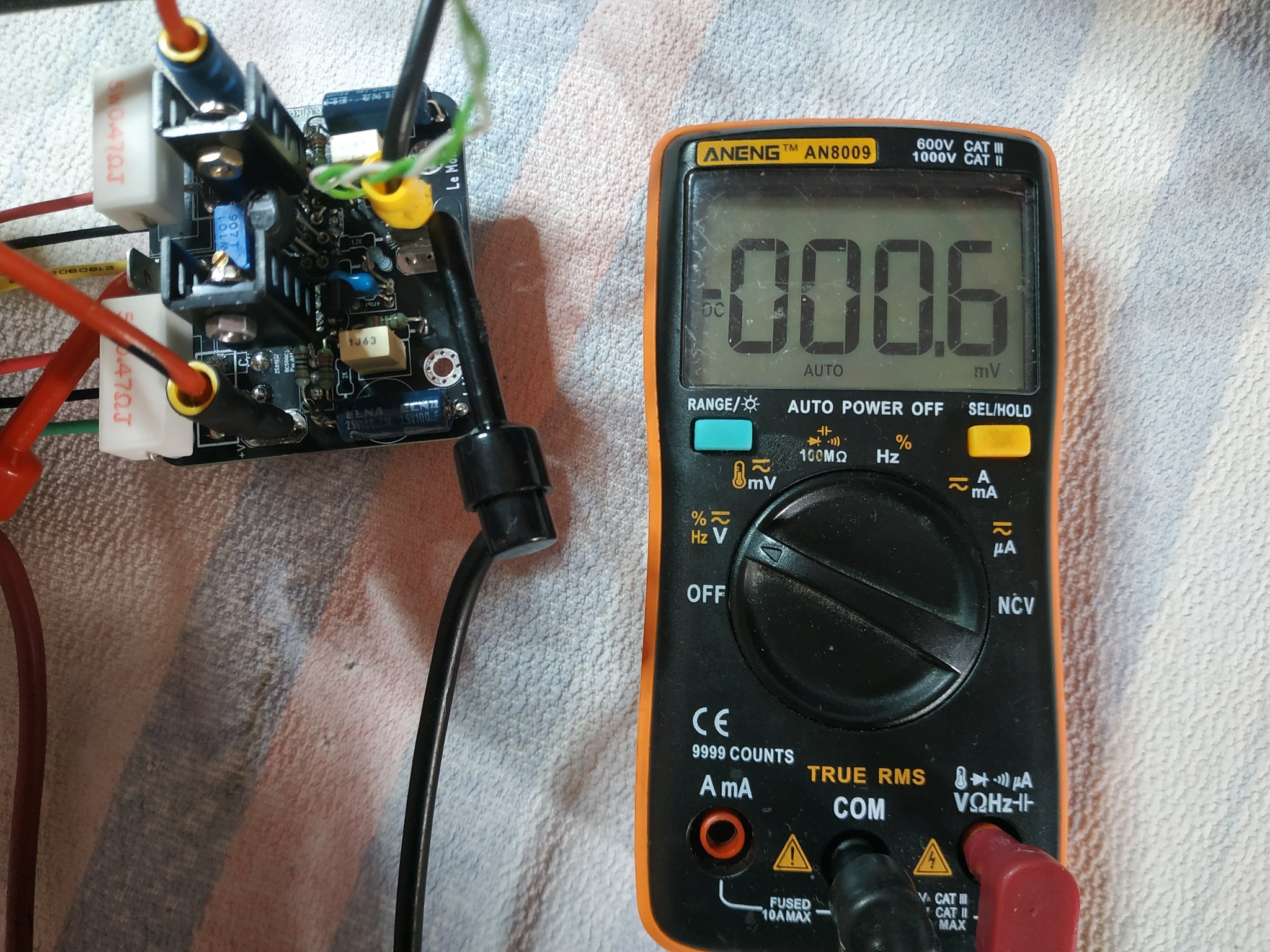

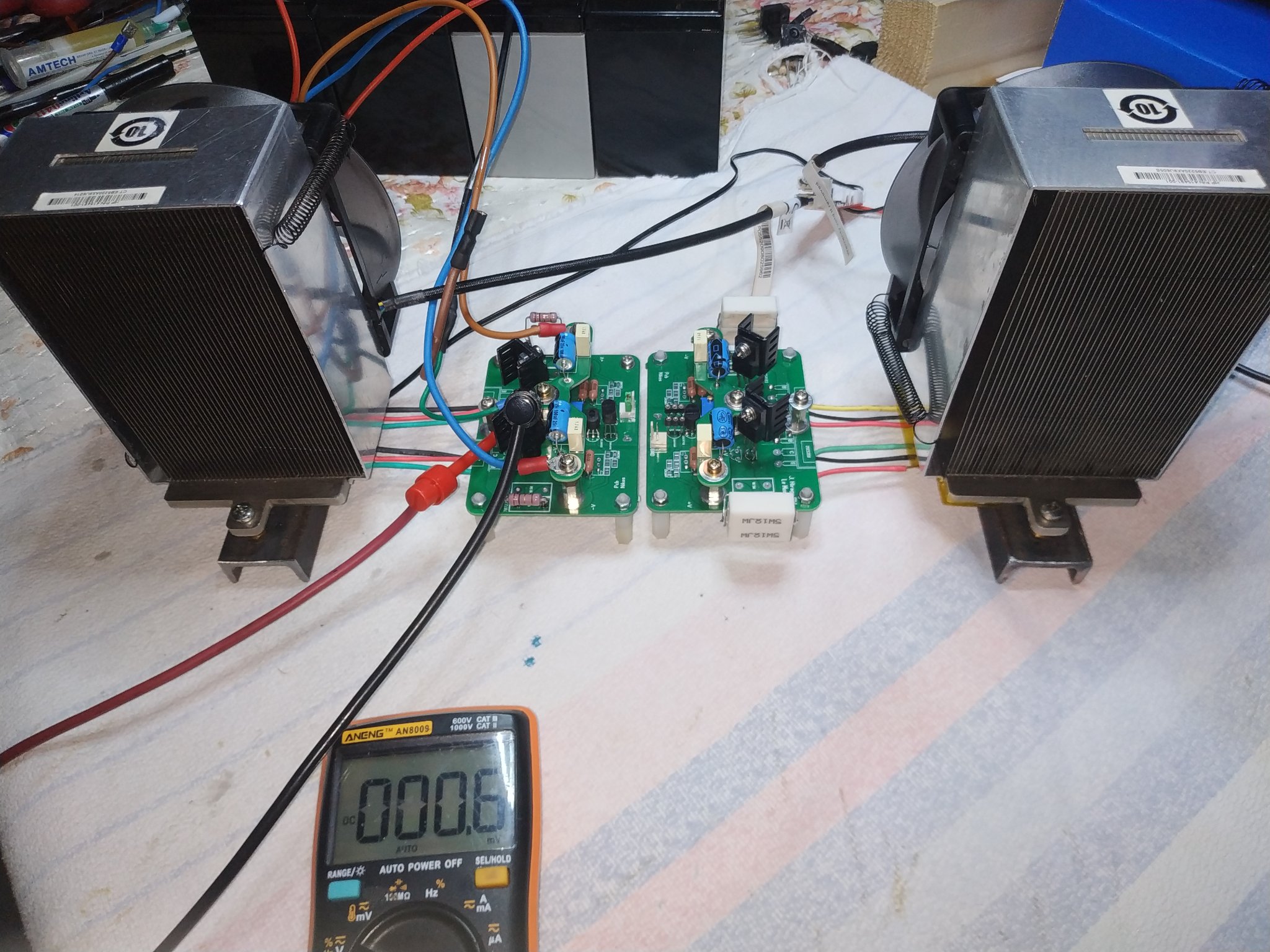

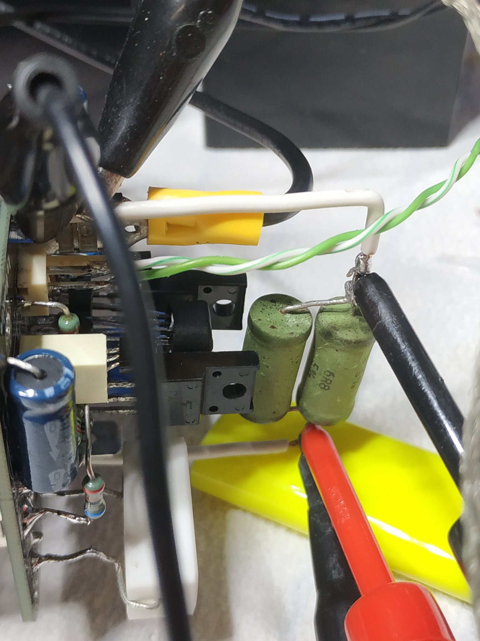

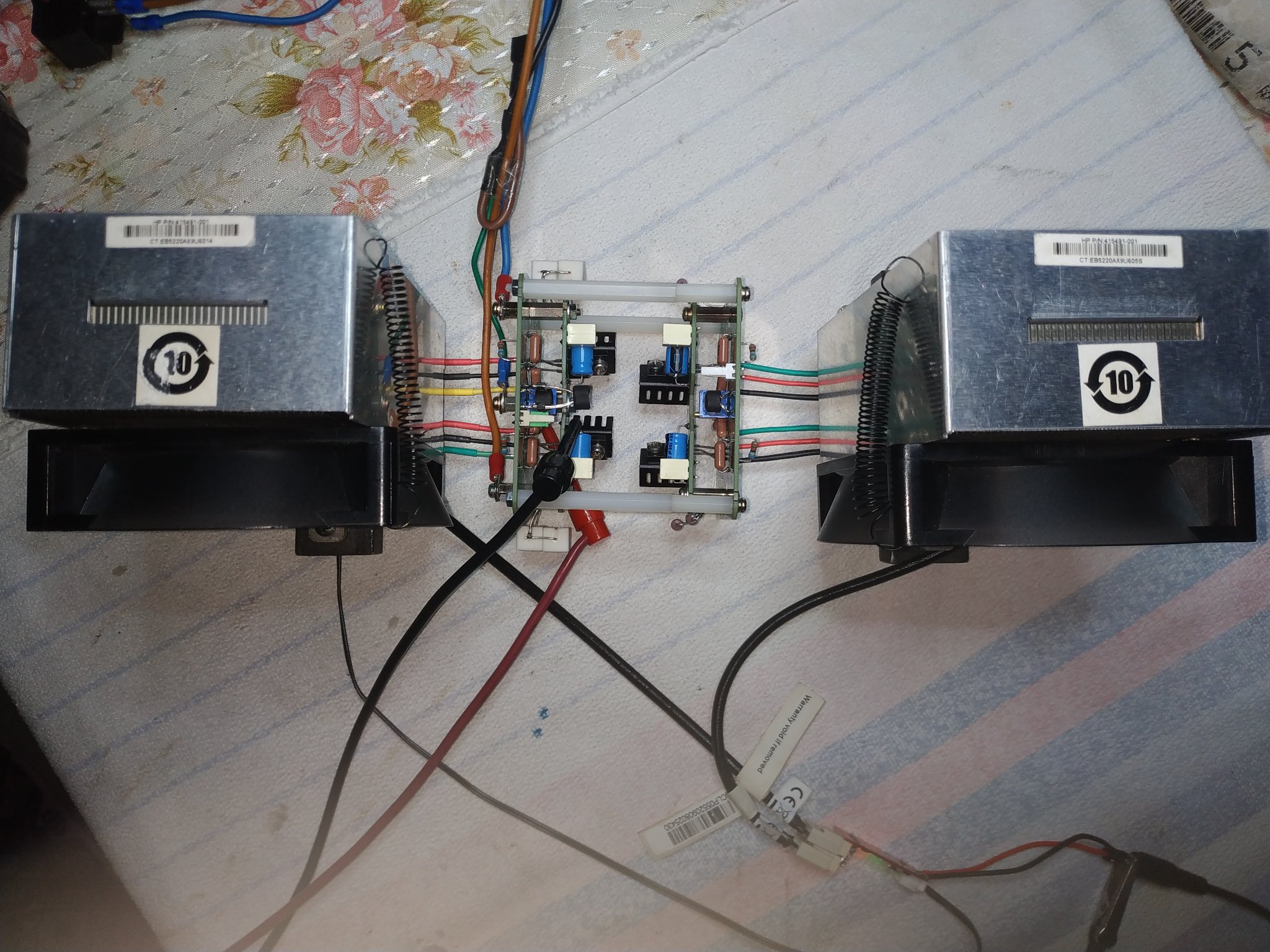

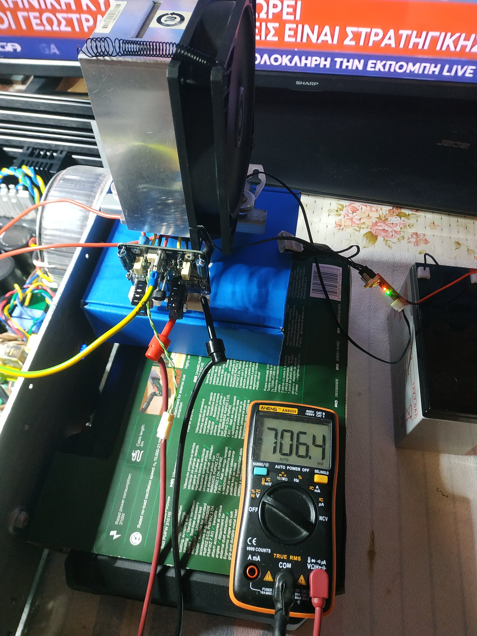

Finally setup for 4Ω version
+/- 22-24V
330pf input cap
Bypass resistor 68k
On 1k res cold 1.20V -1.34V
0.47Ω resistor bias 730 -750mv about 1.6A
220 -20Ω gain resistor
Offset +/- 2 mV
Trimmer 53-48 Ω
2sj74Gr -2sk170gr 3.0ma idss
Cascode 1845-992
Drivers 4793-1837
Output 1987-5359

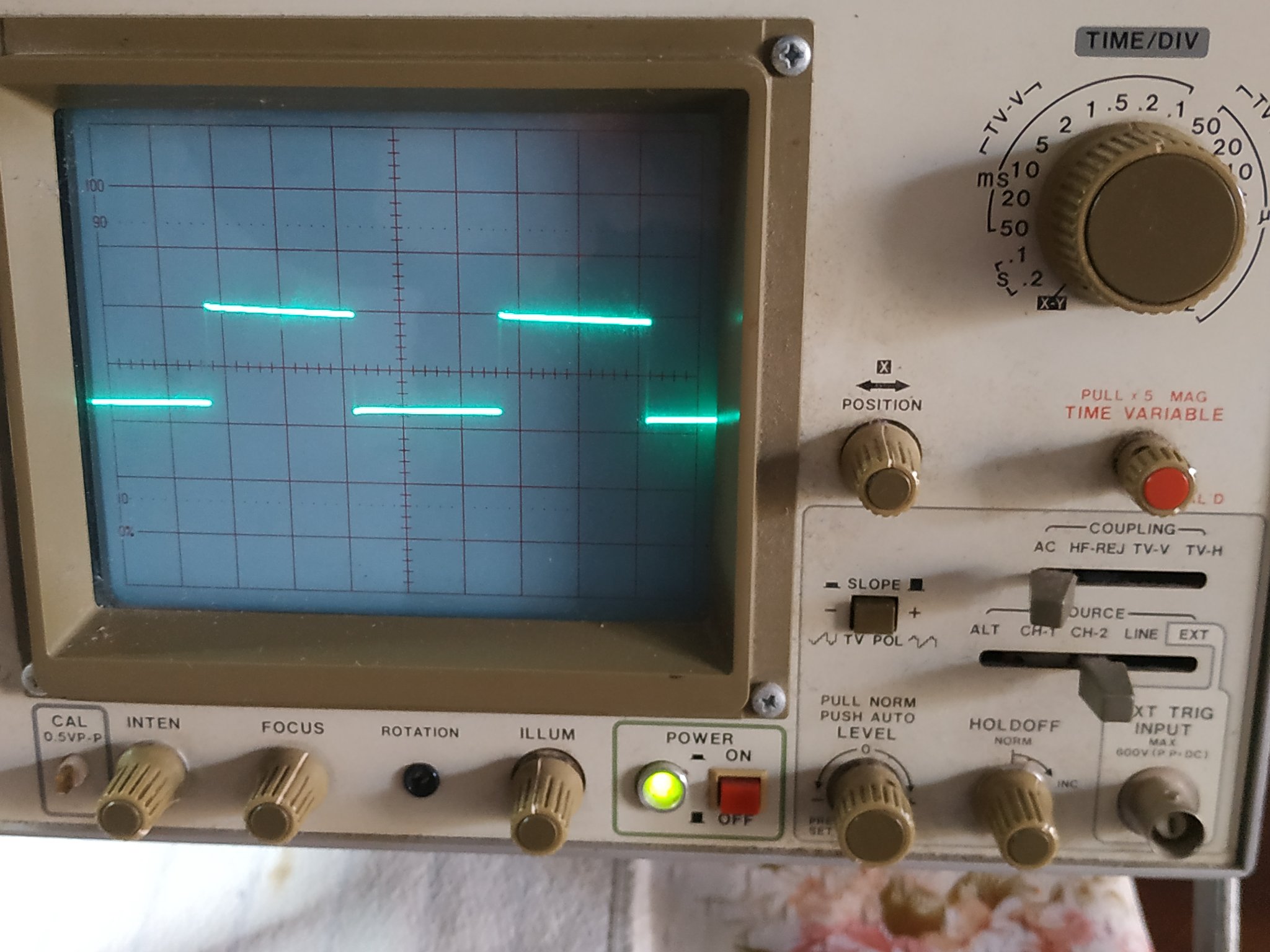

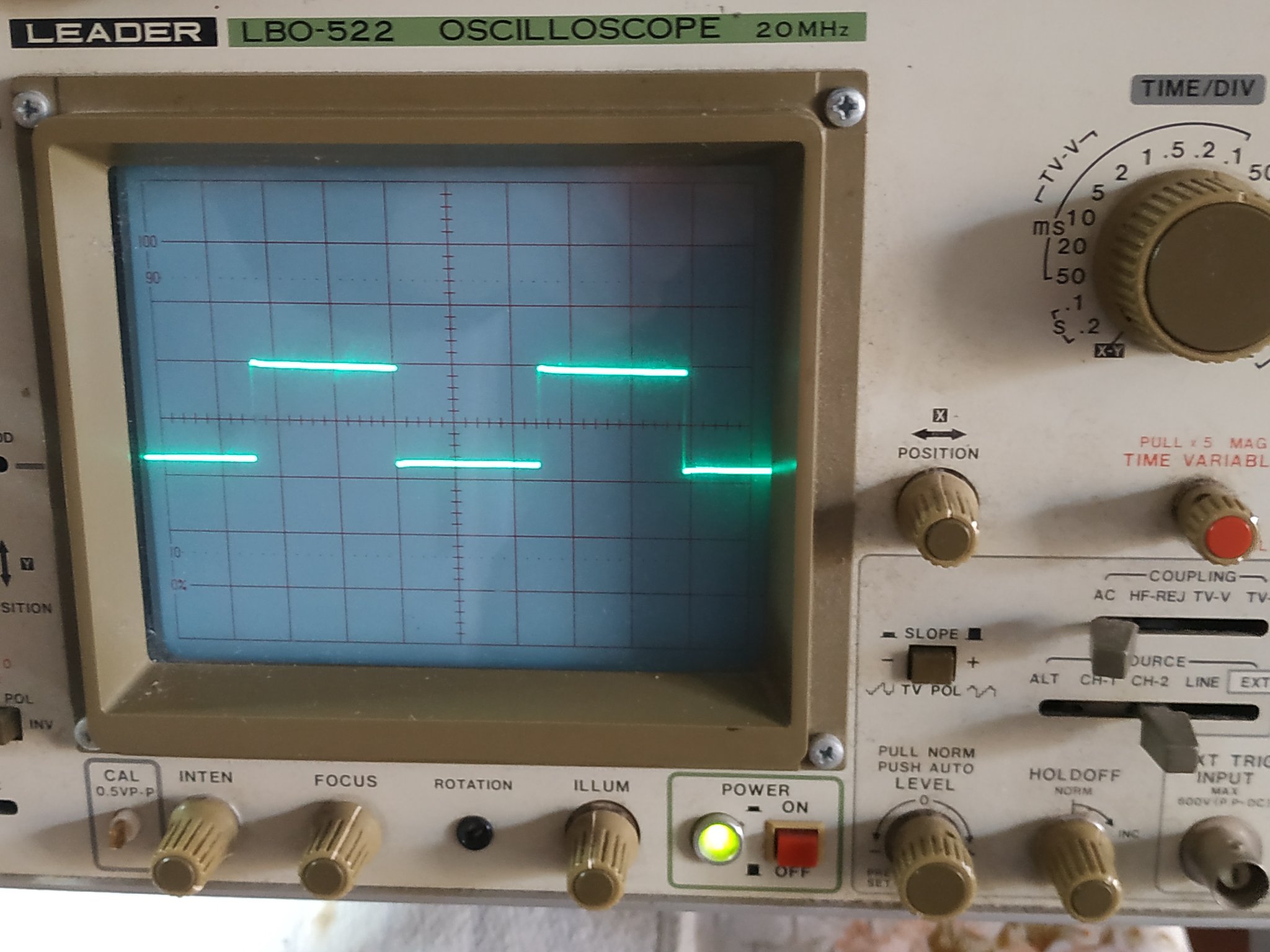

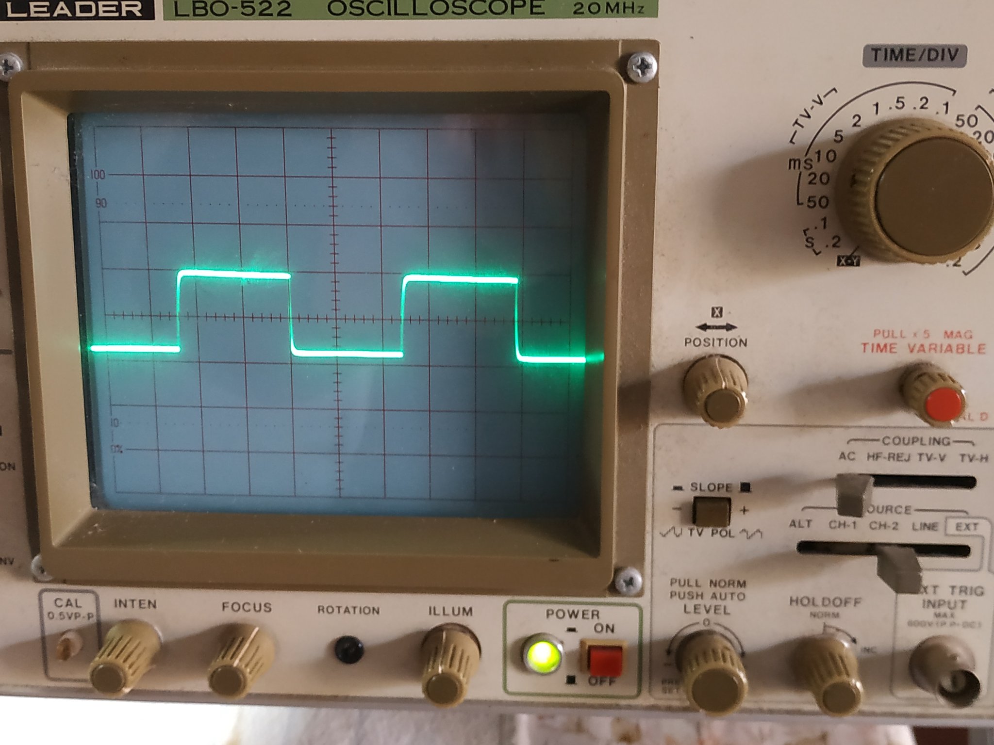

1khz 10khz 40khz. Square wave 1khz sine wave before clip.

Test with load 2 X 6.8Ω parallel.
What made a big impression on me is the square wave at full swing It remains rock steady until clip.I can't wait to hear it, this little Μonster seems to have a lot of promise.

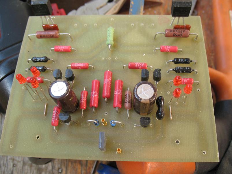

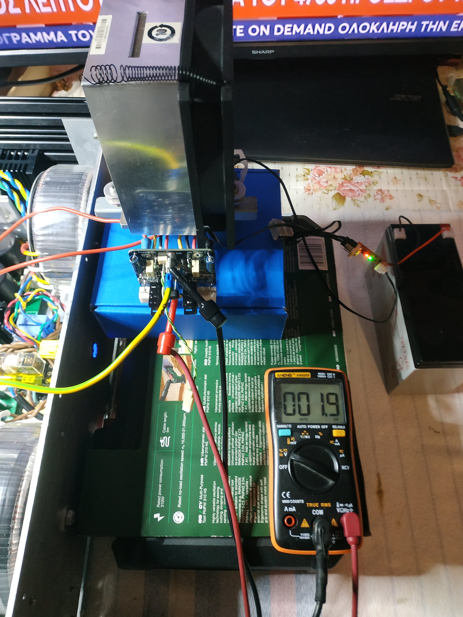

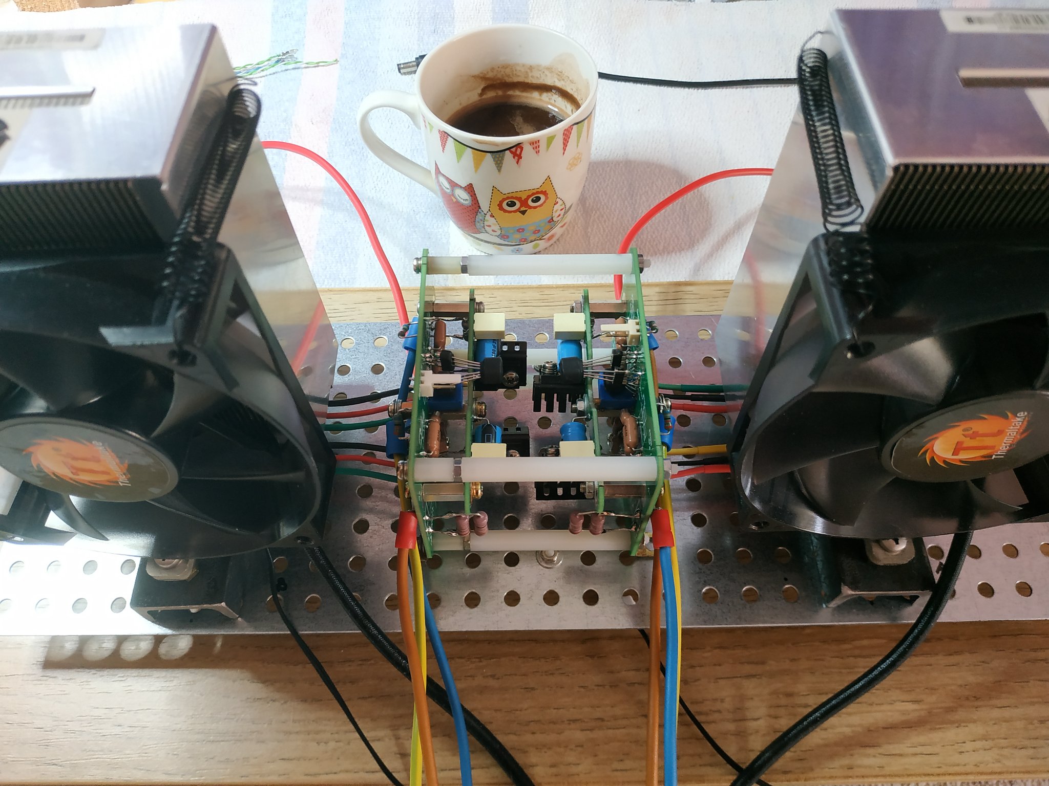

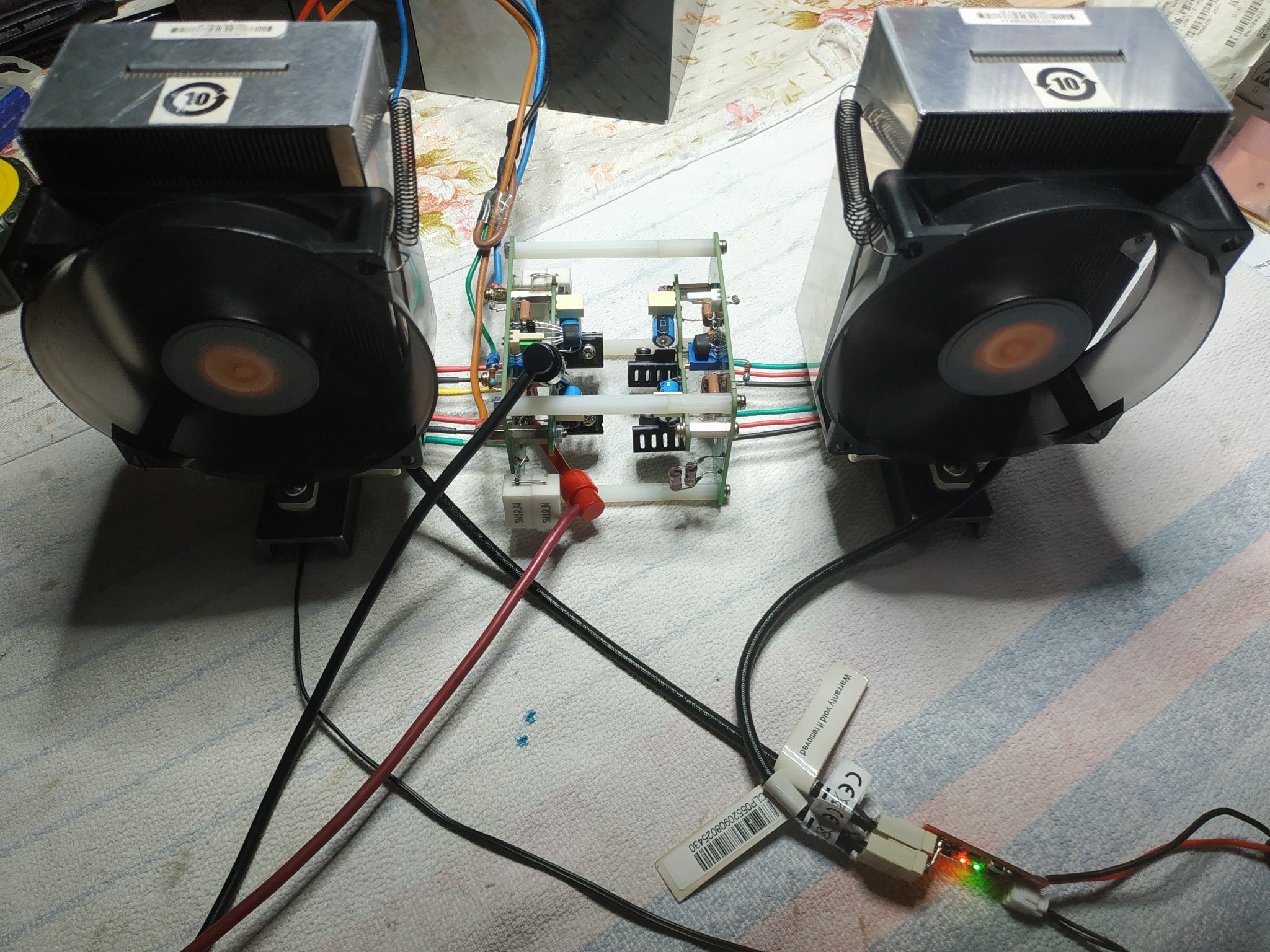

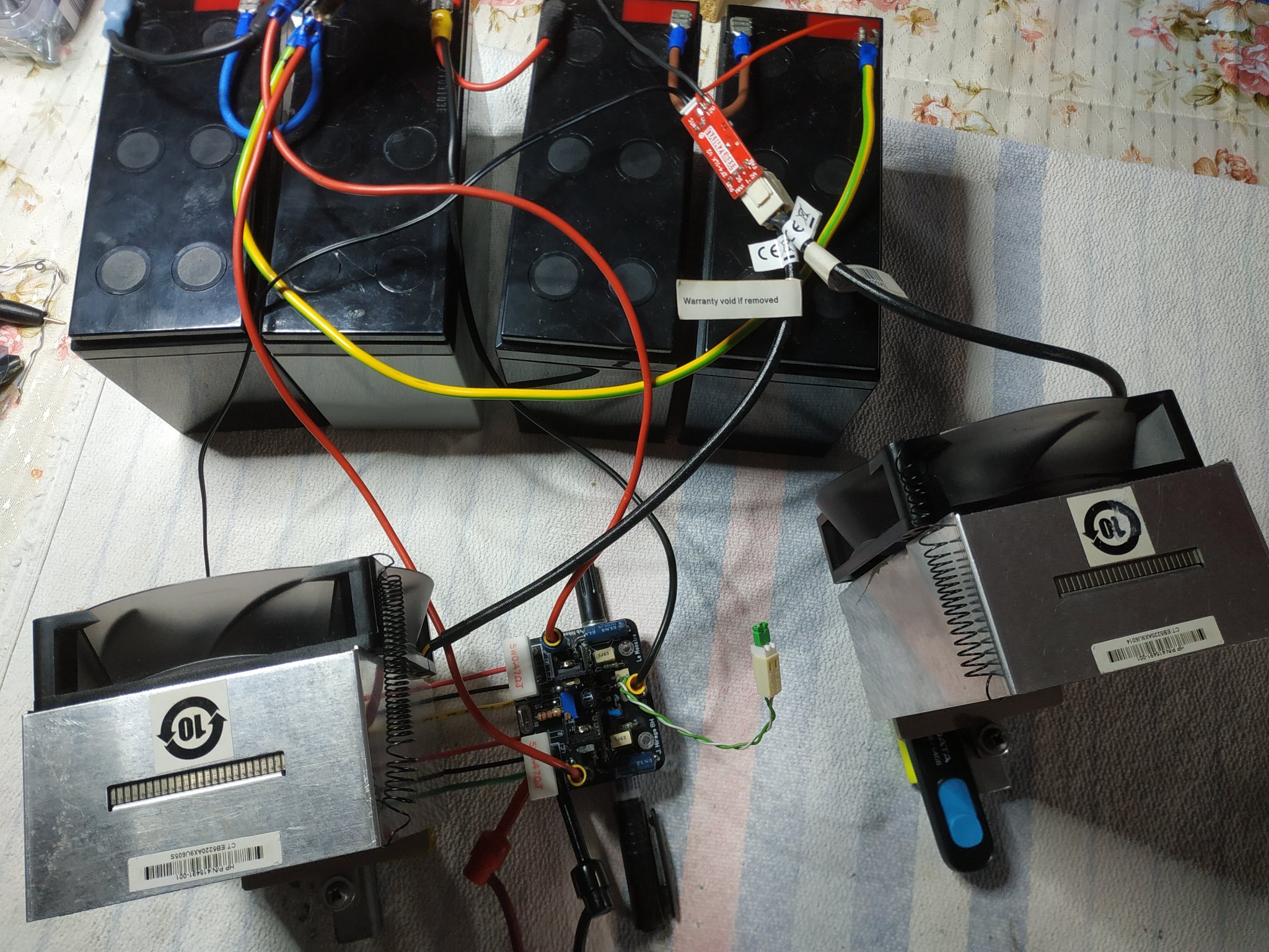

Today I used the power supply Class A cap multiplier from the Alpha Nirvana 39 amplifier. All the more stable since the batteries are small and do not maintain their voltage for long .
Same measurements....
Voltage 22V +/-
Bias 712mV on 0.47Ω
Offset 1.5mV +/-

Even with cheap materials, that is, resistors, the amplifier is very stable, i have two pairs of boards left.
If anyone is interested, please send me a Pm .

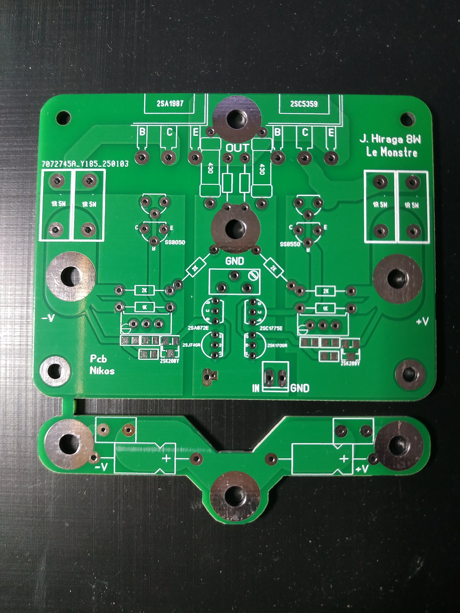

Dimensions pcbs 5cm x 5.5cm.

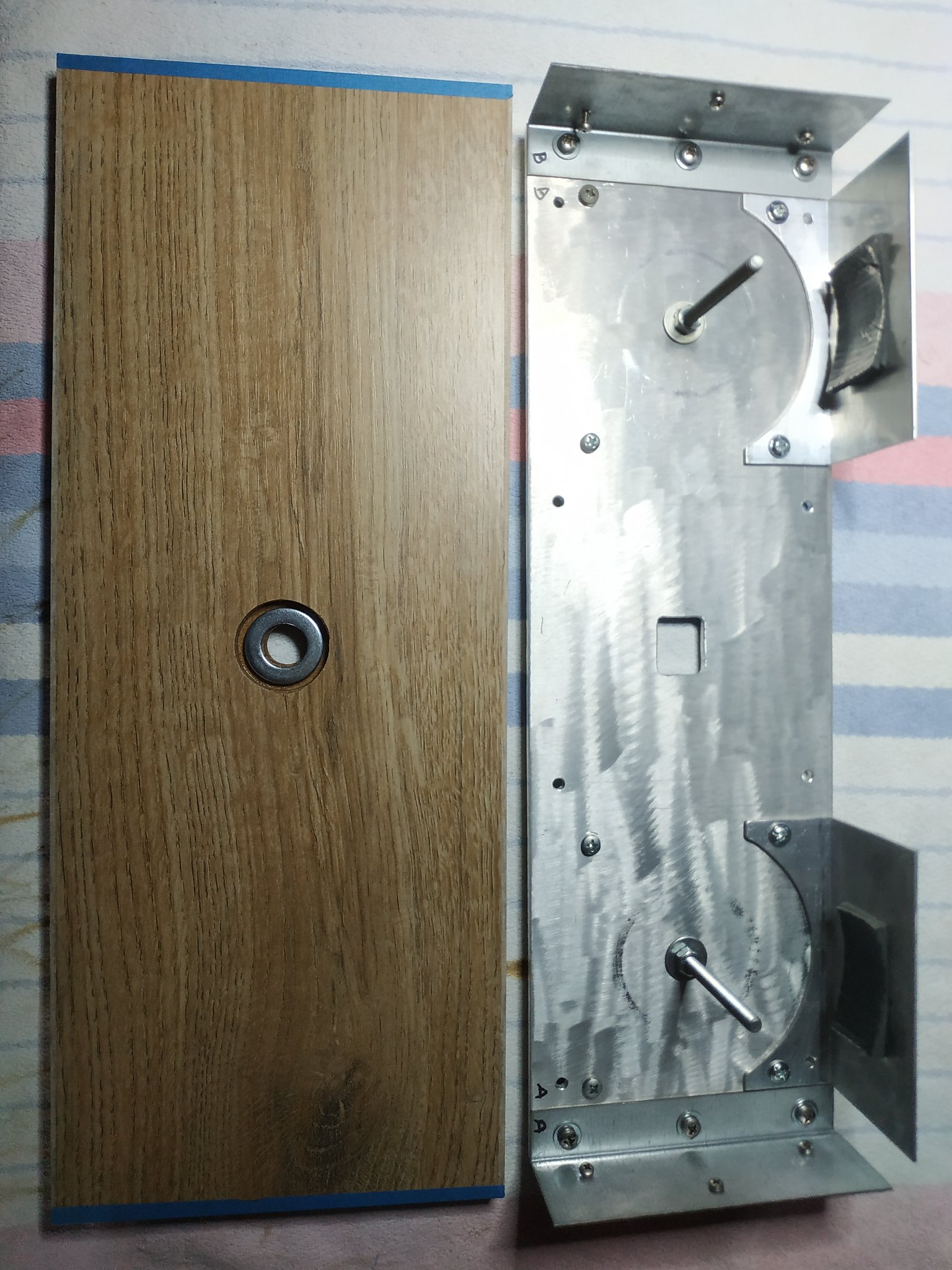

Hello
These speakers I used with the Le Mosntre . The enclosure about 12L BR..
I use Visaton AL130 and Audax tweeters .
I was satisfied with the Le Monstre , and my speaker only 87db.
I had more than enough bass , with the P Daniel Gain clone the bass was a bit shy.
Right now mostly I build my amp using power mosfets..
But also I want to give a try the Hiraga Class A one more time , to me that has more balanced sound.
Has more tube like sound..

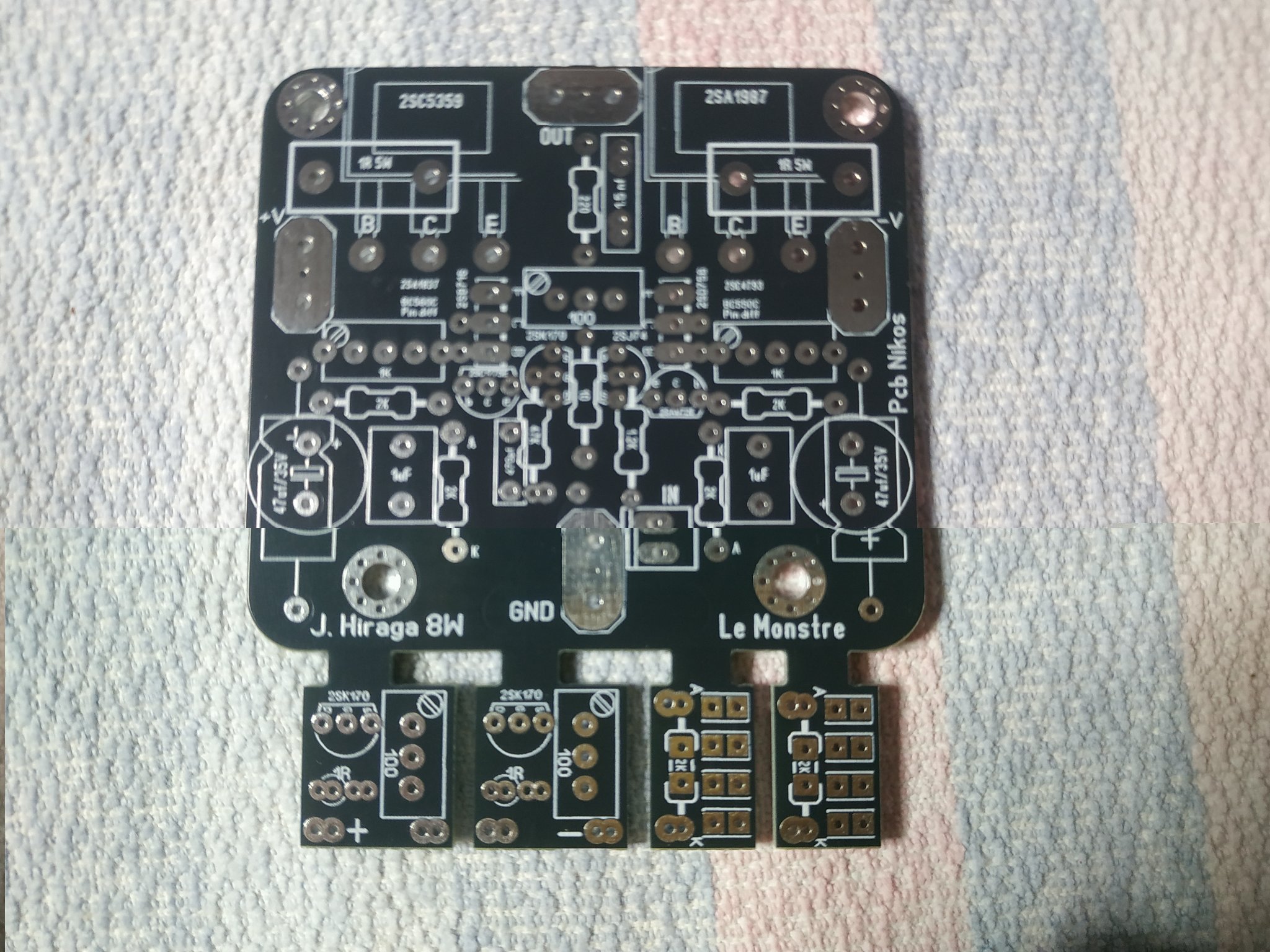

These is a new type of PC board , not finished yet. Power transistors etc need to be mounted.

Hi Gaborbela!
I am looking through this long thread (again), and I notice this PCB. Did you ever finish this project? Did it work, and if yes, how?

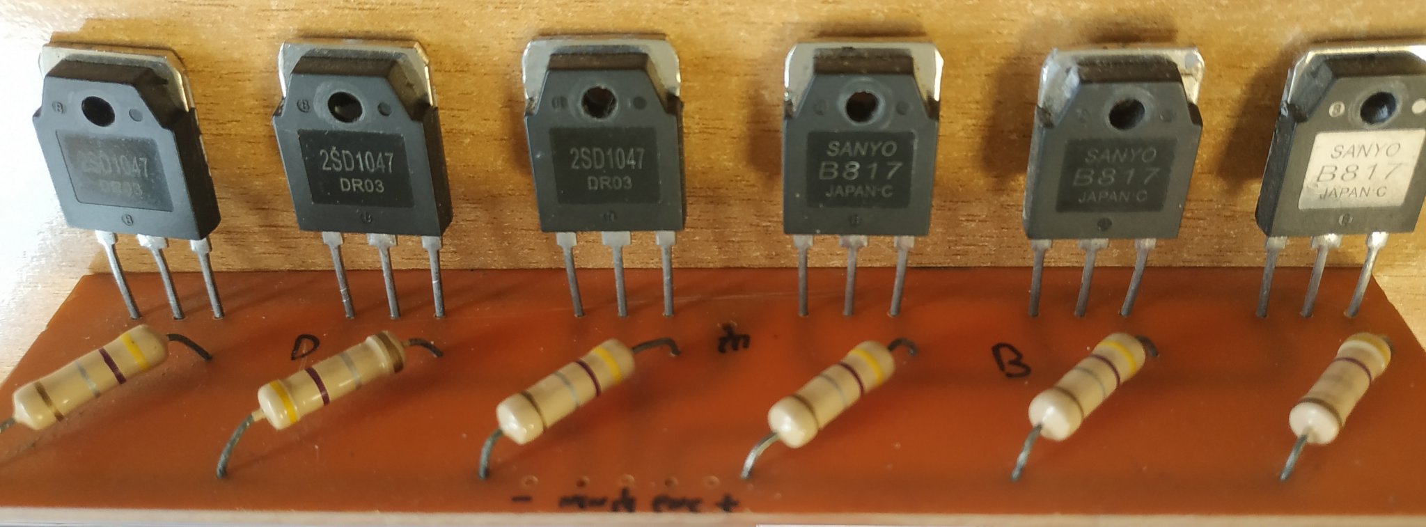

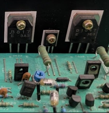

I have a feeling that these are copies, I don't remember ever seeing such 2SD1047/2SB817. There were other manufacturers besides Sanyo, but they still look different from Sanyo. Otherwise, if I knew they were original, I would try them at Le Monstre.

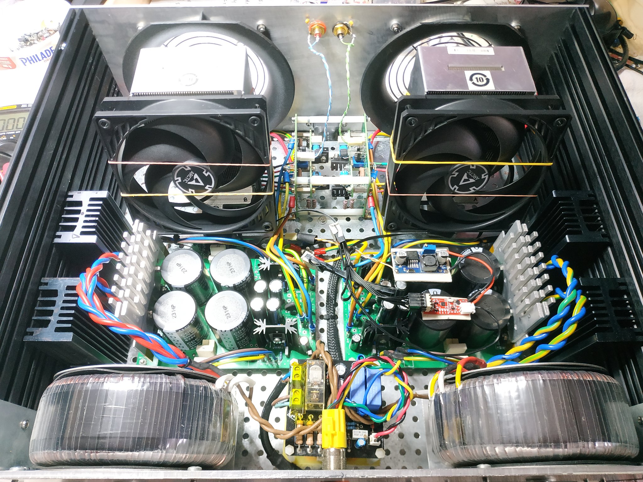

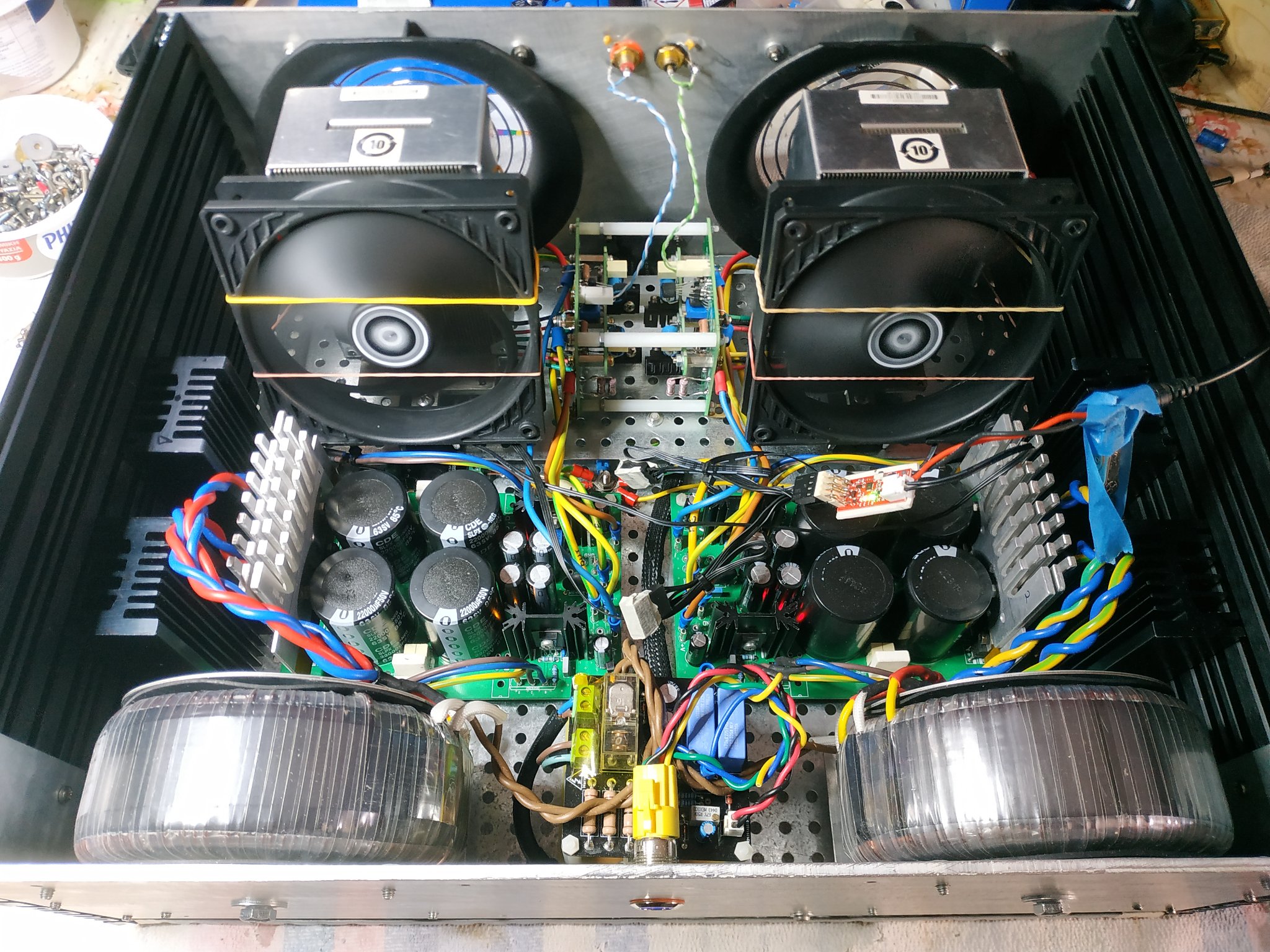

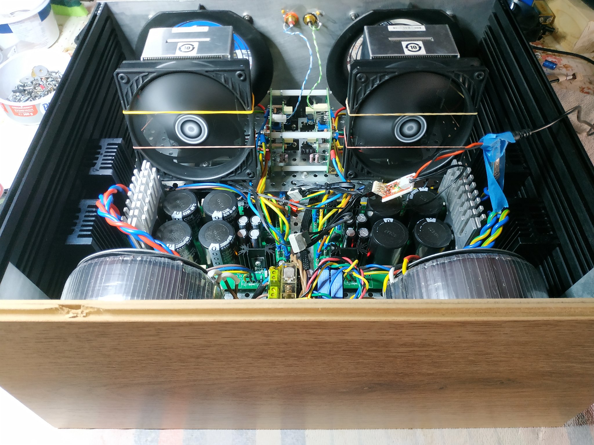

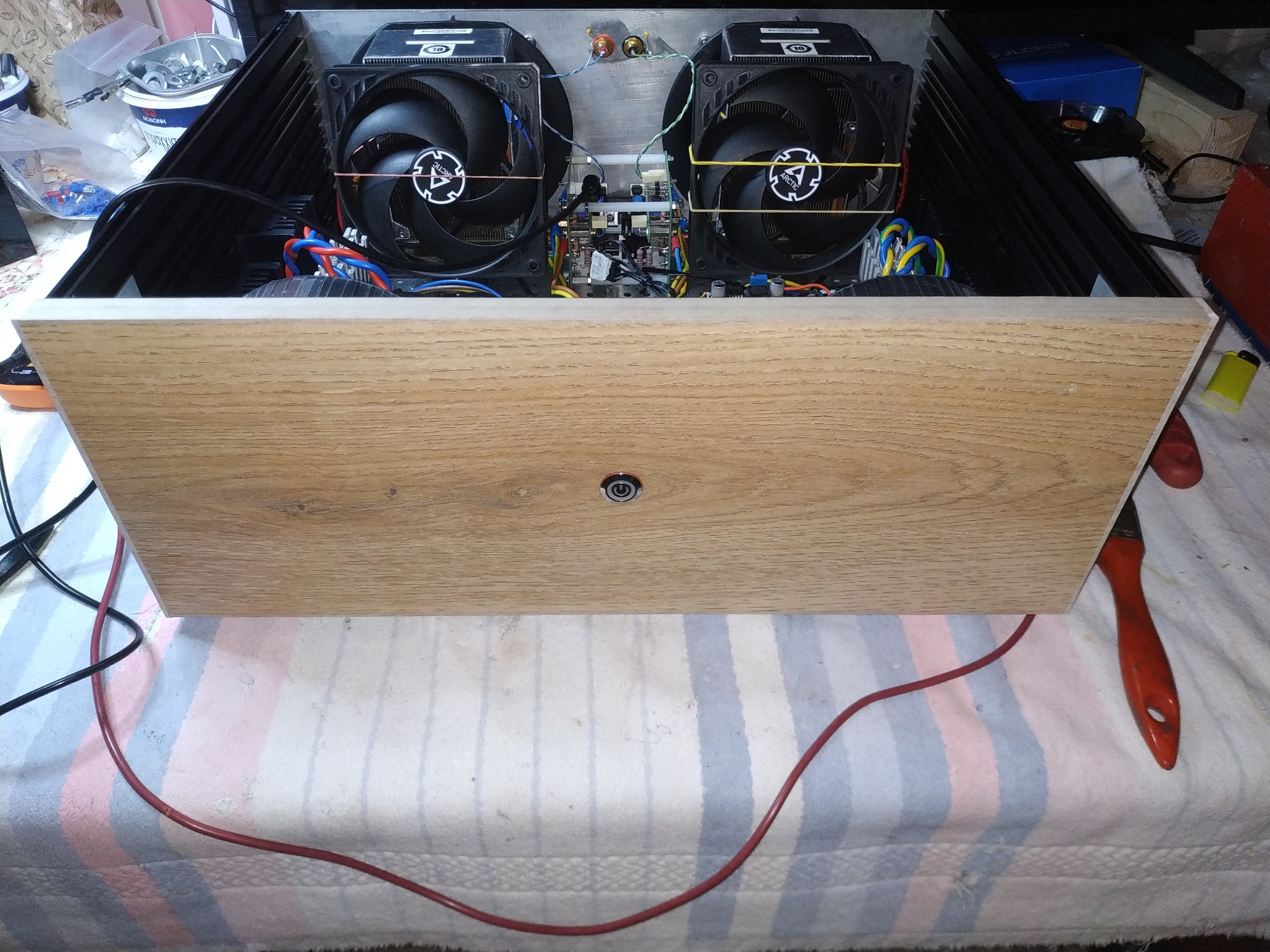

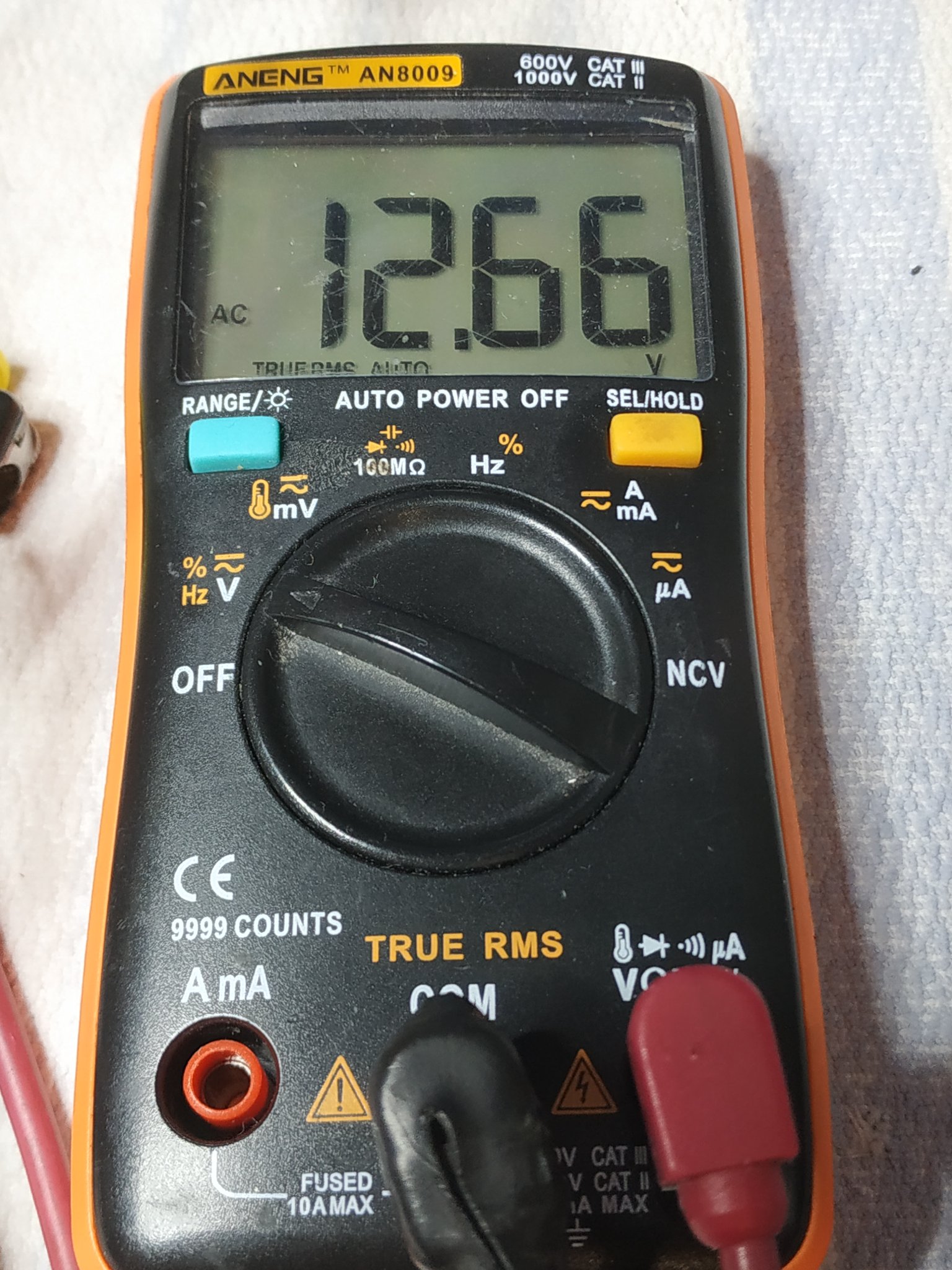

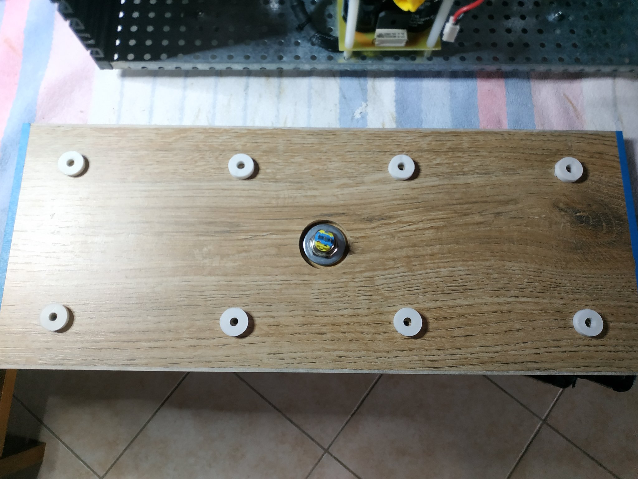

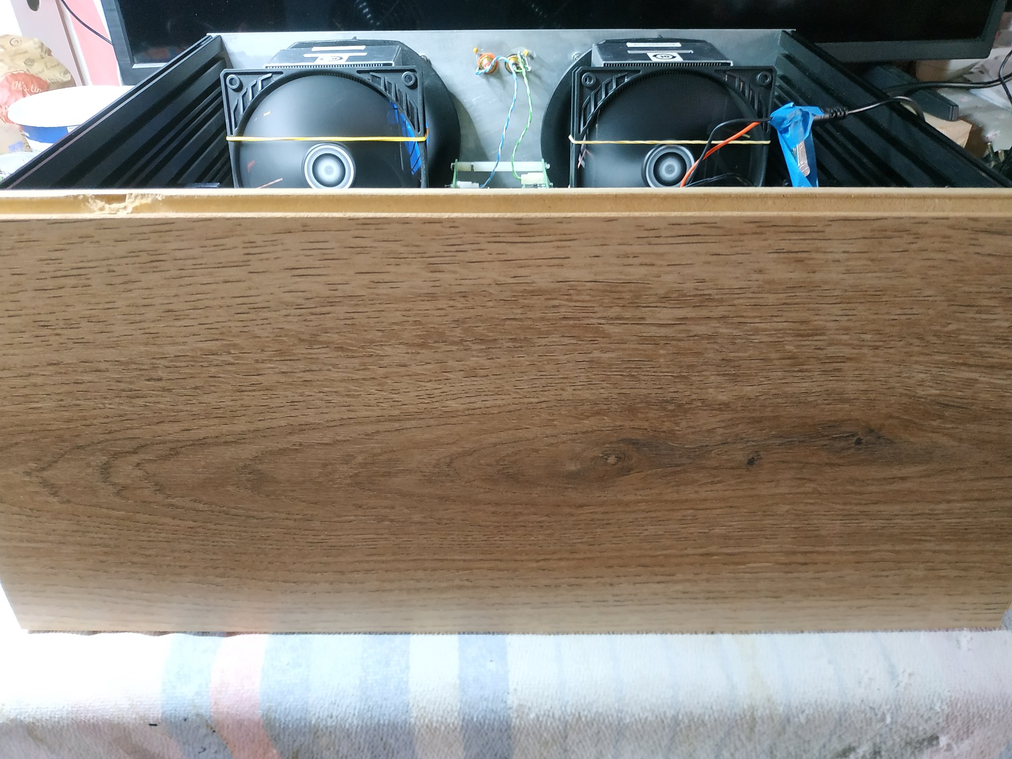

Well done.... excellent behaviour inside the box 1-2 mv offset 740 mv on 0.5Ω resistor about 1.45A bias.
22.5V +/-
Its time for listening.....
Reactions: huggygood
From the short time I listened to it without reaching maximum bias 1.5A , my first impressions are very good ....very great clarity, large soundstage and not particularly excessive bass...No noise at all , hum or hiss.
In relation to ΑΝ39 I have the impression that Hiraga It has a sharper bass while the An39 has a more extended bass.
Impressed!!
