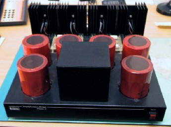

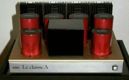

the "Le Monstre" was a pure DIY project in that "L'Audiophile" magazin, whereas its big brother, the "Hiraga Le Classe A" was also a commercial realisation.
I try to load a pic of a commercial "Classe A", which was the first realisation of that amp, with 20W power each channel. The later revised "Le Classe A" had up to 30W per channel, and bigger lytics in the filter stage 330 000 uF (4 times).
BTW, later years of production are much prettier.
