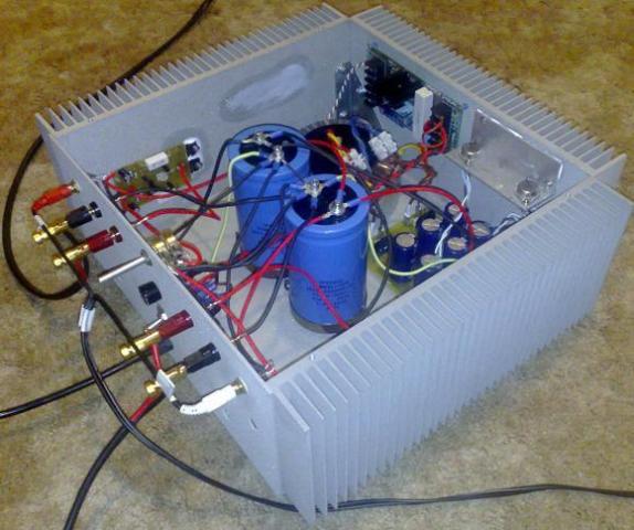

Hi all here is a pic of my regulated le monstre,
and the link.
http://diyaudioprojects.com/Solid/Jean-Hiraga-Le-Monstre/
-Dan

Hi Dan!
Yes, me too, but with unregulated giga PSU like the original. Not bad. It is good for a reference PP amp.
Greets:
Tyimo

Hi There,
Yes i tested this amp and found very good results both using a reactive speaker load and a resistive load.
Have you built the 20W or 30W hiraga ? I want to build that one next
-Dan

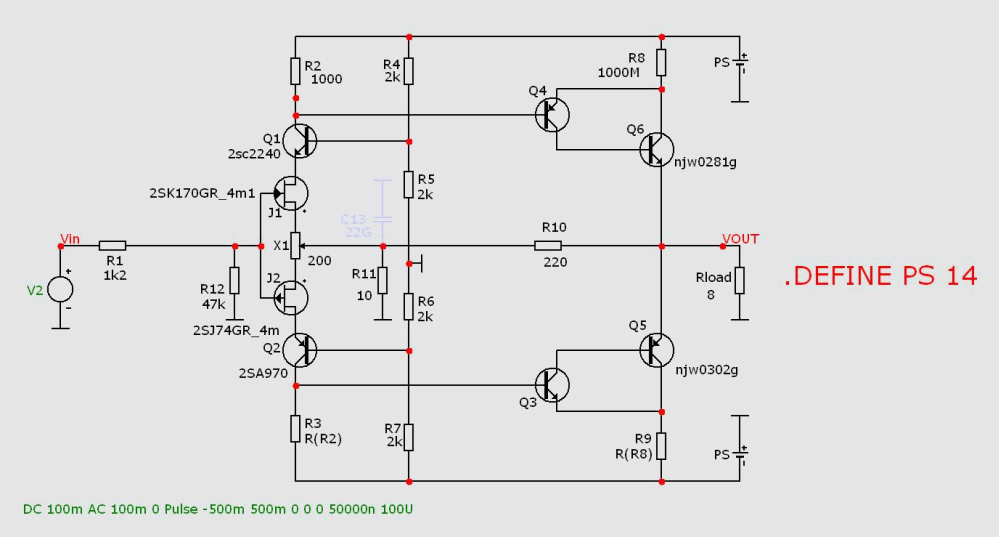

Hi to all
What idss class (GR/BL/V) of the 2SK170/2SJ74 should be used for the Hiraga "le monstre" power amp to get the best sounding result?

HKC said:What idss class (GR/BL/V) of the 2SK170/2SJ74 should be used
hey.
This nobody knows. you just would have to try and listen.
As you ask about 'sound'.
If you mean technically best data of operation into a specific LOAD
it may be easier to try to test or simulate an optimal bias of input stage.
The short answer is, the input FETs should be biased
to get the desired Class A idle current in Output stage.
This current level, would be your choice.
would be different for different wanted power output into different LOADs.
4, 6 or 8 Ohms speakers
This version of Hiraga, in image, uses 2SK246 / 2SJ103
and the bias is set to like 4 mA, for ~ 1 Ampere in output stage.
But I am sure you use some other version / setup
for the Hiraga monster.

I forgot.
I think you should buy/use 2SK170BL + 2SJ74BL
They should be like max 8-10 mA, I think.
They are also the easiest variant to find. Nelson Pass uses often 2SK170BL
( GR variant is only like half as much current. And this may be too little )
Refereing to image in my post.
Depending on different JFET, you may even have to use 220 or 470 Ohm potentiometer.
The procedure for seeting like 1 A current in output, can take some time.
For 8 Ohm speakers, this would be my initial current setting.
When you have 1 Volt DC across both 1 Ohm resistors, you will have 1 Ampere running.
What factors effects (most) how much current/voltage across 1 Ohm resistors?
Several things:
1. What JFETs.
And different exemplars of same 2SK170 can differ.
2. THe potentiometer.
220 Ohm = more current.
470 Ohm pot less current.
3. Value of '390 Ohm's resistors.
Higher value = more ampere in output.
Lower value less current.
Visit Dan's homepage, like he said. Inpprvious post.
I am also sure he can guide you well
how you should do, to trim and adjust Le Monstre
in a safe and good way.
... because if you are unlucky ... you may do a BurnOut
.. at first Power on

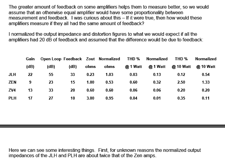

Lumba Ogir said:lineup,
can you estimate the open-loop gain and feedback level of your version?
Lumba Ogir said:thank you lineup, I am waiting...
Lumba.
You should really have a read on a Nelson Pass paper from 2005.
.. unless you have already studied this great paper 😎
See his investigation on feedback factor, in 4 rather classical amplifiers.
JLH is one of them.
I have attached a little teaser image.
Go download at www.passdiy.com
The PLH Amplifier: The classic JLH - Pass style
Then you thank me, lineup, for telling.
But most of all give a nice thought to Our One and Only Nelson.

lineup,
well, Hiraga`s design is simply genial, I`ve never seen anything so eccentric neither before nor after.
You are about to raise the open-loop gain, I would go in the other direction...

Using MicroCap, I simulated the le Monstre, see schematic attached, and CL gain is 24 dB and OL gain is only 37 dB.
THD is about 0,07% at 1kHz and 8Vpeak output.
It is quite amazing that OL gain is flat up to 1MHz!
I have used the GR grades of SK170/SJ74 with Idss = 4mA,
and the pot is 200 Ohm, as to get about the same drain
currents in the JFETs as in the original design.
Lumba,
if you download the free eval version of MC, you can simulate the le Monstre - it is easy as pie.
You can get my MC file if you wish.
Sigurd

500m - 600mV over 1 Ohm is the Ib value,
which is too little, IMO, to get 8W into
8 Ohms. Into 4 Ohms you will only have half of what you get at ( Ohms (into class A).
I have played with the Hiraga le Monstre and am running at
2.5A idle current and that at about 20V rails using 0302/0281 Onsemi transistor. Needs some heavy duty fan cooling 😎
