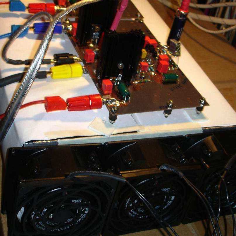

I actually have used 2.8 A at 20V rails for a long time and as long as one has proper cooling, there are no problems.
I do use a 350mm long heatsink with 3x 80mm mains powered fans for a stereo setup. See attached image.
I tried your idea with degenrating the drivers, Lumba, but distortion increased.
SIgurd
SIgurd

HKC said:
Hi Daniel
Your Le Monstre link is very interesting.
According to the power supply schematic. You use 2 LM338K for both of the upper and lower section. As far as I know, LM338K is a positive regulator therefore, should there be 1 LM338K and another negative regulator to form the regulator section instead of 2 LM338K? In addition, the two voltage rails are specified as -12V. Is this typing error? I think they should be +12V & -12V respectively. Correct me if I am mistaken.
Back to the Le Monstre schematic. Is the 100 Ohm trim pot use to adjust the voltage at output? Please advice.
Thanks & regards
HKC said:
Hi Daniel
Would you please tell where did you get the original transistors for Le Monstre? I tried to order from MCM Electronics but they do not ship parts outside USA.
Best Regards
Hello HKC,
Wow this thread got interesting all of a sudden !
The power supply uses 1 LM338K per rail. and is +/- 12V d.c.
The transistors were sourced by another diyaudio member via ebay.
If you do a search in ebay you may be able to get some still.
If not I have some of the transistors left.
-Dan
