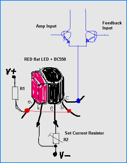

Hello, Lumba 🙂
I am not at all afraid of using RED LED for V-Ref.
They are excellent when wanting a simple + good solution
and not very noisy, in my opionion.
( See Christer, Sweden, investigation link below )
One of the positve things, is when they are put in close contact to the transistor body,
when used as a constant current source, RED LED have a fair temperature compensation.
Preferably I use flat 5mm RED LED, with the flat surface tightly attached
to the flat surface of the TO-92 transistor body.
See pratical example how to in my attached picture.

Lineup - I agree with you. LEDs are superb voltage references in a CCS,
but also when one wants to have a super-low-noise voltage source.
If anyone knows of a more low noise voltage source than a blue LED, do let us know.

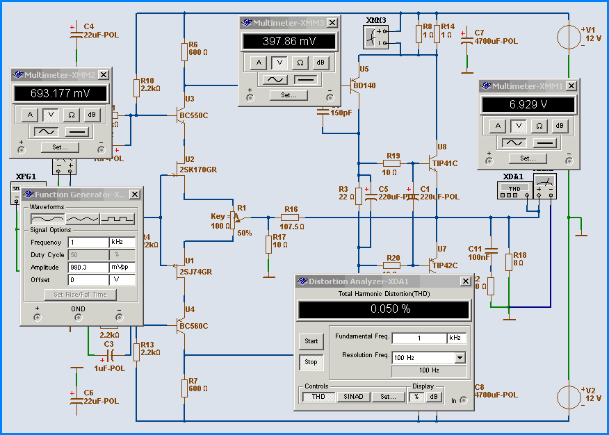

I have spiced a version of this Hiraga Monstre
with transistors that are a bit more 'modern' and can be found to buy.
I feel a bit 😎 guilty for given a less good advice to a guy.
I said: do not change and lower 1 Ohm resistor if you want to use higher Class A current.
for example:
Speaker 8 Ohm / (1 Ohm//1 Ohm) = Vgain 16
Using four 1 Ohm resistors instead of 2 gives:
8 Ohm / ( 1 Ohm / 4 ) = Vgain 32
In short: doubled Voltage gain.
This is needed + good, as well as lower voltage drop across these Emitter resistors is a positive thing.
If anyone want me to
I post my optimal version of this great 🙂 Hiraga Monstre Puure Class A amplifier.
Regards, Lineup

Re: Re: kaneda powewr supply
Here you are, Daniel.
Some points:
- My spice testing shows, that for 8 Ohm speakers,
the original Hiraga idle current 0.8 Ampere, is a good level 😎
- Mathematically:
0.8 A in push-pull gives max output current = 2x0.8 = 1.6 A
1.6 A x 8 Ohm = peak Voltage out +- 12.8 Volt.
- Which, using a dual 12 VDC supply should be enough.
It should be noted, that using Higher Idle Current bias, than you need,
will most often give more distortion, instead of any improvement.
- Transistors in my May 2008 final version ( was doing this one day 1 month ago, 2008-05-31 )
input:
2SK170GR + 2SJ74GR .. IDSS is ~ 4-5 mA
... no problem using them without cascode, as 2SJ74 takes 25 Volt.
- But I added cascode at 6Volt level (half supply) with:
BC560C + BC550C
I do not remember, but probably this gives a bit lower distortion.
I usally avoid cascoding JFETs, unless I see there is some benefit from it.
- Second stage, drivers.
BD139 + BD140
Nothing mysterical. They are the best bang for buck drivers ever made and used in audio.
In this amplifier, Le Monstre, they will fit in very well regarding quality.
- Output transistors.
TIP41 + TIP42
I started out testing with MJ15024 + MJ15025 = TO-3 high power.
But these TIP41/TIP42 OnSemi devices performs better.
Probably because they have higher gain.
Rated 65 Watt and as they will only dissipate like 0.8 x12-15 VDC = 10-12 Watt for Class A,
there is no problem using these easy to find & budget price devices.
They are marketed as:
😎 😎 😎 My first attachment.
Shows that we can possibly squeeze out like 6 Watt RMS
with very low distortion, into 8 Ohm speakers.
This is not bad
When we think of 12 Volt supply & that this means Output is at:
- 9,80 Volt peak
- 1,225 Ampere peak ~ 76% of max ( theoretical max = 1.6 A )
Some points:
- Mathematically:
input:
BC560C + BC550C
BD139 + BD140
TIP41 + TIP42
6 Ampere Complementary Silicon
Plastic Power Transistors
Designed for use in general purpose amplifier and switching
applications.
Datasheet: TIP41/TIP42, PDF
This is not bad
- 9,80 Volt peak
Lineup

The 6 Watt level, as being the limit, when using 0.80 A bias, is not surprise to me.
I have setup many such Class A amplfiers. Of very different circuits.
But most of the time such Class A have the same critical level, at where distortion begins to rise:
.. this is when Peak Output Current is between 75 - 85 % of theoretical Max
In this case was 1.2 A out of 1.6 A ( 2x 0.8A ).
Conclusion:
When designing Class A amplifier, a good bias target value is:
1.33-1.25 x The max output current the amplifier will deliver
Regarding Lumba Ogir comment.
I don't take it too much serious and I am not very bothered. I have seen it looks like Mr. Ogir likes to be ciritical. In fact, I can not remember any post where Lumba actually has been positive to some other peoples works. There is always some detail he find to bang down into the head of other posters 😉
And I am quite sure Jean Hiraga had been much more positive, if see my circuit. At least if he would have had any points, I think he would have been able to explain himself better.
Lumba is right in one thing.
My version is not an original Hiraga Le Monstre.
In this respect, it is probably like most of those 'Le Monstres' built today.
But my version is an attempt to try to improve on Hiraga's good idea. Using some of today's common and affordable transistors.
This makes my circuit a Lineup Class A, a la Hiraga Monstre.
If this is good or not, is much up to the many readers here to decide.
Lineup
