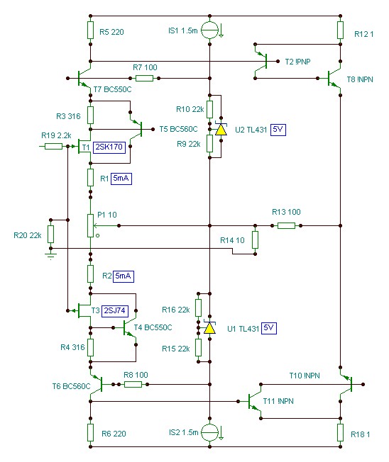

lineup said:
The 6 Watt level, as being the limit, when using 0.80 A bias, is not surprise to me.
I have setup many such Class A amplfiers. Of very different circuits.
But most of the time such Class A have the same critical level, at where distortion begins to rise:
.. this is when Peak Output Current is between 75 - 85 % of theoretical Max
In this case was 1.2 A out of 1.6 A ( 2x 0.8A ).
Conclusion:
When designing Class A amplifier, a good bias target value is:
1.33-1.25 x The max output current the amplifier will deliver
Regarding Lumba Ogir comment.
I don't take it too much serious and I am not very bothered. I have seen it looks like Mr. Ogir likes to be ciritical. In fact, I can not remember any post where Lumba actually has been positive to some other peoples works. There is always some detail he find to bang down into the head of other posters 😉
And I am quite sure Jean Hiraga had been much more positive, if see my circuit. At least if he would have had any points, I think he would have been able to explain himself better.
Lumba is right in one thing.
My version is not an original Hiraga Le Monstre.
In this respect, it is probably like most of those 'Le Monstres' built today.
But my version is an attempt to try to improve on Hiraga's good idea. Using some of today's common and affordable transistors.
This makes my circuit a Lineup Class A, a la Hiraga Monstre.
If this is good or not, is much up to the many readers here to decide.
Lineup

Lineup and Sigurd,
The well-known Toshiba 2SA2240/SA970 have of course excellent linearity sound quality.
Lineup`s input stage is OK, BC550/560 will do a good job in common base configuration but the driver and the output device will not.
Essentially, BD139/BD140 are switching transistors, I`ve never seen their Cob value specified in any datasheet, it`s probably pretty high, high Imax, they perform best in current stages.
Using inappropriate or inferior types means not only poor sonics. Regarding the VAS, Cob MUST be low otherwise under dynamic conditions it will strongly increase, decreasing the bandwidth causing distortions, phase errors and instability. Large fast moving voltages require rapid changes in transconductance, you need a cheetah not a sloth here.

Lumba -
that is a nice list you have made!
I use the 2SC3600/SA1406 and 2SC3601/SA1407 complementary pairs. I have never seen any BJTs as linear as these! As you say they cannot handle much current. But for up to 30mA resp 50m they are fine. Still available, and there is a SPICE model for one of the pairs.
I also use the 2SC2911 / SA1209 from your list. These can handle more current compared to the above BJTs. Up to a few 100mA.
There is one Toshiba BJT that I find very good up to 5-10mA and that is the pair 2SC3423 / 2SA1360.

>>Sigurd If you are using the original drivers, running 2,5A through the outputs will bias them at around 25-30mA, well into steep rolloff part of their beta curve.
With the original outputs with the specified grading from the article the current through the drivers should be around 7.5mA. (Wich is right where the beta curves for 2SD756 is at its flattest and 2SB716 resonably so.)
Also the 2sk170/2sj74 are specifed to be of the -Y grade wich is bellow GR in idss and currently unobtainable. Using GR or BL jfets will increase the bias currents and increase the gain. In my le monstre (wich use BL 8mA) I have compensated for both theese effects by lowering the value of the jfets drain resistors.

Yes, the drivers are working pretty hard. But not as hard as you say. The NJW0302/0281 have a max beta of 150 but at the high temperatures I am using them at, beta is higher. I have not measured the base currents into the NJW:s but I estimate around 10-15mA.
Simulations with beta = 100 for the output devices, and at a die temp at 100 deg C, I get 12 mA base current. This might not be the ideal current, but me and another person have a total of 8 of these Hiragas up and running and they are sounding wonderful. Especially with the TX2352 resistors and the extensive raw PS with chokes and RIFA PEH200/160 caps together with extensive filtering of the input stages and cascodes, and at other places.
PCB material is Teflon.
You are correct about the Y-grade - it was available for a short time only. I use the GR grade matched for +-2.5% and with an Idss of 4mA. The pot is 200 Ohms. The 1k resistors are still 1k, but the power resistors (Caddock MP930 in T0-220 case) are from 0.5 - 2 Ohms depending on what currents we want to use.
We run the "Hiraga le Monstres" at 20-25 VDC and at a bias current of 2A I use 3 fans to cool the HS.
As with Lineup's "Hiraga le Monstre" the one I have designed is not really a Hiraga le Monstre anymore. The other guy has an original Hiraga le Monstre with a huge battery powered PS, but this new Hiraga sounds even better.
Sigurd

As noted, my version runs these Sziklai drivers at 60 mA +.
So 2C2240/2SA970 or BC550C maynot be my best choice.
Would they?
DS.

The right way to go is improving the linearity of the stages, not increasing the open-loop gain and GNF.
Hiraga has showed that stability can be maintained without a single dirty part. It`s an extremely clean design.
Would this work?
was I destructively just? Would polite agreeing constructively promote your creative thinking?Right now my spirit is gone.
Would this work?

Lumba, the use of tl 431 is insteresting.... i cannot comment on how it would work in this circuit perhaps give it a try ?

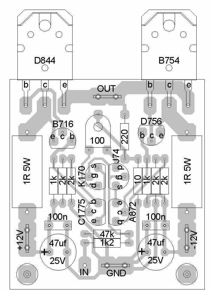

Audiomanics, that layout is great !!!!!
