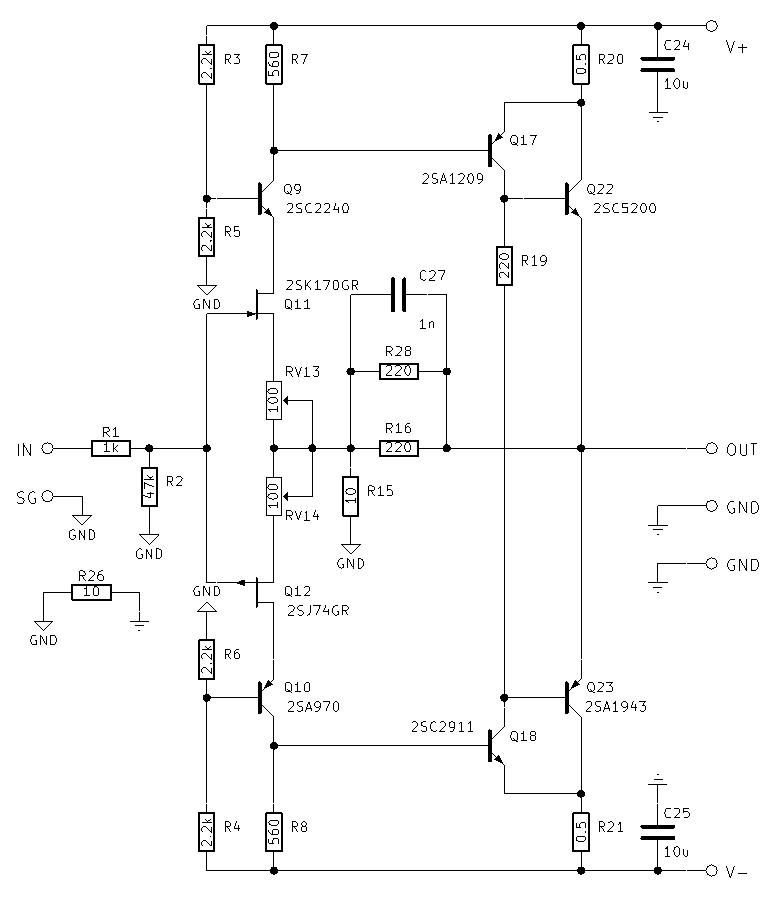

Is this schematic the same as the gerbers? If not, could knutn share the board's schematic?

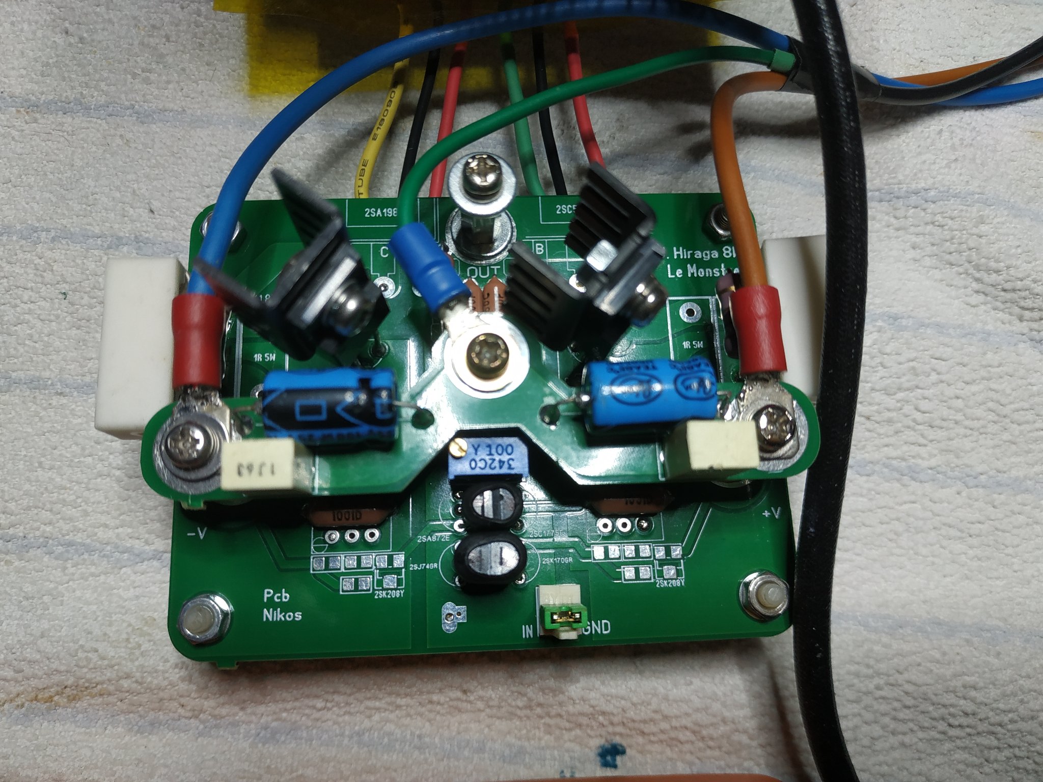

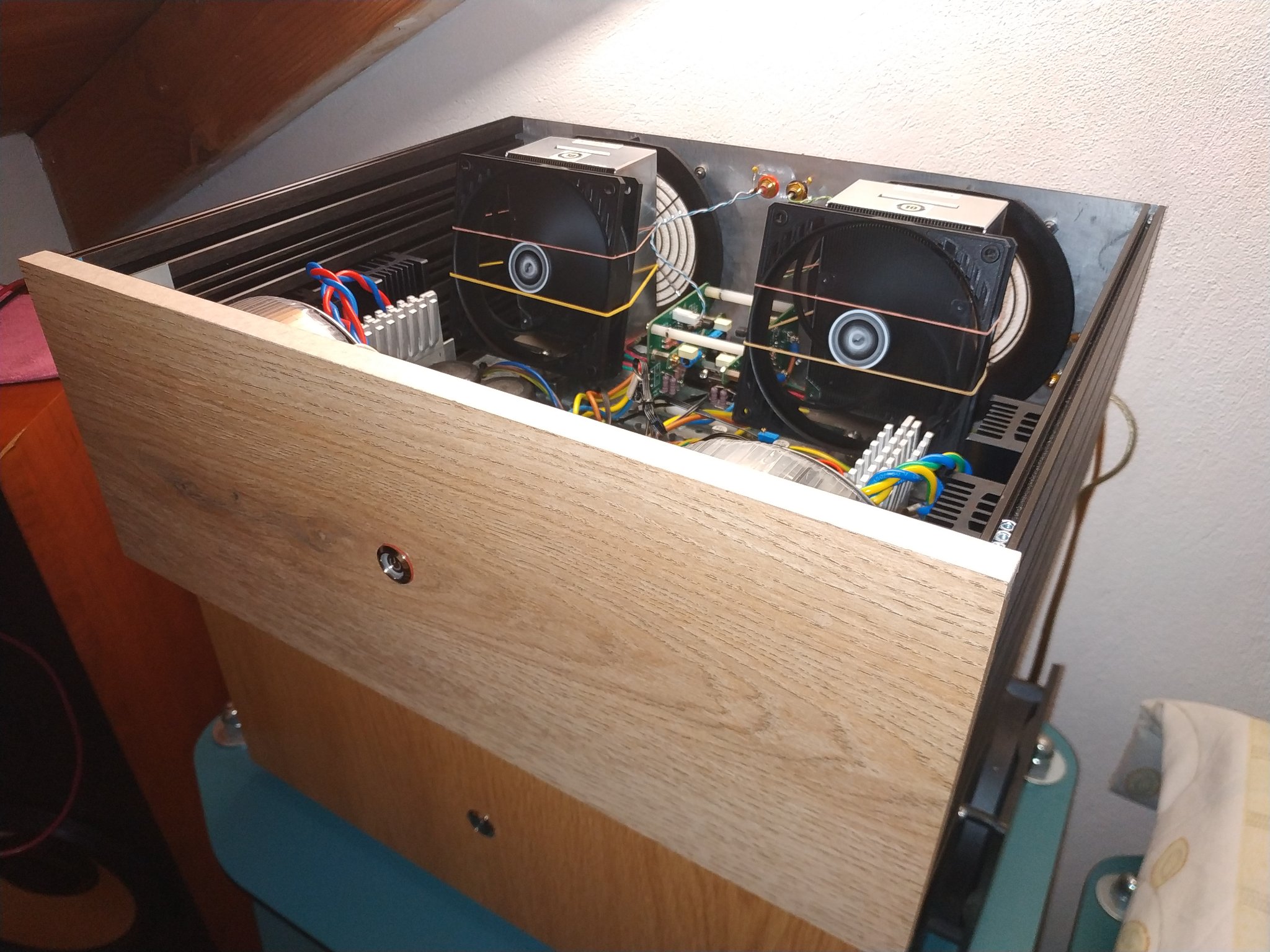

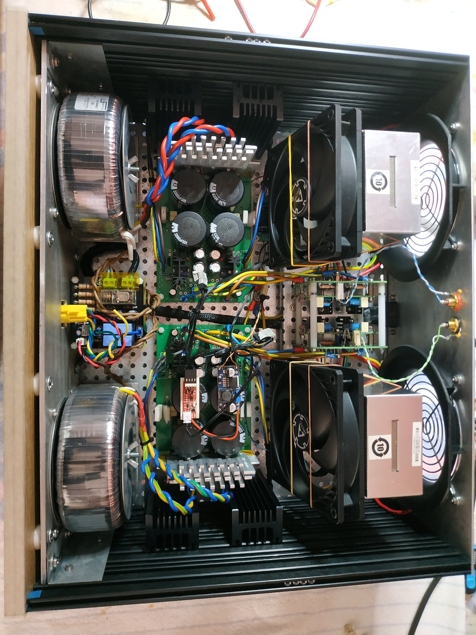

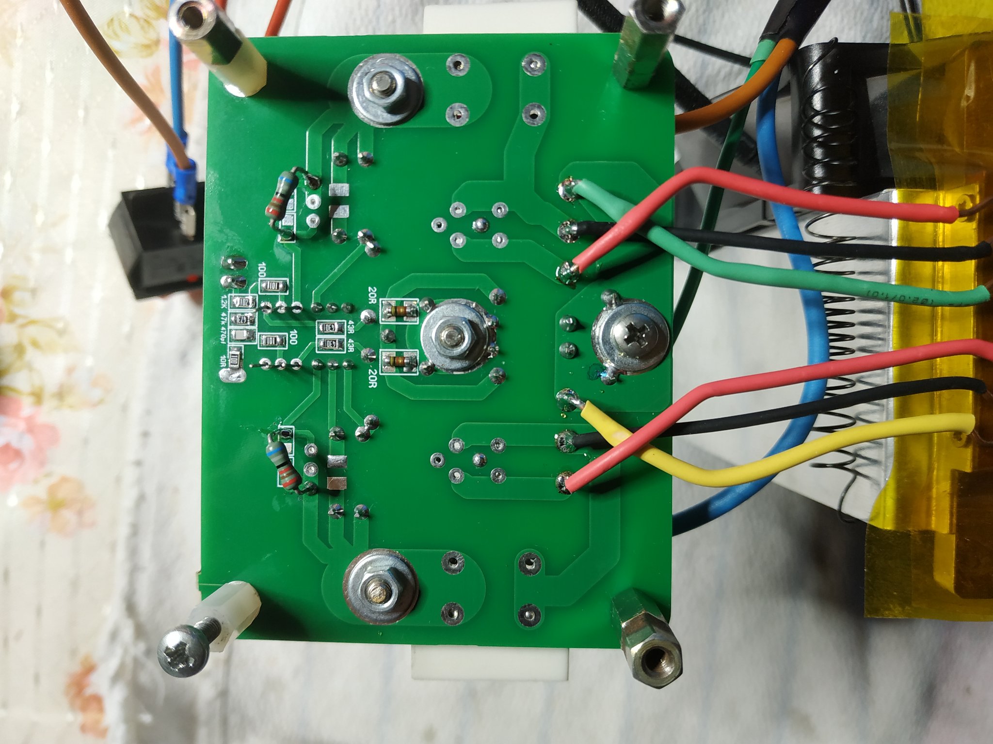

Yesterday, I tried playing with feedback. Le Monstre has a rather high CLG - 26 dB (20x). All of my other amplifiers are at the level of 20 dB (10x). So, I added a second 220 Ohm resistor parallel to the installed 220 Ohm feedback resistor and that lowered the CLG to 20 dB.
Next, it was time for a listening evaluation. For a quick comparison, I didn't solder the paralleled resistor, but connected it with a pair of cables with crocodile clips, in order to be able to readily connect and disconnect it. Well, it was clear to my ears that the lower FB was way better. With the higher FB, sound was less vivid and seemed to loose clarity.
So, I decided to stick with the original feedback scheme.
Evangelos
Reactions: Nikos and gaborbela
Same story here.... i change the resistor 10Ω to 20Ω.
Finally setup for 4Ω version
+/- 22-24V
330pf input cap
Bypass resistor 68k
On 1k res cold 1.20V -1.34V
0.47Ω resistor bias 730 -750mv about 1.6A
220 -20Ω gain resistor
Offset +/- 2 mV
Trimmer 53-48 Ω
2sj74Gr -2sk170gr 3.0ma idss
Cascode 1845-992
Drivers 4793-1837
Output 1987-5359
