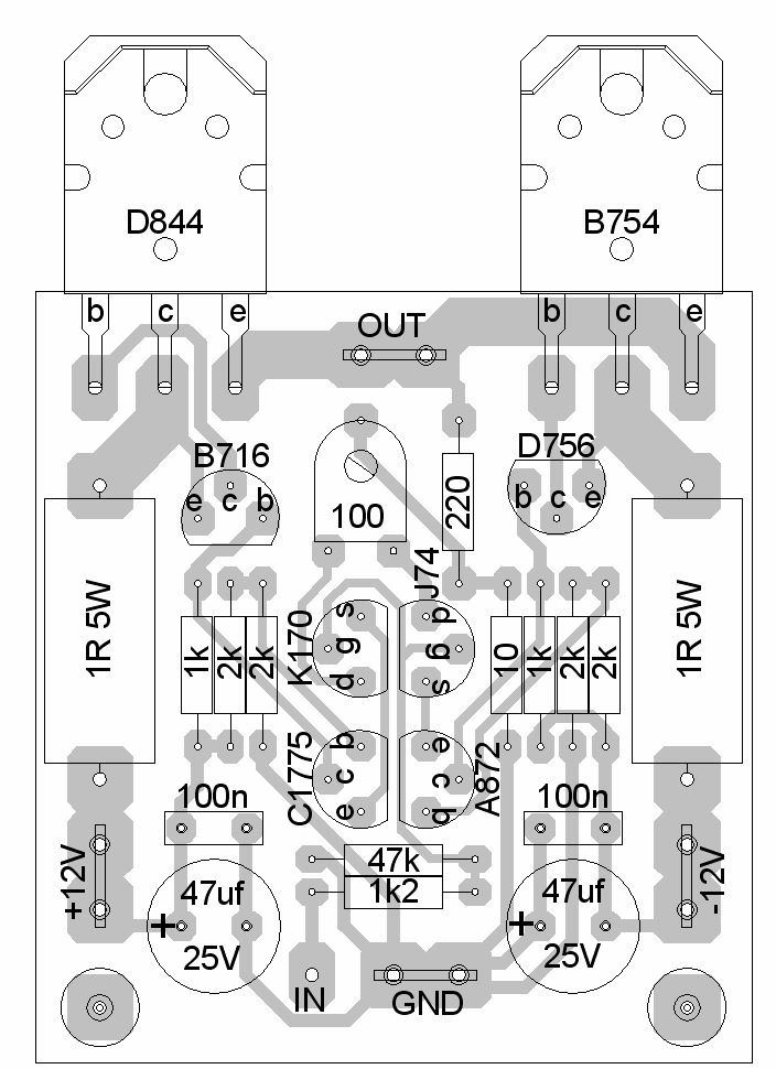

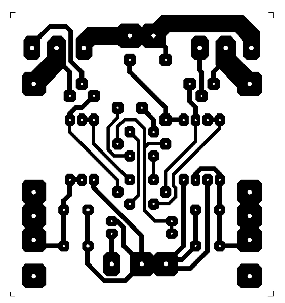

My PCB layout. Single sided, short powerlines, thermal coupled transistors, Faston connectors.
Comments please.

There is a board components layout from a member here. I spent two hours of image editing to make it a clear board free from components (silly a bit, as I could have made one of my own at this time 😛), so here they are. Note, I havent checked the layout for errors but it seems simple to check.

You could also have asked Audiomanics if he wanted to post it..
Sure he would..
I will make an PDF today and post it.. Then it should be accurate in size aswell.
BTW the layout is in mirror.. that's good while transparents should be printed that way..
This print has never been made before, while i'm not able to do that at the moment. So it is never been checked working..
I think it's ok, but if you see an error PLEASE let me know..

Do you want me to remove the attachment and having you to post your pdf?
With a quick look I did not find any mistakes, but I will have a closer look within weekend so I will let you know if I find any error. 😀
I am building my monstre using your board, so I will definitely check this.

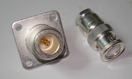

By the way, I attach the photos of some components for this amplifier to take ideas for your construction. Somehow I cannot attach them all in one post so I attach them in the next three posts.
And guess what these are. Yes these will be used for line and speaker. The most important thing is the teflon dielectric and most important the earth-first connection. Combined with the low capacitance aircom plus RF cable they should give a better performance for a fraction of cost of the super high quality junk cables sold extensively. Do not even think these things cost too much.
RF is sometimes better for audio 😀
