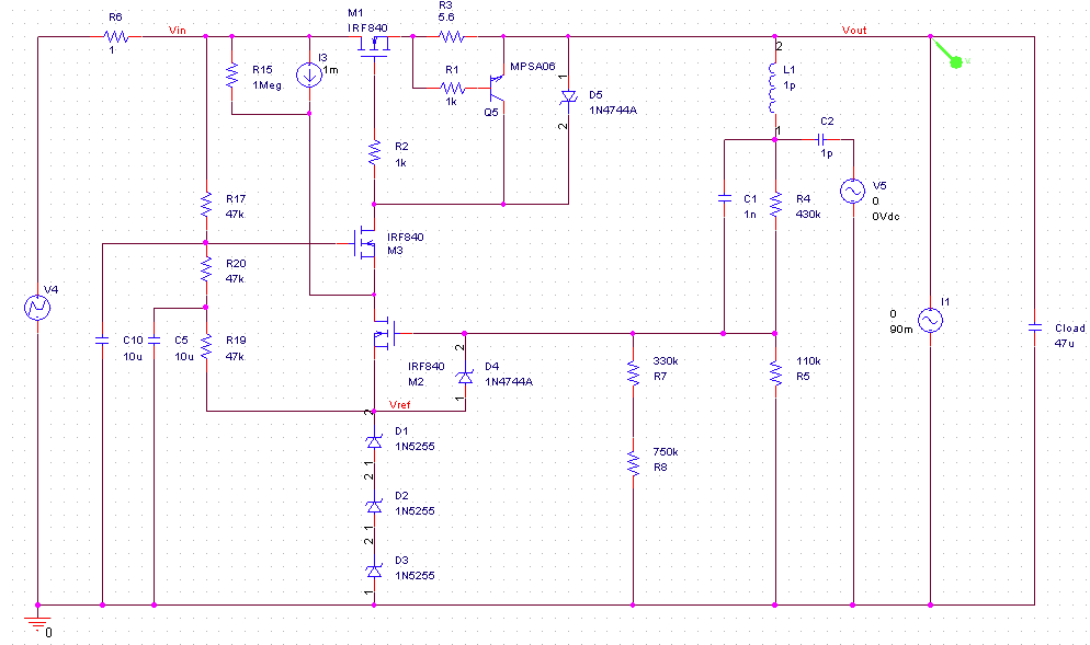

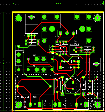

HV Regulator v. 2.0
Folks,
I just pulled the prototype board for this circuit out of the etch bath. I'm still planning on using a 0A3 for the reference voltage, but have left room on the board for a zener.
The only change compared to the circuit in Post #44 is that the series resistor to the reference has been extended to 3 x 47 kOhm.
~Tom
Folks,
~Tom

Sad to say, pulling the "GND" pin to GND will violate one of: Input-to-output voltage rating [40V for most versions], or output-to-GND. This may be a transient effect, but the chip will not be forgiving.
However, you have a husky power FET there already - why not connect Q3-drain to R4-D1{K} in order to throttle back the pass FET, in case of a short? You might have to increase R1 & R2 to keep fault-mode dissipation reasonable, but the 317 should remain unstressed throughout.
A small value cap from Q3g to GND could improve the stability of the trip mechanism; also consider a way of adding a little ac-hysteresis by diode-pulling Q1-b through a series RC network.

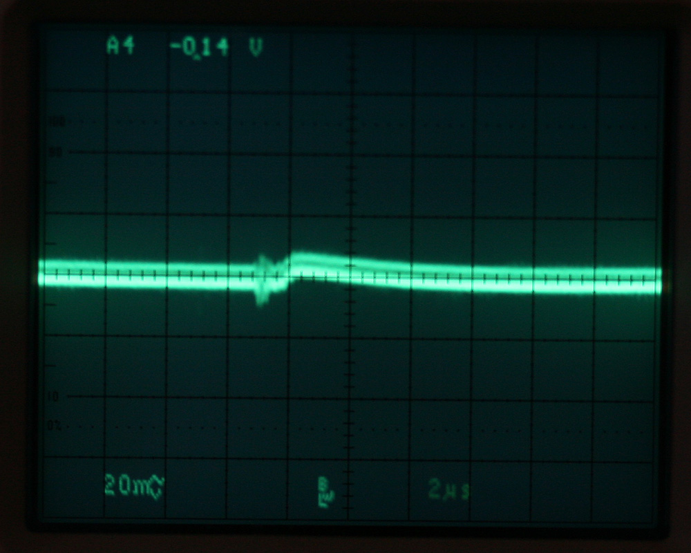

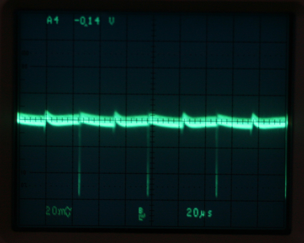

Discrete Regulator Lab Measurements
The discrete regulator is coming to life. The output voltage depends slightly on the temperature of the error amp device, so on cold start, the output voltage is 472 V. As the regulator warms up, the output settles at 475 V. 0.63 % drift. I can live with that...
I decreased the compensation cap as the 10 nF I had in the schematic caused excessive ringing on load transients. Through experiments, I found 220 pF to be a good value. See updated schematic.
I ran a torture test of the regulator:
Start-up into no load.
Start-up into capacitive load.
Start-up into "short circuit" (cold light bulb).
Transient response.
Min. drop-out voltage measurement.
Ripple rejection.
The regulator passes with flying colors. Start-up into a 47 uF polypropylene cap (5 mOhm ESR) presents no problems at all. I even tried with the regulator at normal steady state operating temperature and high input voltage (120 VAC + 5 % = 126 VAC) on the transformer primary. No smoke...
Start-up into cold light bulbs throws the regulator into current limit. The current is limited to approx 120 mA. The voltage across the bulbs (four 25 W bulbs in series) is about 120 V. For this test the 47 uF cap was left in parallel with the bulbs by the way. I have not tested how long the regulator will survive this. I let it run for about 30 seconds to a minute. No sparks, smoke, or funky smells. The heat sink for the pass transistor was lukewarm after this...
The minimum drop-out voltage was found by reducing the input voltage to the point where 120 Hz ripple would show up on the output. The minimum drop-out is about 15 V. I.e. the input voltage must be 15 V higher than the output voltage for the regulator to maintain regulation.

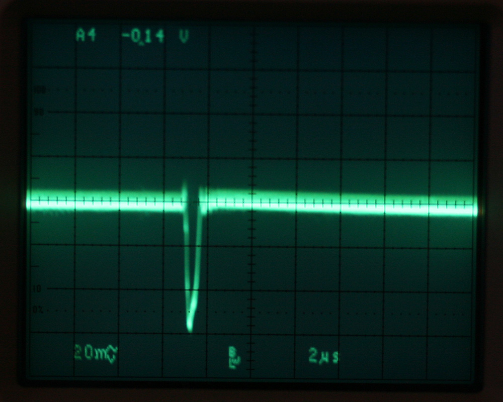

The transient response is shown in attached o'scope pictures. Note that the vertical scale is 20 mV per division. Observant viewers will notice that the "fat" trace appears to be multiple traces overlaid. That is indeed the case. That phenomenon is caused by the ripple on the output of the regulator. This ripple measures 6 mVpp. The ripple on the input is 3 Vpp. Hence, the ripple rejection measures 54 dB. Not shabby... I should say, though, that my lab setup is currently a rats nest of wires. So once the layout gets tightened up I expect to have less 60/120 Hz pick-up in the circuit. Hence the ripple rejection measurement may improve.
The transient response is measured with a 25 % load step (45 mA to 60 mA). The response shows a tiny bit of overshoot followed by a fairly smooth settling. Of course, if the frequency of the load step is increased, the overshoot and undershoot will merge forming a waveform with higher amplitude. The final plots show the step response with a 20 kHz repeat rate for the step. When the load in suddenly increased, the output voltage drops until the regulator recovers. This takes about 1 us as shown in the zoomed plot. It's interesting to note that when the load is dropped, there isn't a similar increase in voltage. Funky... But we're counting millivolts here...
Transient response.
Ripple rejection.

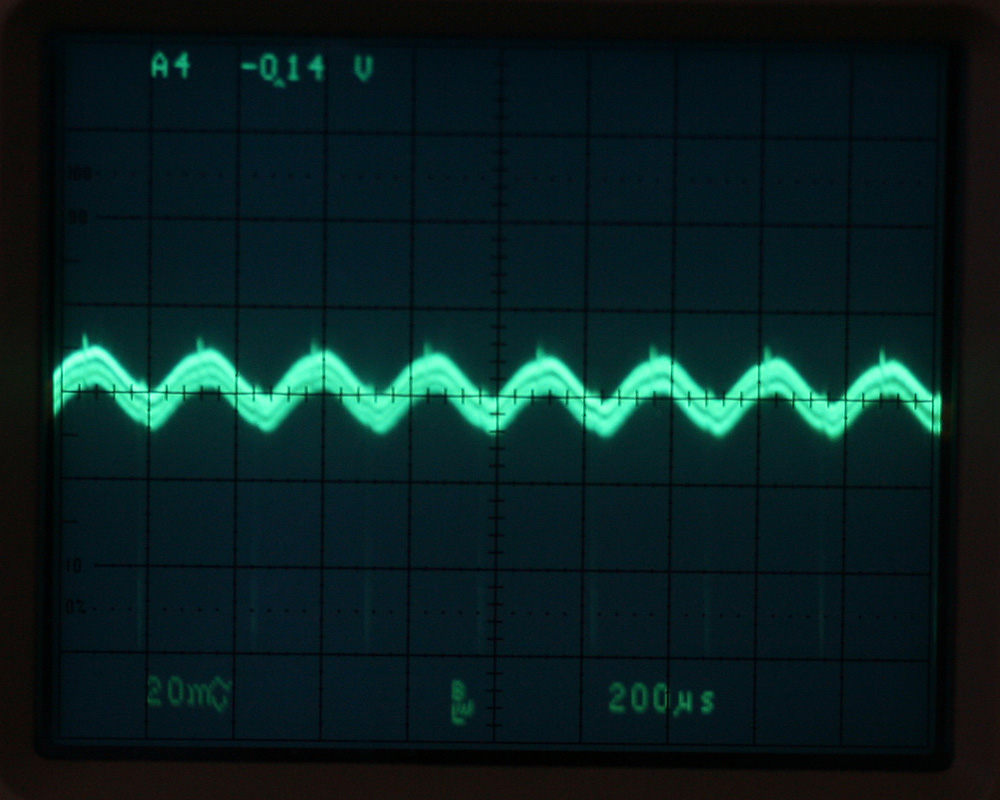

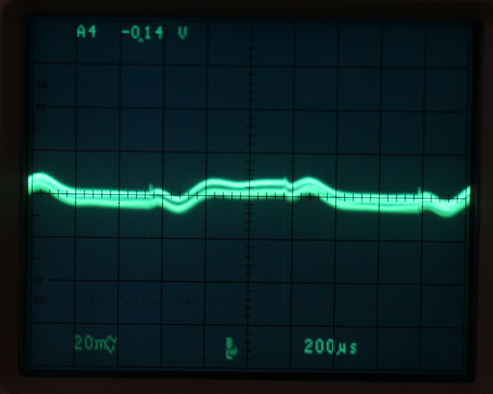

Hmmm.... The ripple rejection needs improvement. Even with only 6 mVpp on the output, I can hear the 120 Hz in the speakers when the regulator drives my 300B amp. Granted, it's not audible from the listening position, but still.... My speakers are 87 dB/W*m efficient. Not super efficient.
Aside from the hum, the amp sounds and measures good, though.
