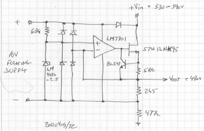

I got to thinking... A zener regulator with current limiter is likely to have relatively high output impedance due to the resistor needed for the current limiter circuit. "Relatively high" in this context would be 5~10 ohm or so. That would probably be alright, but I would prefer a lower output impedance. Although, given the DCR of the OPT does it really matter that much.... Anyway.

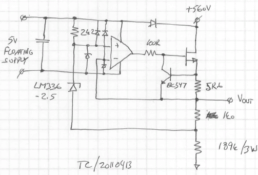

My latest musings go along the line of a floating regulator. Think LM317 on steroids. Basically, I'll follow the circuit in Figure 1 of National AN-178 but with a giant, high-voltage power NMOS as the pass device. The op-amp could be powered by a separate, floating winding on the mains transformer. A spare 6.3 V heater winding would work... Or some wire could be wound around the core to form a winding. That's easy...
I'm thinking to use LMP7717 for the op-amp and an LM336-2.5 for the reference voltage. The whole deal would ride on a small zener-regulated 5 V supply.

Seems dicey; the current limiting needed to protect the pass device will create a large voltage differential across the op amp's inputs at start up. Since 40V 317s have blown in this situation I'd expect a 5.5V 7717 wouldn't last long. Similar issues exist with floating supplies since the op amp rails don't track B+.
There are Apex parts that could be used here but they're a few hundred bucks. So I'd suggest looking into implementing a discrete op amp with high voltage parts.

Seems I'm not communicating clearly. Attached sketches the circuit. The 5 V supply for the op-amp is floating. The range of flotation is limited to Vout~B+ by diodes. Steady-state operation should be fairly obvious. The op-amp has negative feedback, hence, will set the output to ensure that IN(+) = IN(-). This forces 2.5 V across the 1k0 resistor, which, in turn sets up the current in the feedback resistive divider.
Current limit is implemented by the 5R6 resistor and the BC547 NPN. During current limit - or short circuit - the output of the op-amp will have to track the source voltage of the NMOS pass device. Hence, the op-amp output will track Vout. This forces the negative supply rail for the op-amp to track Vout as well --> op-amp remains happy and non-fried.
It just dawned on me, though, that I'll probably have to go with a 12 V or 15 V compatible op-amp. LMP7707 would work... Vgs of the NMOS I'm using is about 4.5 V at room temp. Hence, 5 V supply is rather marginal (read not enough) -- especially at hot.

It does help to have a schematic.
I'm not seeing this will fry but unless I'm missing something it only regulates when 560 - Vopamp_supply > Vout - 2.5, give or take a few volts if the op amp's not RRIO. The desired Vout seems be to 475V, a bit outside the common mode an OPA445 on a 90V supply floating on 560V can handle. Assuming it's desired to maintain regulation across +/-10% mains on a 520V trafo leaves me with a 2*0.1*520V + 2.5V reference + op amp rail approach limitations + ripple = 125Vish op amp supply in this topology.
I think you could get around this by floating the op amp's rails on Vout rather than Vin. Split supplies centered on Vout would probably be about right.
The op-amp rails are actually floating on Vout.
Notice the polarity of the diode to Vin. It clamps the positive rail so it cannot drift higher than Vin. It is, however, free to drift below Vin. Actually, I'm not sure the diode is required. If I use a zener on the front for stabilizing the supply to the op-amp and the lower rail is clamped to Vout, the upper rail would be limited by the zener.
And actually... Now that I think about it some more. The body diode of the NMOS will clamp Vout to Vin so if the lower rail of the op-amp can't move too far anyway.
All this is really only relevant for startup, short circuit, and possibly a few failure modes anyway.

This gets into the semantics of floating. For small op amp supply voltages the diode on the op amp's minus input clamps the minus rail to Vout + forward diode drop. The plus input is nominally at Vout---and therefore below the op amp's negative rail---so it gets clamped as well, turning the op amp into a comparator of the diodes' forward drops instead of a regulator. With the schematic above, the only reliable way I see to avoid that is to open up the op amp's supply voltage such that the diode between the op amp's positive rail and Vin forces the negative rail below Vout.
Stabilizing zeners to Vout should be much more tolerant of mains variation than a stack to Vin. E.g., 12V LMP7707, 6Vish zeners.

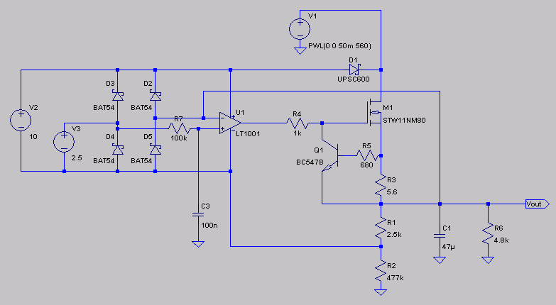

Trying LTSpice here...
C3 is needed to prevent the floating supply from bouncing once the final output voltage is reached. It also makes it real easy to implement a soft start. With the circuit as-is, it starts up in about 10 seconds.
I suspect I'll also need a cap across R2 as the negative rail for the op-amp won't be as tightly coupled to the reference node as it is in this circuit.
R6 is the load resistor.
The output voltage is 480 V. Max output current is 110 mA.
In the actual circuit, I'll add pads to form a local, high-frequency feedback loop (aka capacitor) around the op-amp. Just in case things get out of control at HF.
Sim says the ripple rejection is on the order of 100 dB(!). Boy, I hope that holds true in real life. Sounds rather optimistic, though.
