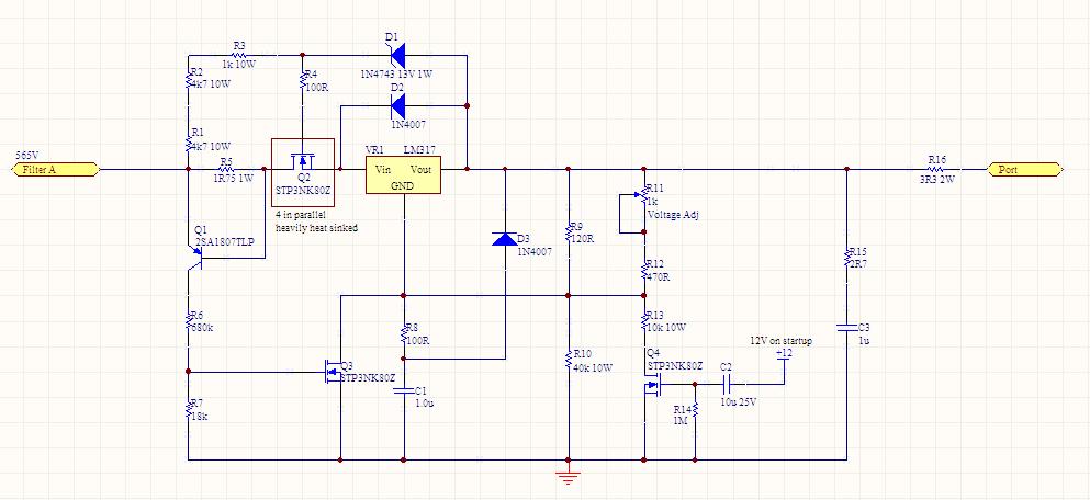

Hey Guys,
I redesigned my 500V regulator using MOSFETS instead of BJT's as suggested by SY.
I moved the current sensor circuit before the pass MOSFET transistor. When the current gets to 0.4A (0.7V across R5), R5 turns on transistor Q1 and pulls the voltage at the gate of Q3 to about 15V. Q3 then shorts out R10 which drops the voltage of the regulator. I put a 3.3 Ohm resistor (R16) on the output of the regulator so that when the regulator is at its minimum voltage of 1.25V there will be 0.4A of current supplied.
Since there will be a huge voltage drop from input to output during a short, there is going to be a lot of heat dissipated. This is why I put 4 MOSFETS in parallel that are heavily heat sinked. Furthermore, I put three 10W resistors in series which feed the 13V zener. During a short there will be approximately 30W dissipated by R1, R2 and R3 combined and just under a watt for D1.
I added a soft start using an RC circuit and Q4. When the amp is turned on, 12V is seen on the gate of Q4 thus Q4 is on. I put a 10k resistor in series with the Q4 so that the regulator starts at 100V. As the capacitor charges, the voltage at the gate drops and then the slowly rises to 500V. I set the RC time constant to 10s.
I built this regulator and it works really well. However, I have not tested the current limiting circuit since I have Q1 on order. The soft start works great too. At 0.333A load I was getting 60dB of ripple rejection so I think R15 and C3 will suffice.
Is there any comments or concerns? I came up with the current limiting circuit myself so I am curious if anyone has seen this method before. I hope the current limiting works. I should be able to test it tomorrow. Thanks everyone for your input. This is my first tube amp build and Maida regulator; so far everything seems to be going smooth.

Excellent!
I have to say that most ss regulators at high voltages won't survive a short. If yours does, you've got a right to feel a bit proud.
