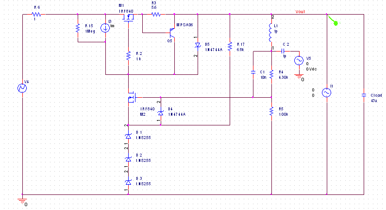

Folks,

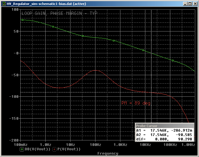

Here's where I'm landing. This regulator actually shows remarkable performance. I'll follow up with graphs later. Ignore L1, C2, V5. They are for the AC loop analysis.
The three zeners D1~D3 will be replaced by a 0A3. Powering the reference from the output side of the regulator resulted in an improvement of over 25 dB in line regulation. It should start up fine as the CCS supplies 1 mA through Q5, thereby, pulling the gate of the pass device high. This in turn charges the load cap and powers the reference.

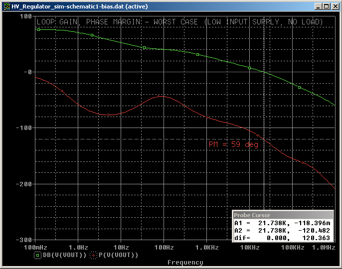

Worst case phase margin is about 60 degrees (high input voltage, no load). Under load with typical input voltage, the PM is about 90 degrees.
Using a CCS as a drain load on the error amp device boost the gain by some 20~25 dB. More importantly, it ensures consistent performance across input power supply variation.
The unity gain bandwidth is over 20 kHz. /me like...
~Tom

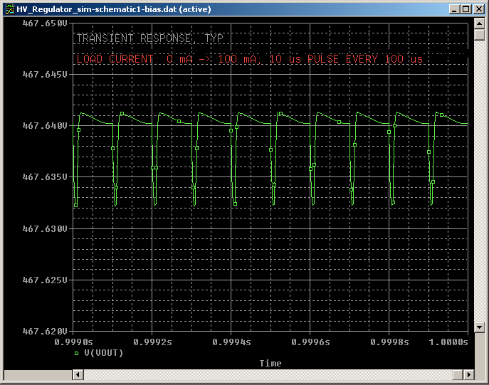

Plots

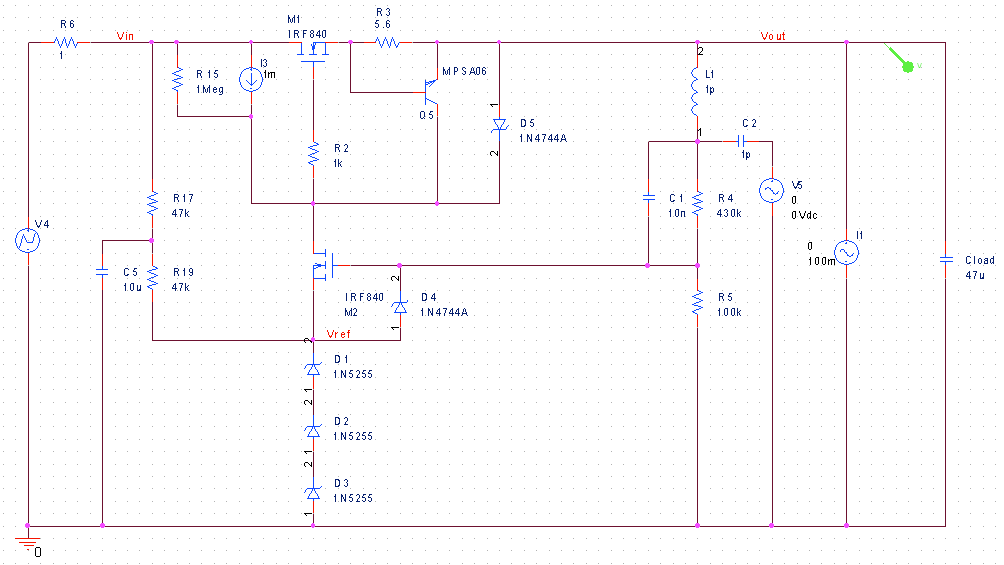

I went back to feeding the reference from the input voltage as connecting it to the output voltage seemed to create LF instability.
The latest schematic and plots are attached. Salas: It looks like 25-ish dB of loop gain at 1 kHz.
~Tom
Tom, I noticed you haven't split R15 and put a decoup cap in......try inserting that on simulation program...you will get a vast improvement on that poor -50dB ripple rejection. By doing this and relating the benefits to component layout, at this low ripple level one has to be careful with the neg layout that it won't take much to pick up the odd mV ripple from input rectifier-cap rectifier returns.
As a cap is fitted on the output, this indicates an undesirable pole in the Bodeplot response...so naturally reducing it will increase the noise.
The circuit I submitted appears overprotected but I live in quite a electrically noisy environment with alot of summer storms.
I get alot of queries regarding a high current low dropout 6.3V. There seems to be a shortage of suitable packaged devices so I've opened another thread on this with a discrete circuit to give others more ideas.
richy
R15 is actually a model of the output impedance of the current source. I the actual circuit I'll use one of the IXYS CCS parts. I slapped 1 Mohm in there as that's probably in the right ballpark.
Yep. It doesn't take much of a layout screw-up to ruin -55 dB of anything.
Unfortunately, that cap is required in the amp I'm driving with this supply. I could change the amp topology or change the cap size, but I don't feel like doing that. The amp performs well and the cap has been optimized for the best frequency response. Makes the power supply design a [FEMALE DOG]. Tough... 🙂
The main challenge I have with low-voltage, high current regulators is how to deal with dissipating the heat in a graceful way.
I've taken the route of not generating the heat in the first place. I use switching regulators... With solid performance too. If you're into switchers, check out National's SimpleSwitcher lineup. LMZ12003, LMZ14203 come to mind. LM2734 or LM3102 also.
I can justify dissipating 15~20 W for the amp supply, but for the heaters I go a different route.
~Tom
