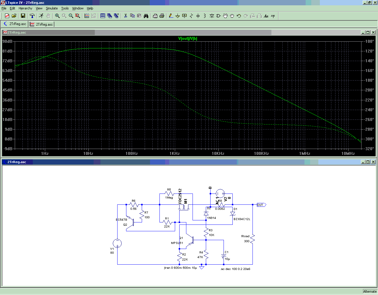

A discrete, protected regulator using a MOS ballast will be much more resilient than any BJT or 317 alternative.

I agree - a regulator with a single pass element should be capable of better dynamic performance than a "stacked" IC regulator. And better durability.
Have you built the circuit on the linked page? I am wondering about the aggressive pole formed by R3 and C1 - and the risk of oscillation at 500k .. 5MHz with that response. Does R4 zero it in time?
I prefer non-LDO circuits at high voltage though - the drain-output configuration in LDOs is much harder to tame, due to the open-loop behaviour, and difficulty with capacitive loads.

I didn't build exactly that version of the circuit, but I tried a number of similar ones.Have you built the circuit on the linked page? I am wondering about the aggressive pole formed by R3 and C1 - and the risk of oscillation at 500k .. 5MHz with that response. Does R4 zero it in time?
The schematic is bit misleading, because it upside down, but if you look more closely, you'll see that those components create in fact a zero, not a pole.
I disagree, actually. Run a sim of the loop gain and it's pretty easy to convince yourself of the advantages of the IC regulators. You do have to ensure that the cascode device will operate within its SOA under all operating conditions. If the cascode fries, so will the IC.
It's the same level of reliability for the discrete regulator. If the pass device in the discrete regulator fries due to operation outside its SOA, the regulator won't regulate.
~Tom
