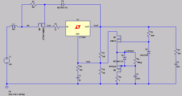

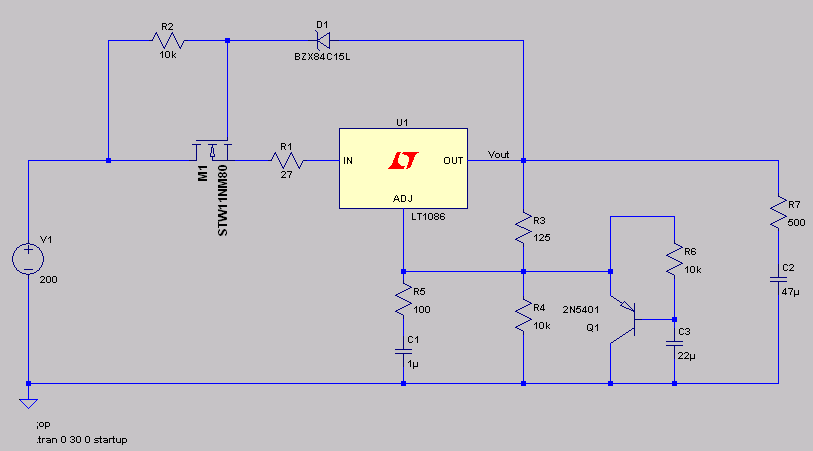

I had a sneaky suspicion that the soft start circuit wouldn't necessarily prevent SOA failures on the cascode device. So I ran a quick sim.
On start-up, the base of the soft-start PNP is grounded by the cap, but the transistor doesn't start turning on until the emitter voltage is at least 0.5~0.6 V. This leaves some time where the regulator is providing the full output current - limited by the Vgs of the cascode, the minimum drop of the regulator, and the voltage across the resistor on the regulator input. As I've described earlier, this current limit is actually rather ill-defined as none of the voltages except that across the resistor are guaranteed by the manufacturer of those components.
Using a MOS for the soft-start transistor makes matters worse as the MOS doesn't turn on until a Vgs of some 4~5 V is reached.
That said, the start-up current is much better controlled on the soft-start version of the regulator. It does peak at the value set by the current limiter - as predicted - but within 80 us it returns to a few mA (charging current for the external cap).
This is looking pretty encouraging. I think I'll build myself a prototype... If it works well, I'll follow up with some boards.
At 200 V, life is relatively easy. I'm using upwards of 600 V in at the worst case corner. Much more energy and rather more difficult to ensure reliable operation.

Hi, Tom. Good to hear from you. You're right, it is quiet here.

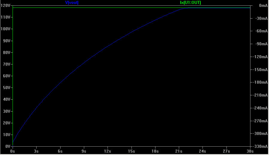

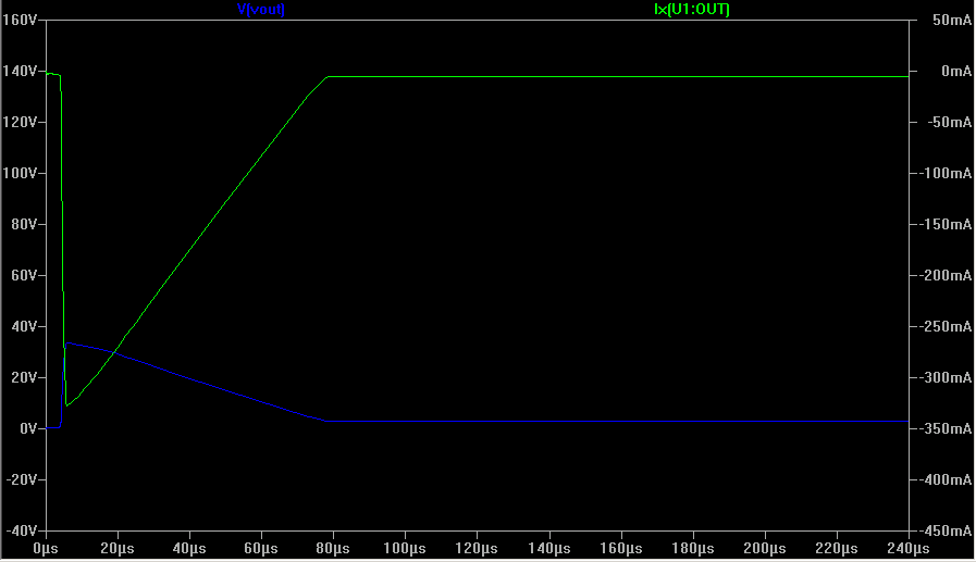

I tried shorting the prototype output with a 47uF capacitor added in parallel with the 1uF. The model predicts a modest increase to 22A during the short, but for a longer duration.
For the benefit of others who may be reading, here's what happens;
On switch on, the output gradually rises over a period of about 10 seconds, being regulated all the way up, until it reaches 144V in this example, and there it settles. When the output is shorted, the capacitors quickly discharge, releasing a burst of energy in the form of a spark, with some current going back through the protection diodes. The choke's high reactance at very high frequencies limits the initial discharge current and prevents high current surges through the protection devices.
Once in the shorted state, with output voltage around zero, the current is limited by the voltage developed across the resistor, I_LIMIT, and the MOSFET dissipates all the heat. The limiting current = (V_gate-output - LM317 voltage drop – MOSFET VGS(TH) ) / I_LIMIT or ~ (15 – 3 – 3)/270 = 33mA in this case. As Tom says, this is very approximate. The voltage across the MOSFET in this shorted state is nearly the supply voltage, so dissipation is around 6W for this design. More heat is generated during the short than it is at the beginning of a normal start up where current is limited by R_load plus that required to charge the capacitors.
On releasing the short, the cycle immediately repeats from zero output volts. If shorted before the final voltage is reached, the ramp is immediately terminated and, on release, the cycle then resumes from zero volts as before.
The spark was much more invigorating with 48uF and, yes, it survived the 10 or so cycles I put it through.

Bob,
For low currents and low input voltages, such as the 30 mA, 200 V in your example, you're not likely to run into SOA violations if you're using a reasonably beefy MOSFET - or even better BJT - for the cascode. I have no doubt that your circuit works.
My design target was 200 mA, 600 V and the regulator was designed to current limit around 250 mA as I recall. I turned several beefy (10 A, 950 V, 230 W rated) MOSFETs into silicon slag before I realized that they couldn't handle the in-rush current during start-up. However, that was without soft start. I think the soft-start should make it possible for the device to survive start-up.
Another option would be to use a tube rectifier. 5AR4 with its slow warm-up characteristic would be a good choice.
With the lower voltages, currents in your case we're not comparing apples to apples. Good for you that your circuit works, though.

Did some more simming. Found another potential pitfall. Again, this applies to my 600 V in, 470 V out, 200 mA design. Significant power is dissipated in the soft-start transistor during start-up. One will have to use a fairly beefy MOS here as well. High voltage, high power PMOS and PNP are becoming scarce. Hmmm...
