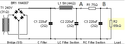

Hi guys. Sorry to drop in like this but I built a maida regulator exactly as in Morgan Jones Valve Amplifiers and have a few questions. I managed to get it to 320.0-320.1V stable. I use it to feed the final stage with 2xEL84 PP topology. Got ccs in cathodes set at 96mA (with lm317 as well). I intend to use another one for the driving/pi stages. Both need 320V as well and wondered if there are any problems with adding another one. First stages draw about 28mA together (I use 6n6p for both). My questions are about the psu. At the begining of the project I used a RC network, lately I added a choke to filter a bit and get some voltage back from the resistor it replaced. I get the voltage for the el84 regulator after the choke, and currently the voltage for first stages is taken after the next resistor in PSU. I saw some discussion on maida regulator topic and I am curious if I'll use regulators for all the stages, is there any point in keeping the choke? Should I just put the connection of the regulators at the first cap after the rectifier or it's better to keep the choke for additional filtering? I plan to use separate regulators for final stage on each channel and one on both driving/pi stages on each channel. That would be 4 regulators total. I added my circuit and current PSU. From the A point to final stage is the regulator and B (about 325-330V) goes to the first stages at the moment. R2 is the bleeding resistor.
The reg will eat up the ripple pretty efficiently as long as the trough of the ripple waveform is still well above the dropout voltage. That said, if your grounding is good, the extra filtering won't hurt and may even help a bit- ripple rejection isn't infinite. And the extra drop beforehand reduces the amount the pass transistor has to dissipate.
I haven't simmed your filter, but you might want to check it for stability in the face of a stepped CCS load. The first cap in the filter could possibly be reduced in size, which will lower ripple current.
To a 47-100uF? Also I see that you are recommending a 47uF cap in series with the final resistor in the regulator. I use a 2R7 one with 0.47uF in series at the moment.

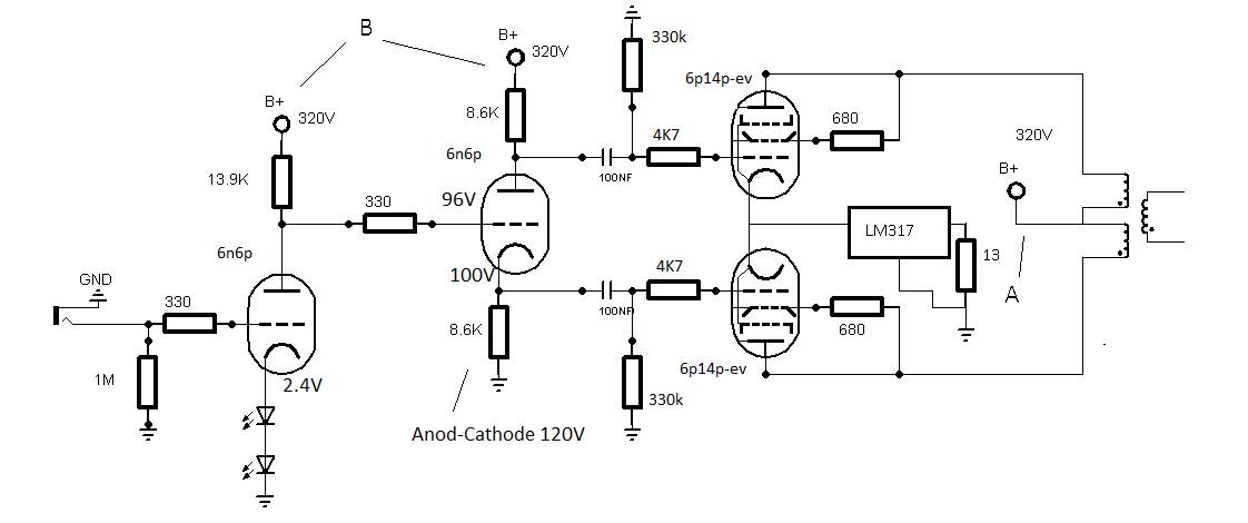

Do you recommend to change the lm317 ccs in the cathodes of el84 with a MOSFET cascode like the one in your phono preamp? Cathodes will be at arround 10V with about 100mA current drawn.
100 mA is a bit much for the simple DN2540 cascode. You do understand that using a CCS there will limit you to class A with very questionable overload recovery?
I tried your approach with led array and couldn't get more than 50mA on both cathodes. Don't know why, I built your RLD regulator as well in the setup. So I changed to CCS to get the required current for el84. My array was made from 6x7 red leds, and each had about 1.9V drop. That put it at 11.4V. Didn't put the 4R7 paralleled resistors in there, only the tail 1R one to measure the current. Max voltage was 280-290V from the regulator with pot at max. I really liked the led array and would have loved to keep it there.
There's a lot of variation in output tubes- if the idle current is too low, remove one LED from each string. With some tubes, I had to remove two from each string.
Ok, then. I will try it once again with less leds. I think the idle current varies between the EL84 RFT's and 6p14p-ev's. I noticed some changes with that swap. But this way I'll be limited to pentode mode. Is there any way to adapt for triode mode operation with leds in cathode? I also tried a global feedback with a 1R resistor following the 2 IR leds from driver stage, and I connected the resistor from opt secondary there between the resistor and led. Is this a good approach to global feedback with leds in cathode of driving stage? Pure pentode doesn't quite cut it for me. But I have bad opt's so I see this when I get my replacement C-core opts. Thank you and sorry to divert the subject of this topic.
Pure pentode works great if you use a feedback loop or a Schade-type connection. If not, you'll get excessive bass distortion and high source impedance.
For triode or UL, the only way you can finely adjust the idle current is with the B+, which is a tougher proposition than just changing the screen voltage.
I took out 7 leds, now I have 5x7 (7 parallel strings of 5 in series). bias at 9.5V and 72mA current.
G2 is at 304V via regulator. plates are at 306-307V.
If this is the best it can do I will settle for this if CCS is not good soundwise here.
Forgot to mention that it sounds better anyway! 🙂
