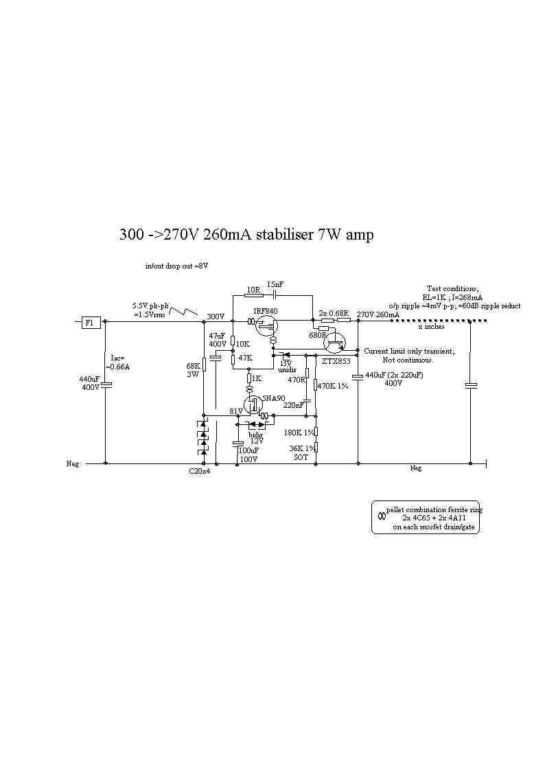

TRy ferrite beads in mosfet gates..they work wonders esp at 6MHz. The reason why I am fussy about reverse transients is that I work in motive power electronics when a single lightning flash to the overhead catenary is still the most effective spike in blowing up tram and train inverter electronics especially when 3 phase is created from a single and a spike crashes the lot. This makes EMC a nice little earner and is mighty expensive for businesses. Poor cramped multilayer boards with few earthing vias is nearly always asking for trouble.
I use a 10-47uF on the output. This adds an HF cutoff pole and reduces noise.
ANother bit of investigation is to listen to the noise on the output. :att'n:This bit isn't for experimenters....a good 0.1uF HV cap into an HP 311 audio analyser input terminated with a 600R resistor and output monitor into an amp/loudspeaker will tell one by the noise if pSU is about to oscillate. This takes skill and this carries a voltage risk. You know what you are doing in order to do it.
One of the drawbacks of designing for transients, it can lower the dv/dt circuit response but is the most secure and reliable. Notice, where there is a cap in the error or pole correction, there is a resistor in series with it.......to many this goes against theory but the problems can be worked.
Enclosed is a simplest version of a regulator I used for a 7+7W amp with considerably high o/p capacitance.

Yup, these aren't critical values......except carbon resistor used as spike dump. Carbon films are ok and be sensibly rated. The mistake many make is using m/o/film types which are useless for handling transients. The same holds true for the current sensing resistor often used in fixed bias o/p stage cathodes to ground, where a 1% wirewound is the best choice here.

I've been using BC components PRO-2 metal films for the majority of valve applications - they have a pretty damn good pulsed power performance, and one would be pretty hard pressed to not find them suitable for snubber applications if the layout could not be improved by a smaller part.
Constraining the gate voltage from drain dV/dt is a worthwhile focus, and may require a look at source resistor and zener layout, and possibly some more Cgs, and a lower zener voltage.

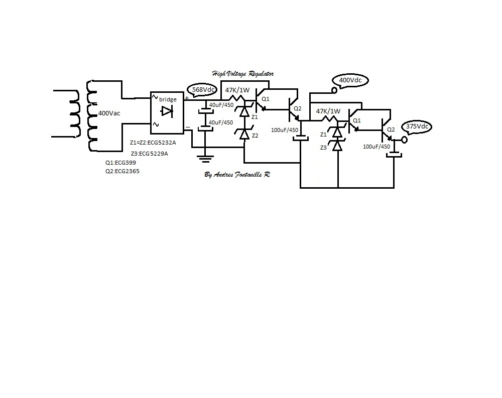

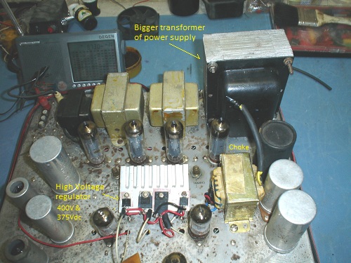

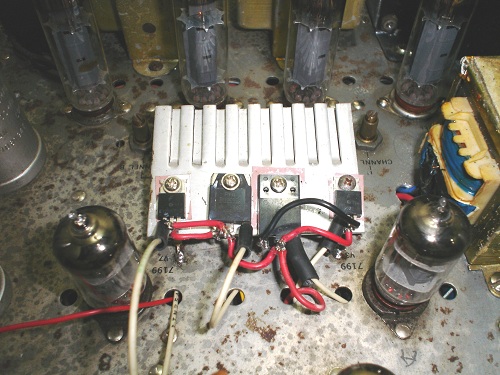

Hi guys
Why so much complication with a high voltage regulator? I built this simple regulator and fine work. only need to use the appropriate zener and a good sink
