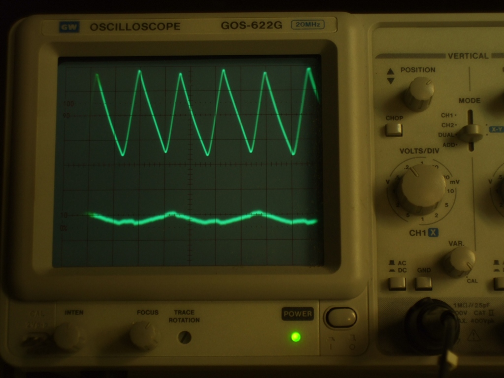

Attached is the ripple traces of the TomChr Regulator. Top trace is Vin ripple of approx 7V p-p and bottom trace is Vout ripple of approx 5mV p-p. The Time is set at 5mS/Div. The rectifier is a 5U4 with a 40uF capacitor. Vin into regulator is 489Vdc and Vout of regulator is set at 394Vdc. The hash on the Vout is approximately at 60kHz and that is why the trace looks fuzzy.
Do you have any idea why the V out ripple has this weird pattern to it repeating every 16 mSec? Any idea why there is a 60kHz oscillation on the output?
Have energized the regulator several times and it starts up smoothly and the measurements are repeatable. Have loaded it to 160 mA with no issue. All I need for the design I am presently doing is 120mA. Temperature of the mosfet case has stayed below 30 deg C on the fan cooled heat sink.
1/60 = 16 ms. So what you're seeing is likely the ripple from the op-amp supply feeding through.
On this schematic: Neurochrome.com : : Audio – High-Voltage Regulator
what are your values for Q1, R4, R10, and C3?
With the values on the schematic (R4 = 2.7 ohm), the regulator will current limit at around 100 mA (or maybe 120 mA). You need to decrease R4 to something like 1.8 ohm if you intend to draw 120 mA continuously. That could be the source of the 60 kHz and weird ripple pattern.
Another potential source of HF oscillations is the gate-source cap of Q1. That's why I added R10 and C3. If decreasing R4 doesn't take care of the 60 kHz, I suggest increasing R10. There should be no HF buzz on the output of the regulator.
But my guess is that the current limiter is playing games with you. That current limiter doesn't play nice. It does the job, but it has fairly high gain, hence, you need to ensure that it never turns on during normal operation.

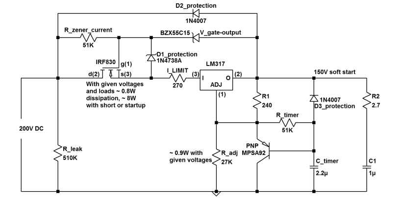

I came here to find a ready made PCB for an LM317 HT regulator with soft start. Nothing on the web it seems. I'm thinking of a design more or less straight from the data sheets like this.
Can anyone see anything wrong with it. It looks like it should even withstand a shorted output. Haven't tried it yet.
With 200 V in and a beefy cascode, you may be able to get the regulator to survive an indefinite short circuit. But note that the "current limiter" of the Maida regulator is really ill-defined and soft. Basically, what happens is that the LM317 runs out of headroom as the voltage across the cascode and input resistance to the '317 gets too large for the '317 to maintain regulation.

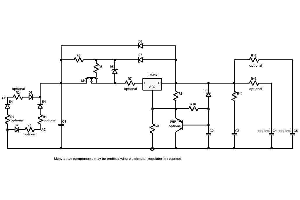

But I'm also considering revisiting the Maida Regulator. It's a pretty rugged regulator and works quite well for low voltages, currents. It would be nice with a beefed up version.
If you do go there, Tom, it would be useful to make a versatile generic Maida PCB which makes provision for;
1 A soft start pnp such as MPSA92 or higher voltage equivalent. The nodes are already there in the Maida circuit. It just requires 3 extra holes. Simply don't use them if soft start isn't wanted.
2 A current limiting resistor before the 317 input.
3 AC input, i.e. full wave input rectifier diodes with optional series resistors to provide the low noise equivalent of a valve rectifier. This followed by a beefy smoothing capacitor.
4 Two optional RC output filters such that outputs can be directly wired to a valve amp or to each channel of a preamp.
I'd buy a couple of them to help spread the cost. I'm thinking of this, perhaps with other optional add-ons;

Actually, R6 in the previous circuit is redundant and D5 should have been connected directly to gate anyway, so I've removed it and re-named the resistors.
Enough for now. It's best that I build and test the circuit to see if it's worth pursuing any further. I'll order parts tomorrow and, hopefully, report my findings over the weekend. I'll monitor;

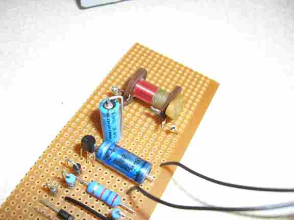

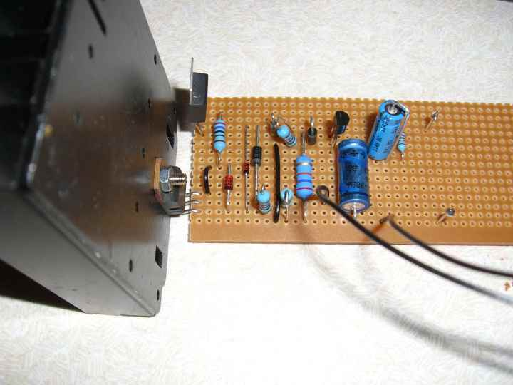

I built the prototype today and tested it without a load. The attached images show the prototype and the actual component types and values used.
It appears to work well. The soft start behaves very much like a valve rectifier, gradually increasing output voltage (over about 10 seconds with values shown). It isn't a linear ramp as would be the case with a P channel MOSFET since the pnp base draws a little current, and the timing resistor value needed to be approximately halved to get a similar time constant. LTSPICE predicts this.
It gracefully changes voltage state on repeated switch-on/switch-off of the unregulated (but smoothed) DC supply used.
Enough for today. Tomorrow, I'll try and destroy it.

I probably wouldn't include the input rectifier and reservoir cap. Those are very application dependent. The reservoir cap is also huge - in my setup at least half the board area if not more would be reservoir cap. So including those caps would basically double the board cost. These components are easy to place elsewhere in the chassis and easy to mount on a piece of vector/vero board.
I hope you're not in a rush. Nothing around here seems to happen in a hurry... Between work (you know what pays my parts budget 🙂) and hockey, there isn't much time for regulator development. That said, I've been known to suddenly get the bug and get stuff cranked out. Stay tuned.
My main challenge is that I need a regulator that'll provide 470 V, 200 mA without blowing up when loaded by a capacitive load. Accounting for mains variation, this means upward of 600 V in... Lots of energy to blow stuff up.

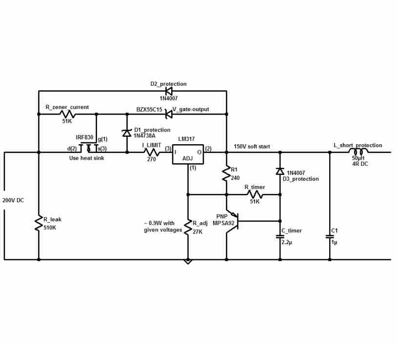

I started to look at ways of bringing the regulator output line down gracefully in the event of a short circuit to prevent the predicted high current surges through protection diodes and zeners.
My simplest idea was to use an inductor, and LTSPICE showed that 50uH was sufficient (reactance 3.14 Kohms at 10MHz), the DC resistance not being too important. Eager to try it out, I robbed one from a scrap valve oscilloscope and soldered it to the output of the prototype I'd made.
I removed the 2.7R resistor in series with the 1uF capacitor from the prototype since it typically represents the electrolytic capacitor's series resistance anyway, and I set all capacitor series resistances to 3R in the LTSPICE model.
The model predicted a surge of 17A during a short so I switched the prototype on and braced myself for a good spark. It was disappointingly small. Many repeated shorts were carried out at different times during the voltage ramp without damaging effect.
An RC filter typically comprising 22R and 100uF could be placed before or after the choke, according to SPICE, or an (R+L)C filter could be used.
It's interesting that the circuit diagram for the scrapped oscilloscope shows that these variable 50uH inductors were used in series with 4.3K or 3.9K load resistors in ECC88 differential amplifiers and tuned to produce optimum square wave response. That noted, the protection inductance could be used to enhance the performance of the amplifier in many designs.
So there it is. A high voltage soft start regulator, tolerant to shorts and now looking very bullet proof.
