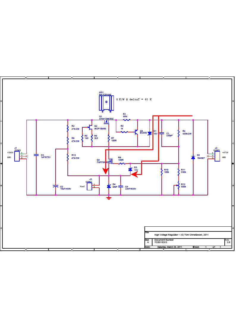

The final schematics and bill-of-materials attached. Enjoy. I have included the Digikey part numbers, but, of course, the parts can be obtained elsewhere as well.
~Tom

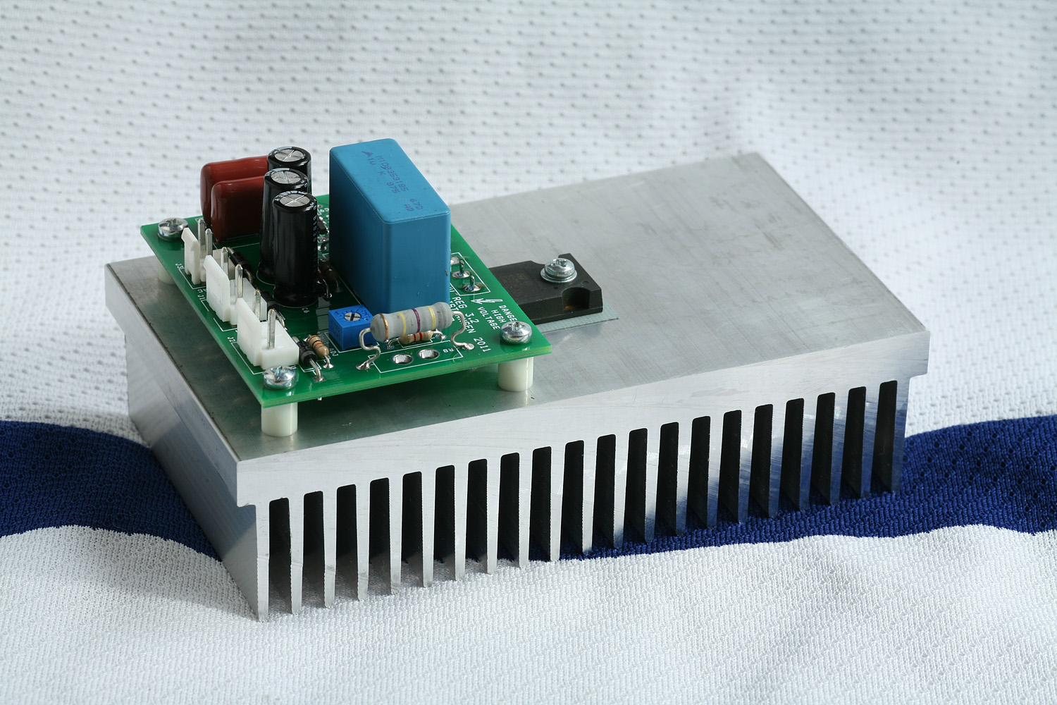

I decided to build my regulator as a module (stare at attached image).
The heatsink is a 5.375" wide, 3" tall profile from Heatsink USA. The reason for the rather large heatsink is that the input voltage is rather high - about 575 V nominal. At 200 mA output current, this results in about 20 W dissipated in the pass device. As I generally don't like having heat sinks run hotter than about 60 deg C, I went large...
After one hour at 205 mA output current, 575 V input voltage, the heatsink reaches 60 deg C with 25 C ambient measured by an IR non-contact thermometer. At this temperature, the pass device case reached 82 deg C.
With the component values on the schematic/BOM, the regulator will deliver a bit over 100 mA. To support 200+ mA, I changed R4 to 1.5 ohm.
~Tom

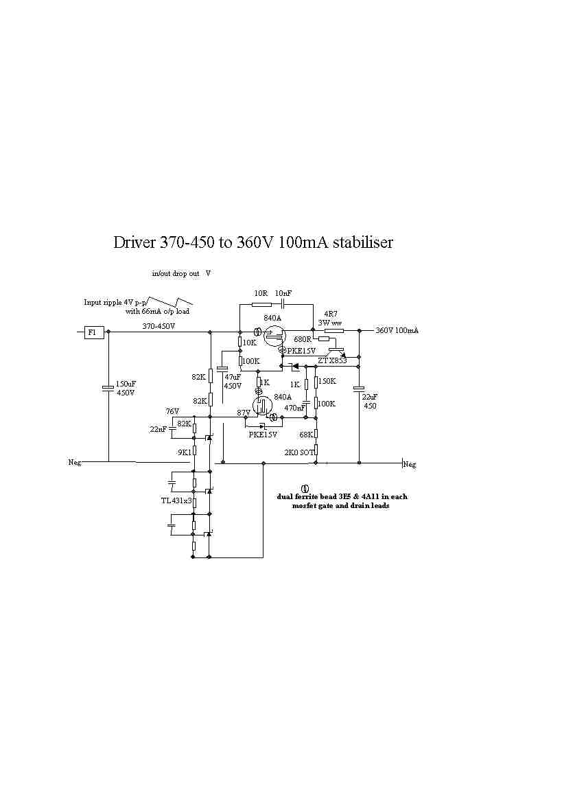

Often stuck in situations like this, I use several sections of programmable TL431 in series which have a much lower dynamic resistance. > More components, yes but I find the performance worth the trouble.

TL431 can take 37V max.....however it's only a small bit of sand.. lets be fair to the device.... I aim for 30V or lower. Brainstorming a 5 min botchup, a few 431 devices put in part of a reg design can work wonders. I added an external TVS's as protection as my electrical area is quite spiky.
This configuration works and part of my power amp designs.

Tom looking at your pdf schematic, I notice with no ouput cap there is a possibility for a reverse transient to spike through D1,Q4,D4 although this swamped by the 22nF and to a lesser extent C1,D3, D4 same comments as other. You probably see what I am getting at....a nasty dv/dt transient reverse spike created by an output socket connection or connection whilst on will destroy one of these components leading to another.
My survival experience with such circuits is a soft transient return path must be provided, this is where carbon resistors are excellent. Metal oxide and metal films are hopeless for transients and will go "high" but fine for reference stages.
Instability must be avoided......this causes unwanted dissipation and worse still, "birdy noises and whistles" which are easily picked up in amp stages.
Correctly designed, the noise floor my regulator is quite low, -90dB down and ripple rejection around -80dB. With this type of design, the Line voltage variation performance to output voltage does vary a few mV but still good.

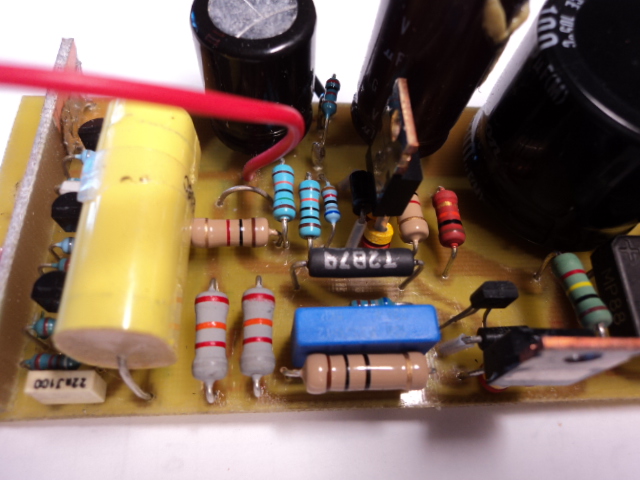

Enclosed is a pic of my regulator. note ferrite beads on mosfet and the use of a wirewound resistor in the current limit. Essential !
To constructors, note components are elevated off the board, the reason is anything stuck around components is easily seen and dust easily blown off.
For a second you had me confused there.... You're referring to the older design (Rev. 2.0) not the new, floating design (3.2).
How much output cap would you recommend as a minimum to deal with such reverse spikes?
Yep. That's a really good point, actually. Thanks for bringing it up.
