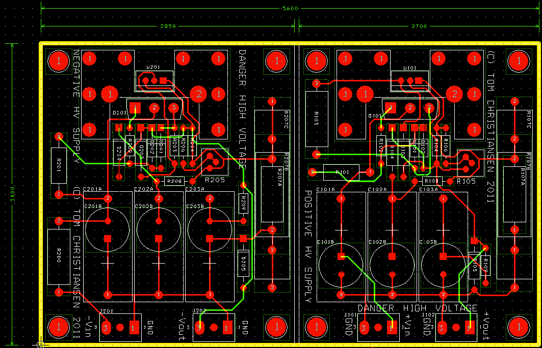

HV regulator boards are taking shape
Folks,
I figured I should let you know where I'm at with the prototyping... Stare at attached.
Note that C101, C102, C103, R107, C201, C202, C203, R207 have multiple options. The idea is to allow for either a film cap or an electrolytic cap in case of the capacitors. The resistor options allow for using 3W, 5W, or 10W types. This allows for a fair amount of flexibility as far as input and output voltages go.
R200 is in series with the input to the negative regulator. It ensures that the cascode device, Q201, doesn't fry in the event of a short circuit on the negative supply.
The image shows two boards on one panel. The end result will be two separate boards.
I plan to build a prototype using toner transfer before committing to a PCB fab run. I'll let you know how it goes.
~Tom

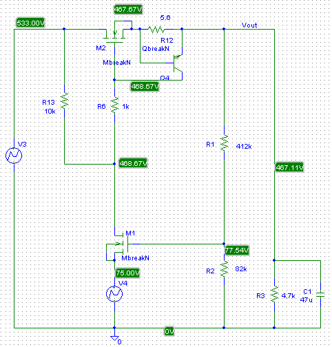

How to straighten the tempco of this circuit
Attached shows my latest incarnation of the high voltage regulator. It's pretty straight forward. I chose MOS to avoid base currents of BJTs. Power BJTs tend to have rather crappy beta, hence draw an unfair amount of base current. This forces resistors to be lower, hence burn more power. I have a small-signal BJT handling current limiting by sensing the voltage across a 5.6 ohm resistor. The current limit is about 130 mA.
I still need to add the compensation network so this circuit is by no means complete.
However, as an engineer and, thus, perfectionist there is one thing that bugs me a little bit. Due to the Vgs variation versus temperature of the error amp MOSFET, the output voltage varies about 1 % across temperature (0 C --> 125 C). I would like to straighten that out a bit. Does any of you have ideas on how to do this?
The temperature of the error amp device and temperature compensating device need to track. So they could be two identical devices mounted back-to-back on the same heat sink. Easy. One could be hooked as a diode in series with the lower resistor (R2) in the feedback network. But in order for this to work, the two devices will need to operate at the same current density, hence, I need to burn 5~6 mA in the feedback network. A bit rich for my blood...
Any other ideas?

I assume R3 is your dummy load?
A 1% thermal error is not exactly the end of the world, but you can use a diode in the reference string to compensate if your circuit is really that critical. But that 1% error isn't even close to being the performance limiting factor- your main problem will be poor regulation because of the low feedback. A speedup cap across R1 will help, but not nearly as much as increasing the reference voltage to something more like 100-200V.
If it were me and I didn't want to use a Maida (big "if"- they have always performed reliably and well when I've used them), I'd have the error amp be a CCS-tailed diff amp so the the reference voltage could be filtered. I'd make the error amp with bipolars to improve regulation. You'll want to stopper the MOSFET gate- R6 is on the "wrong" side.
Yep.
That's certainly true. 4~5 V variation on 470 V is not the end of the world by any means. I can always adjust the voltage at hot temp as the devices will dissipate a fair amount of power and run hot anyway.
I haven't sim'ed regulation yet. But the loop gain is on the order of 60 dB so I would be surprised if the regulation was that bad. Not thereby saying it couldn't be improved. In fact I would like to improve it.
Correct about R6. Oops... Good catch.
I tried several incarnations of the Maida regulator. The main problem is that the current limiter is relying on the Vbe/Vgs of the cascode along with the drop-out voltage of the LM317 to work. For resistive loads or small capacitive loads, this is not an issue. But in my case, I'm driving 47 uF with the regulator so the regulator will need to be able to survive starting up into a dead short. Aside from changing the topology of the amp I'm supplying (which I have decided not to do), there's really no way around it. I like the Maida as well, but for this application, I'm afraid it's out.
I'd like to filter Vref as well. Diff pair... DUH! Why didn't I think of that.... 🙂 That would also eliminate the thermal issues associated with the Vgs of the error amp in the circuit above.
I'll take another spin through the sim cycle...
Thanks for your inputs.

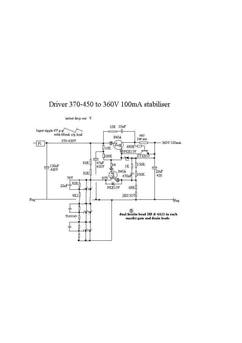

One thing that helps you is that the impedance doesn't have to be ultra-low. You're running a tube circuit and it's class A.
Have you looked at Jan Didden's HV regulator? Very nice design. I've used one on my breadboard with excellent results, and it will be in my next power amp.

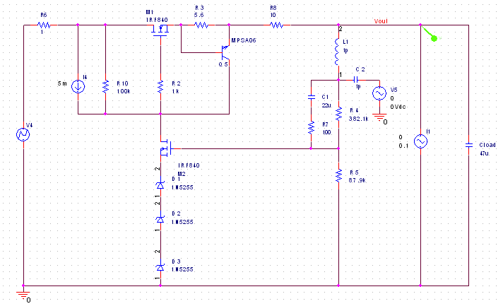

I ran a couple of sims on attached (sorry for the crappy image quality). Ignore L1, C2, V5. They are used for the open-loop analysis (in that case L = 1 kH; C = 1 kF; V5 = -1 VAC and Vout shows the loop gain).
Here are the results:
Line regulation: 75 dB up to 10 kHz (70 dB @ 30 kHz).
Output impedance: 100 mOhm (up to 30 kHz)
75 dB DC loop gain, 30 kHz UGBW, PM = 74 deg, GM = -28 dB.
That's pretty respectable. Of course, I'm not going to use IRF840's as they won't handle the voltage, but that's what I had models for. It shouldn't be too far off from reality.

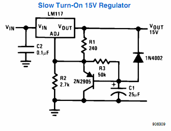

There are features I could wish for that I don't see implemented in this circuit. Soft start being one. Though, the current limiter takes care of that - kind of. It would also be nice to have a filtered reference voltage. But in terms of simplicity this is tough to beat.
~Tom

Looking at the zener string, this is an achilles heel...poor dynamic regulation (high impedance) will cause temp/voltage variations and is noisy. I use a string of TL431's which are the perfect sources, but what's missing in your diagram is zener voltage feed otherwise it won't start.
My experience a fast zener or TVS is required across mosfet G/S imperative against spikes. This circuit enclosed I use alot cobbled from the junk box. Notice the extra cap ripple rejection feed. That makes a BIG difference. The cue in HV power supply circuits is to avoid too much gain that can cause oscillations so ferrite beads to fitted to mosfet drain & gate.
One can improve these circuits no end but they are reliable. A similiar approach can be done for the high current 6.3V, with a very low drop out but that can come later.
richy
richy

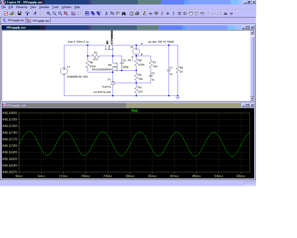

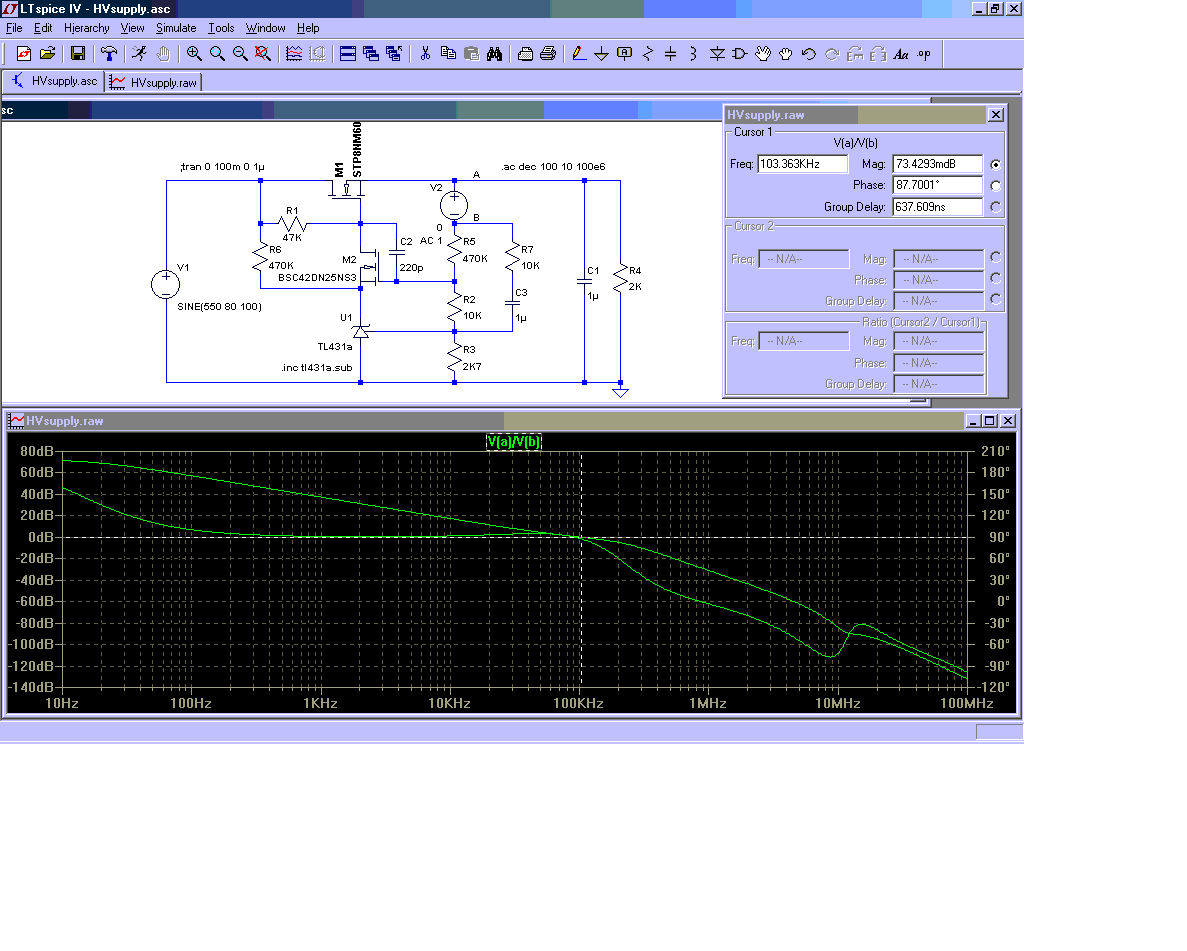

This kind of topology can be implemented using a TL431 as a "supertransistor", having superior gain and voltage stability.
Here is an example, cascoded with a MOS for high voltage operation.
The circuit just illustrates the concept and lacks protections: zeners across G-S of MOS transistors, current limiter etc.
The transistor types also are unsuitable, M2 in particular, they were picked for a quick sim, but it shows the principles.
The circuit has decent performances and good stability for a minimal complexity.
Tom, you want C1 from your schematic (the speedup cap) to be a lot smaller. 1 or 2uF is enough to get you the benefit of low source impedance at audio frequencies without excessive slowing down the regulator recovery from load changes.
Rich's point about the Zener noise is spot on. That's one reason that using a diff amp for the error amp is useful- you can filter the noise more easily since the base or gate of a transistor is a higher impedance point than the emitter or source.
Yeah, I wasn't too thrilled with the 22 uF either. It does give me higher phase margin, though. But I need to find a better compensation scheme.
