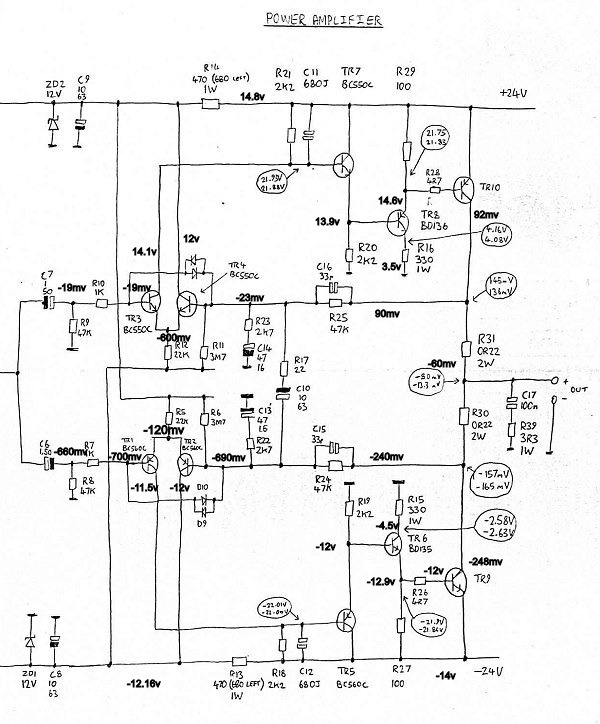

Here are what I measured based on current situation (protection bulb bright, hence dropped rail voltage, amp sound fine ). Please not the voltage drift a bit during measuring because of the series bulb used, it makes power rail voltage not stable. so the voltage I measured across the circuit, will be some inconsistency depends on time its been measured. but it should still be able to provide some kind of knowledge about what is going on.
Please only look at the voltages in Bold, not in circles which comes from original schematic.

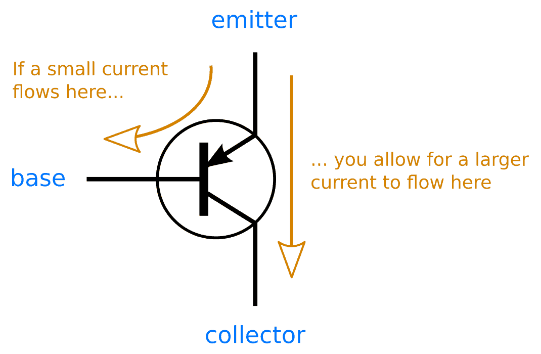

Tr1 and tr2 here is pnp transistor, the current should flow out of base, like this.
But here I don’t understand where the base current of tr1 and tr2 go,seems everywhere they connected to has higher voltage than the base.
what is actually happening here?
the working channel as comparison looks fine and logical
I think you've made a succinct statement of the mystery. Where are these strange currents originating? Earlier posters suggested carbon tracks as a possible culprit (posts 20 and 38). I think that may have merit.

Because it's tied to a positive supply, I doubt R6 is the problem. I can't see how it could lead to the negative base voltages that are so problematic and baffling.
I agree that the value of R6 and R11 is an important issue. They help establish the claimed 700mA "standing" bias current. Since you've raised the supply voltage to +/- 30V, that implies 42 Watts per channel, more than 84W for stereo when accounting for earlier stage dissipation. Hence, the earlier suggestion to make R6 and R11 = 22M.
At present, carbon tracks are the only mechanism I can think of to explain the weird symptoms. The only method of exploring this notion that occurs to me is to purse my proposal in post #78. If the carbon suspicion is correct, the strange bias voltages will remain at the end of step 2. Assuming this is the case, next step would be to remove TR1 and TR2, and look for voltage drops around the bias paths that don't make sense. Carbon adjoining nearby tracks with negative voltages would be chief suspects. Carve on suspect areas with a hobby knife to see if that reduces the errant voltages.
I agree with BSST in #85 that tracks should be thouroughly inspected and measured.
The large amount of current causing a massive amount of voltage across R18 (2k2) cannot be easely explained.
Suppose the right or maximum current is running there (voltage across R5 / R5), say 0.5mA, 1V over R18 is also a maximum.
But 1.5V over R18 implies more current, or a increased value of R18, or a bad contact (bad track, bad soldering) there.
Given the various blackened spots, a discontinuity is apparent.

"...2v base/emitter at TR9; 0.9V across R26 in the wrong direction if TR9 is biased on..." I missed that one, very well observed!
"-11.5V at base of TR5 should yield -10.9V at emitter instead of reported -12V" TR5 cannot conduct and not conduct at the same time; what's happening there?
I was also thinking of a nasty (partial) shorting down under somewhere, carbon or otherwise.
Rails drop by serious increased current through... TR10/TR9 are the usual suspects. Hence the bulb condition.
I've already shown my concerns about various caps (C6, C7, C13, C14, C10), which are wrongly reversed and should be bipolars or poly's. But that would not explain the negative rail side to go out of its normal setpoint enough.
So again, ... spark! (while typing)
TR5 does not conduct but is forced as much as possible by TR1/TR2 and the feedback loop to open. So, there must be a nasty shorting near or just after TR5 preventing this! TR9 can do such a thing, notice the voltages across R26 and the Vbe of TR9. Your analysis!

1. Lift one end of resistors R6 and R11 so these are out of circuit. At this point I would make a quick powered check to see if biasing becomes more sensible. Doubtful we'll be so lucky.
2. Solder temporary jumper wires across R16 and R21 and install a 1k resistor across the speaker terminals. These steps should place TR9 and TR10 in cutoff; any leakage will appear across the 1k load at speaker terminals. Further, both long-tail-pairs should be biased at 0V, both at input and output--- quasi balanced. Maybe it will be easier to to spot problems in the input pairs.
step 1, lifted r6 and r11 when powered on with bulb in circuit, rail voltage initially keep rising in tens of seconds, up to about +-22v, with bulb become dimmer. Measured tr1 emitter voltage become positive, about 250mv. While base still negative.
and then the rail voltage started fluctuating, jump up and down with bulb dimmer - brighter -dimmer, back and fort.
tried to remove the bulb, transformer stared making noise, r30 and r31 become hot very quickly, so I powered it off soon.
I think this doesnt help much, right?
Interestingly, when I solder r6 and r11 back on, and power on the amp, this time everything looks very promising actually.
with bulb still in circuit, I got about +-30v rail voltage. Bulb is very dim (as expected it the amp is normal with no unusual bias current)
when I measured, every voltage is good as it should be,
r8, tr1 base small positive value
tr1 emitter 550mv
tr2 base small positive value
r15 -2.5v
tr9 collector around 200mv
all values becomes perfect as they should be
only problem is bulb occasionally becomes bright for 1 or two seconds and then back to dim. So it’s no very steady yet.
