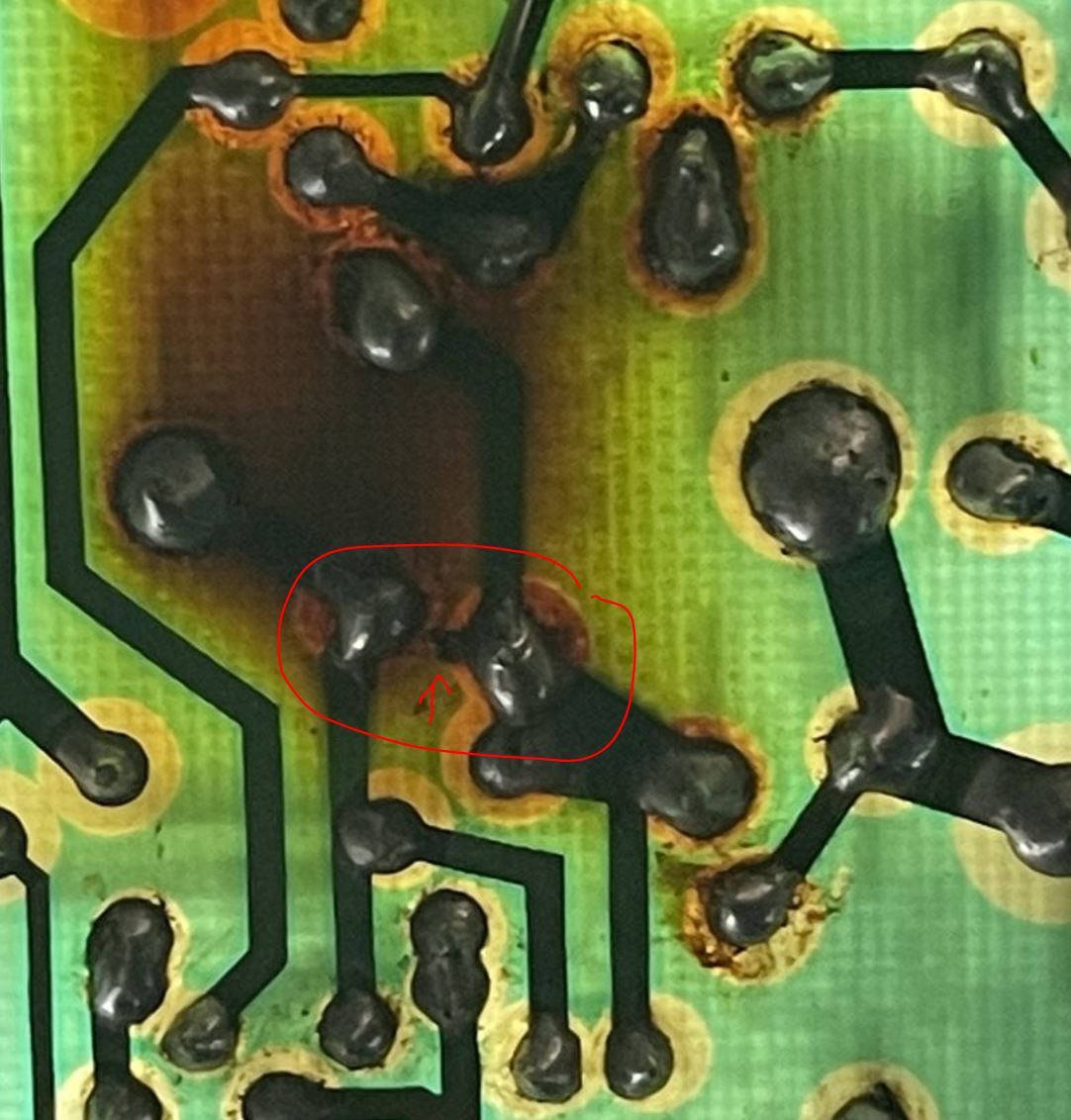

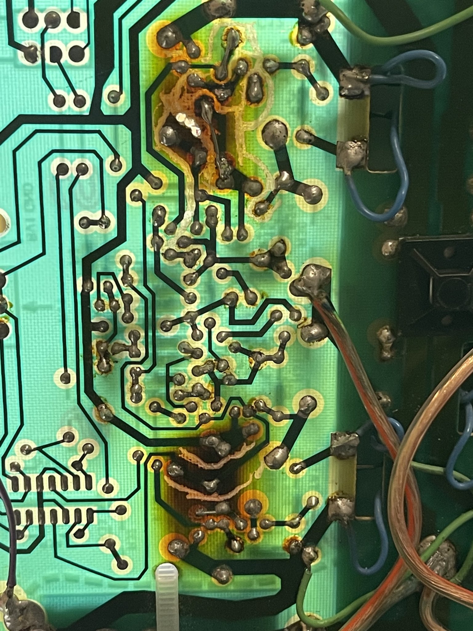

I get lost trying to find where the scorched areas are in the circuit, Is it inescapably clear that the burned spots are caused by the Zeners and their bias resistors? The 24 volt rails in the original schematic imply ZD1 and R13 each dissipate 0.3 W. This is way more than needed but is it enough to cause the damage observed?
Any thoughts about how to proceed this amp? I'd still like to help, but sure what to suggest without some guidance.
The practical options for repair have already been discussed. It's time to choose whether to make those repairs, assemble and fit replacement boards or quit fixing. You could offer the case and power supply to someone else who wanted to build with the available PCBs and get at least some cash for it.

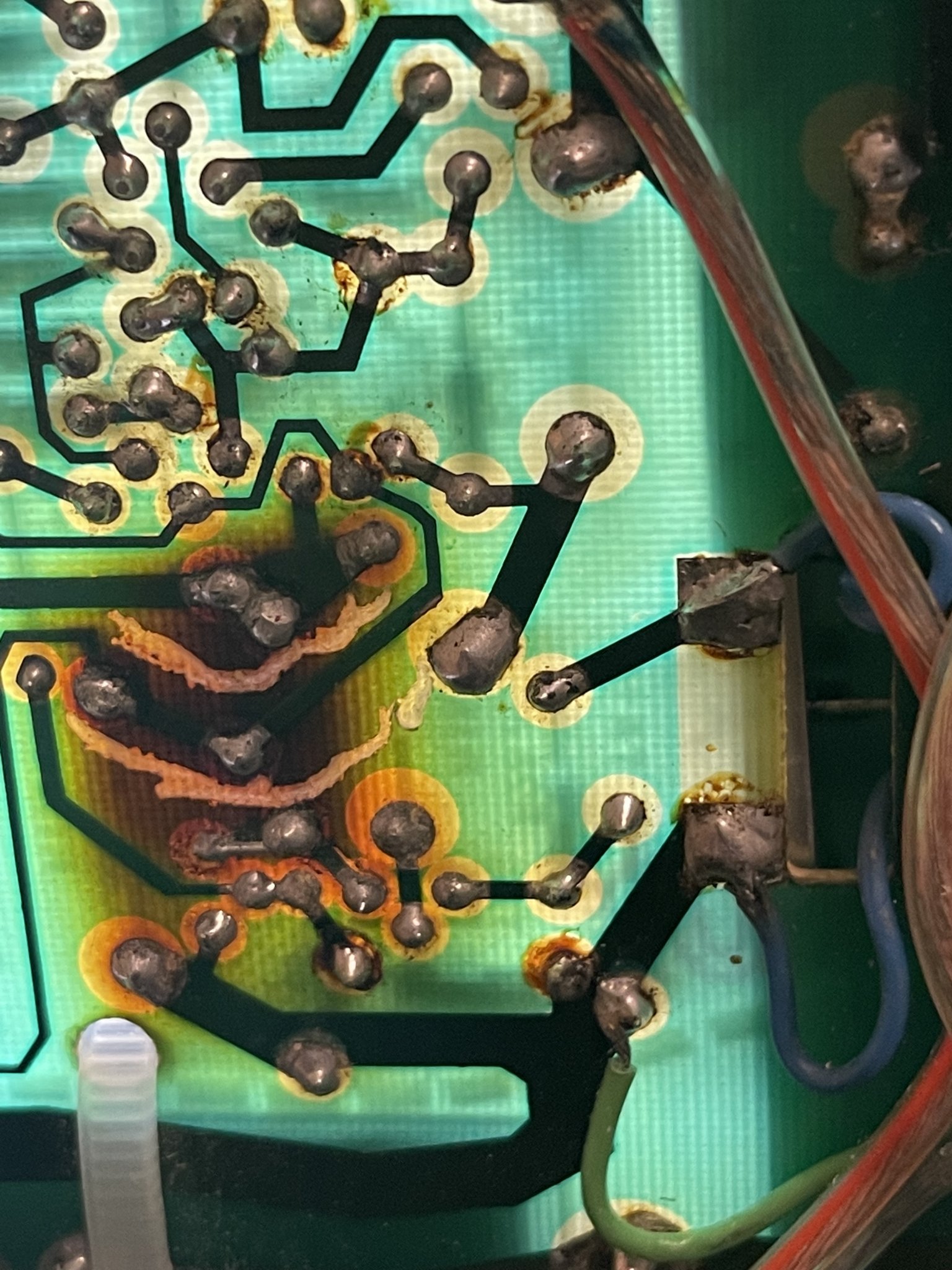

As BSST mentions, the dark spots are are mostly due to overheating of the zener diodes and had they been located well clear of the PCB, the bad charring as well, may not have have occurred. The green dye used to colour the epoxy resin is very heat-sensitive and would darken eventually anyway, even as low as 45C internal temperature. It would not surprise me that this amplifier had been left powered up for days at a time and on several occasions either, so the problems may just have combined eventually into failure. At least there was no fire, which can happen when you operate these amps with the heatsink cover plates removed.

But it looks like I am best off make a new pcb myself, shouldnt be too hard right? I am new to these stuff obviously
If the PCB is not burned/broken, then I do not think there is any reason for doing a new one ...... then it would be more fun to do a completely new and different amp.
Did you check the area I pointed out?

As for the Zenner, the issue here is that if it is mounted with the resistor value feeding it as used in the integrated amp, a lot of current (and a lot of unnecessary current) will flow through it. In the Integrated version the zenner regulator is also feeding the input section and therefore most of the current will flow in that direction and leave the diode with only a fraction (or at least much less) of current load. Also if the resistor value was not changed from the low voltage A1 version to the higher voltage version here (32V), then of course the current through the zenner will be even higher (don't know if this is the case).
For the MA50 you should only have a few mA flowing in the zenner. I would say 3 mA. If you use 4.7k for the resistor, instead of the 680 (or 470) ohm.
This will lower the zenner disipation to about 40mW and 85 mW for the resistor.

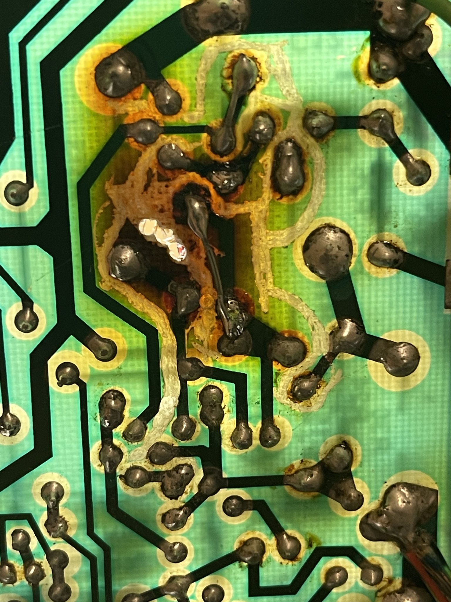

As people suggested, I carved the burned area as much as I can without completely remove and rebuild it. See pictures attached.
It seems improved a bit after that work, I am not 100% sure.
Now tr1 and tr2 emitter are around 480-500mv, about 100mv below ideal case.
Tr1 base still negative around -60mv, thats about 90mv below expected.
R15 is around -3.5v, thats about 1v below expected.
