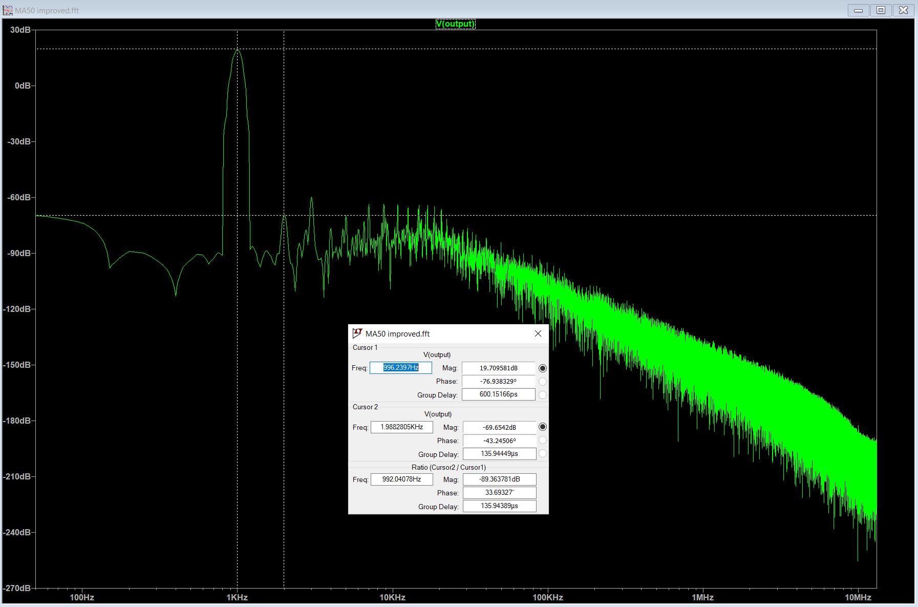

Just messed a bit with the simulation, and there are plenty of ways to improve the performance without changing the circuit much.
Firstly changing the output transistors from 2N3055/MJE2955 to 2SC5200/2SA1943 gives a ca 20 db improvement.
Increasing the current in the input stage to 1.5mA, Increasing the amplification in input stage, and increasing the current in the driver stage (this will require small heatsinks on the DB139/BD140) gives another +20 db. All theis at 1kHz and ca 14Vpk output / 0.775 Vpk input.
Increasing the currint in the input stage will require 2 small caps as shown to eliminate starting oscillation.
Better than increasing the current in the output and getting so much heat you need a fan.
The above will have to be tested further also ensuring better performance at higher freq, ensuring no oscillation etc. .... most can be done in sim, but using an oscilloscope at the end to ensure no oscillation
PS. No sim is better than the models used, so don't trust the overall figures, but for sure the trend ... if it increases the distortion in sim, it will most likely do the same in reality
PPS. An then there is the bigger question, if we can actually hear the difference .... I highly doubt it 😉 ..... but it's fun anyway 😀

I am currently using MJ21193/21194G as output transistor, I have bought 4 pairs of them, so not likely to swap them. These transistors looks good to me as simulation shows without other improvements you mentioned, I still got not bad distortion figure. I found the spice model of these transistors from onsemi website.
I will have a look into the improvements you suggested. Its quite fun to test things in the simulation. I never used simulation before, thank you for bring me into this wolrd.
I dont have much experience in the circuit design, so will be hesitant to change the original design in real world, in a risk of ruin something that I dont have experience to resolve. Will start the investigation in the simulation. To learn some knowledge and have some fun.
In terms of this amp itself, it obviously dont have very good spec of things like THD as modern amps have, but it does have some magic that sounded very nice to my experience. Maybe someone more knowledgable can explain why is that

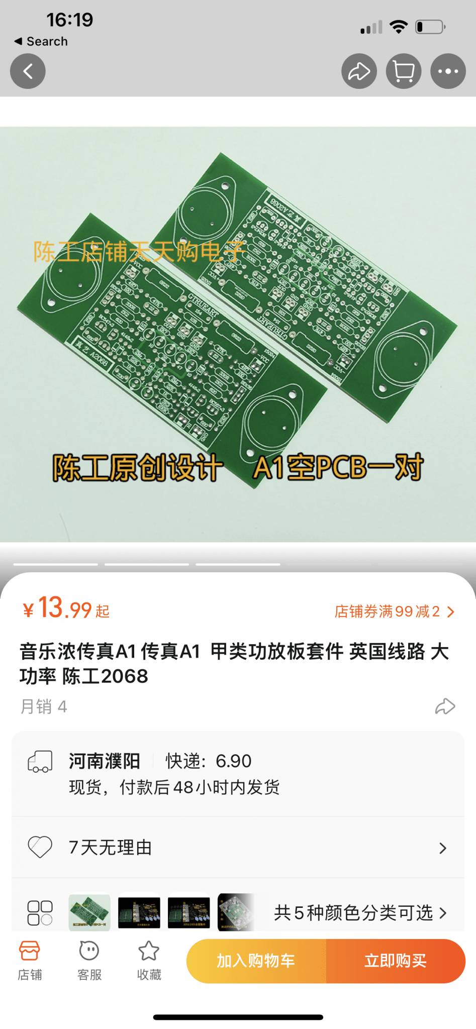

This PCB to be honest is quite hopeless. The quality is quite bad from the beginning. After a few solder and desolder, a lot of place have contacts and tracks coming off the board. So I have to jump everywhere, plus they are mono blocks, that means I have another board to deal with. Quite a headache if that one also have same problem at least same burn marks are on the other board as well.
I actually found a new PCB without the power section, on chinese taobao site only sell for 2 dollars a pair(shipping them to overseas may cost 30 dollar alone), left and right channel. maybe worth considering buy a pair and place it on top of original PCB.
Ultimate option will be design a new one, in which case many things can be improved, including the improvements Baldin suggested.
