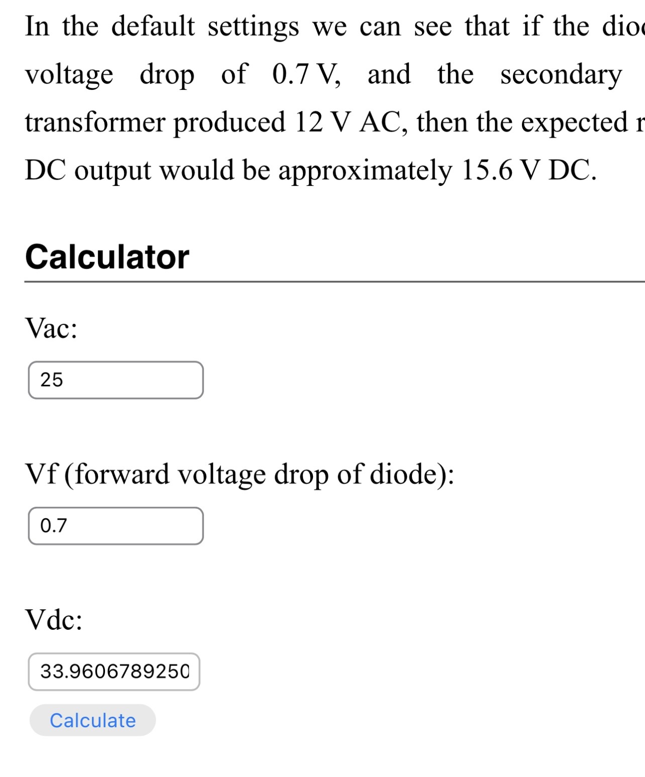

The transformer only delivers its rated voltage at its max. rated load. Small transformers including the original toroidal types, have the poorest regulation, which is to say that under load, their DC supply voltages could sag by some 7-10% of their unloaded voltage. If you were to disconnect the DC power to either or both amplifiers thus removing their bias current load, you'd see this in action when you compared the DC voltages in each case.
are u saying I should have got lower voltage? but in fact I am getting 36.6v, with bulb removed, which is a bit higher than I expected.The transformer only delivers its rated voltage at its max. rated load. Small transformers, including the original toroidal types, have the poorest regulation, which is to say that under load, their DC supply voltages could sag by some 7-10% of their unloaded voltage. If you were to disconnect the DC power to either or both amplifiers, thus removing their bias current load, you'd see this in action when you compared the DC voltages in each case.

Think about it. It means you will have a higher than normal voltage if the load is less than normal. If for example, you were to disconnect one of the amplifiers or the bias current was low for some reason, you have reduced the load and should expect a higher voltage supply to the remaining one.are u saying I should have got lower voltage? but in fact I am getting 36.6v, with bulb removed, which is a bit higher than I expected.
Also, check the AC voltage direct from the transformer windings - it should almost track (less diode voltage drop) with the rectified DC output.
with 120va transformer, 25-0-25 AC, after rectifier, 36.6-0-36.6 DC, what value of quiescent current is realistic? maybe 900ma is too high for this voltage?

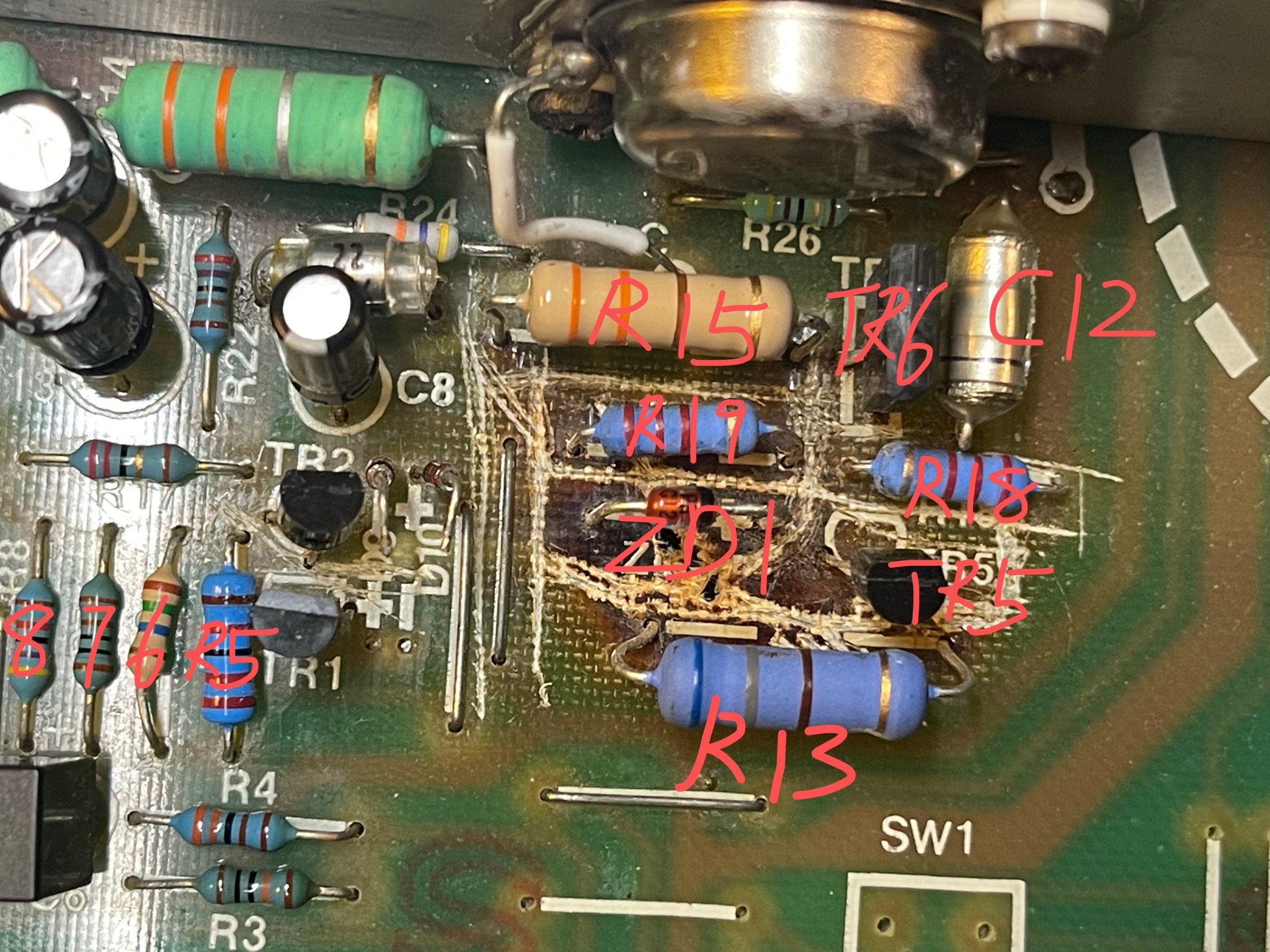

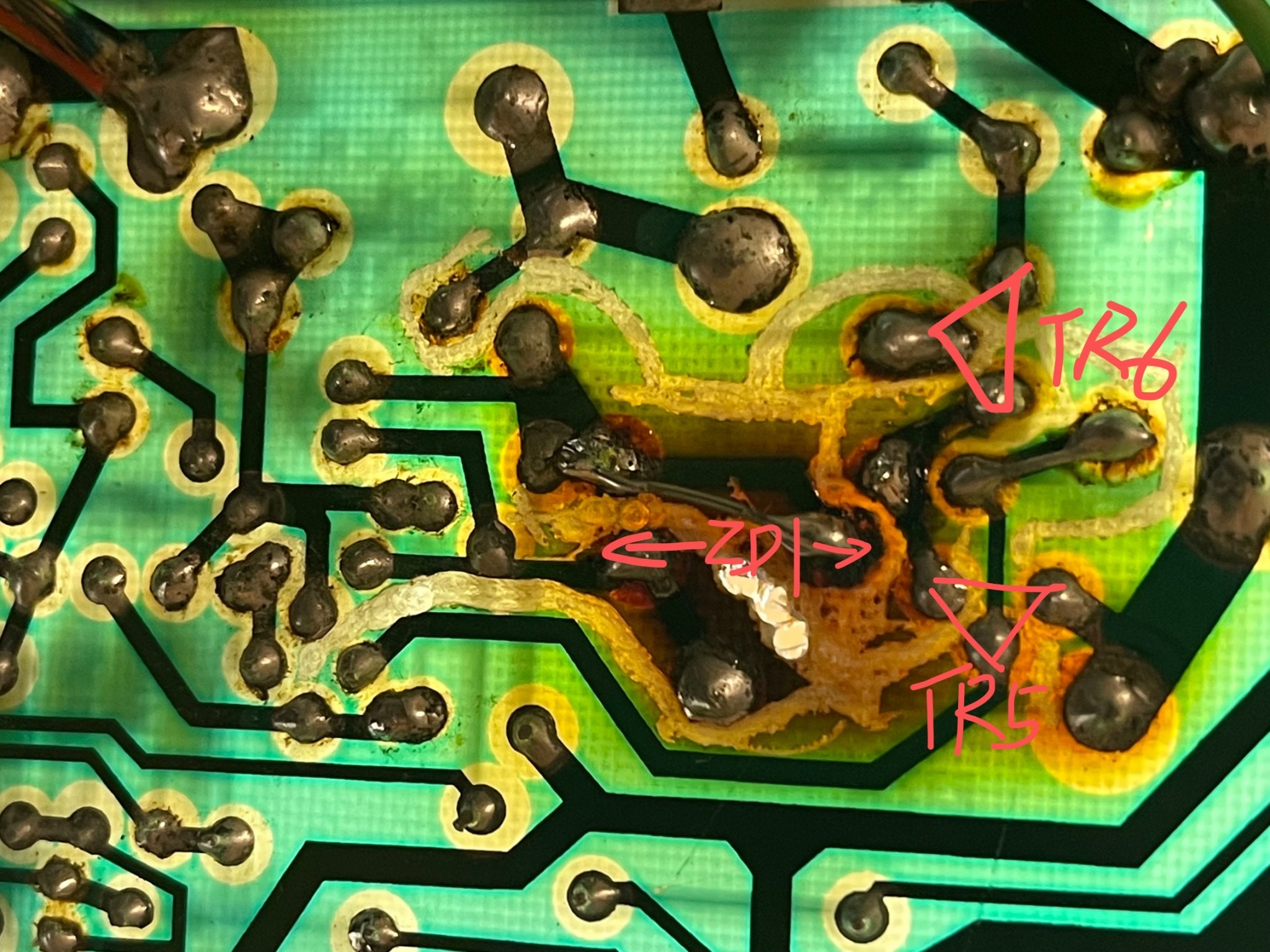

The fact that you see improvement after the carving effort is confirmation that suspicions re carbon have been correct, IMO. But the fact that TR1 base is still negative indicates that carbon leakage remains a problem.Of course its been checked, not conductive, all obvious suspicions have been checked.
As people suggested, I carved the burned area as much as I can without completely remove and rebuild it. See pictures attached.
It seems improved a bit after that work, I am not 100% sure.
Now tr1 and tr2 emitter are around 480-500mv, about 100mv below ideal case.
Tr1 base still negative around -60mv, thats about 90mv below expected.
R15 is around -3.5v, thats about 1v below expected.
Rail voltage increased to 20v, with bulb attached.
The picture showing the carved paths is very helpful. Would you mark on a schematic an indication of where these carved tracks are relative to the components and adjacent circuit tracks? I'm trying to understand exactly where TR1/2 bases are within the burned regions and carved trenches.
Thanks.

Maybe its more clear to see from front view as well.The picture showing the carved paths is very helpful. Would you mark on a schematic an indication of where these carved tracks are relative to the components and adjacent circuit tracks? I'm trying to understand exactly where TR1/2 bases are within the burned regions and carved trenches.
Thanks.
The two picture I attached are front and back view. I flipped the back view picture, so it directly maps front view
after I did some more carving, reinforced week connections, clean up PCBs.
most of the voltages become normal, even tr1 base is a small positive voltage now.
except now tr9 collector is around 0 mv. tr10 collector is around 100mv.
while on the other channel, tr10 is about 60mv, tr9 is around -60mv.
So I think I still have problem with unbalanced up and down part of the circuit in this channel. Seems when the bottom part is working quite good now, up part circuit and tr10 collector is pulling up the voltage of tr9 collector. That seems to me the up part may also suffer a bit from carbon track problem.
I am actually pretty confident most parts I replaced, are good parts. Except c13 or c10( more likely just c13), which when got replaced, fixed distortion problem.
so as a CONCLUSION:
it is the PCB board carbon tracks caused the problem — wrong Voltage, then wrong voltage caused c13 to negatively charged, hence failed.
I guess there are still some carbon track problem in the up part of the circuit (positive rail), which caused imbalance between positive and negative circuit. I also feel the carbon tracks/contamination is a little bit heat sensitive.
In this circuit, the feedback loop is quite sensitive, carbon track problem makes accurate match of spec almost not possible or too hard to achieve. Using better tolerance rating components to achieve low distortion also become meaningless in this case.

Your continuing experiments seem to add further evidence that you're on the right track. I agree with your conclusions.
I'm not sure how to advise you. You've got a lot of time and effort already invested in this board. I can recall similar experiences; as the board approaches the point of being a hopeless case, it's a bit liberating--- you can attempt bolder measures because there's little left to loose anyway. Success is sometimes the payoff.
Cutting suspicious tracks just beyond the burned areas and then jumpering the severed traces may be easier than trying to thoroughly excavate damaged material (and success more assured). If a lead of a sensitive component lies within a burned region, pull it out of the board and improvise a through-the-air connection. If you eventually get the amp performing as it should, then you can swap in close tolerance parts for better performance. BTW, your caps may already have adequately low leakage--- I didn't know what parts you have chosen.
If you get stuck in a particular, area-top or bottom, I'll try to offer advice.
