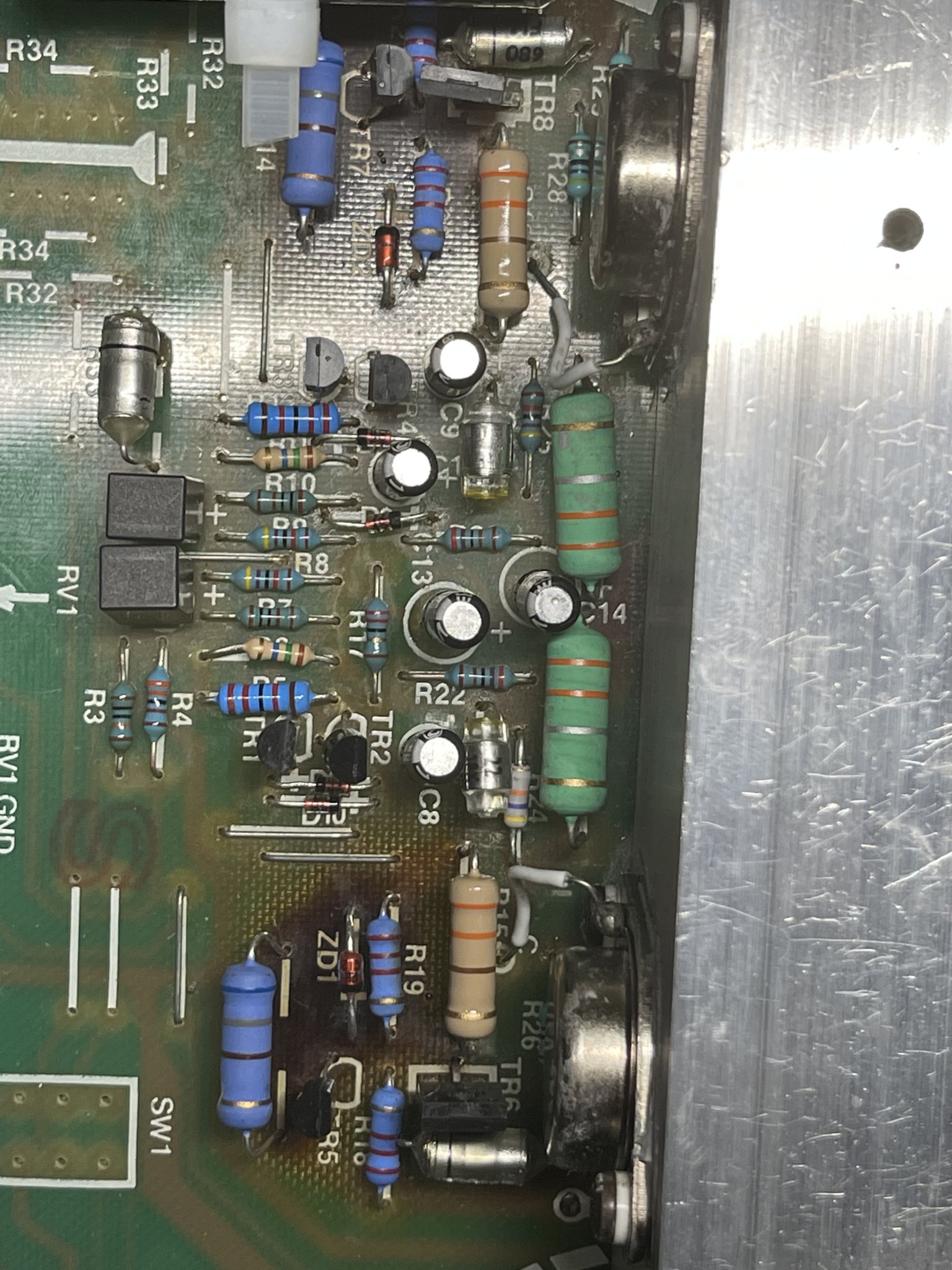

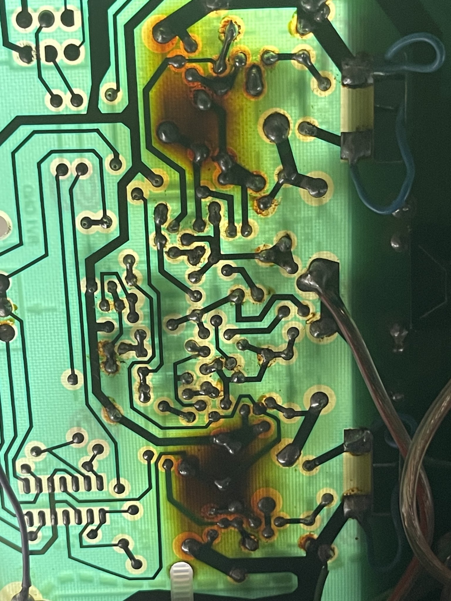

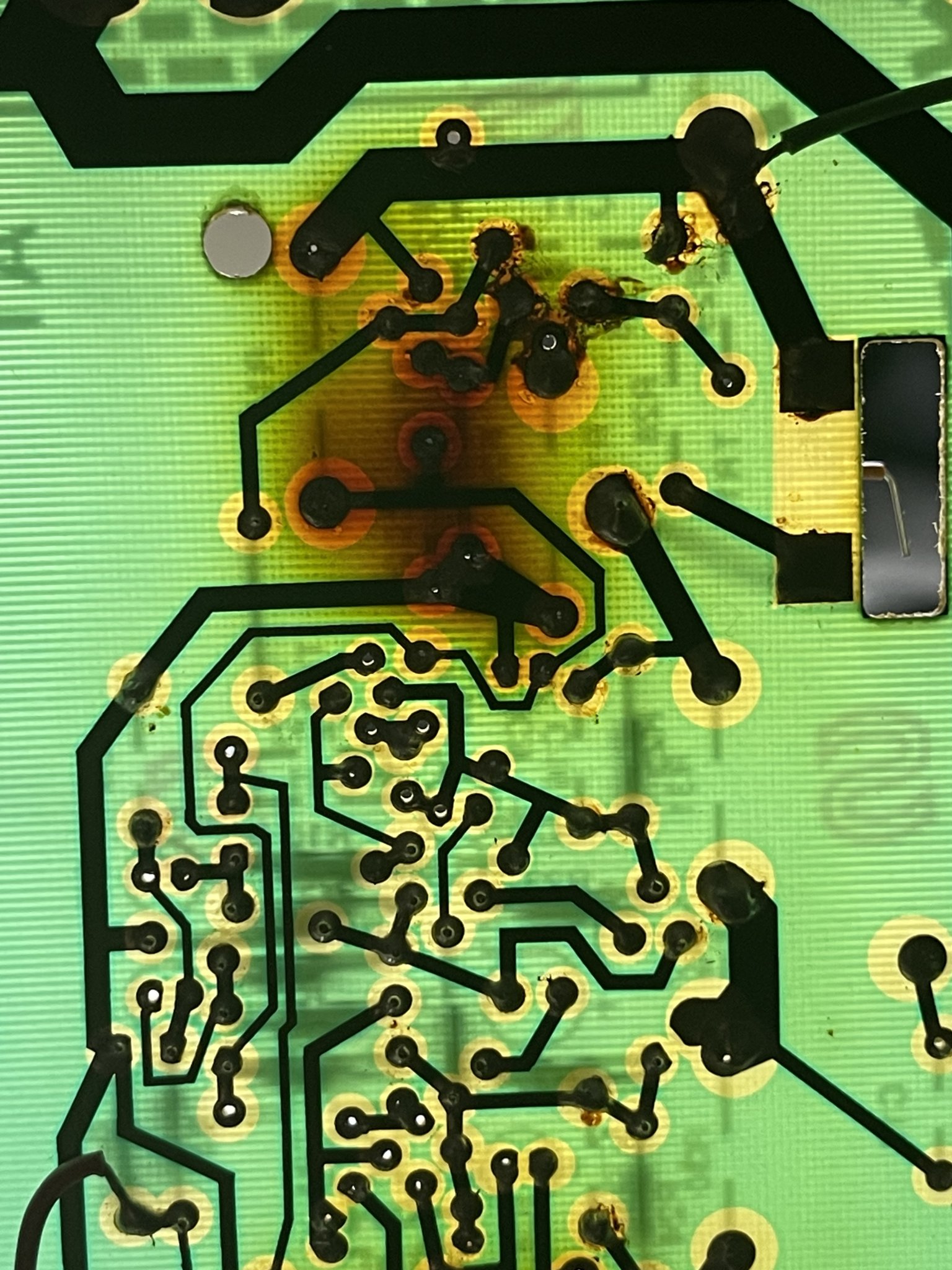

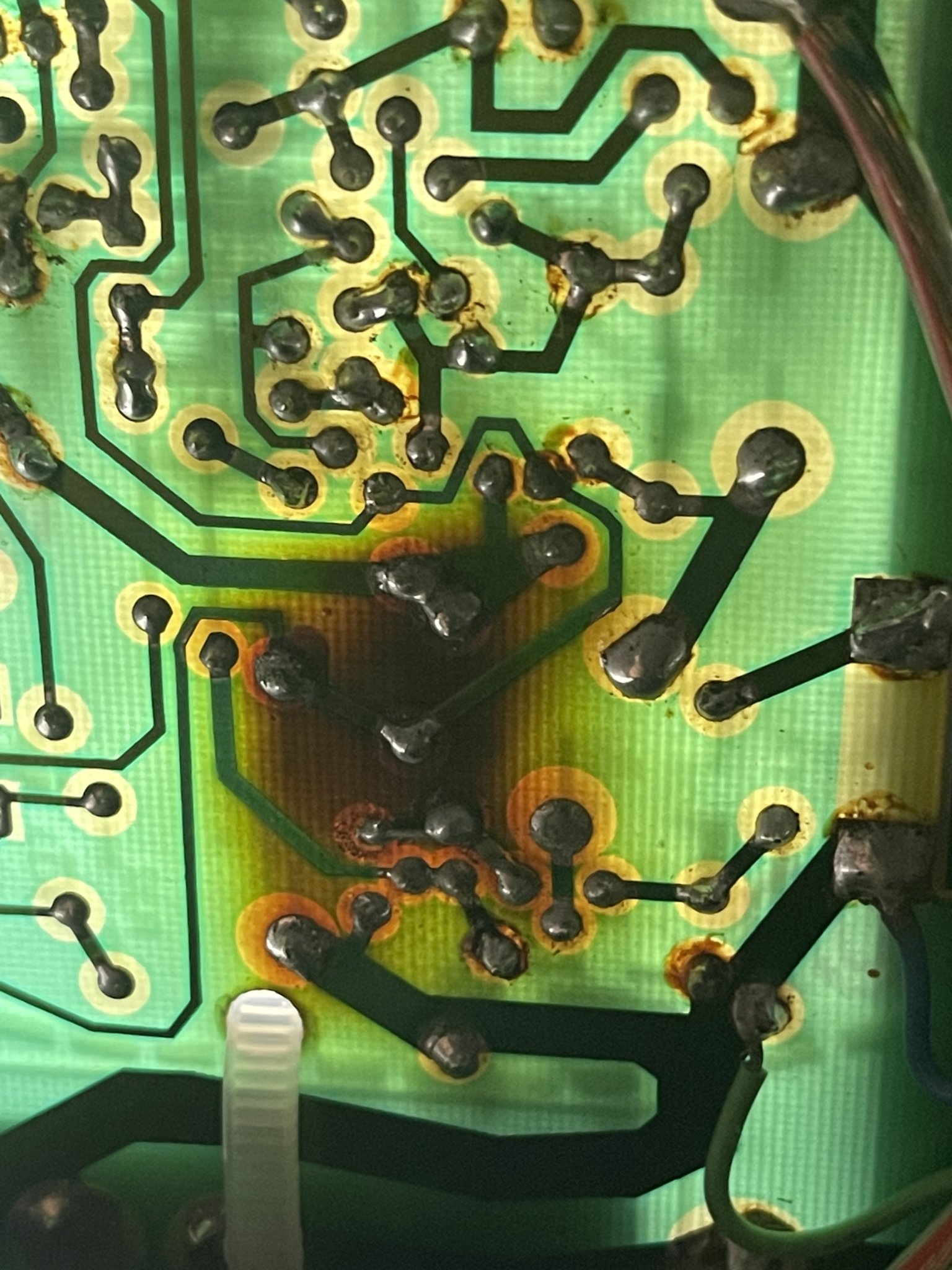

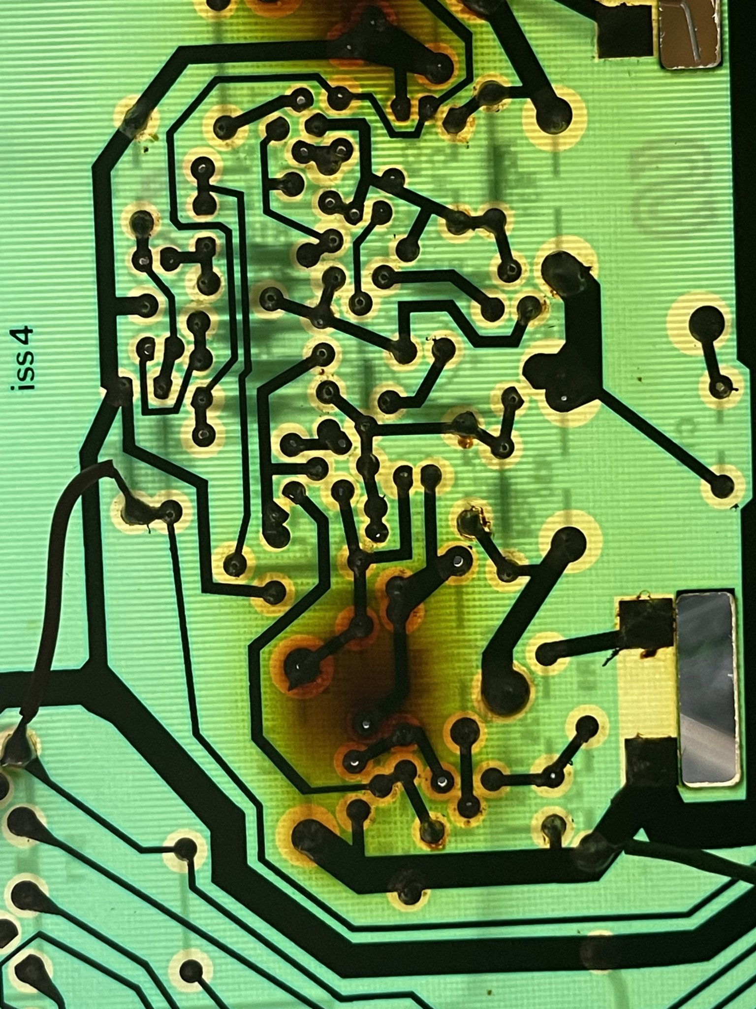

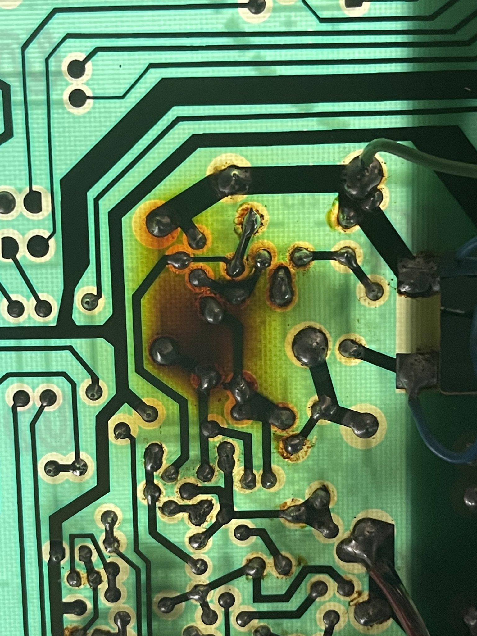

Yes it does, again check everything around TR5, TR6, TR9 as mentioned above for issues. Go into pcb details! Double check this TR9.
Carbon track contamination is conducting ('burned') material unwanted, dragging the the system down.
When you sneeze upon the pcb, the amp goes beserk. Just imagine the unnamed conducting contends.
Yes, it is mainly carbon proper.
Carbonised circuit boards and most organic solids will be conductive to some extent, since they are effectively a charred mass of random high resistance tracks through the woven glass fibre fabric reinforcement here. Heavily carbonised materials such as PCBs made from phenolic or epoxy resin composites, can become highly conductive - virtually shorting from one track to another. Except that it means a complete rebuild of the board, a repairer should scrap a board like this and replace it if they expected to do a reliable repair. It may well have been cheaper to scrap and replace the whole amplifier in this case and for all we know, that could be how it came into your possession.
We DIYs being cheapskates of course, will prefer to dig out the darkened parts ourselves using a scalpel and mini grinder such as a Dremel tool then patch over the holes and gaps with epoxy filler compound. It's messy and ugly work but it can work if you prepare your board carefully, map out the existing traces and components carefully and replace any sections of copper trace that will be damaged or left unsupported, with solid wire links.
how do I find which part went conductive? Is it possible to detect it by using multimeter continuity test?Carbonised circuit boards and most organic solids will be conductive to some extent, since they have effectively burnt away to a mass of random high resistance carbon tracks through the woven glass fibre fabric reinforcement. Heavily carbonised materials such as PCBs made from phenolic or epoxy resin composites, can become highly conductive - virtually shorting from one track to another. Except that it means a complete rebuild of the board, a repairer should scrap a board like this and replace it if they expected to do a reliable repair. It may well have been cheaper to scrap and replace the whole amplifier in this case and for all we know, that could be how it came into your possession.
Tried for a while, didn’t find any place unexpected conductive. Also used alcohol and wipe to clean it.
not much change.
now it went back to bright bulb mode. so it’s intermittent

It needs a bit logic to see what the problem is. You can't really identify what parts are conductive until the board is stripped of components and connections. Any remaining resistances/shorts will still be elusive to identify until they are effectively isolated from all others. The more practical way to deal with that is just to attack the evidence, the darkened areas of board. Remove them completely and patch over, as described.

I assume there's no source of unpopulated PCBs? Do you feel up to creating a copy or a new board layout?

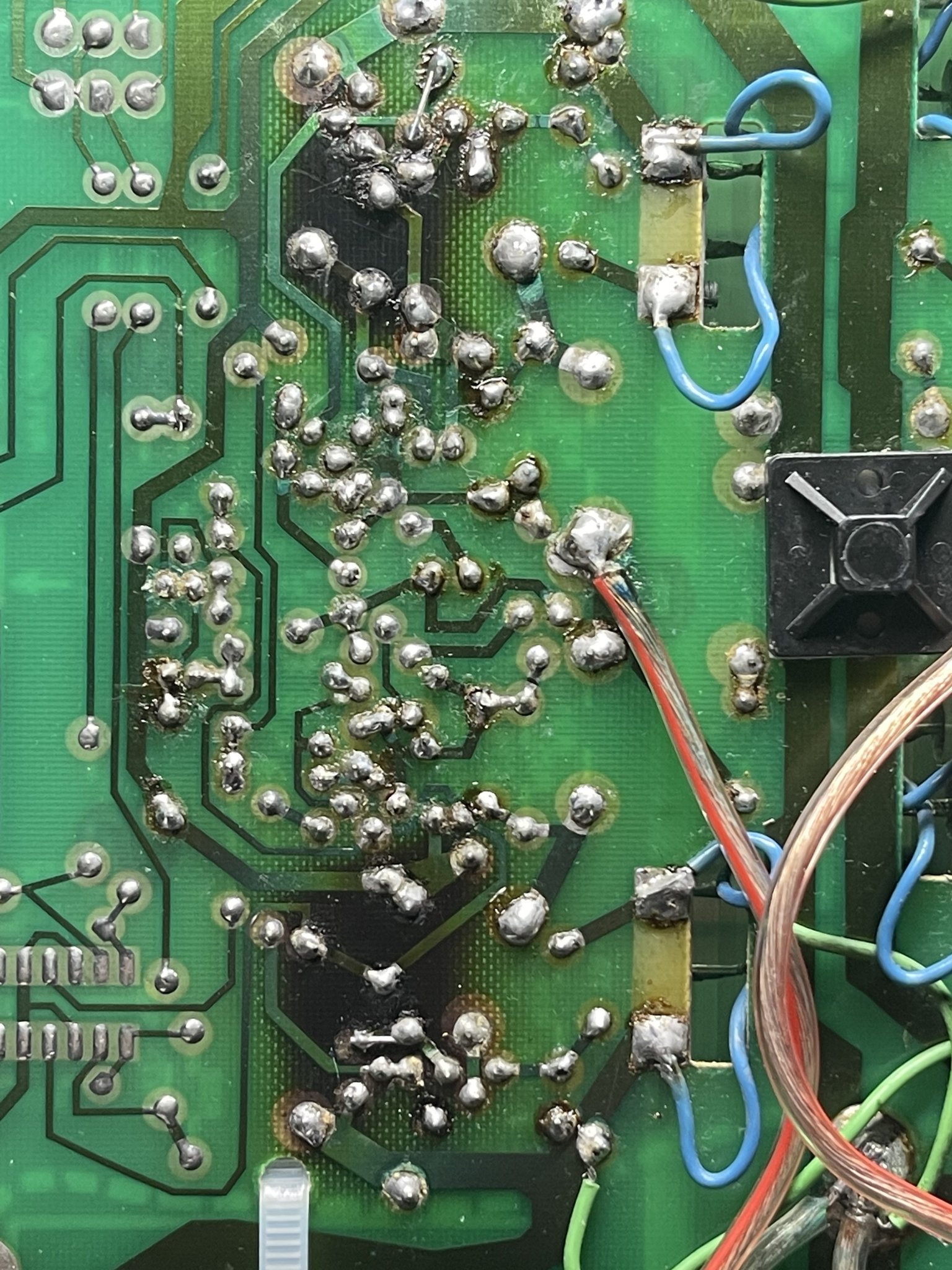

If it's not too much trouble, would you post close-up photos of the boards--- both top and foil sides? And particular details of the burned areas. Maybe that will spawn some ideas.

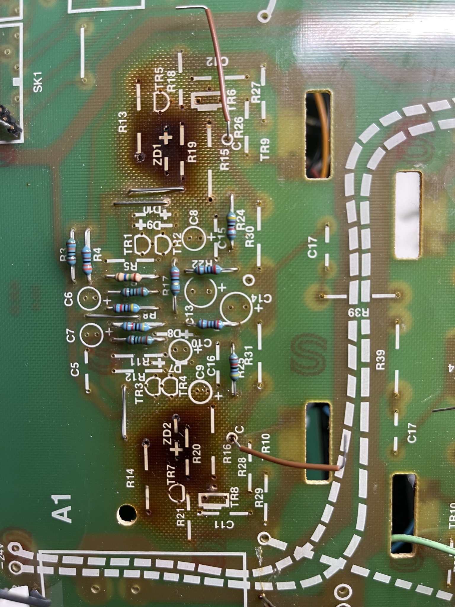

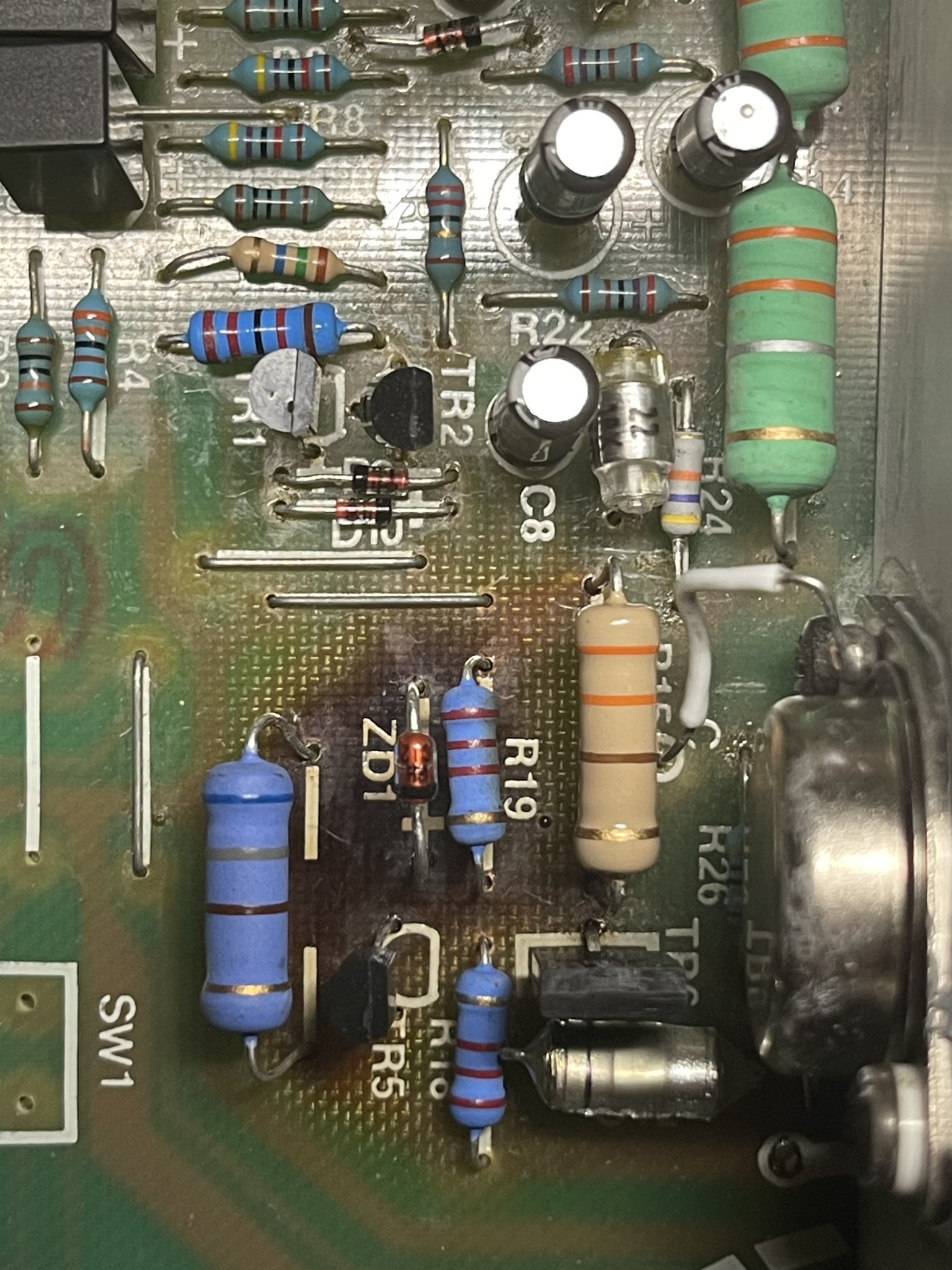

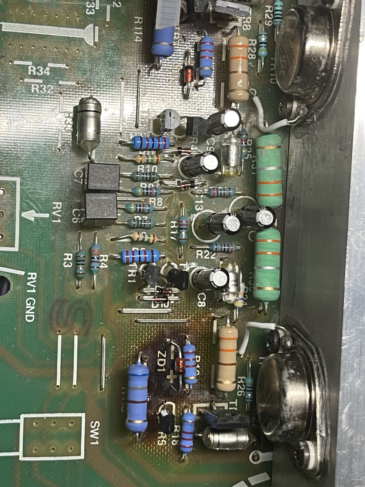

Looking at the schematics, I can´t understand why R13, R14 and ZD1, ZD2 should be so hot as to discolor the pcb?
Are they feeding other circuits not shown in the schematics on the first page?
According to the schematics they are only feeding the input stage!

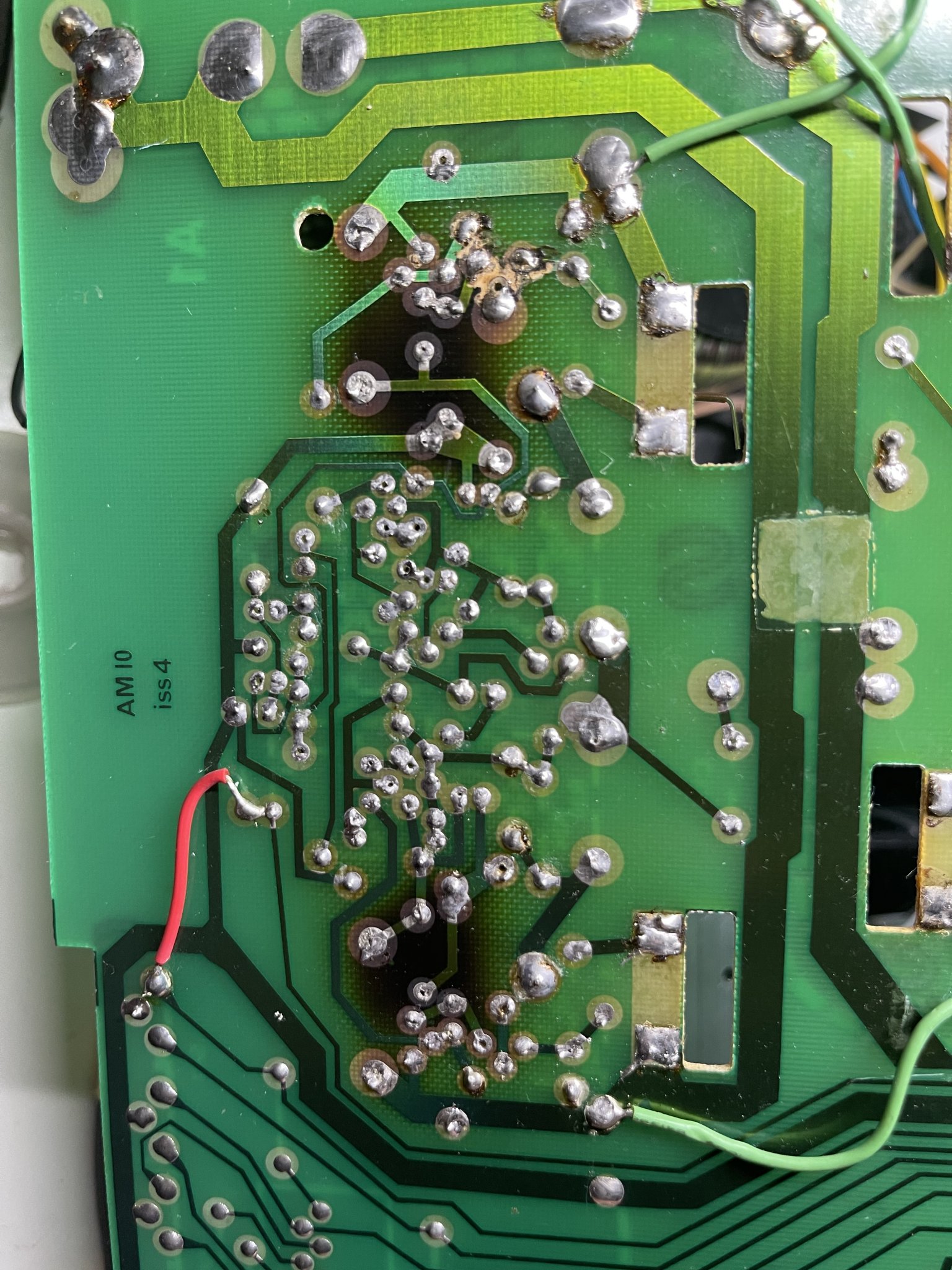

Here are the photos

I also have another board with almost all the components removed.(as its mono blocks, so comes as a pair) I didnt start to work on that one because stuck in this one
Here are photos of the other one
I dont know either why they got so hot, my other A1 model dont have these marks, but that was in lower power rail, +-24v, with 100va transformer, as shown on the schematic I posted
These zener diodes is not feeding anything else, because this is power amp version, there are no preamp section in it. In original A1 integrated version, one channel feeds two op-amps for line premap.
