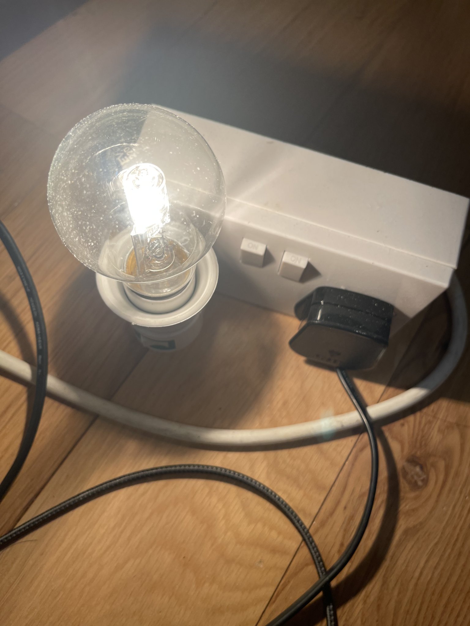

Bulb is much brighter, while rail voltage dropped to +-9v. Which, I guess means the current in the amp is much bigger.

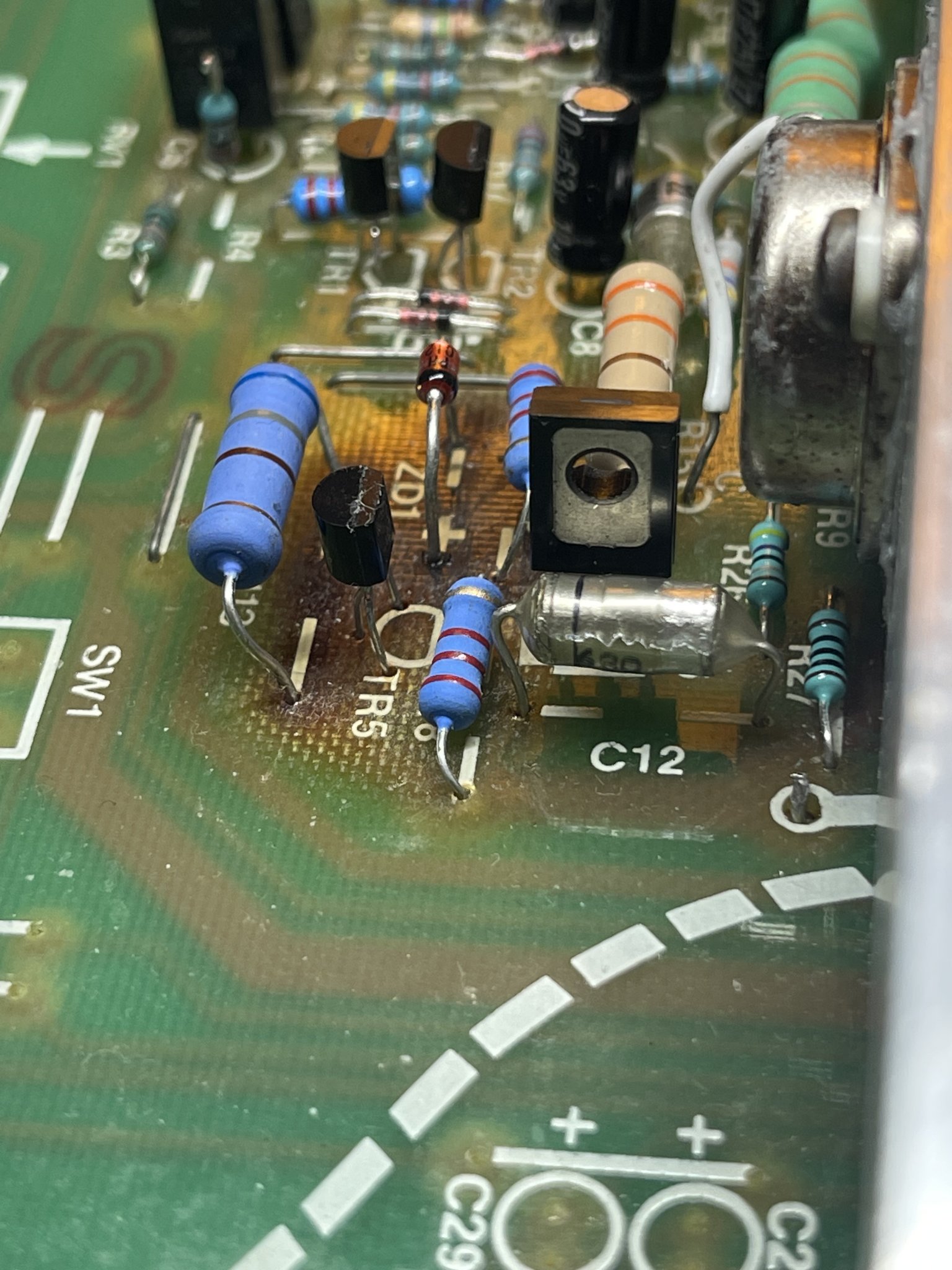

R26 is 1%, I replaced it.What is resistor tolerance of R22,R23,R25,R26? 5%?
R22,r23, r25, I don’t know, they are original

You can put two diodes in series (anode on base TR5, cathode on collector TR5 = negative rail) to prevent the bias current running out of control. It should stay well under 1.4V (compare voltage drop of 0.7V over R21 on positive rail).
Same reasoning with your new measurements.
TR5 replaced... don't have c and e swapped incidentally?
Thats not possible. Its clear labeled on pcb and I double checked the connections.Same reasoning with your new measurements.
