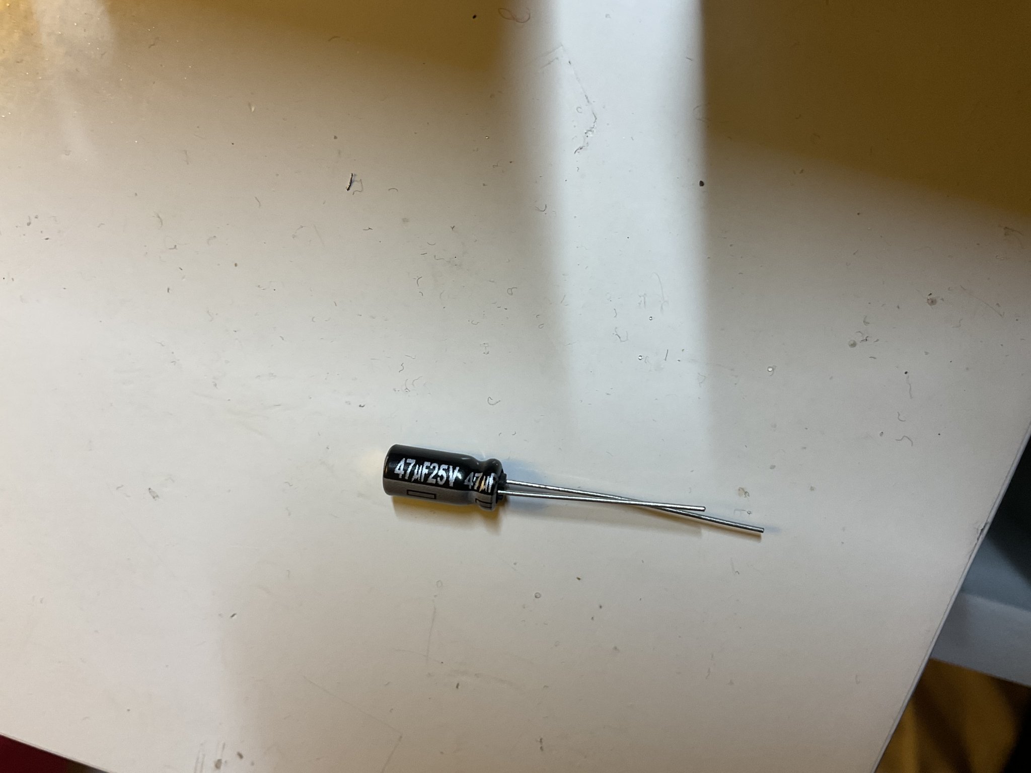

I tested with multimeter, the capacitance is fine, and it is not shorted. It’s newly replaced cap, if it does goes wrong again, it won’t be the source of the problem, it more sound like the result of the problem being charged negatively. So I can’t just keep swapping it, that make no sense. I probably better order some dual polarity caps to replace these as Citizen suggestedit wouldn't be the first time i've pulled a "new" capacitor out of my parts stock only to find it it bad.
so please tell me what sort of testing was used to make your determination that it's "good"
and as i've already mentioned the carbon contamination of the PCB could well trump/fault a new part.

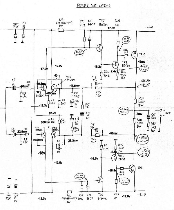

I already replaced C6 & c7 with film capacitor. so it’s bipolarBase of TR1 should not be negative, as its base current flows into R7 and R8, causing a positive small voltage.
If it is negative, current flows from ground of R8 into what?
Replace C6 & C7 also for bipolars.
Base of TR1 and TR2 should 'mirror' base of TR3 and TR4.
Different values can happen due to component tolerances, mainly ZD1 and ZD2.
please describe your test method... because as for one, i ,after 30 years of doing service work on electronics cannot conceive of a test with nothing more then a multimeter and say that a cap is ok...

do tell,is this from the same batch of caps that was used for the previous replacement?

Yes, it is from the same batch. That’s all I gotdo tell,is this from the same batch of caps that was used for the previous replacement?

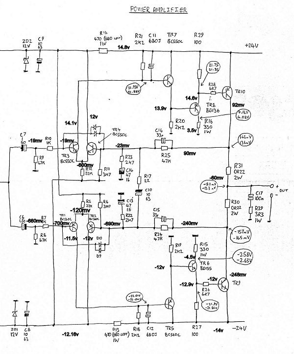

Here are what I measured based on current situation (protection bulb bright, hence dropped rail voltage, amp sound fine ). Please not the voltage drift a bit during measuring because of the series bulb used, it makes power rail voltage not stable. so the voltage I measured across the circuit, will be some inconsistency depends on time its been measured. but it should still be able to provide some kind of knowledge about what is going on.
Please only look at the voltages in Bold, not in circles which comes from original schematic.

and here are the measurements from the other (good) channel. Please note, the rail voltage goes up to 17v in this measurement, its just the variation between two power on, and time.

Do you have bench power supplies--- i.e. adjustable voltage and adjustable current limiting?
Do you have a drawing similar to #53 of the working amp with bias voltages shown but operating at +- 30V, your original goal?

#52 is the problem channel, initially sound is distorted as described in #1, then I replaced c13 and c10, sound is normal, I cant hear obvious distortion. But voltage still measured problematic, I think it will fail again if I leave it like this and run for a long time.This is the case for the working amp?
#53 is the good channel measurement
