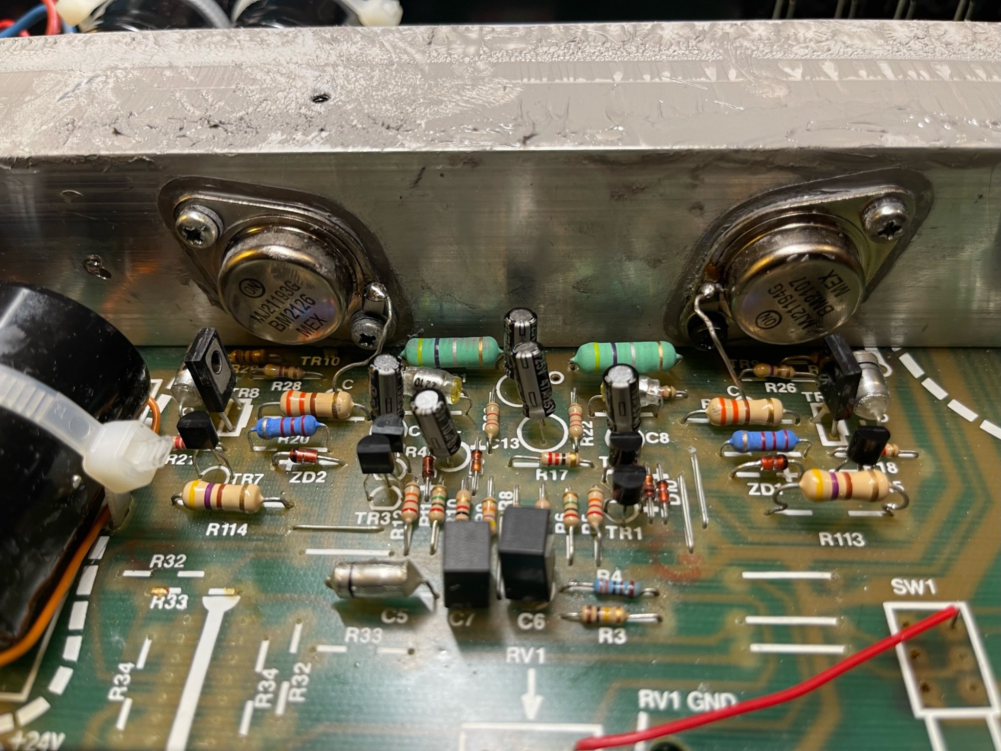

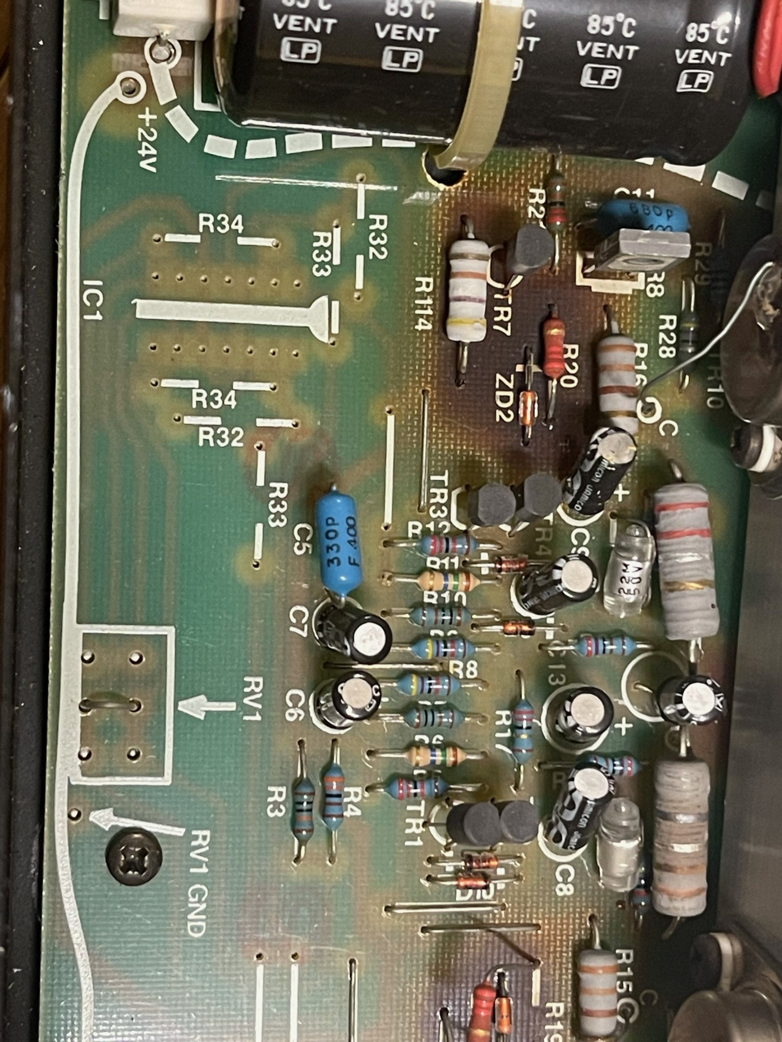

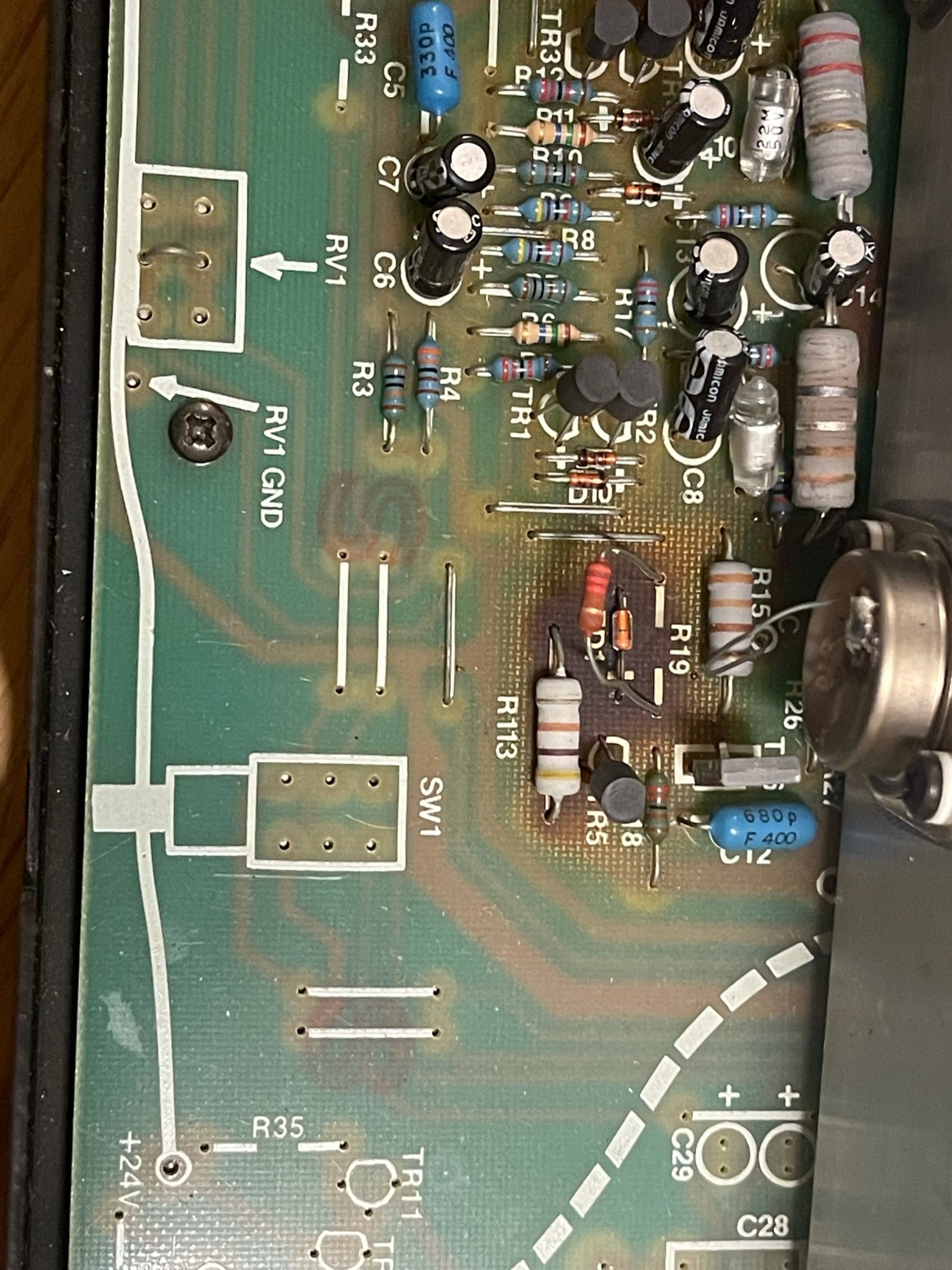

That was the original burn mark, I bought these as parts only, and completely rebuild. ( the circuit board is also low quality, but thats not standard parts so I didn’t manage to replace it.What are those darkened area's near ZD1/ZD2 on both channels? Looks critical.
these burn marks are standard on this machine, if you search online every musical fidelity ma50 looks like this.
it’s due to r19 and zener diodes runs very hot. I changed them to higher rating parts, and checked circuit, fixed these disconnected places.

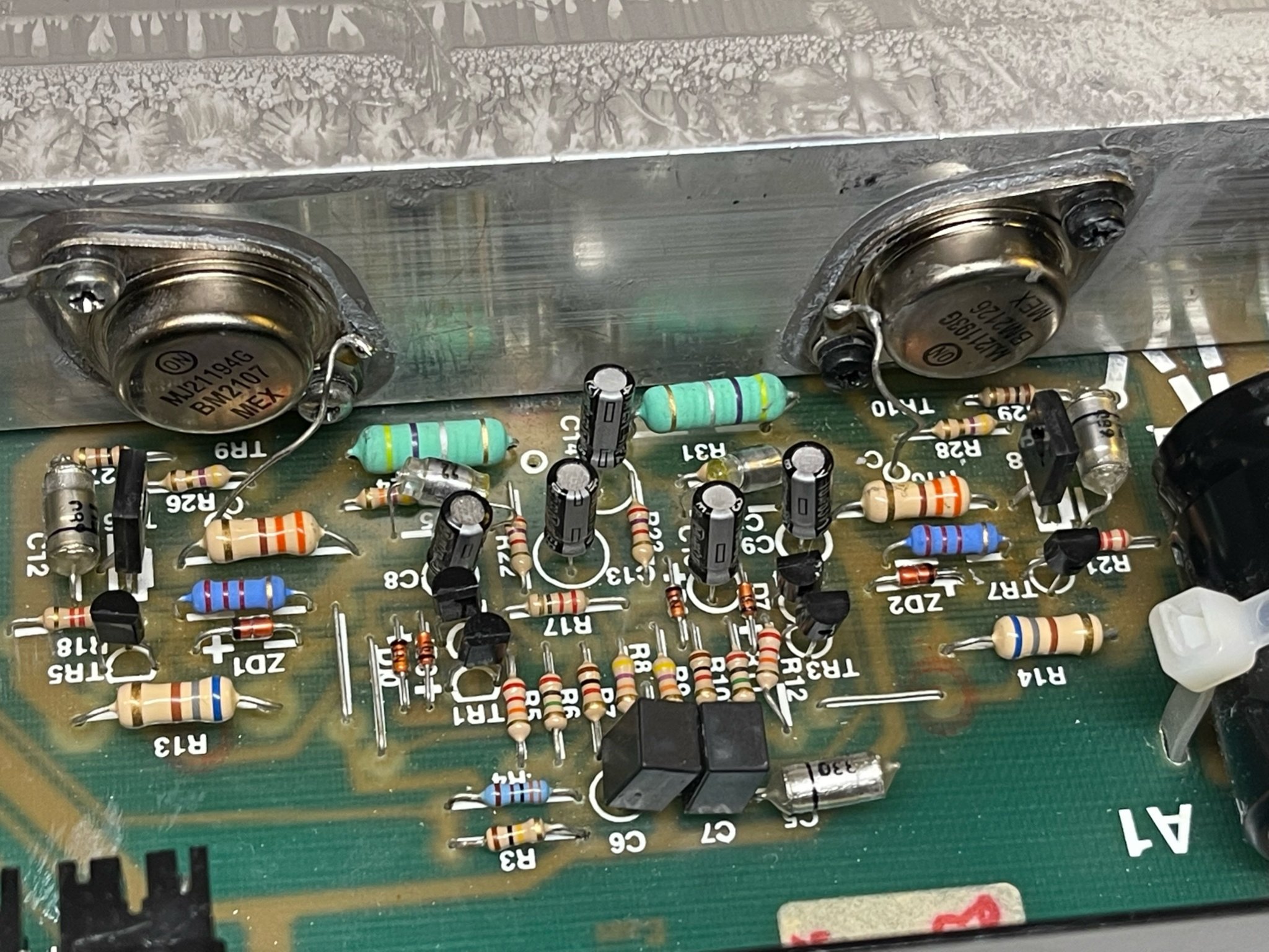

below are the original pictures

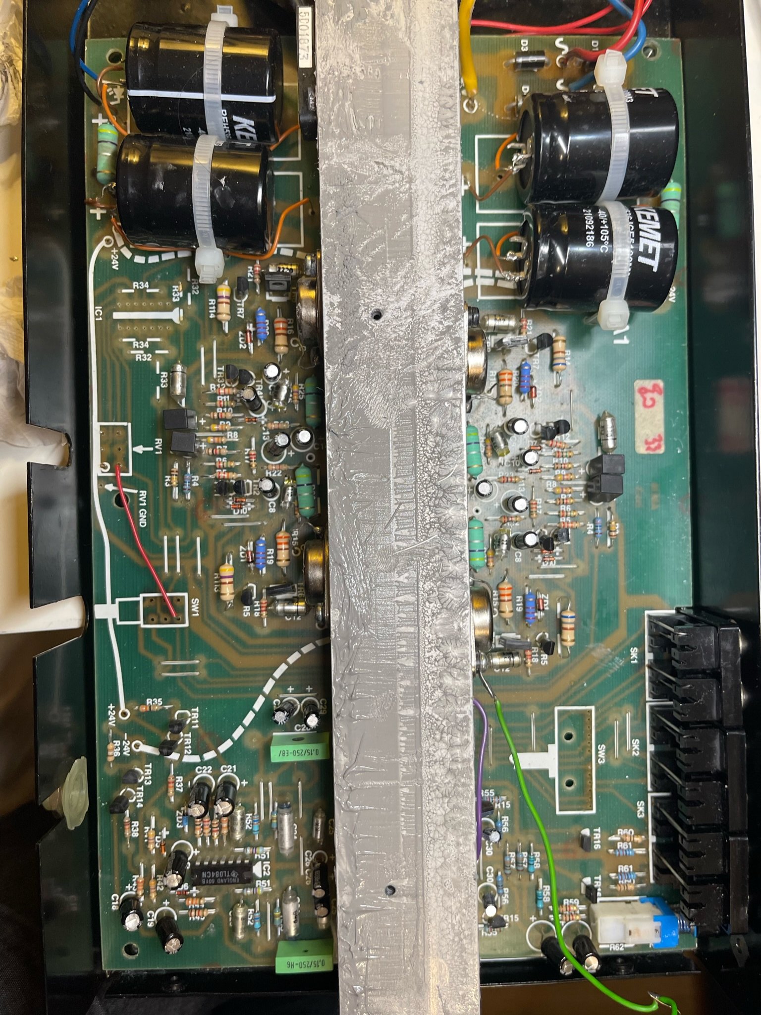

I also have A1, that was my last rebuild project, I completely removed the pot, selector and the tape selector switch. Make it a power amp eventually.MF showing bad design practice.
I owned a MF A1, lovely sound. Years ago. Grill toaster. Volume pot burned by the heat sink. Nasty issues.
as I found theses parts caused so many problems, not only noise, but also severe left right channel cross talk.
this is my a1 after rebuild, basically used same parts as this ma50
