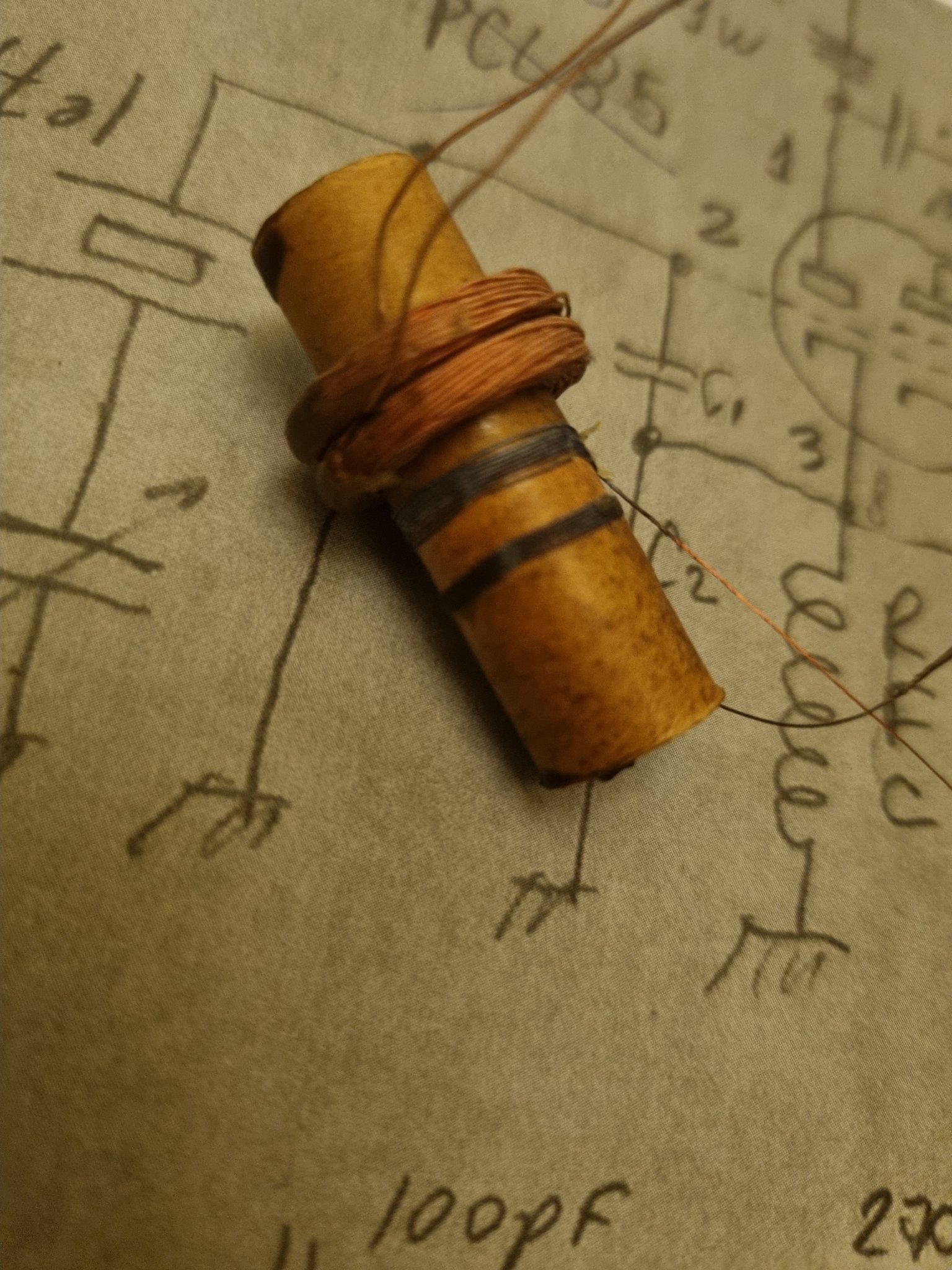

RF chokes... Pair of coils from the second picture from above... I can still try to use them for cathode choke regardless of using PCF802?
That leaves the RF choke below the tank coil and the tank coil. Any specs for making or buying the RF choke? And for the tank coil if I understand correctly I must make it matched it to my xtal? How do I calculate the specs?
If you carefully can dissasemble the two pies from.the antenna in the radio depicted, one of them will be fine for the triode's cathode, and the other for the decoupling choke in the plate circuit. Going deeper, a choke in RF is closely a constant current source device. So there you can have a high impedance to the signal while low DC resistance path to ground.

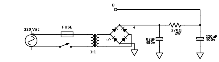

Would this power supply be appropriate for the project? I used this schematic in EL84 amplifier build, B+ is 270VDC
Yeah. I suggest to add a ceramic .01uF on each 'lytic as they aren't good for RF decoupling. Also add .001 across each diode for the same reason. All may be those ceramic caps @1KV blue colored available in many shops and SMPS to reuse.

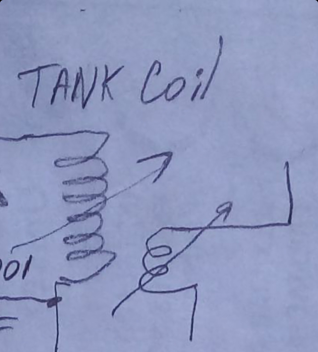

Only one thing I'm having hard time with... It's the tank coil... I'm searching and searching, but can't seem to find much info on it.
Should it be something like that?
Or more like that?
Distance between the two coils must be adjustable?
I had also seen small coil over bigger one and ferrite core inside that moves up and down to change inductance. Would that fit?
Just to confirm on the smaller coil, upper end would go to antenna and lower end to ground or not connected?
Tank coil may have any form. For tube circuits generally are air cored but no allways. From a single layer of wire to copper tubing inside them running water for cooling, at very high power. Remember the old times when short wave emmiters had 500 to 1000 KW. Our one will be more like the one wired over a white plastic tube. But have patience. First take the oscillator running and let time yourself to enjoy building the project and familiarize with circuit topology. Tubes and solid state are different in several aspects but similar in others.
In the coil of the first pic, try to leave the dual pie coils over the bobbin alone. If possible, get rid of the other coils.

Will get rid of other coils, no problem.

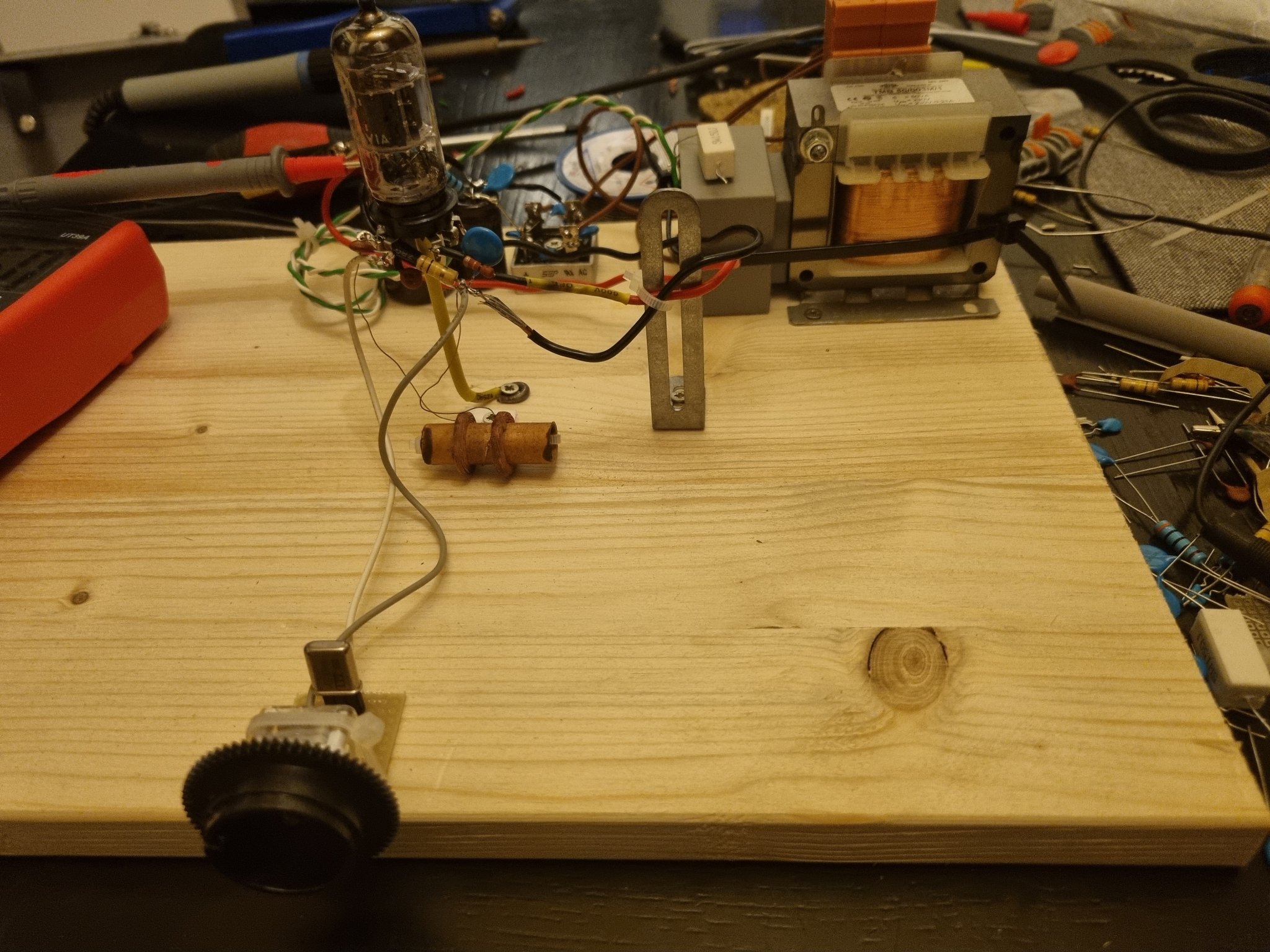

I had made the oscillator. But I need to get probes for oscilloscope because I can only apply 50vpk max with :1 probes.
B+ is 300vdc and falls to 295vdc when tube warms up... Is this good or to high?

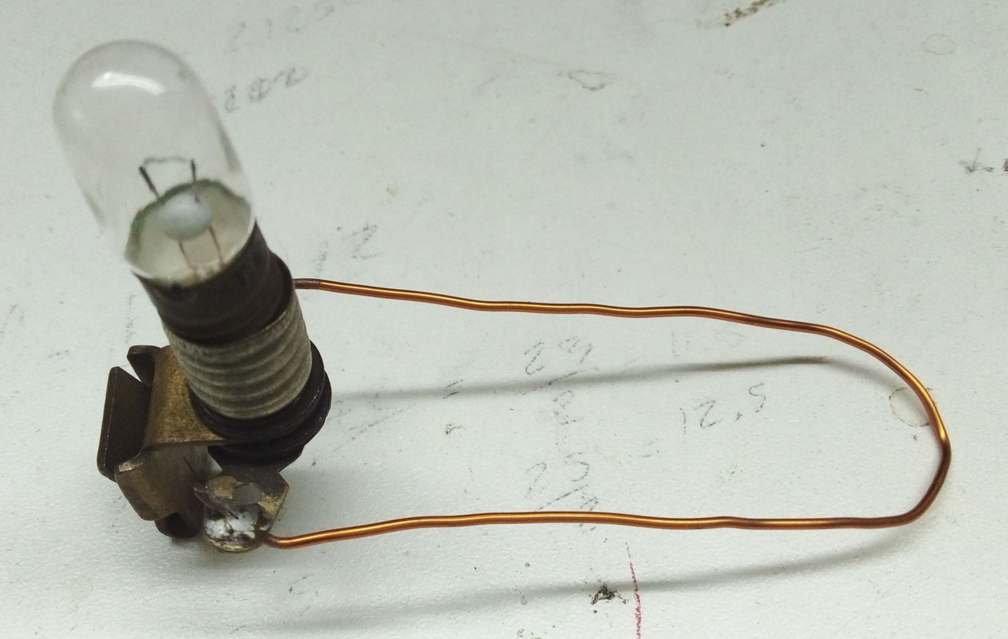

You can make a natural attenuator for RF. Only take about 10~15cm of copper wire plastic or enamel isolated. Peel both ends. One end to the tip of the oscilloscope. The other end to the ground clip (usually an alligator clip). Give it the form of a round loop.
You surely will think its a simple shortcircuit and this is thus, useless.
Halt: This is true for DC and low frequencies, but NO at radiofrequencies!!!. You had built a secondary single turn of a RF transformer whose primary may be any wire conducting RF: the choke is the best primary. But any conductor in the circuit conducting RF currents radiate it. Why not to try it?
300V for a crystal oscillator is too high. 150DCV is more proper. This may be adjusted with the decoupled anode resistor. Crystal may be any whose frequency may be received in your SW set.
