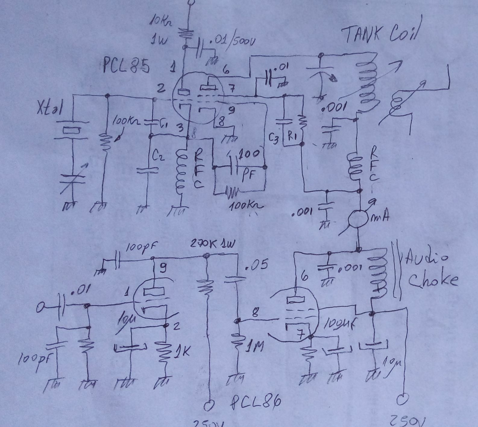

This is an easy to build QRP (low power using ham radio dixit) you can build.
Note the use of two tubes. Triode PCL85 oscillates crystal controlled. Frequency depend exclusively on crystal. Pentode amplifies the oscillation runing both class C.
PCL86 triode amplfies the signal coming from any audio source: a dynamic microphone, a small speaker used as mike, and the pentode augments audio power. As the pentode ECL85 takes energy from PCL86 pentode, if audio is at the plate, the amplitude of the oscillations will increase or decrease acording audio signal, thus a simple AM transmiter is built.
Plate tank labeled is a coil you will need to build yourself and will depend on frequency of crystal. So when the later is defined, the former too. The variable capacitor at plate of PCL85 may be one section of an AM radio of the air dielectric type (not polivaricon).
The screen dropping resistor must be adjusted in service. For security of the tube, a 100K resistor @1W may success, but posibly when the TX is finished, and if no red plating at pentode, this resistor can be reduced to allow a higher power. The bipolar capacitor in parallel may be any good 10uF@400VDC and enables screen grid be feeded with audio signal too. All .001 and .01uF must be ceramic or mica, not less than 500VDC.

Ok, I had just arrived from work. I will start with hunt for parts in about an hour. But i don't have the PCL85, can I replace it with something I have on the list? I will order it otherwise....This is an easy to build QRP (low power using ham radio dixit) you can build.

You had also mentioned ECL85, did you mean PCL?

PCL85 is roughly to PCL805 your mentioned at first post. My apologies for those typos.
Prior to put hand to work, l suggest you to take some readings about tubes, their habbits and mainly how do they are operated as Class C.

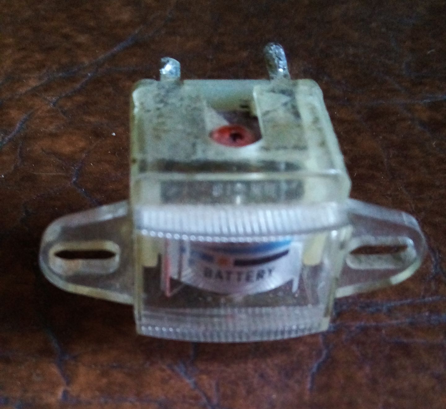

Forgot some words about the milliammeter. It will be needed to properly adjust tank circuit to resonance. Any moving coil instrument with a full range of 50mA will suffice. But nowadays those instrumemts are difficult to find. You can also use a vumeter of the used in cassette players and make a proper shunt for it.

I don't have milliammeter, but I do have spare vumeter.

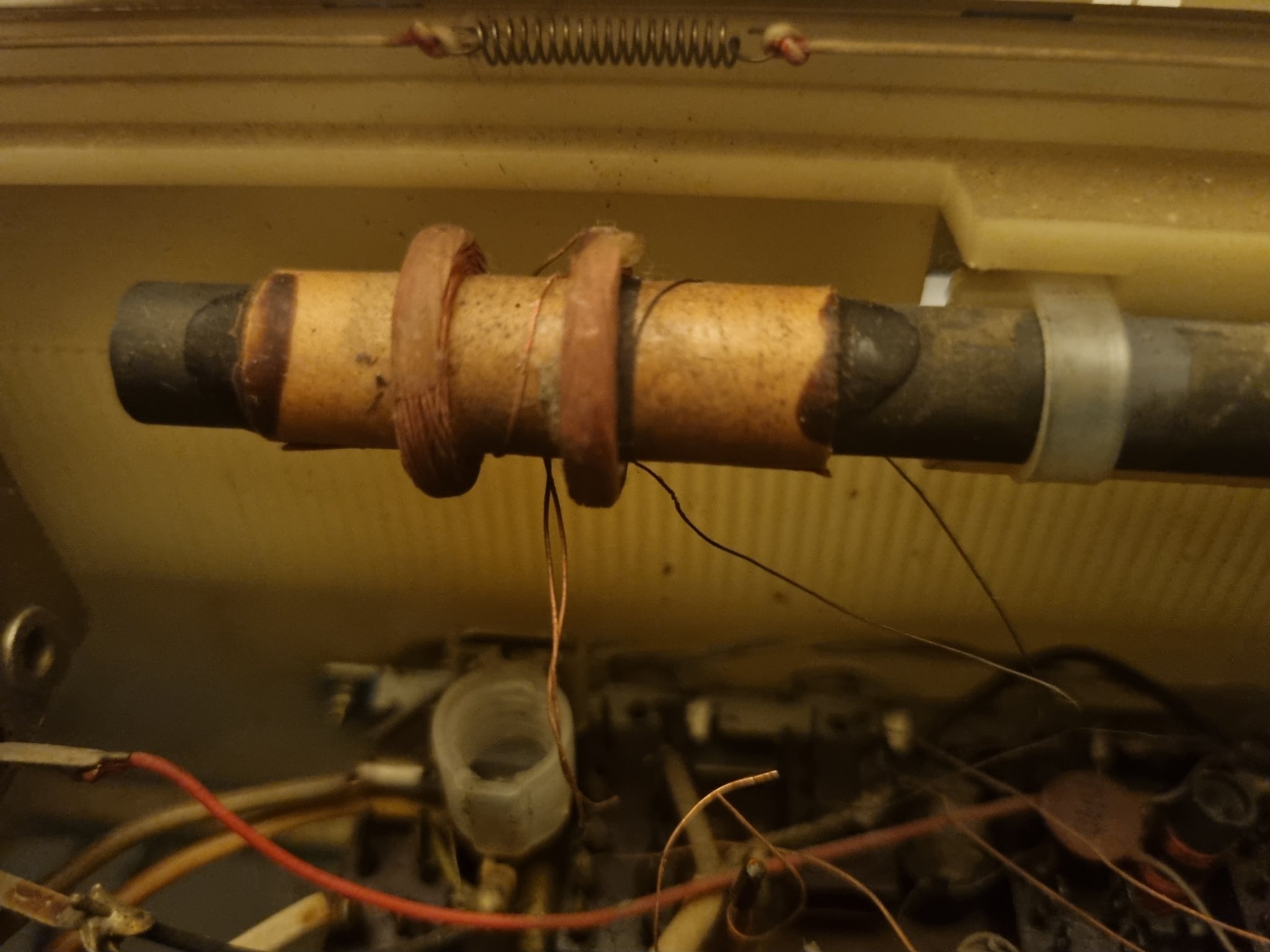

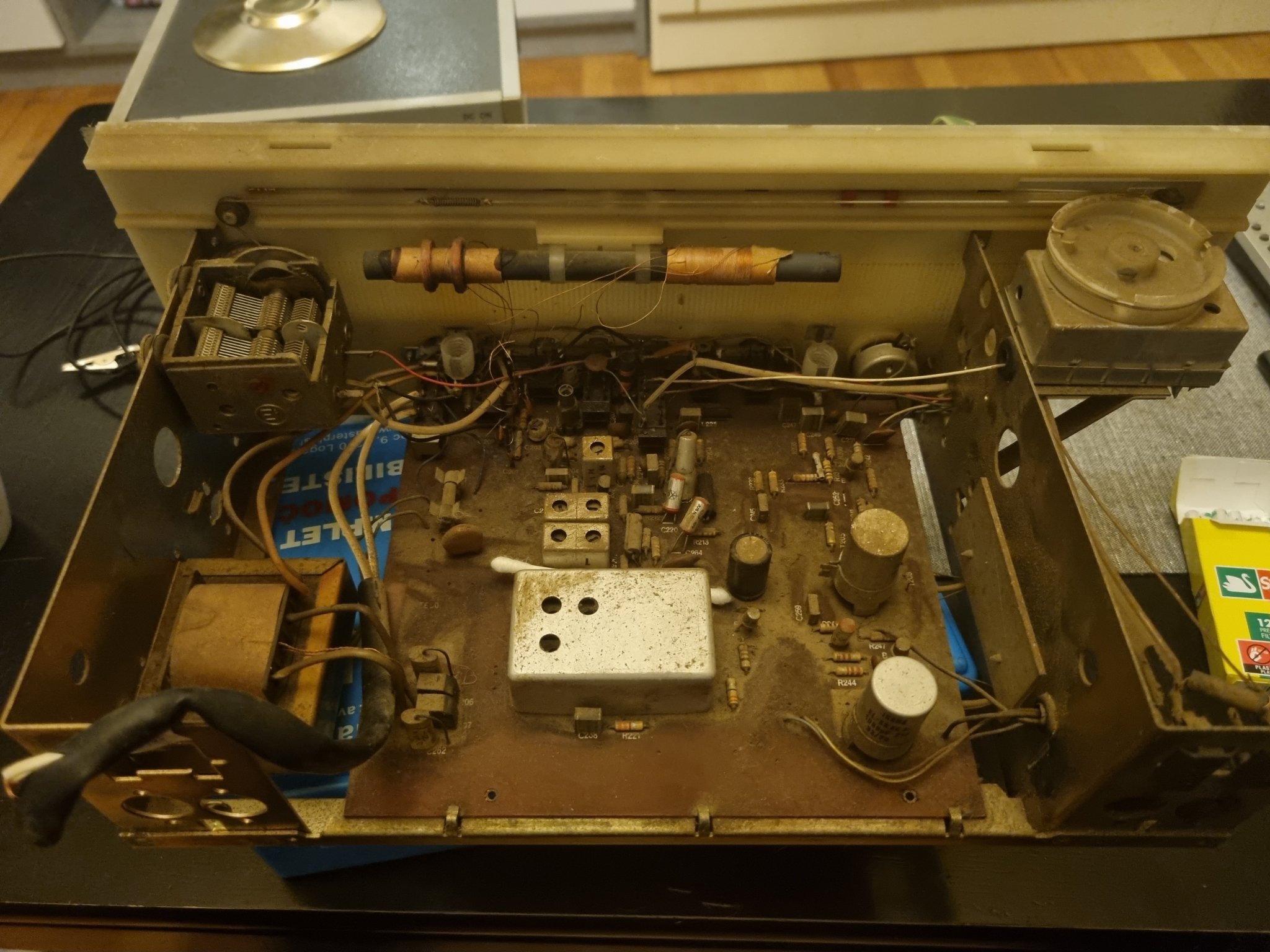

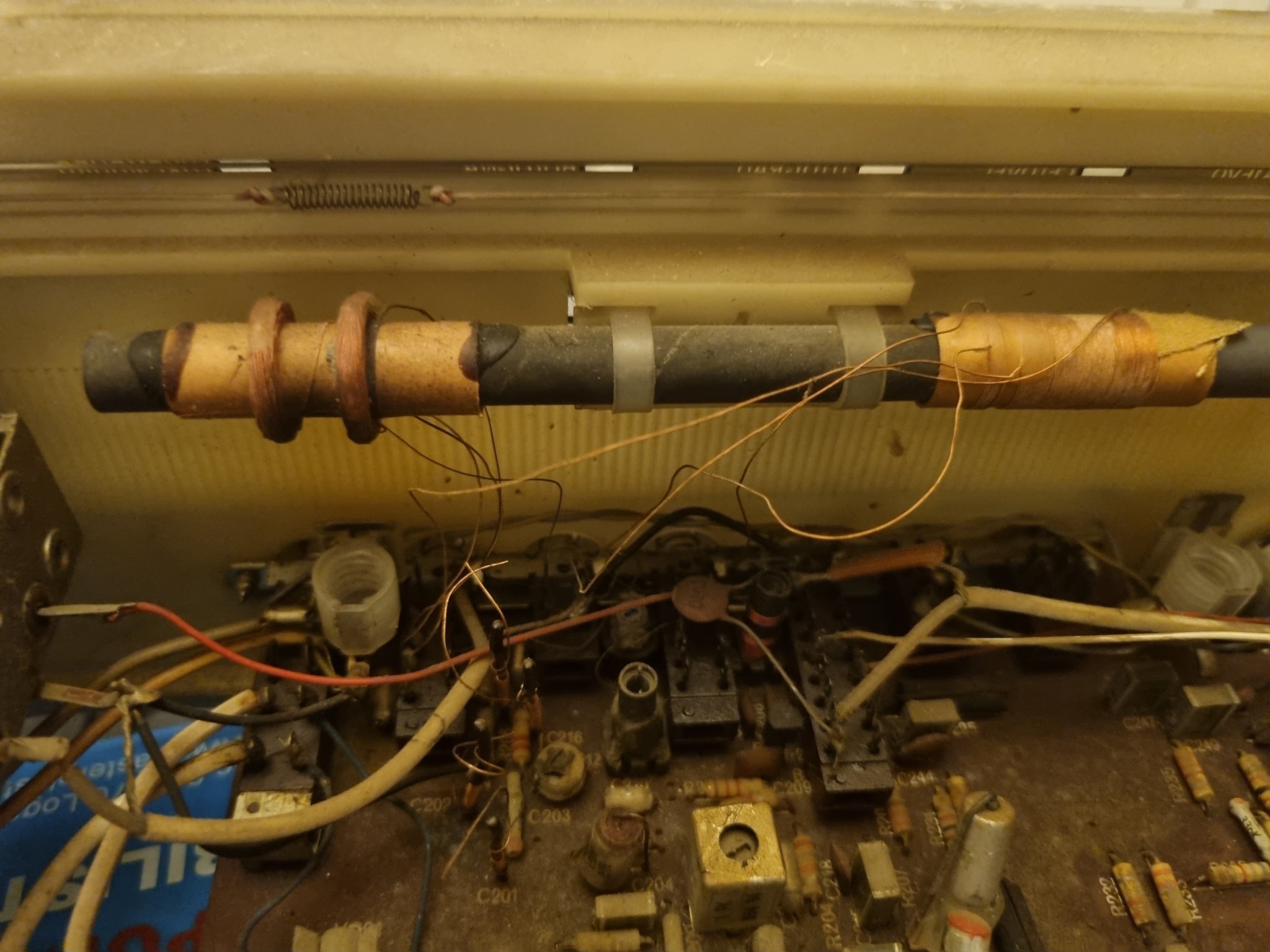

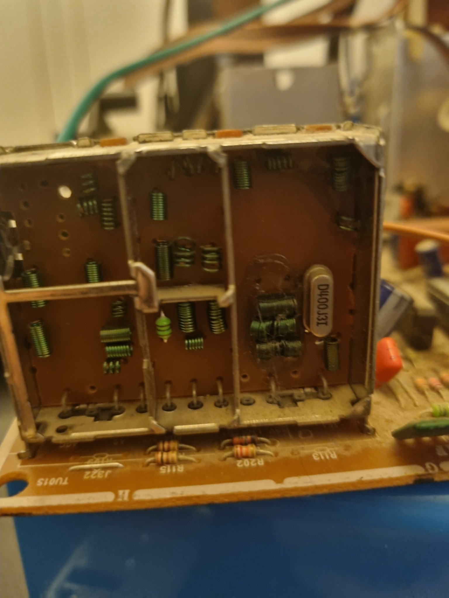

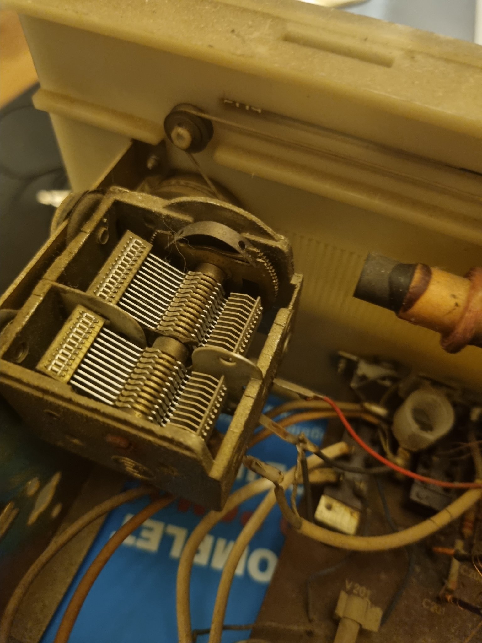

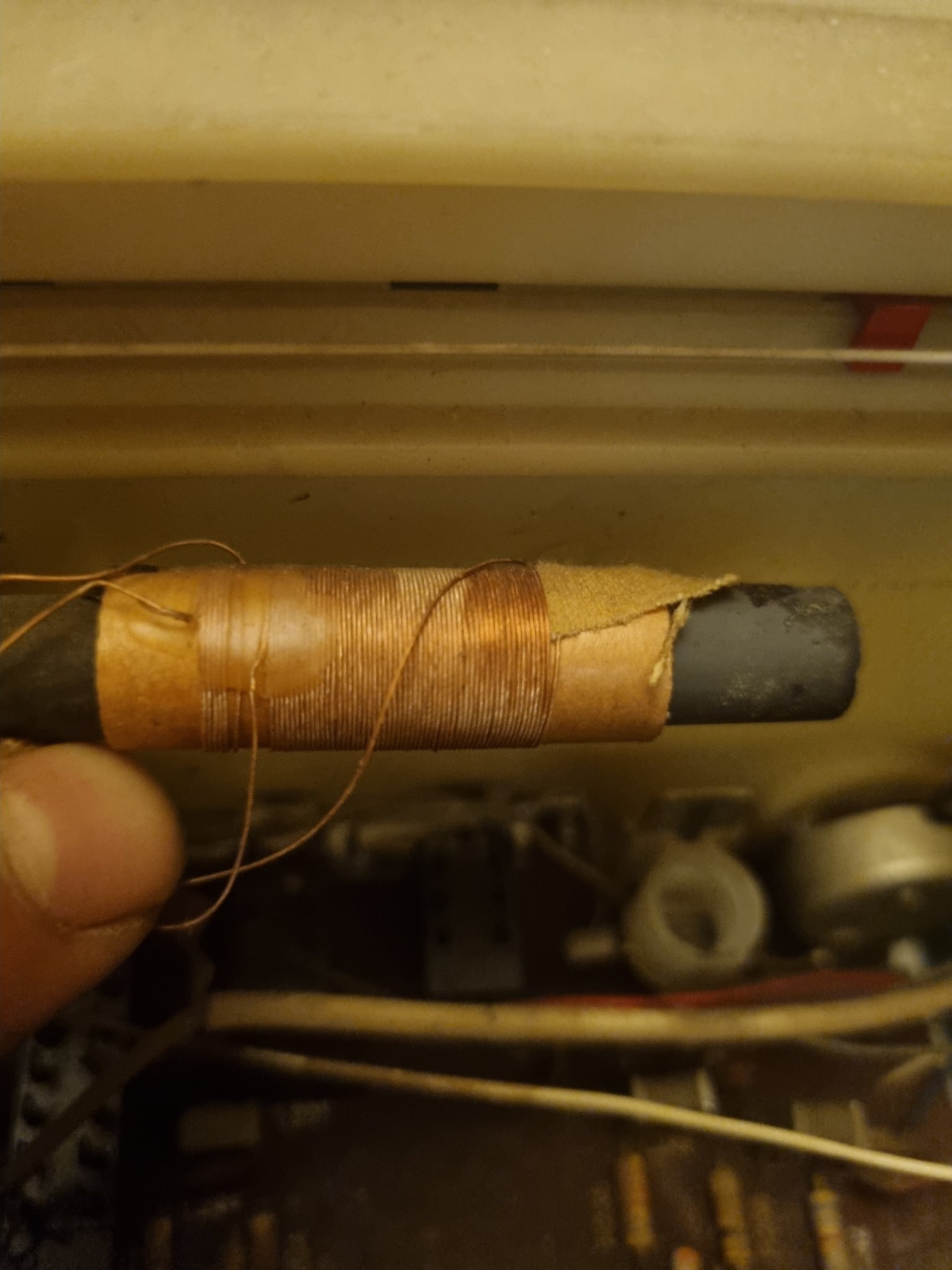

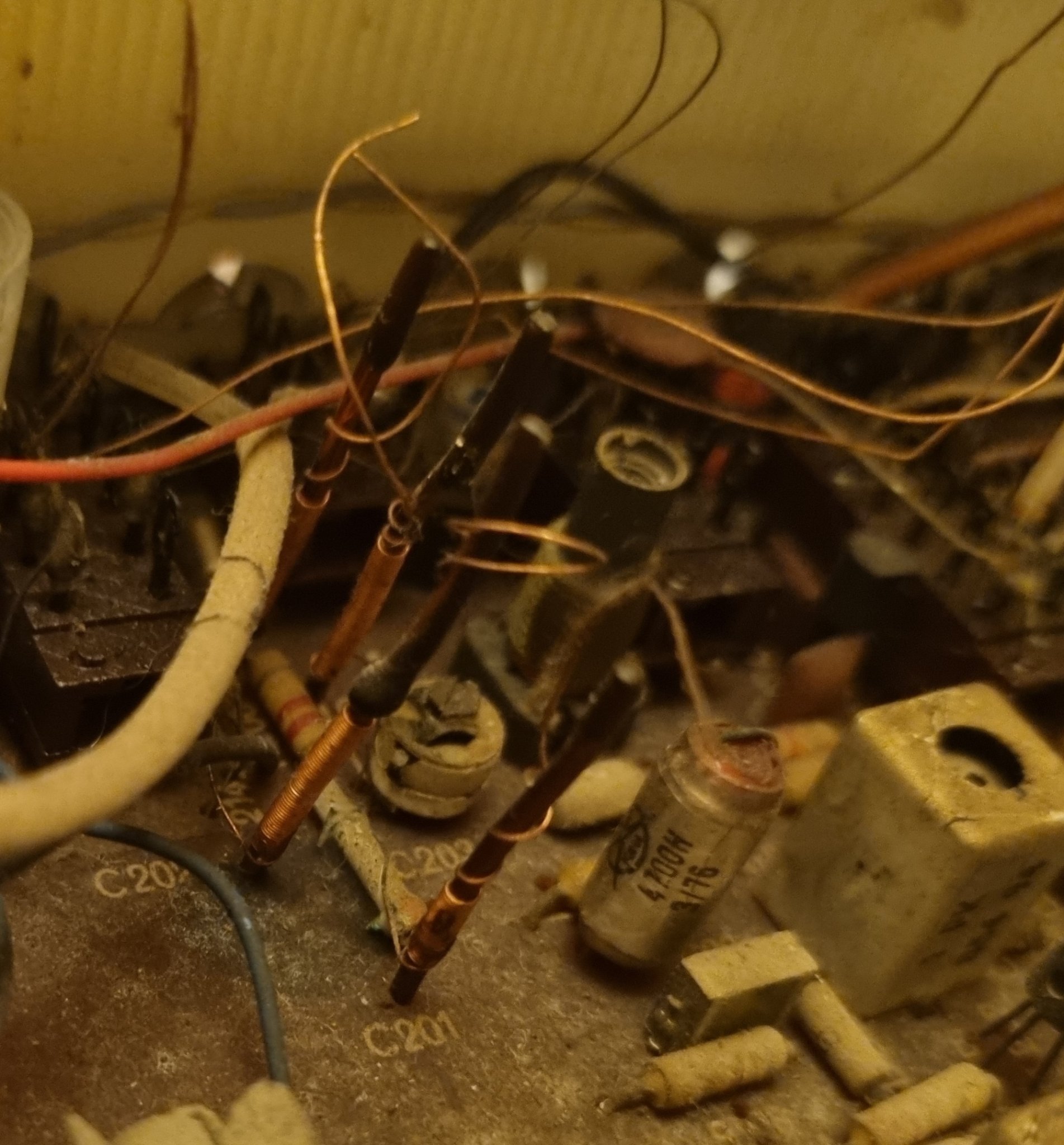

I hope something will be usefull from there, I must translate writings on some crystals, but I think the lowest I have is 4.433mhz.
There are the coils from the savica radio:
Left part, two coils wired in series, one small is also located green coil under the right coil:
Right part, two coils:
4 small coils with pigtails:
Trimmer:
Whole thing:
Coils from hifi system, where antenna connects:

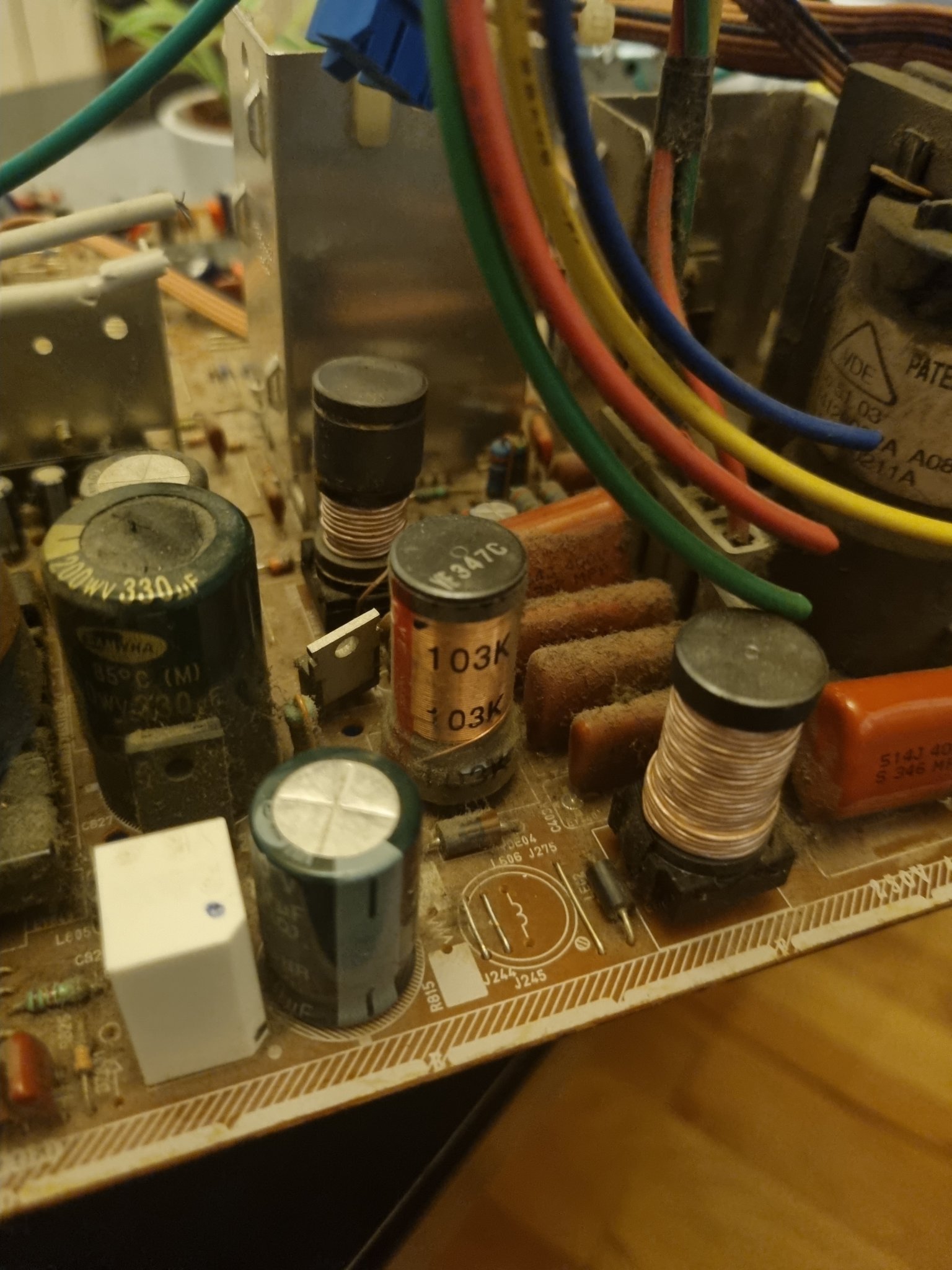

Chokes from TV board on high voltage side:

The gang (you called trimmer) above depicted is pretty fine for final tank. 4.433 is fine too. The coils from PC monitor or TV's don't work fine at HF. Those ferrite coils are good only up to 150 or 200KHz. And has too high internal parasitic capacitance.
The pair of coils at second pic may be fine for cathode choke at oscillator stage.
The proper sequence of facts ideally are:
1. To make the oscillator to work fine.
2. To make the RF amplifier to work fine too. To do this job, you will need the mA and a small lamp such those used in radio dials. No neon nor led: filamentary lamp.
3. To assemble audio amplifier and couple it to the RF stage.
4. Check modulation in a short wave receiver.
This is the best part. You will listen it at 4.433 and harmonics because of proximity of tx and rx will put the last close to saturation.

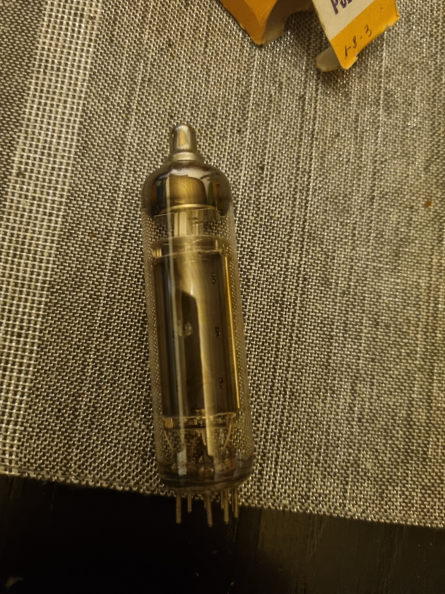

Looks like I will need to order PCL805... this is the only tube that have signs of use and text came off... it was stored in PCL805 box and somebody written PCL805 on there one more time by hand.... but it has metal cap... this can't be the right one. Thankfully PCL86 looks brand new.
