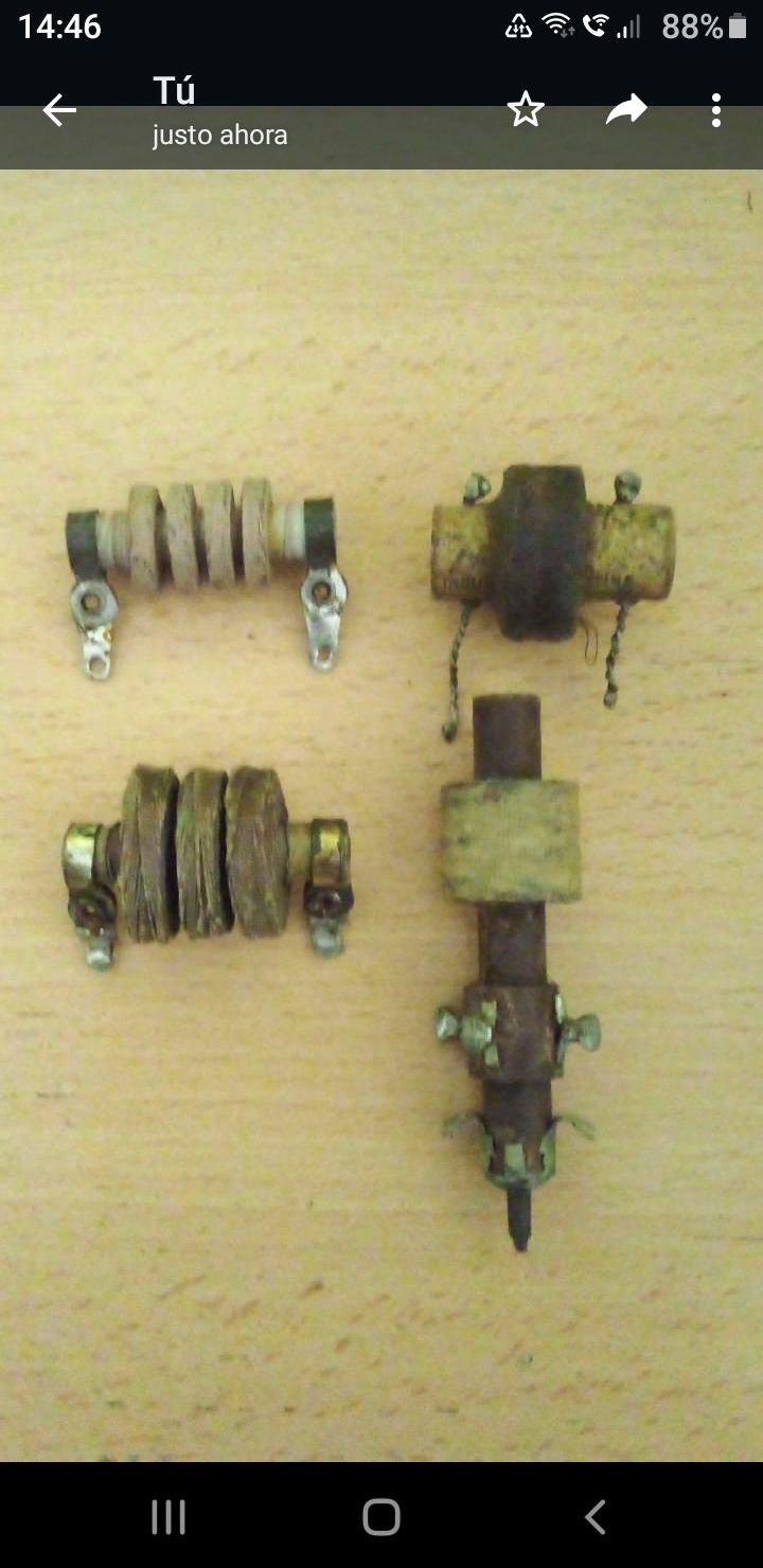

Regarding the RF choke, you may use any coil at hand with 500uH or more. You can buy one, get it from an old TV set (peaking coil in the video amplifier) or using the full coil of a transistor radio ferrite antenna. The long rod of the last will help irradiate the RF field.

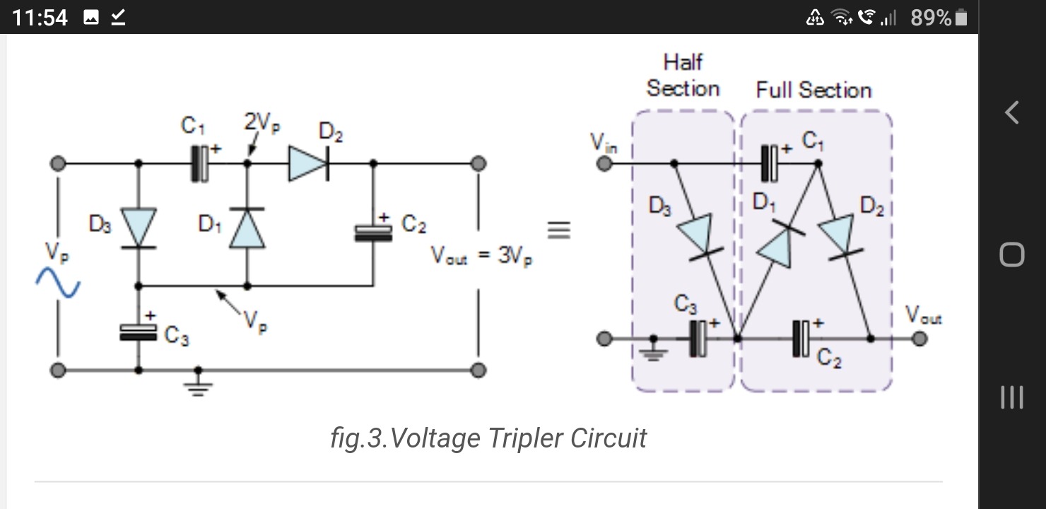

No, greatz bridge no. Look at google for "voltage tripler". 3 independent isolated diodes are needed and 3 electrolytic capacitor. 100uF @50 or 63V suffices.

Will build voltage trippler.

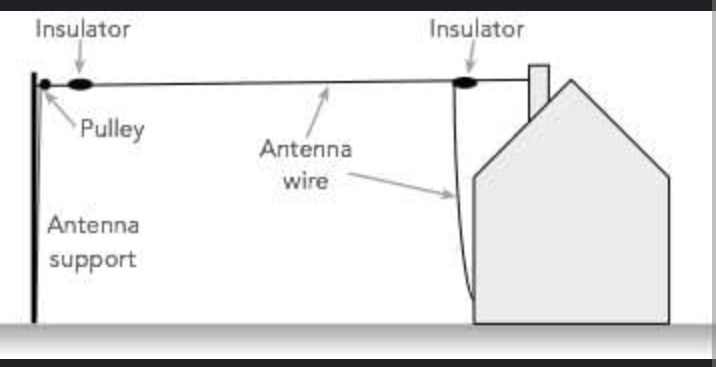

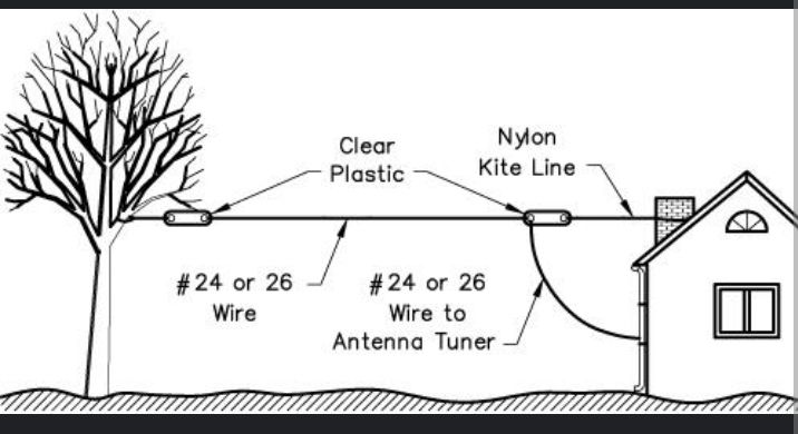

Usually you don't need an authorization to receive any signal. You can't radiate power over 100mW here, but it depends on local regulations.

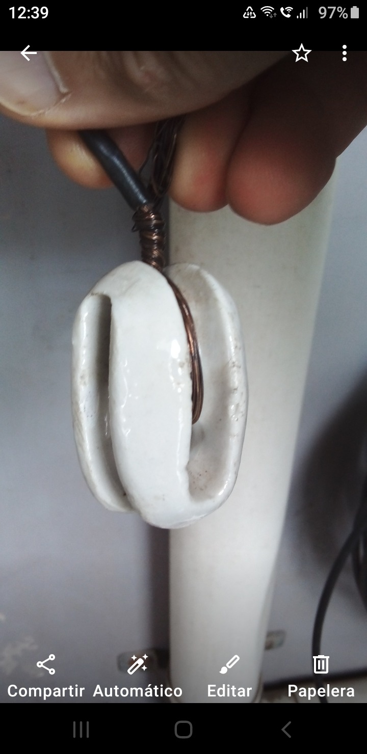

And for using your receiver, you don't need an expensive one. You can build its own for a very small amount. Get a couple of good insulators like the depicted below and a piece of wire as long as you can. The longer it is, the bigger is the energy taken off the signal. Put both insulators at the ends of it; and the wire as high as you can and via a coaxial cable whose impedance is any, say, an excedent from cable TV may be, and hook them to the receiver. The live (inner wire) of the coaxial must be connected to the insulated long wire. Shield is unused at the aerial side, or ground it to a large metallic structure if close to it. Protect the joint between wire and coax from rain, moisture, dust and bugs. Take the other end of the coax to the receiver and enjoy. I really don't know if today are short wave radioststions still on air.

I must see in my Iskra Savica spare unit for those...Well. And,... do you have some coils like those ones? They are called Radio Frequency Chokes. They act as audio chokes but at higher frequencies.
