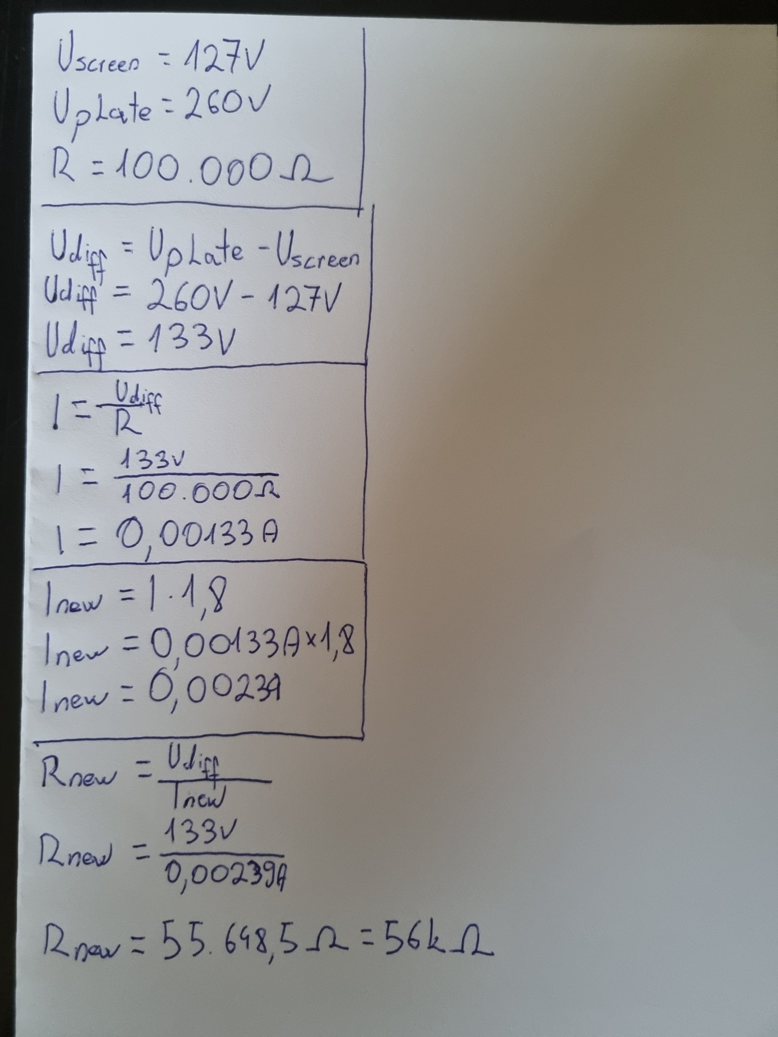

Try halving the value for the triode plate. Say, 47 or 56Kohm. Use 1W to be safe. For 802 screen, anode current in a pentode is +/- a fixed multiple of screen current, beween 4 to 6 times. So write down DC screen and plate voltage and resistance. Thus, compute the current and use a new resistance who give, say, 1.8 times the actual screen current. In any case choose the immediate higher resistance value, and operate it keeping in mind that this will alterate once more the tank adjustements. And after ~2 minutes in operation, and in deep darkness observe the plate of the 802 pentode. If it gets red and you are sure it is not the light reflected from other source, thus the tube is overloaded. That's no good for him. Shut down the PSU and use a bigger valued resistance. In any case about 20mA plate plus screen is a good value.I will play with it a bit today. Tomorrow I will go get the resistors for screen and triode. What values do you reckon I should get ?

Will do, tomorrow when I get the resistors.

Well done. Looks good. You are starting to think like an Engineer. In any case, like your tube may have several hours of running, don't expect exact results.

Looks like school did help me good this time (ohms law).Well done. Looks good. You are starting to think like an Engineer. In any case, like your tube may have several hours of running, don't expect exact results.
