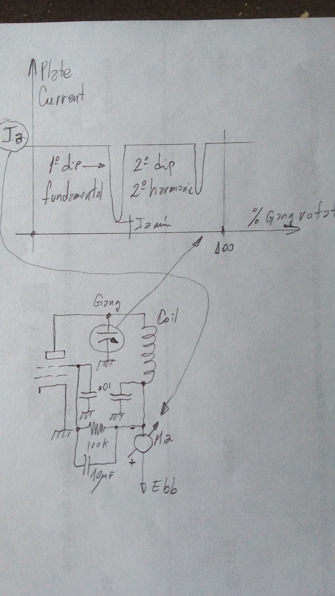

Below is rougly depicted the amplifier behavior. With the oscillator runing, give power supply to the final stage. The current in the mA will show surely a large current. Thus, start to rorate the tank's gang slowly from the plates totally closed (maximum capacity condition). If all is OK, there must be a point in the angle of rotation that the current starts to drop. Then it will increse again as you continue rotating it. The dip in the plate current means the plate circuit is tuned into resonance with grid signal and is what we are interested to get. Search with care the minimum of plate current. It may happen that if you continue opening the gang, to found a second dip of lower depht. This point is the second resonance an the amplifier now is a frequency doubler, that is the amplifier doubles the frequency on its grid. In audio, it is undesirable (harmonic generation), but in RF ot is sometimes desired and wanted. Also it may create a third harmonic and we have a frequency tripler. With the constants we have, it is possible to find the 2nd harmonic but rarely the 3rd.
Once the dip in the plate current is found, move slightly the plastic gang in the oscillator. You surely will found the dip is still more depth. Iterate 3 or 4 times readjusting both gangs until the dip is no longuer upgradeable. This is the proper tunning without load of the amplifier. If you have the receiver to be used as monitor, you must ear a depth, and loud clean signal into it.

I want to check just to make sure. You ment to wire resistor across the plate and screen, right? And plate goes directly to coil, no resistor in series?
No. Screen resistor goes to the cold side of the plate tank, for DC are the same but no for RF voltages. The hot side is only composed by bottom wire of the coil, the stator of the variable capacitor and pentode's plate. No more things there.
Yes. The screen bypass must be there. The 10uF may wait.

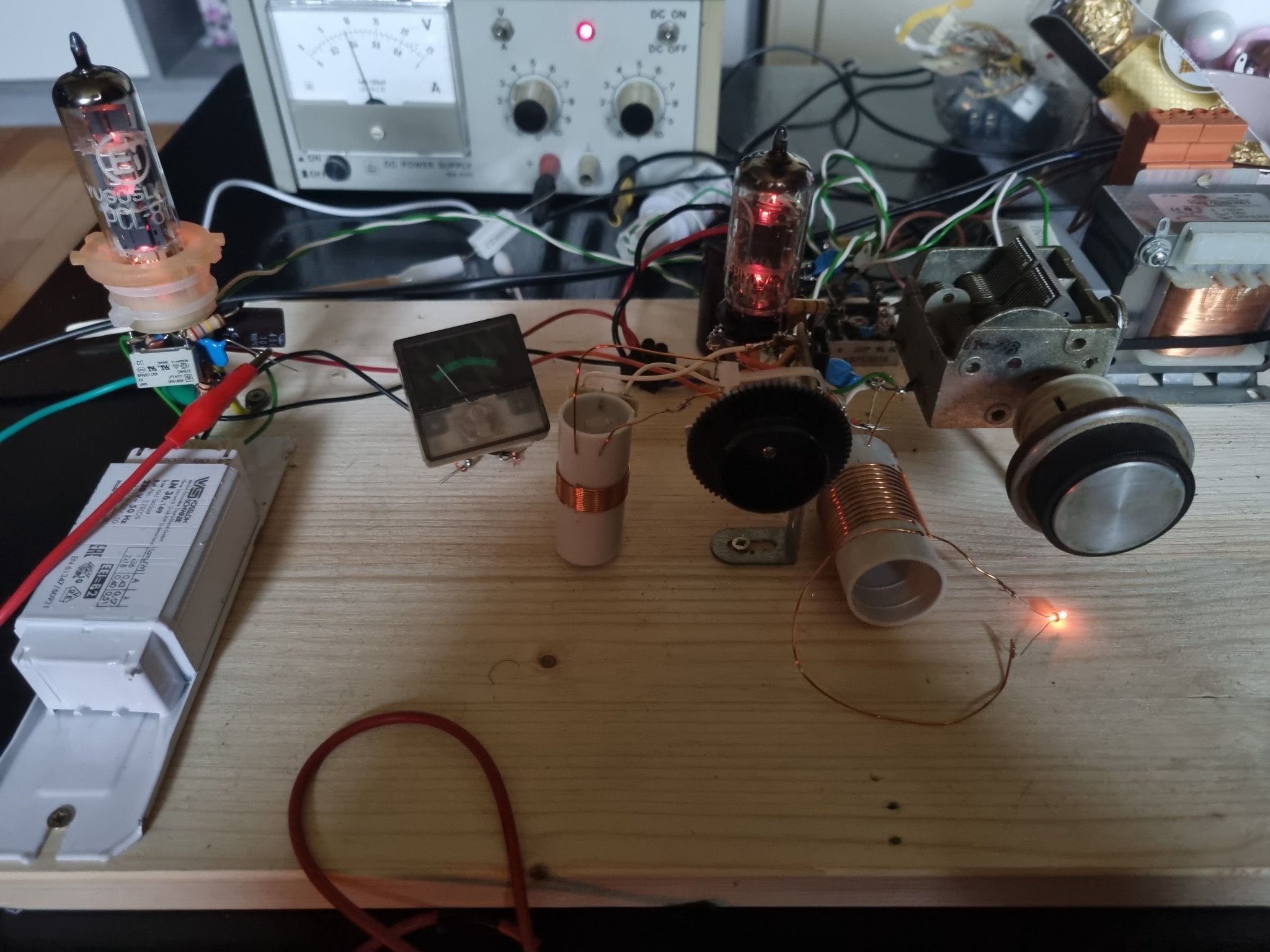

I had found the dip, there is only one. I can clearly hear it on the radio, buzz goes away and some static remains.
Bit of solder has jumped onto the gang and I didn't see it, unpleasant experience. Well I had my hand on the switch and switched off instantly. Thankfully it works.
Current is a bit bellow 10mA.
It lights up a herz loop 🙂

Wonderfull. Now its time to modulate it. 10mA for such a valve is okay. Hook on the '86 and attach the "mic" or "mike" (microphone) to the '86 triode's grid. Start the pot (modulation index control) from zero and increase until the desired level. Maximum m (modulation index) is 100% for an undistorted AM transmission (theoretically). Thus increase pot until the TX sounds distorted in the receiver. Once more, retune the amplifier. Or the coupling to receiver make them to oscillate (Larsen effect).
When attaching a load to any tuned amplifier, it will detune. In a tuned circuit, inductive and capacitive reactances are equal and (logically) on opposite phase. As you are coupling inductance (the loop itself), resistance (the bulb) and sometimes capacity (a slightly mistuned antenna), it will run out of proper tuning increasing L or C depending on load reactance. So you must readjust tank setting almost every time you make a change in the operating conditions. This also is normal too. Usually oscillator tank isn't necessary to readjust because you are using only one fixed frequency Xtal defined.
You will also see variations of bright of the bulb at the audio level and a small variation in plate current. Excesivelly larger needle variations means amplifier being unlinear, that's overmodulated [m>100% or m>1], or misadjust in the RF tuned amplifier.

It works. I had tryed with music and the mike. Herz loop with it's bulb helps alot to indicate if big gang is adjusted right.
However I have a big problem. It's the buzzing. It is much louder than the sound. Shorting signal input to gnd doesn't help and I can hear different buzz when touching input path... This makes me beleive it's not the input. Once I tune the big gang to the right position, buzz comes much louder.

I had wired in the 10uF bipolar and light on the herz loop doesn't shine as bright, but it reduced the buzz.
I had found out that I can alter the frequency quite a lot... my starting point was 7.3mhz, but I can lower it to about 6.7mhz... god knows for how much higher it can go, but my receiver wont do above 7,4mhz. At the higher frequency that my reciever can't hande I can get the herz loop bulb to shine much brighter.
Also is the herz loop a good test for power output? I'm asking because sometimes bulb is not lighting at all, but I can get better sound from the radio.
