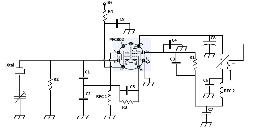

I had some free time (I work on demand) and managed to draw schematic for PCF802 on work computer.
I figured it will be simpler to label all the components with numbers and I can update the values on it as needed.

When the oscillator is ready, you can check oscillations by 3 ways:
1.- Hooking an oscilloscope at the oscillator's cathode. You will be able to see a relatively clean sine wave at the crystal's frequency.
2.- If you have a receiver capable of listening short waves. If the crystal is much lower than the receiver's coverage, you can listen it in a harmonic, say, 2; 3 or 4 times crystal fundamental although each higher harmonic is lower in intensity or field strenght.
3.- Having the grid bias leak in the pentode section but leaving plate and screen unpowered, you must be able to read a DC voltage across the grid leak and bypass capacitor. Ideally this voltage would be about 20 to 50VDC negative at the grid side of both.
Any device hooked to the oscillator, loads it and then changues slightly its amplitude and frequency. This is a normal situation. So try to use only one thing wired to the oscillator. Use as short wires compatible with clearness and safety between high voltages (both RF and DC) and ground or AC grounded parts (anode of the triode for example). The oscillator's cathode although it will have few DC volts, it will be live for RF several volts. So, measuring of DC volts at the cathode while the oscillator is active, will cause a digital VOM to become crazy although properly set. This is normal too. This usualy don't cause damage to VOM nor to triode, but expect any unreasonable readings.
