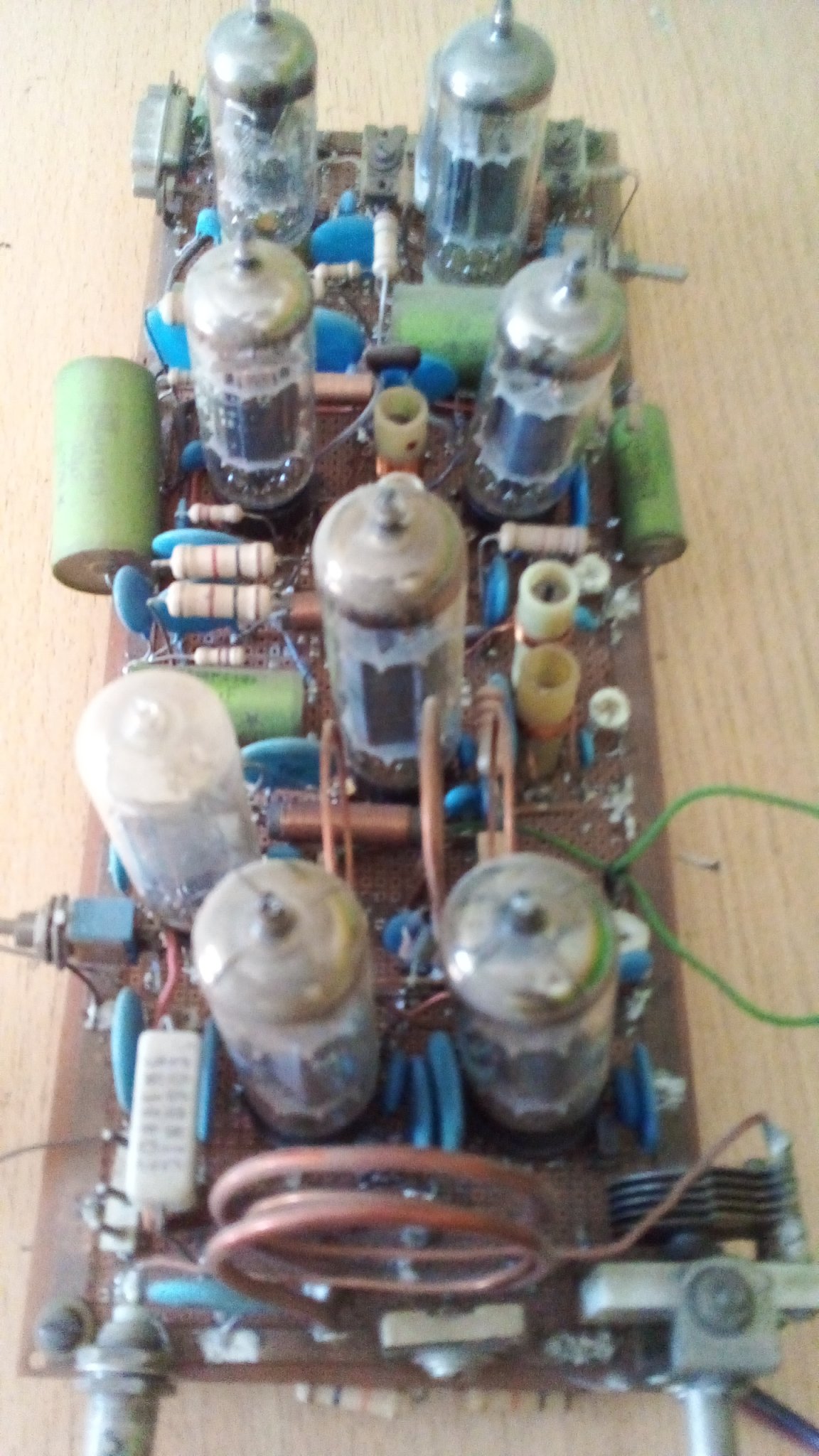

Help me put these tubes into good use... I need a project
This inexpensive but useful device I used to test my all-tv-tubes 150MHz FM modulated experimental TX. I used 2.5V lamps, but I blown several of them.

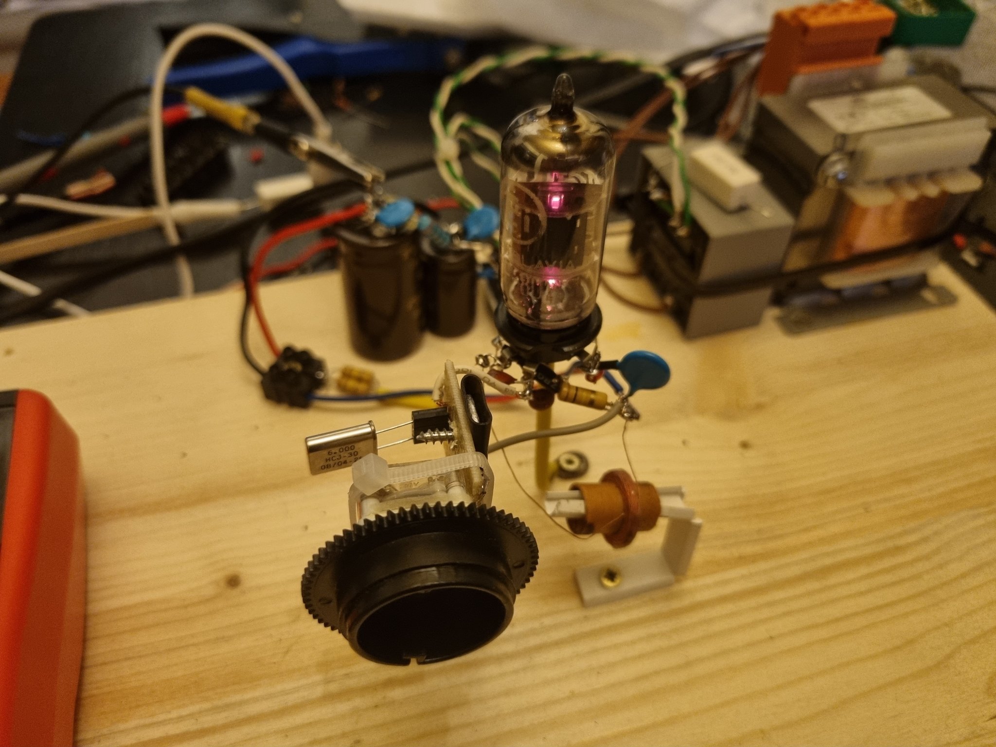

Just to confirm if it's ok... I built essentialy the same thing that is on the schematic that you sent me first... the oscillator, only difference is that I had already wired pin 7 -pentode's cathode to gnd.
For trimmer before the crystal I had used small plastic gang from newer radio... I had seen some people using those on similar projects. Should be good right? What value capacitor I could use instead of trimmer if I will need to be troubleshooting?
Right now I get -5v (negative) on triode's screen, is this ok?
Perfect. As the grid goes negative is because it is oscillating. This is a good proof.
The gang may work. Take into account that may be a point near the minimum capacitance the oscillator may stop as too low C decouples the crystal fom the triode. Try also to make wiring shorter.

Congratulations. Welcome to the RF world
Thank you
I was never so happy to hear the silence.

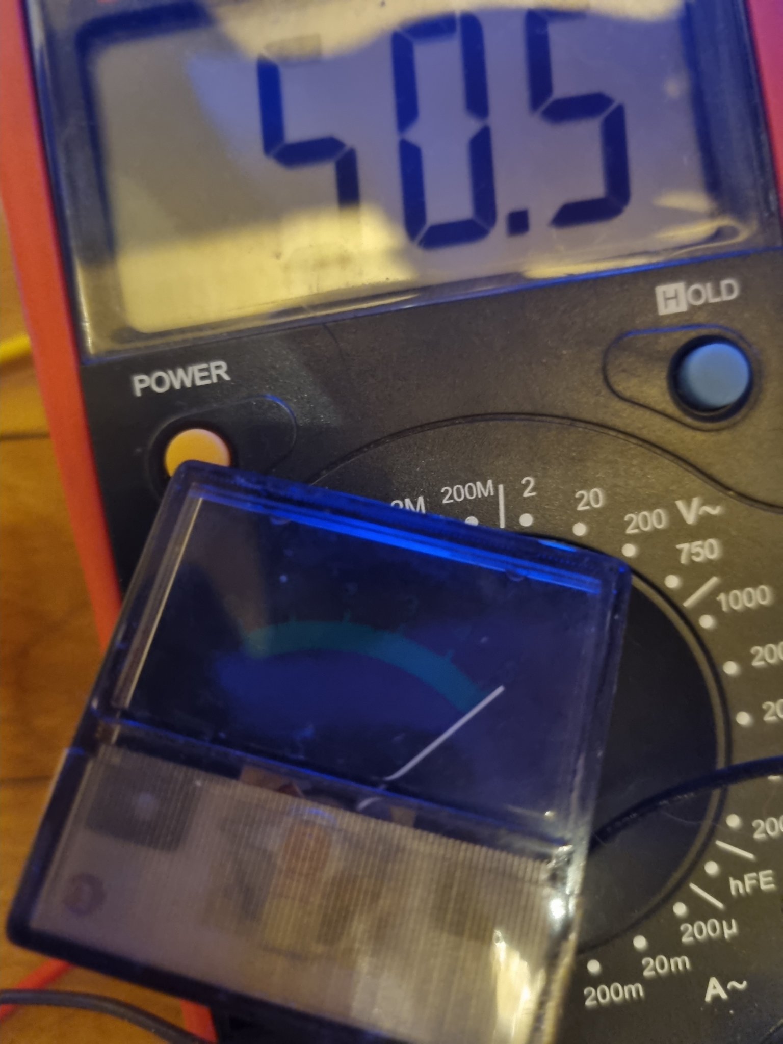

Prior to start building the final stage (pentode section) it is important to have at hand a milli or micro ammeter. A direct device capable of 25 to 50mA suffices. If you lack such a range, it may be any microammeter properly shunted. Measure the full scale range and the coil resistance. Thus you need to make a shunt to be wired in parallel to the ammeter to take an idea of the current drawed by the final stage. Again, any analog moving coil will do. The final stage current will produce a large dip (a minimum) when the tank is adjusted to resonance with the signal at its grid or at an harmonic. This point of minimum is important because two reasons: the amplifier is safely managing the signal and giving the most from it. Once the minimum is found, the amplifier is tuned to resonance and is capable of delivering power to a load.

Ok, I had just finished the modifications, wires are shortened, plate voltage is 160v (50k resistor used) and I had split the two pies of coil & cut the bobbine.
Noise got more silent as I dropped the plate voltages, I didn't notice any other changes.

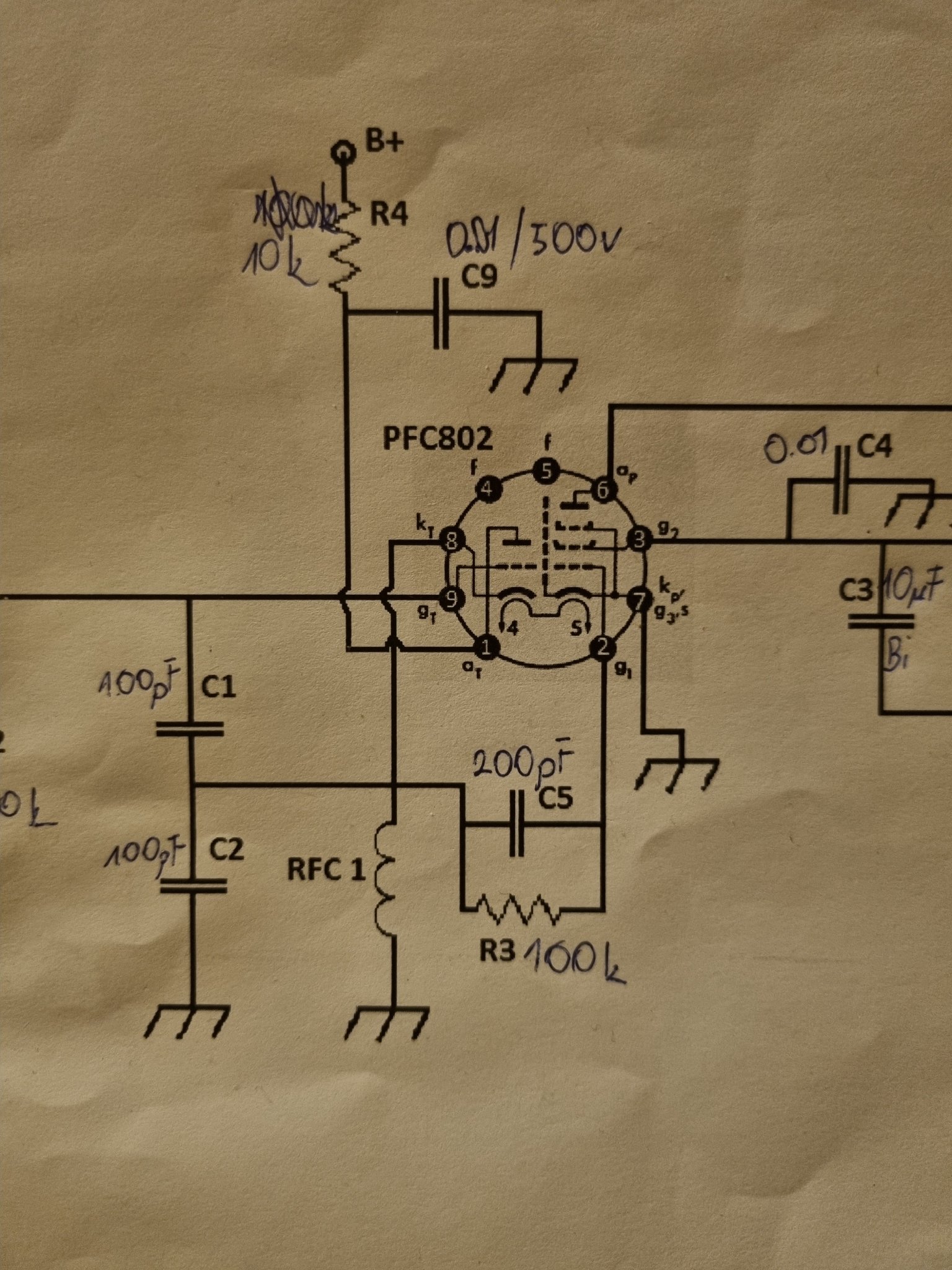

Next time let me know if the pentode's grid biasing resistor and capacitor (100pF & 100K) are placed in site. If the case, say us which is the voltage appearing at the grid side (negative to the grid pin). If it is below 15 or 20V, thus we will need to change the capacitor divider across grid, cathode and ground in order to increase slightly the current to the crystal and increase the excitation for the pentode.

Amp meter solved 🙂 old VU meter with 2.2ohm shunt resistor.
I'm a bit lost about pentode's grid biasing resistor, is it R3 and capacitor is C5? If that is the case is 200pF good for the C5?
Those two are not in site yet, just let me know if I should use 100pF instead and I will add both components and report.
