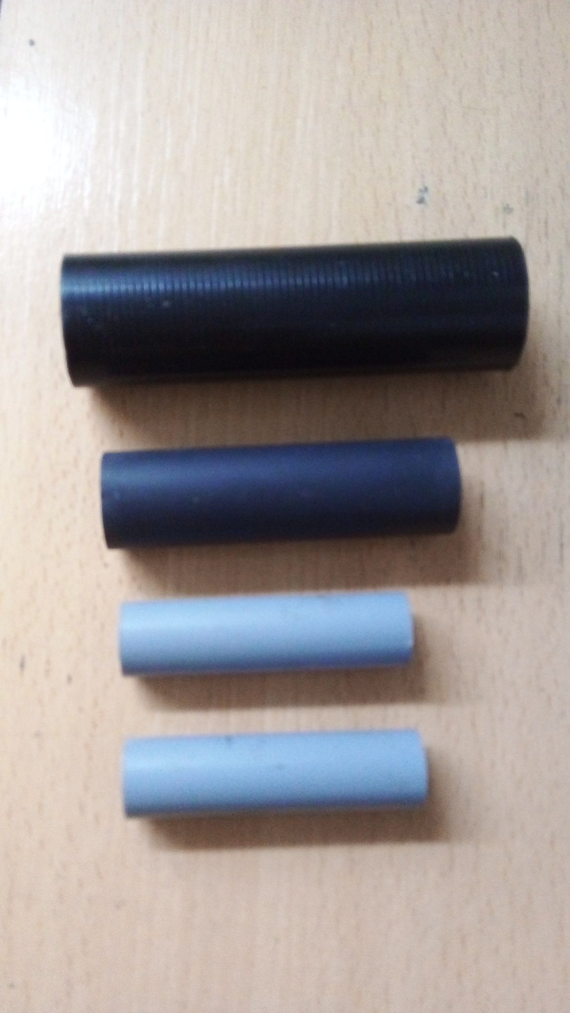

Also let us know if you can measure the large gang capacitance (the bigger one in the radio) and if you have a piece of plastic tube say 2cm diameter and 2cm height to start building plate tank circuit. For this we will need about 1 metre of copper wire preferably enameled of 0.4 to 0.7mm diameter.

When you get the bobbin for the plate tank, verify at eye that it hasn't any metallic part inside it. If ot looks ok, place the piece of plastic in a microwave oven during 3 o 4 seconds. Thus open the door and check if its temperature rose notoriously, it means that is highly loose for RF and discard it. Those piece of tubing from fax or electronic cash registers go OK for the task. If several of them are at hand, catch those in the 2 ~ 3 cm diameter.

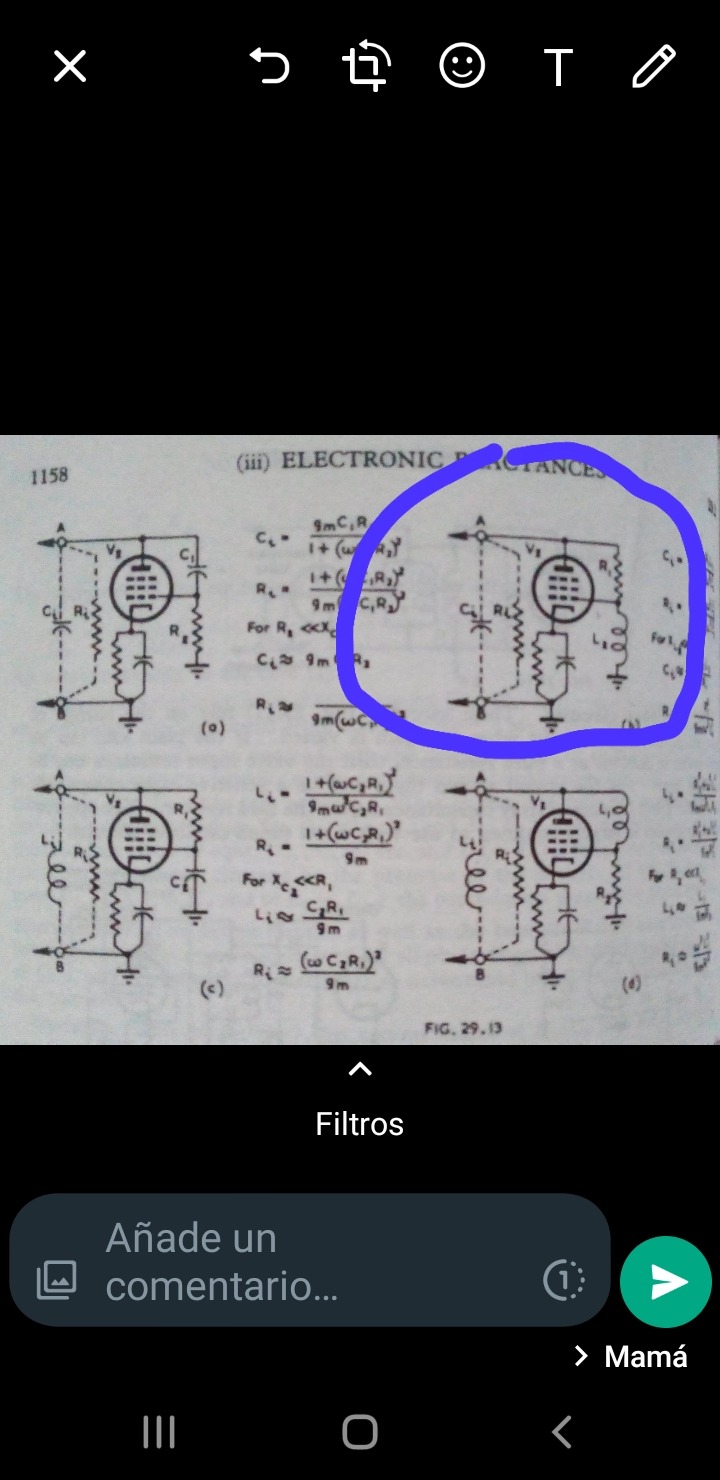

A crystal oscillator can also be used for narrow band FM, when designed for it. Such a circuit goes under the name VCXO. For instance, a standard CB Xtal (~9 MHZ fundamental) can be pulled about 20 KHz (enough to make a 99 MHz FM transmitter as linearity can be approved via frequency feedback). https://ecsxtal.com/what-is-a-vcxo-voltage-controlled-crystal-oscillator.The project at post #102 formally uses phase modulation. Try to frequency modulate a Xtal results in phase modulation.

Good to know, but one thing at a time.A crystal oscillator can also be used for narrow band FM, when designed for it. Such a circuit goes under the name VCXO. For instance, a standard CB Xtal (~9 MHZ fundamental) can be pulled about 20 KHz (enough to make a 99 MHz FM transmitter as linearity can be approved via frequency feedback). https://ecsxtal.com/what-is-a-vcxo-voltage-controlled-crystal-oscillator.

Yeah. But I believe that for good sound modulating a Xtal with reactance and listening in a regular FM RX, it is needed to pass the audio signal by a severe low pass filter in order to increase the low frequencies respect to the high because in the equation for PM is a derivative with respect to frequency thus high notes modulate the Xtal much more than lower if I am remembering well.A crystal oscillator can also be used for narrow band FM, when designed for it. Such a circuit goes under the name VCXO. For instance, a standard CB Xtal (~9 MHZ fundamental) can be pulled about 20 KHz (enough to make a 99 MHz FM transmitter as linearity can be approved via frequency feedback). https://ecsxtal.com/what-is-a-vcxo-voltage-controlled-crystal-oscillator.
The project at post #102 uses a pentode ECL84 as reactance modulator and the triode as the Xtal oscillator (note for readers: Xtal is an acronym for Crystal in RF jergon). There are two Xtals about some KHz apart in the 16MHz fundamental range, selectable with a common switch. The "reactor pentode" has a choke in the screen supply and a resistance to plate, both live for RF. The audio is injected from a walkman earphone used as dynamic mike in a preamplifier EF184. Thus the ECL84 is a capacitance multiplier driven by the audio signal. Them, 2 steps of EL84 each tripling freq. and the final is a push pull EL84. A EM84 indicator serves to adjust all the stages measuring the voltage rectified at the grids, critically coupled to the previous stage and plate and grids all series feed. The Frankestein gives about 4W into +/- 150Mhz with 240VDC @ 50 ohm. Observe all tubes was from TV and all has the x84 in the part number, so l called it "The 84 transmitter".

I'm looking for wire & bobbin right now and will build the tank first... Only question I have for the audio section is what kind of audio choke would I need. It's best that I try to get it ASAP, because probably I will need to get it ordered and might aswell order sooner than wait for it later.Okay. Thus its all by now. When you have at hand the elements to build the tank, we will continue. You are my hands at this moment.
