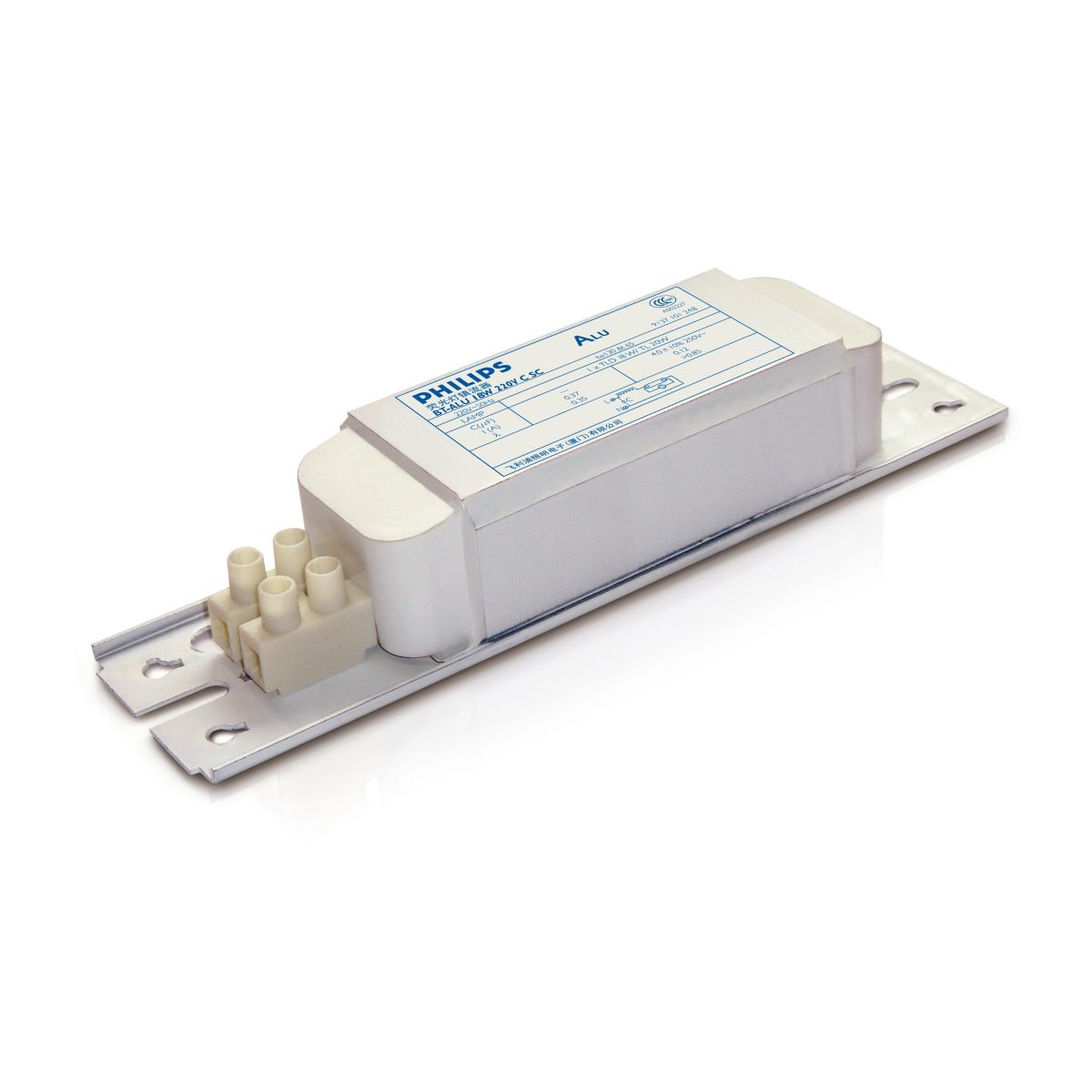

Would it be worth to get audio output transformer over ballast? I can get ballast for less than 10eur and localy...As audio choke you may use the primary of an audio output transformer, or an electromagnetic ballast for fluorescent lamps, 10 to 40 W. Not electronic ballast!
Audio transformer on the other hand... we know the prices 🙂

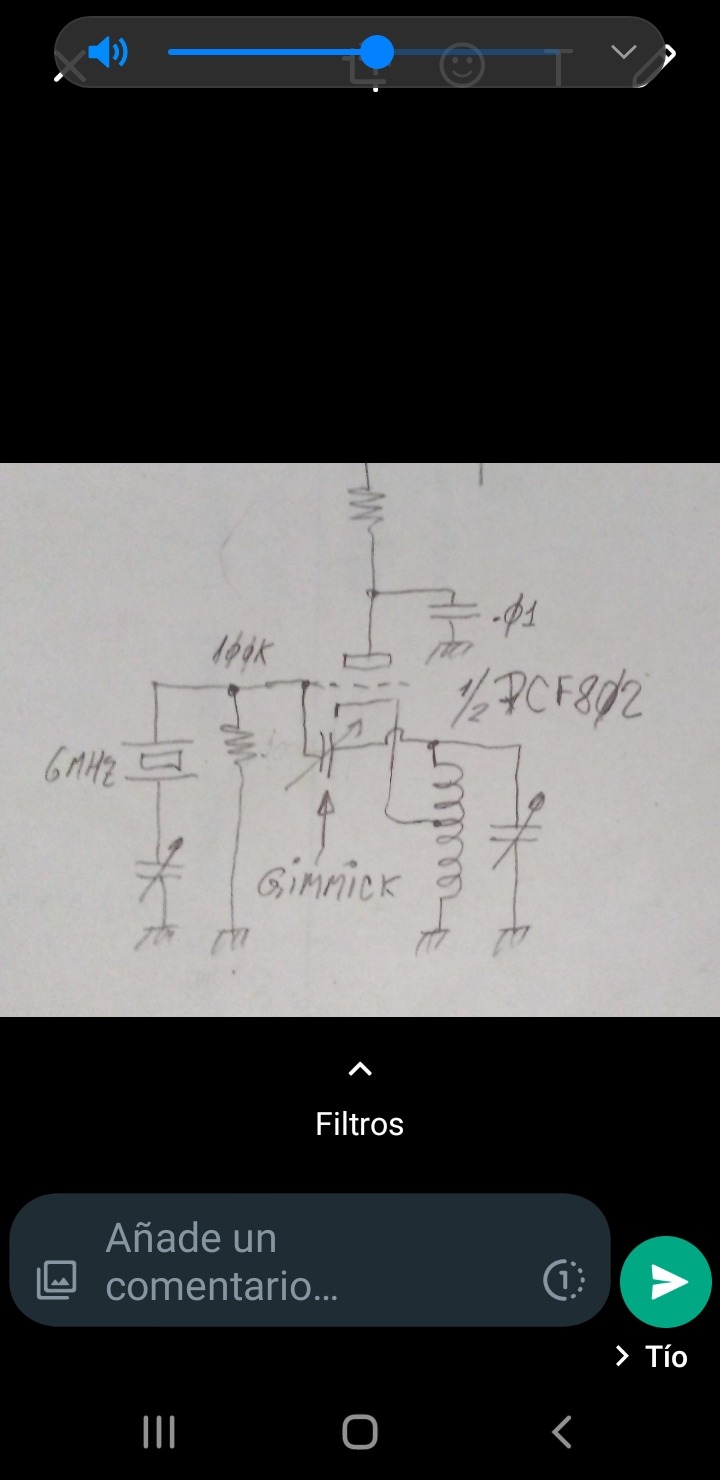

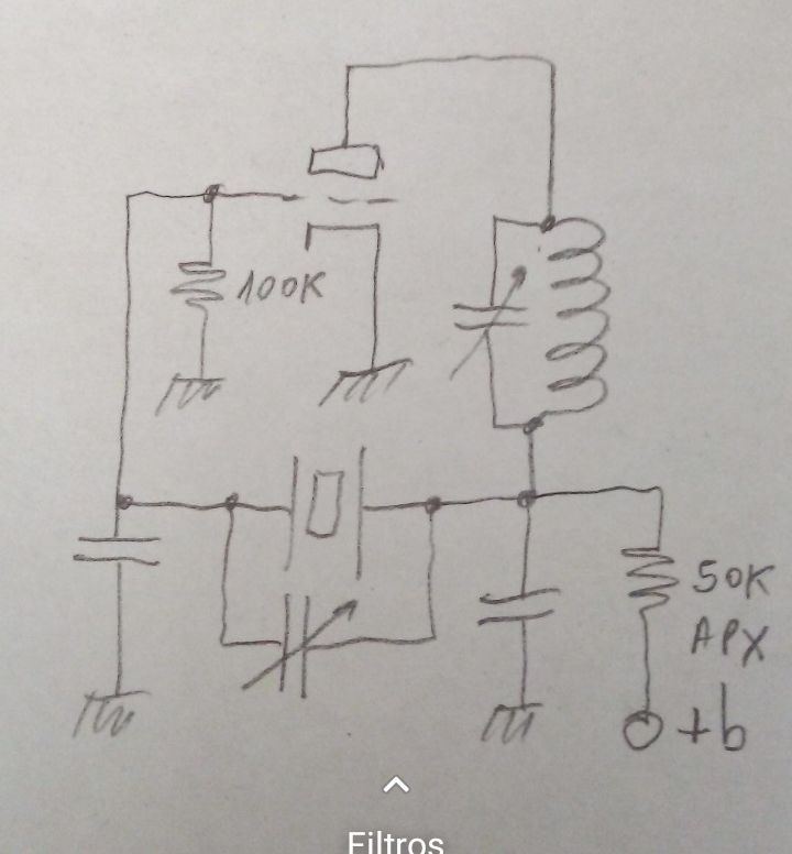

I was thinking about increasing the oscillator's efficiency in order to get a bigger excitation for the pentode final stage. You may try anorher oscillator topology. Do you want?
These are.
What is called a gimmick is a hombrewed variable capacitor made with two insulated wires whose dielectric is the cable plastic. No more than 5 or 6pF are needed and about 5cm of a twisted pair of cables may go; such those inside cat 5 utp. This is an old trick used for neutralizing amplifiers in tube low power or QRP transmitters. The coil is also a tank and will requiere some experimentation, and we no longuer needed the choke.
The second is also an option several times used by me. In fact the 150MHz already depicted after, uses this kind of oscillator.
Choose the one you like and talk obout component values.

Yes, I would like to. Sounds good.I was thinking about increasing the oscillator's efficiency in order to get a bigger excitation for the pentode final stage. You may try anorher oscillator topology. Do you want?

Honesty, I don't know wich one too choose. Are there any benefits with one over the other? I would like to put that 0.6mm laquer wire that I bought and would there be any "special" components such as more chokes that I would need to get for one or the other, except for caps and resistors?I was thinking about increasing the oscillator's efficiency in order to get a bigger excitation for the pentode final stage. You may try anorher oscillator topology. Do you want?

Ok, I would like to go with the second circuit then.Usually the second circuit (the one with the cathode grounded) gives best results.

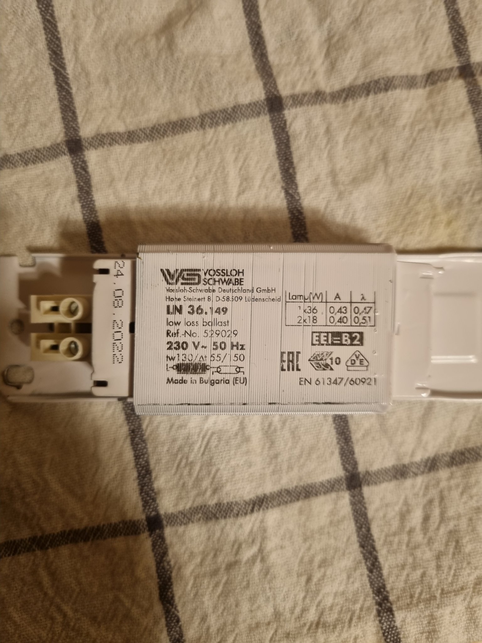

No, having the "audio choke", the milliammeter and the bobbins for the tanks, no more need for rare materials. That's all.
I hope that this is the right ballast. It's the only one that I could find and the last one in stock.
