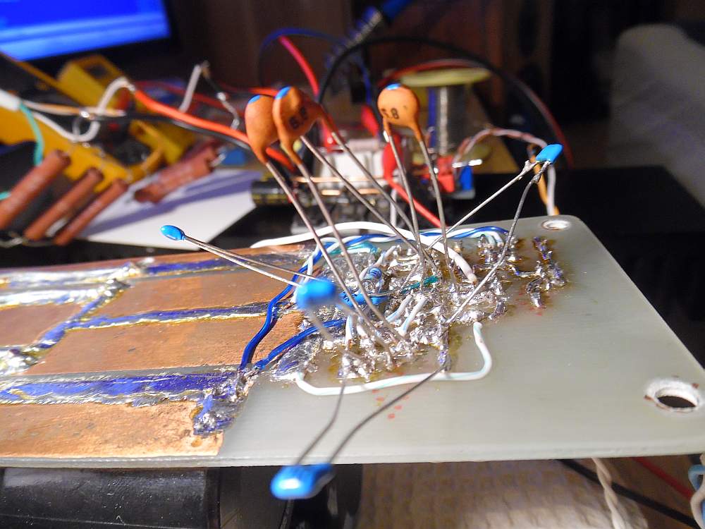

And here is a picture of my poor little "overcompensated" IPS as well... 🙂
  • spice.asc
    spice.asc

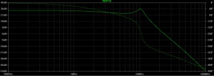

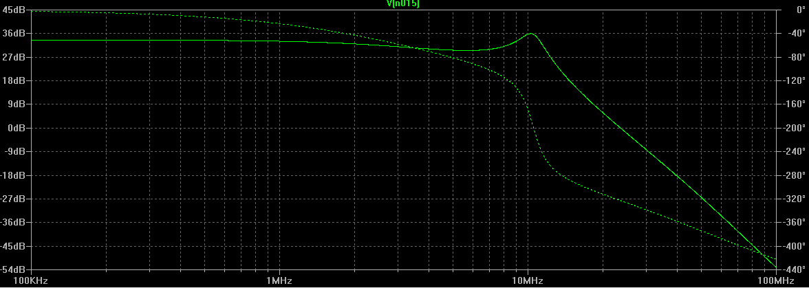

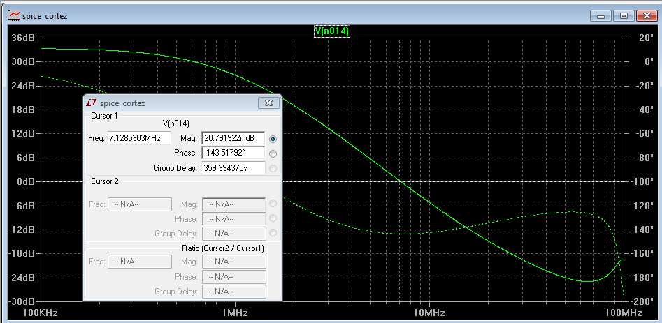

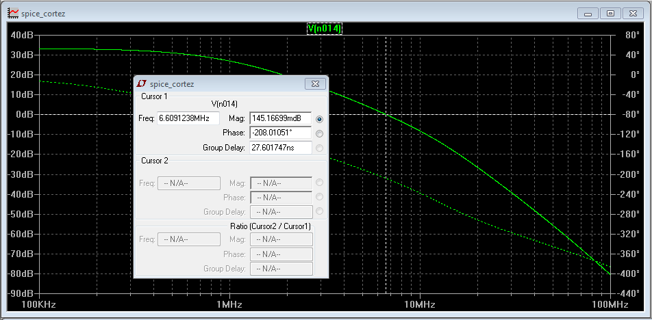

Paul, thanks again, it looks promising! 🙂
A stability question: I checked a closed loop bode with the version you sent, this is the 1st picture.
As I know with this -208° @ 0dB is not stable, right?

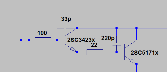

Anyway, this RC filtering @ OPS was just an idea, my OPS contains now only the 33pFs @ the pre-driver stage.
I made a bode with this setup as well, this is the 2nd picture.
Now @ 0dB the phase is -140° which is better and already stable, right?
But the compensation part looks good, I'll try it in reality hopefully in the evening!
The other issue: I have to be careful due to the underhand local OPS instability caused by these ultrafast drivers...
Hopefully I can check your compensation scheme without modding the whole OPS for a check...

I couldn't stand it and tried in reality quickly... 🙂
I have some oscillation but I guess its due to the OPS problems...
But otherwise the oscillation modulated result is looking good..! 🙂
(I couludn't take a picture due to the smoking current limiting resistors...)
Is there a way to separeate the OPS/IPS oscillation?
I mean: how can I know that an oscillation is casued by some OPS issue or from an improper IPS compensation?! 🙄
Other thing: as checked with CL bode this setup can not be stable without (< 22pF) the input filter cap, right?
Is this a bad thing or nothing wrong and acceptable?
