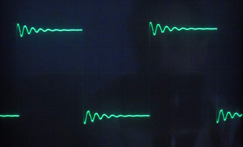

That's exactly what I did this evening and maybe (just maybe..!) I have some hope... 🙂before you dive into another layout design maybe you want to give the existing boards a last ditch attempt
In the morning I repaired my half-way-smoked IPS and googled this compensation topic.
I found TPC and gave it a try...
I started in reality just with the miller and the incrementally/experimentally
a lot of C values in almost every combination...
A finished with an intresting combination with just 2x10pF miller, 33pF from
VAS PD, 10pF from VAS ND and the original 47pF going to the current mirror.

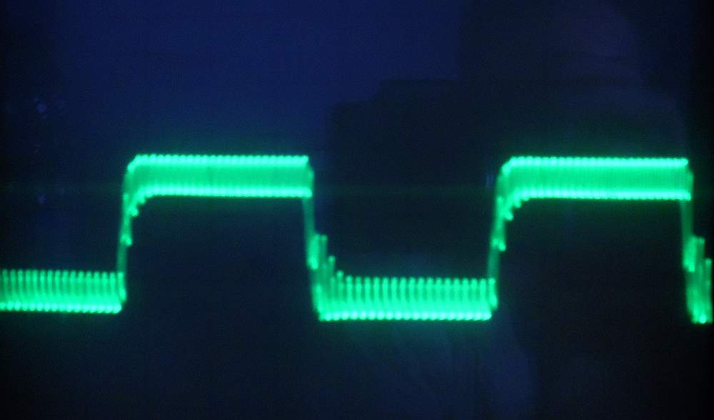

The result was quite good with the standalone IPS even up to 20Vpp levels.
Then I tried with OPS but it oscillates but the modulated waveform looks
"good", so I hope maybe now it's basically just my nasty OPS...
So tomorrow I'll try to MOD it according to your suggestions:
Reducing quiescent currents and placing RCs to the pre-driver and driver stages as needed...

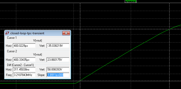

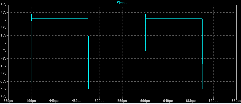

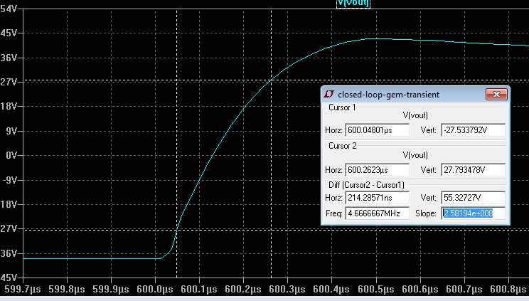

Results:

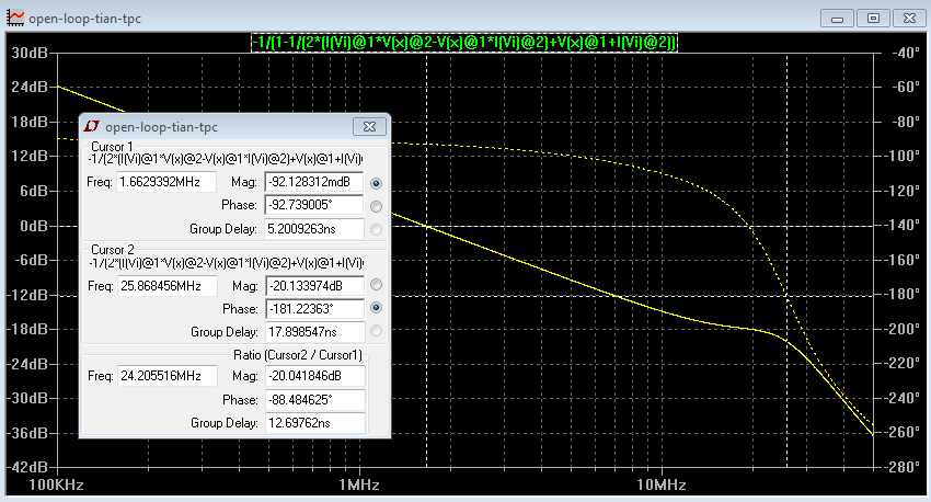

- #1: simulated bode: looks OK (but as you told me maybe this doesnt
mean anything due to the multiple compensation loops...)
Phase margin = 88°, Gain margin = 20dB
(Oh you cannot imagine how I wish this would be the reality as well... 🙂) - #2: simulated transient analysis shows no overshoot and a ~190V/us slew rate
(input signal risetime = 1ns, input filter removed) - #3: scopeshot with 200kHz @ 5V/DIV and the indispensable oscillation of course... 🙂
(Sometimes it's better just when I touch the VAS to OPS PD/ND wires/solder joints...)
Schematics attached as well...

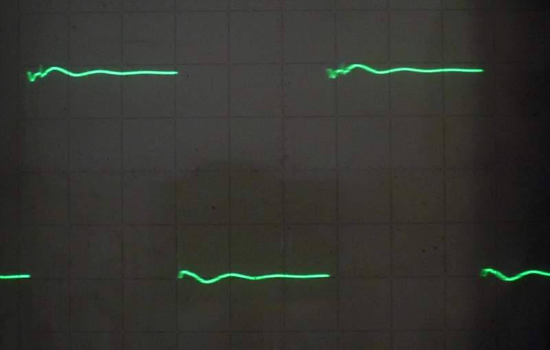

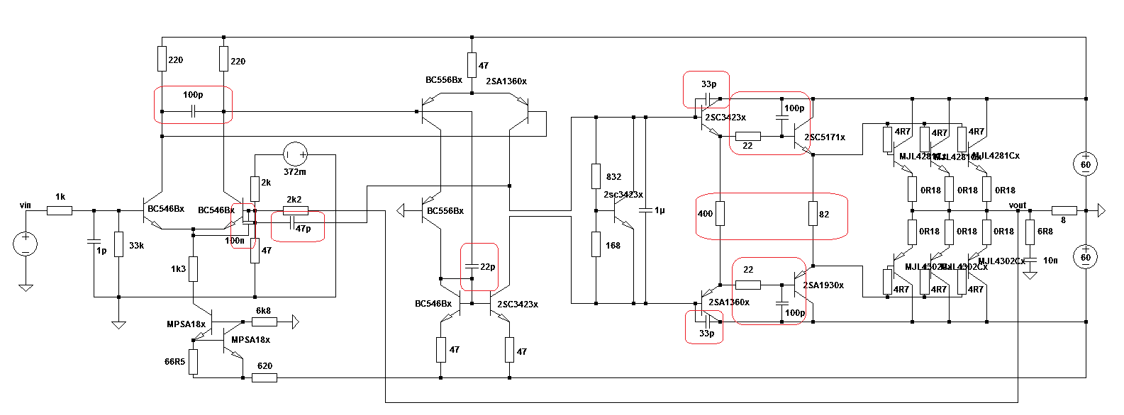

Today I found this layout:
http://bovan.net/gmweb2/gem100.gif
(Explanation: The GEM)
And that unconventional 10n at LTP Q2 B-E.
I tried and tuned the values and it works for me...
Beyond that there are 2 comp caps:
100pF from LTP current mirror B
and 47pF from VAS PD to FB.
I modded the OPS as well:
Changed the quiescent currents according to Valery's reccomendations.
RCs there: 33p on predrivers 22R driver base stopper + 100pF CB.
And take out the 680nF || on the driver emitter resistor.
But that wasnt dominant maybe it will help with long term stability
but didnt change much on the square wave response.

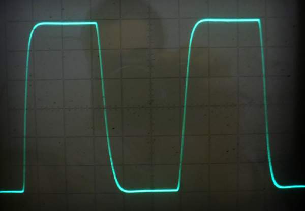

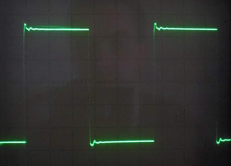

Result attached. (200kHz @ 5V/DIV, 47pF @ input)
Its stable even without input cap but then it has some overshoot and ringing.

Post an imagine of your scope using a 10 kHz square wave with a load of 8R in parallel with 2uF and see if it does not come unstuck.

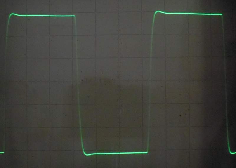

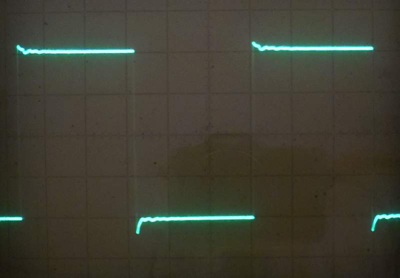

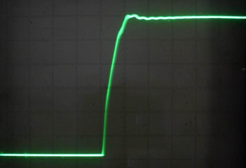

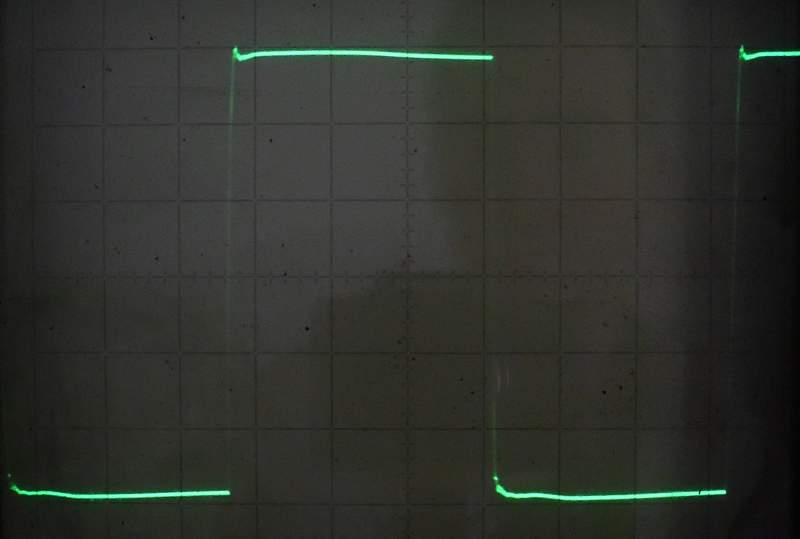

Guys you must explain this...

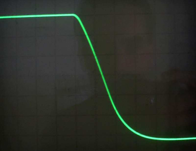

Out of curiousity I just tried a 100n(!) C there at LTP Q2 B-E and it's even better so...
Check out the results: (Sorry for the blurred images I just made them in hand...)
- 200kHz @5V without input filter
- positive edge
- negative edge
- capacitive load = 2u2 @ 10kHz (5V/DIV)

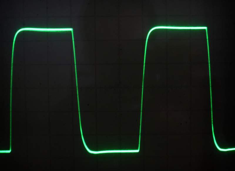

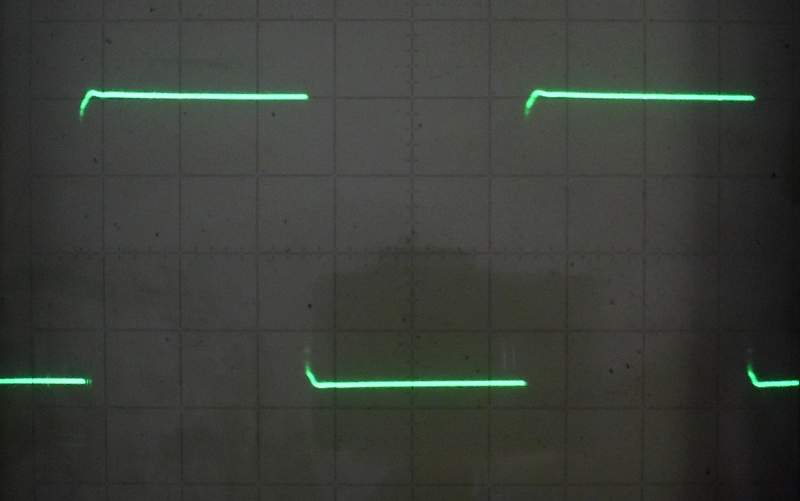

Take a better picture with 2u2 || 10R @ 10kHz 5V/DIV (current limiter reduced to 3R5/rail).
Strange that its a bit squared and not smooth and rounded sinus like... 🙄
But maybe it's due to the testing layout and long rail wires.
Even the Power ground is now taken from far from the PS center GND point.

I simulated the amp with this 100n and it looks like still both tails are working in AC as well both at LTP and VAS.
I attached the latest schematic both in open and closed loop analysis modes.
And some pictures as well, in order:
- spice transient shows a little overshoot without input cap
- slew rate in theory is 260V/us
- tian bode: phase margin = 80° gain margin = 13.7dB
- my function generator isnt ideal at all... (100kHz)
- the same with different voltage level
- rising edge (still just my generator)
- amplifier doing 100kHz @ 5V/DIV on a 4R7 dummy load
- testing with 10uF capacitive load @ 10kHz 5V/DIV (no current limiters now)

Oh, I almost forgot to tell: the OPS mod was necessary!
Yesterday I tried to remove/decrease the Ccb caps @ driver stage but then it started to oscillate!
With the 22R base stoppers at the drivers base 100pF was a good value.
Made a schematic and marked the mods made compared to the original design.
