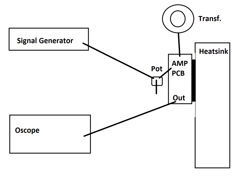

I tested the stability with different capacitive loads as attached and
I could easily drive it to oscilaltion with this two caps in the near...!
With the 1nF 400V and a 10n 630V foil capacitor. I tried with a lot of
different types and with other types of 10n didnt caused oscillation...
What can be the background..?! Simply capacitor ESL, ESR..?!
What kind if capacitnce has a normal speaker cable? This region..?
BTW: I guess thats exactly why an output inductor is a must...
Not because of a heavy capacitive load as this amp handles even 10-22uF
without any problem but there is (can be) a OPS self resonance which
I guess comes into play when the load capacity hits a critical value...
Or is it still some weak point at my OPS..?
RCs should cover all kind capacitive loads in this region?

Just a little update:
I built a fast square wave gen with the 7414 IC like here:
Squarewave Testing
and now my results are much cleaner/smoother... 🙂
The results:
  1. 100kHz @ 5V/DIV
  2. 200kHz @ 5V/DIV
Load = 4R
Input filter: 1k - 82pF
The Ton/Toff asymmetry is coming from the generator.
Is there a way to equalize it somehow..? 🙄

Those are your power amplifier results before your inductor?
Did you look at the generator wave form before making this judgment?
Generator: Ok, thanks Valery!
Inductor:
I tried it and the output inductor doesn't make any difference in this test.
I removed it and the result is attached: 200kHz @ 5V/DIV 4R resistive load.
I reduced the input filter to 68pF and even without it the amp is now stable, there's just an overshoot then.
It's not bad, isn't it..? I am so happy that it succeeded finally... 🙂

And hopefully the last upadte... 🙂
I finally assembled the amp all together and tested and still found one issue related to stability...
Maybe it's useful for others so I share.
Even though I tested on the bench the output RL (1cm x 12 round + || 1R) wasnt perfectly tuned
and the amp (rather the OPS) started to oscillate to an 820pF ceramic and a 10nF foil cap...
I was very disappointed and tried to remove the || 1R but even so it wasnt enough.
Then I tried with a 8R2 and now it's perfect to any kind/value of caps from pF to uF...
I tried all of my caps as attached they were my testing team now... 🙂
I thought the resistor is just for reducing the HF loss but as it seems it should be tuned precisely...
I made the tests with very short wires directly @ the output connectors
with open (I mean with a 10k pot) input and with square wave driven + with all the caps.
Every cap produced a very differrent ringing both in amplitude and freqency.
Even the same valued but different type of caps (ceramic/foil) produced a completely different result.
(BTW: I guess this can be good to method to analyse capacitor behaviour..!)
I hope now I can put any kind of cable/load to the amp without stability issues... 🙂
