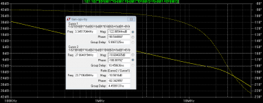

Is this formula and bode plot giving the final loop gain or "just" the open loop gain?
Yes, it shows a loop gain plot in the examples I gave, that is what one needs when examining loop stability.
I played a lot with your versions and then out of curiousity I tried to play with my
original/initial version as well and found that in spice it's not hard to achieve
a stable state I guess but in my case it's not working in the reality, check this out:

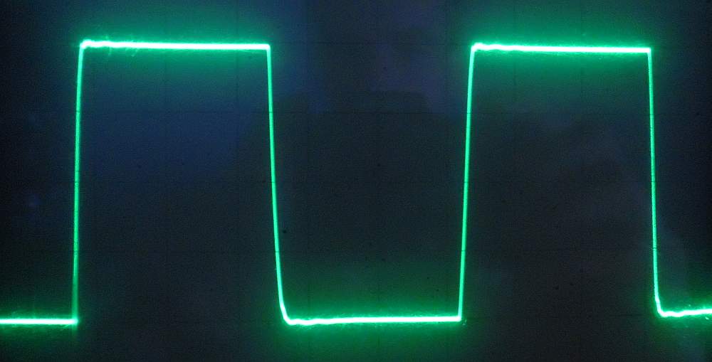

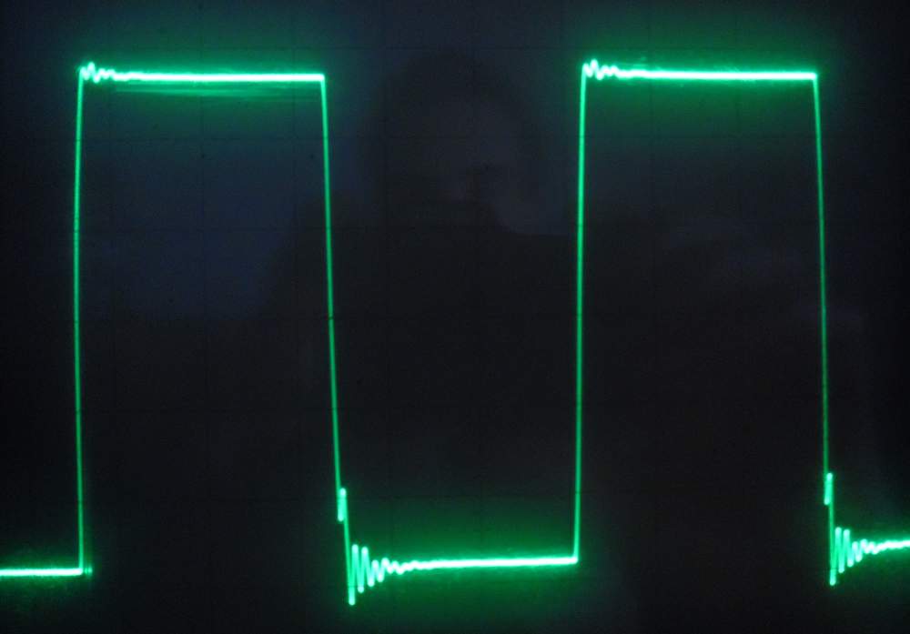

Results:
- #1 bode: looks fine in theory... 🙄
- #2 reality: 200kHz square wave (0.5V/DIV)
On higher output level an overshoot is appearing and increasing with level.
I dont know whether is related to the current limiting resistors?! (22R on both rails)
I dont know where to continue now. Is this due to an OPS issue or just compensation?! 🙁

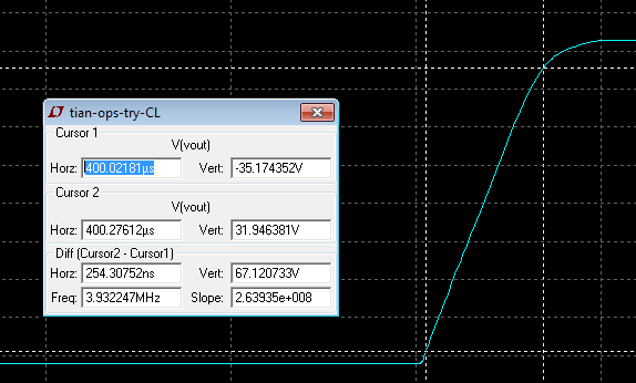

I attach the latest schematic. Both the open loop one with the Tian
bode and the same schematic in closed loop transient analysis.
Slow..? With this setup LT shows me a large signal 264V/us..!
Multiple compensation loops? What does it mean?
It's not enough to check the loop gain with this Tian method?

I disconnected the OPS and checked the IPS standalone and it looks like as attached.
(200kHz @ 5V/DIV -> I cant drive it further due to the low imp. FB resistors)
It also has some ripple but much better then with OPS but I guess its natural...

I also checked them in reality but they seem to be OK.

Hi Cortez,
You are looking at one loop with the Tian analysis. How do you know that that the MIC loop made by the 10p caps is stable? How do you know that the loop made by the 822p cap is stable?
We need to work out how to analyze those loops! Otherwise you are working blind.
You only know that the main feedback loop is stable. The more loops you have the more problematic the compensation can be. The more complex it is to get it stable. You just don't know how that input cap affects the other loops.
The closed loop response can sometimes indicate a problem but you can have a situation where an unstable loop is stabilized by another loop.
You are making assumptions ny not having proof as nattawa has pointed out.

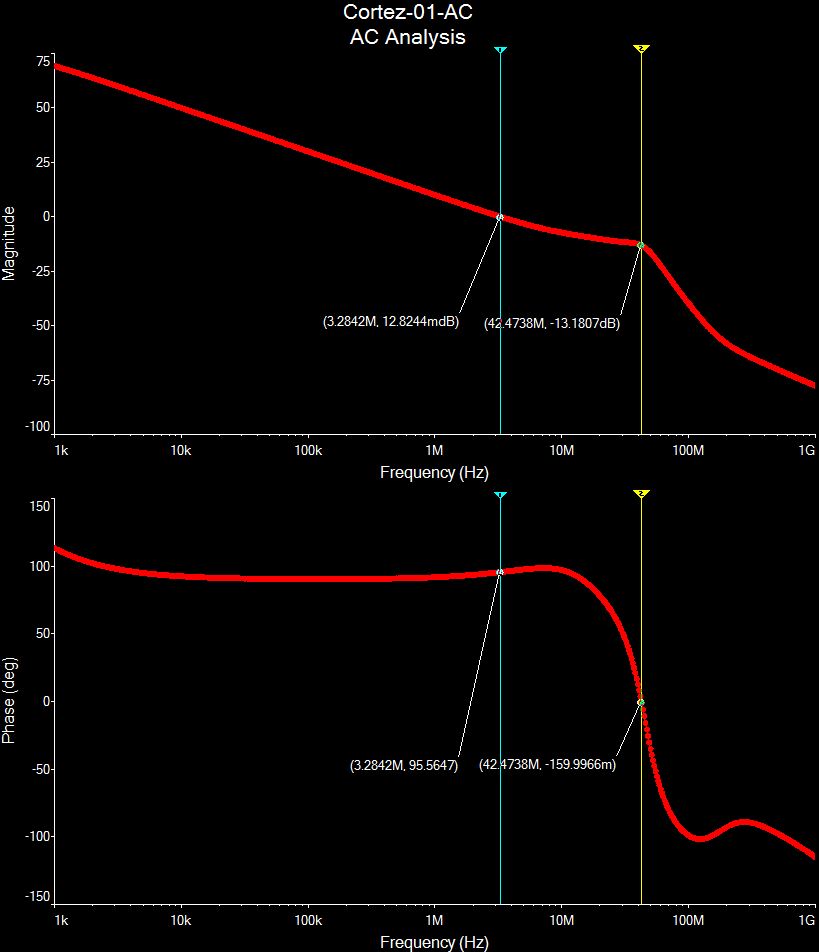

Again - just see what AC analysis shows:
1-st picture - input filter cap is in place (220pF);
2-nd picture - no input filter cap.
This is an oscillator (16.98MHz) by design. Input filter makes the situation a little bit better, softening the magnitude peak and correcting the phase response. But this is a very bad situation - the amp must be unconditionally stable even without the input filter capacitor.
So, the key design mistakes are:
1) Overall OLG is around 160db = way too much; virtually impossible to stabilize.
2) Each stage is prone to local oscillation:
- LTP - no degeneration;
- VAS - no degeneration, huge gain;
- Drivers - too high quiescent current for transistors you use (they like oscillating at high quiescent current).
3) Low impedance NFB network - just adds more issues in this case.
As a result - each stage local issues + huge overall gain + not good compensation approach = screaming oscillator 😉
