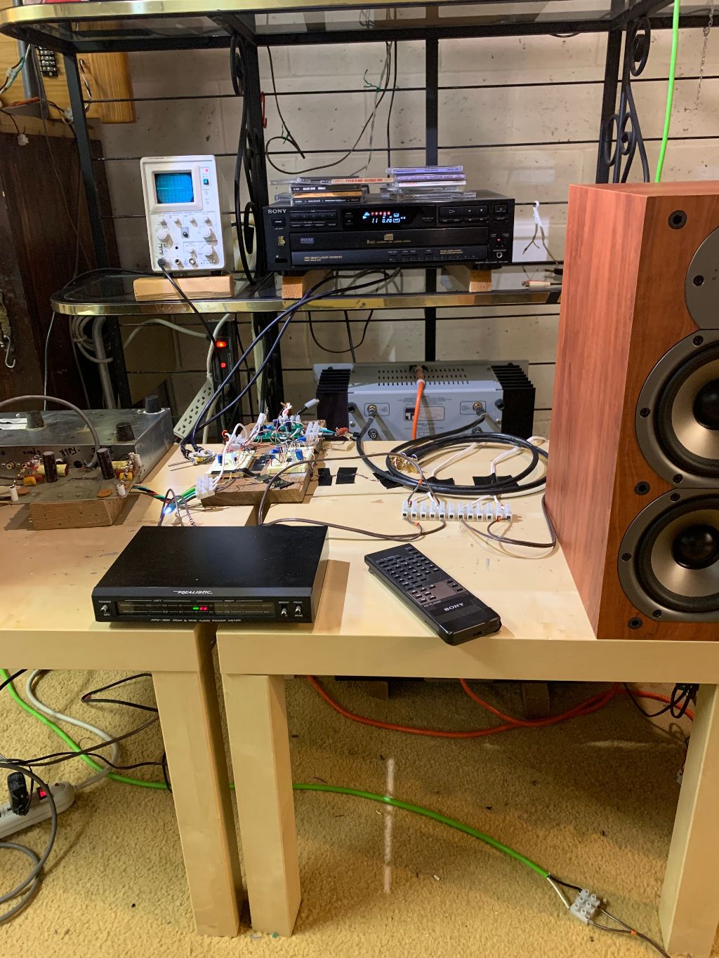

The three attached pictures show different views of the hardware which I'll be using to experiment with H2.
The middle picture shows:
1. Sony CD player as the music source. Its line level [R and L ]outputs are channeled via the the RCA Monster Cables under it.
2. Threshold S/150 power amp; 1982 or 1983 vintage. The orange cable [3 conductor] emanating from S/150 terminates in a bank of two 30,000uF capacitors; one per rail. This external bank augments the capacitance of the original and internal PSU capacitors. Makes a difference.
3. A scope to measure the Left output of H2. I need to correlate the value of this output with the graph on page 7 of the H2 article by Mr. Pass which is entitled Distortion% Vs Output Voltage. I must know the magnitude of %H2.
4. Up front is a Realistic device which reads the power output of the L channel across the Left speaker [Polk; 4 Ohms].

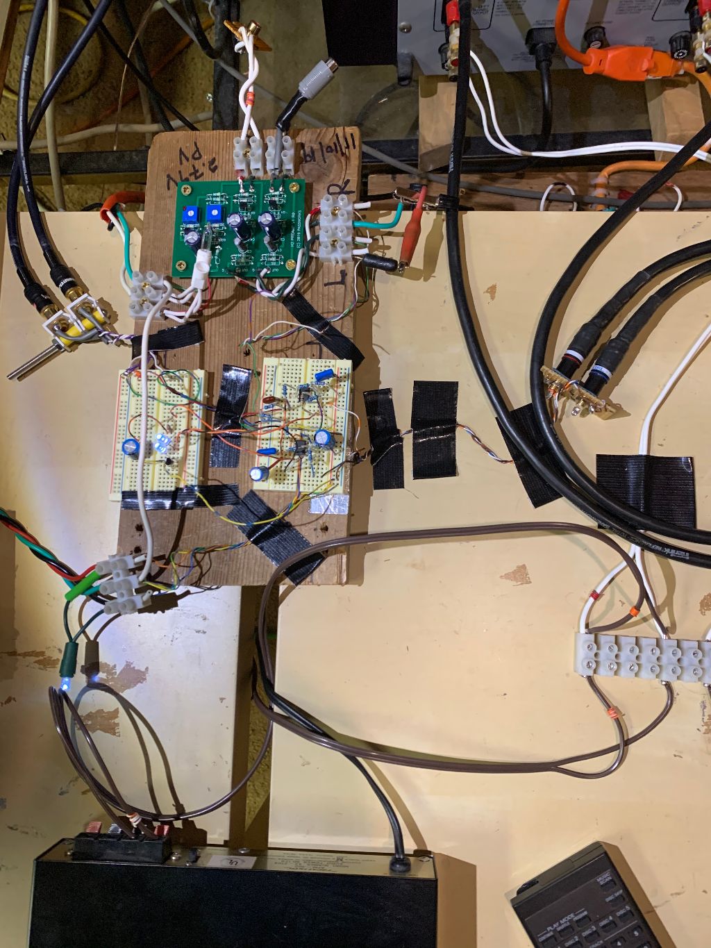

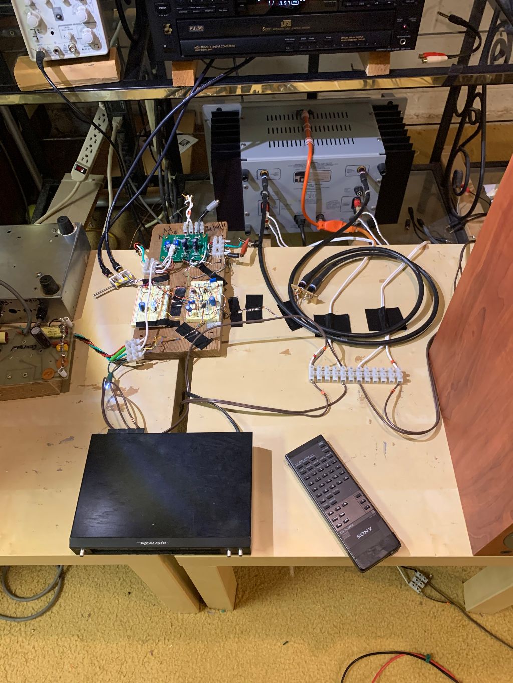

The right picture shows:
1. A top view of the H2 kit and other control electronics. The right-side proto board is a stereo buffer [to H2], and a volume level adjustment to S/150. Schematic to post.
2. The output of this stereo buffer/Volume adjument circuit feeds S/150 via 2 RCA Monster Cable cables on the right side of the view.
3. The left-side protoboard has
a. A voltage source of 2 LEDs and a Zener- connected BJT to reduce the output offset voltage of S/150 [ L ch = +45 mV, R ch = + 35 mV] to +/- 1 mV. Schematic to post.
b. An independent stereo input from SONY to the right-side proto-board [buffers/volume adjustment].
This setup will allow for an exhaustive study:
1. Direct connection from Sony to S/150. Will give me the impression of Music Fundamental [MF] plus impact [if any] of [+ DC] output offsets on S/150. Reverse the loudspeaker leads.
2. Indirect [independent] connection of SONY to S/150 via the buffer circuits. Will give me the impresion of [MF] without a DC offset at outputs of S/150. The right-side picture shows this inter-connection
3. The music impressions of the two phases of H2 with and without DC offset at the outputs of S/150.
Best
Anton

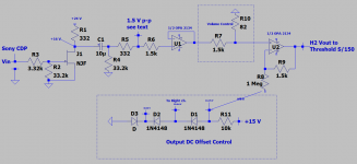

The attached is the schematic [L channel] for the audio system which I described in my previous post.
Most of this schematic is in post #390. The add-on is a circuit to reduce the power amp's output DC offset [L=+45 mV, R= +36 mV] to ~+/-1 mV. It is comprised of a string of the shown diodes plus the resistor [1 Meg] which is connected to the inverting input of the last OpAmp feeding Threshold S/150.
Essentially, the resultant H2 signal at the output of this last OpAmp is riding atop a~ [-15 to -18 mV] offset. The input of S/150 does not have a coupling cap to the preceeding stage. And thus readily allows this specific tweak. A wire shown on schematic from the proto board of the circuit can be readily connected to or disconnected [on the fly] from its destination [1 Meg] on the adjacent proto-board of the buffer/volume control OpAmp circuits.
Process conditions
1. The music output of the H2 generator was adjusted on the scope to a maximum of 1.5 Vp-p. This gave a a sweep of H2 up to ~ 1% H2 as read on the graph of page 7 in the article by Mr. Pass. Outliar peaks did emerge at ~2 Vp-p. This adjustment was done with the SONY remote commander/volume control. This adjustment was not altered when comparing H2 negative phase [H2np] with H2 positive phase [H2pp] while playing the same music/disk. It was tweaked up and/or down [counted the steps] to accomodate different disks which have variable output levels.
2. The power output of S/150 was adusted to read ~0.5 W peak on the Realistic power meter. The specific location on the schematic for this power output level adjustment is at the input of the last OpAmp; which I call Volume Control. Essentially by changing the value of the resistor which is connected to ground [82 Ohms].

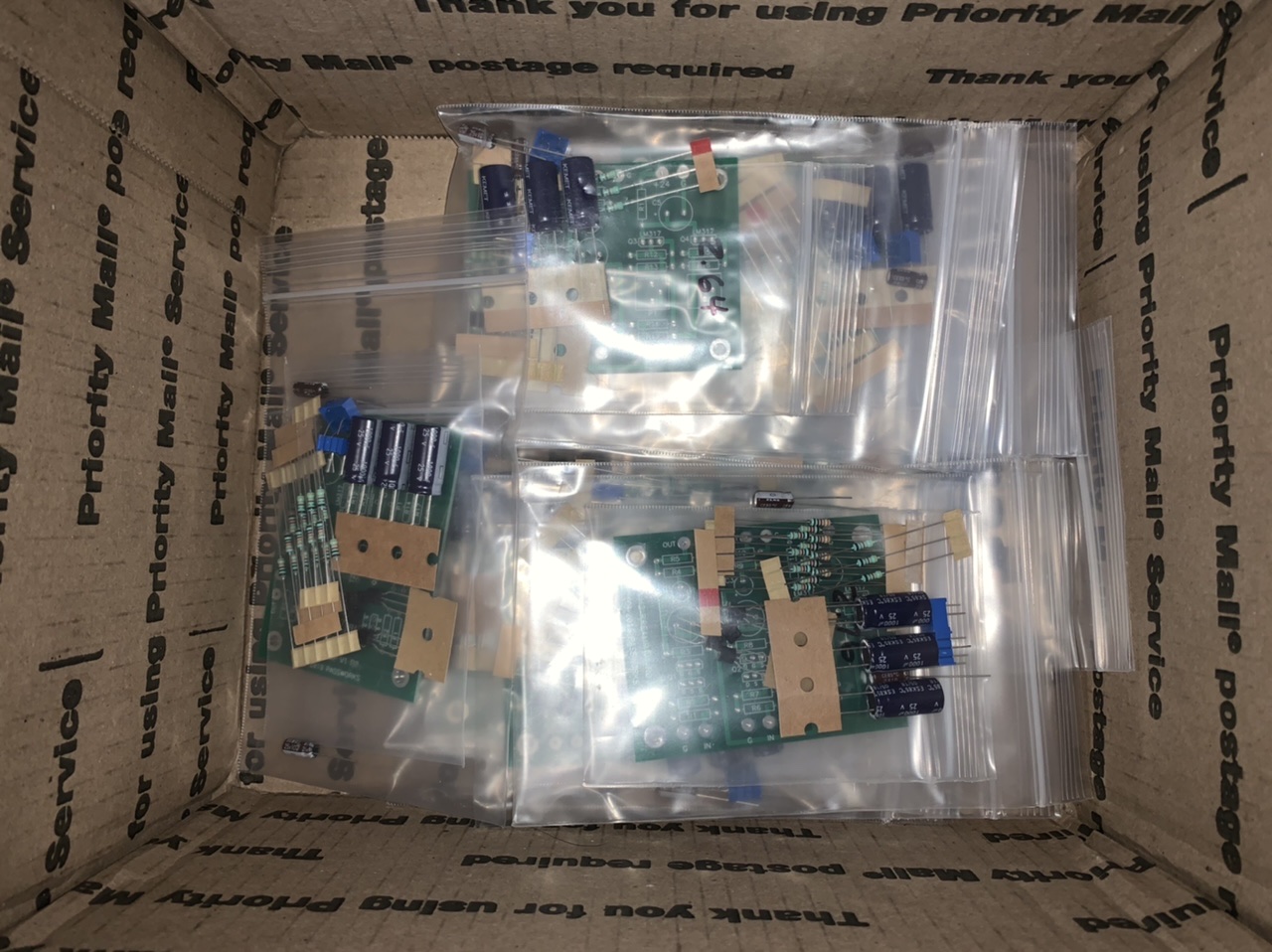

Hi Nelson,
I received the kit today in the European round of giveaways organised by Max, thank you for your generosity.
I've never heard a tube amp, I've had no interest in them and come from the 'reproduction faithful to the source' camp for the most part, although I have used tone controls and DSP, so I'm no absolutist. Having this available at the very attractive price means I can play around and see what the fuss is about with these 2nd harmonics.
I'm looking forward to it!
Cheers

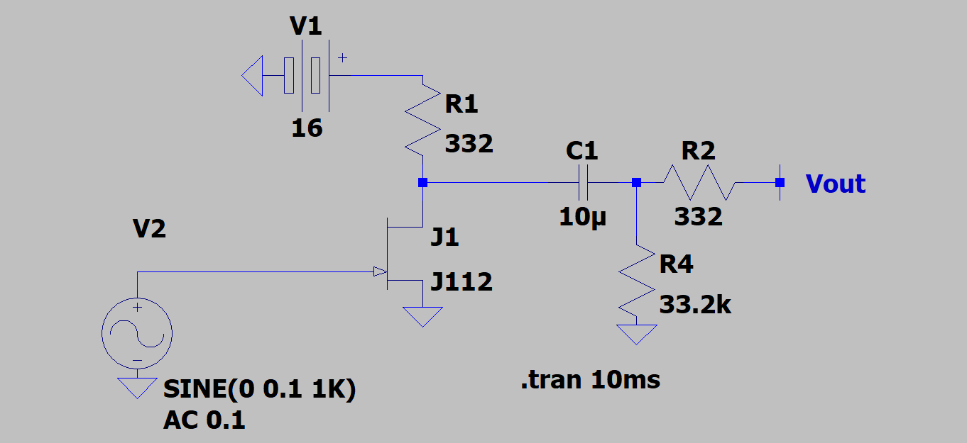

The attached LTSpice schematic simulates the performance of J112 NJFET operating as an H2 negative phase [H2np] generator per its description by Mr. Pass.
The graph of [Vout] versus Time clearly shows this signal is [H2np]. The absolute value of the positive voltage peak referenced to common is slightly less than [~732 mVp] that of the negative valley [~-747 mVp].
Voltage gain is ~7.5 and H2 is ~40 dB below the Fundamental.
40 dB = 20 Log R. Thus R = 100 which is the voltage ratio of the Fundamental to its H2. Thus [1 V/101 V] times 100 = 0.99% H2; to connect with the distortion graph on page 7 of the article by Mr. Pass.
Best
Anton

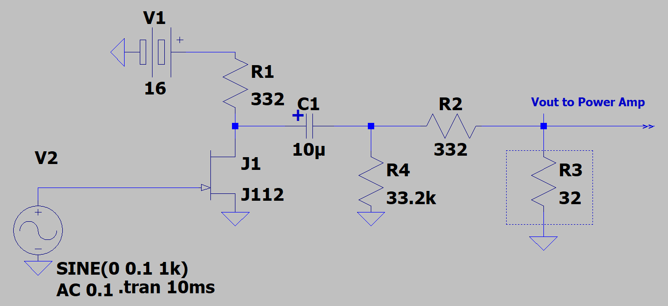

Mr. Pass wrote on page two in his article: H2 Harmonic Generator-DIY Version 1; "I don't think it can get any simpler or cheaper". True, and so are the following simplest applications which are shown in the attached schematic.
1. The actual music condition was a maximum [1 Vp-p; via scope] at the drain of the L channel JFET.
2. Added an external 32 Ohm resistor in series with the 332 Ohm resistor which is internal to the kit; so as to make a voltage divider. Vout to the Threshold S/150 power amp is taken across the 32 Ohm resistor.
3. I used my 32 Ohm Grado headphones instead of the two 32 Ohm resistors. A headphone is a Full Range [FR] driver. It has an impedance curve as a function of frequency which is like that of a woofer; maybe more level at the higher frequencies. This H2 JFET circuit is a current source amp [CSA], and is suitable to drive my headphones directly. Mr. Pass has articles on his FirstWatt website which discusss driving [FRs] with [CSA].
4. Spice simulation showed the gain of this simple circuit to be ~ one half the unloaded one. H2 is still 40 dB below the fundamental.
Best
Anton
