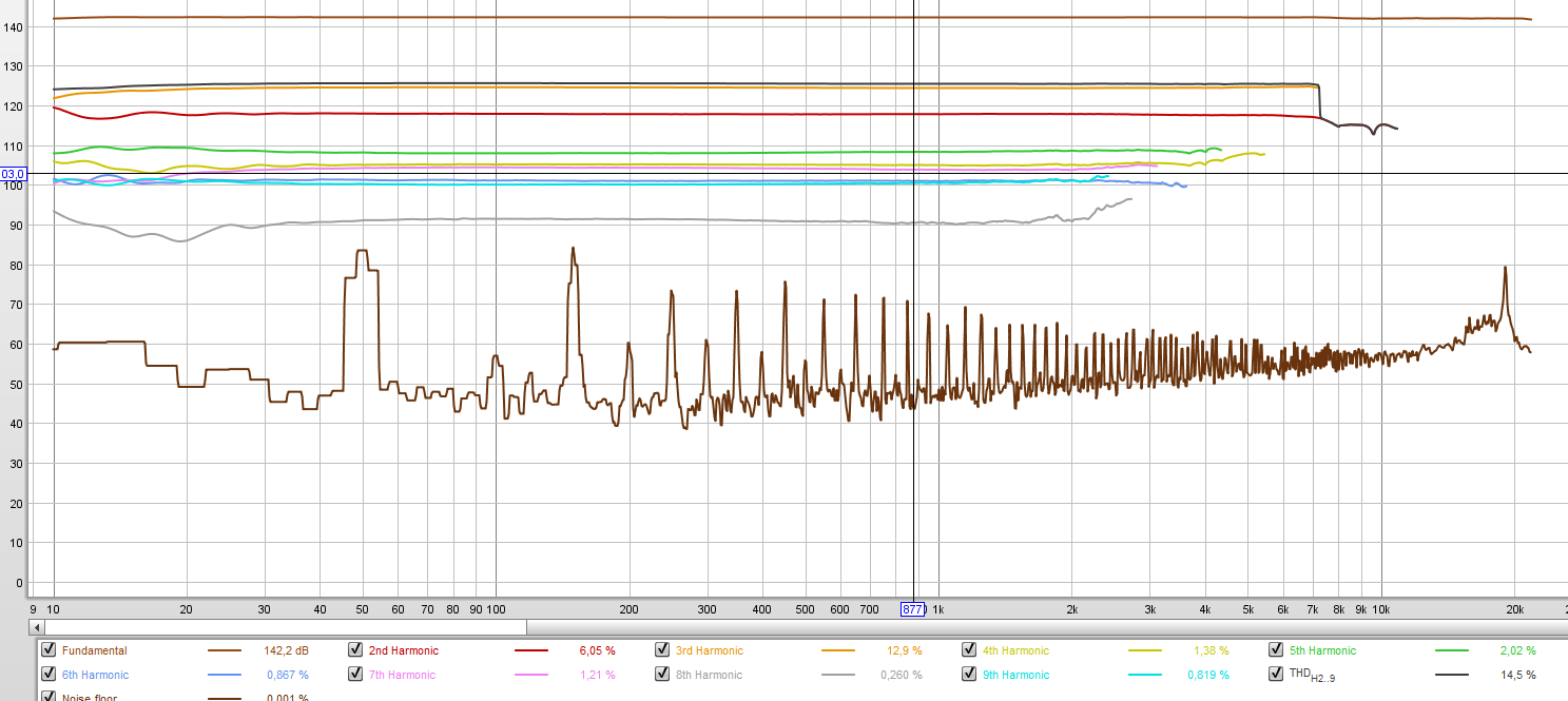

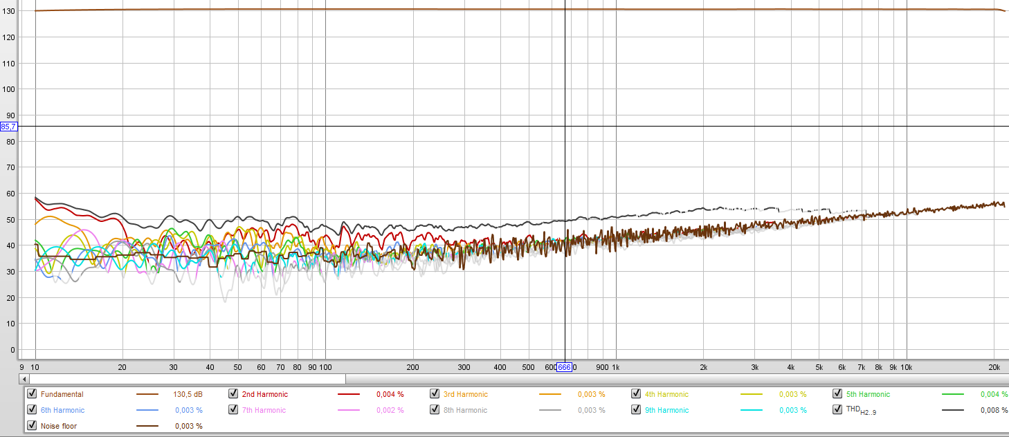

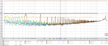

H2 mounted, with TO-220 lm317, and meanwell mini psu , here REW H2 measurement vs loopback, is that what one would expect ?
First picture is at 40 % volume, third picture is with max volume on computer onboard audio card. Too much volume, and we can change it name for H3 ^^ Noisefloor is high, but it's probably due to the long bad spaghetti jacks used crossing 220V power line.
Picture 2 is loopback of course.
I hear directly on computer to m-audio small monitors.
I have been fooled at first by what my brain wanted to think at first, but doing A/B comparison with loopback recorded songs VS recorded throught H2, it seems i don't hear that much difference. If i make volume higher, H3 become higher, and i got some nasty noise that at hear seems a bit like clipping.
I had 2,8 wrotten of my Jfets enveloppe, so i've set T2 voltage to 15,5V. I'll play again and tweak later. It's 0:43, child and wife are sleeping, and i was soldering instead of hanging laundry

Hi papasteack.
Please show a picture of H2; focus on its wiring and the other connections.
I understand that the music signal is fed to H2 from computer [level?]. The resultant output of H2 [level?] is sent to a sound card in computer. The output of the sound card [loopback?] is sent to the loudspeakers.
Is the output of H2 too high for the onboard sound card [overload]?
Best
Anton

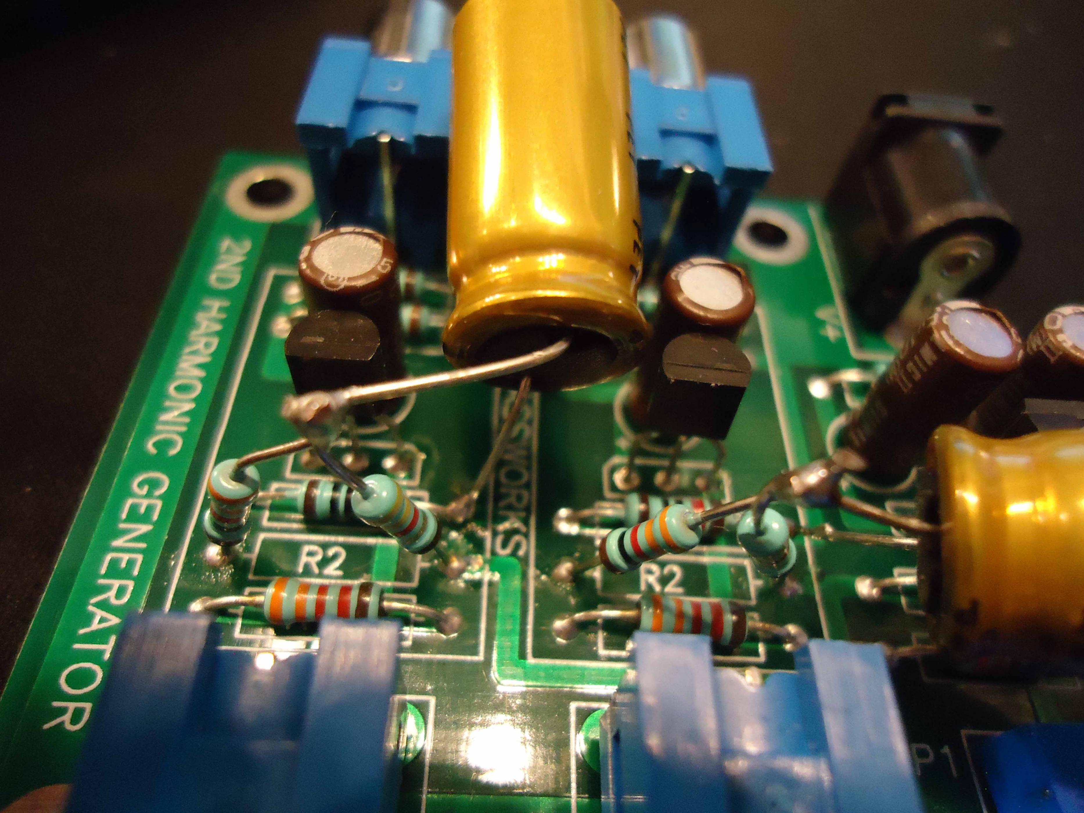

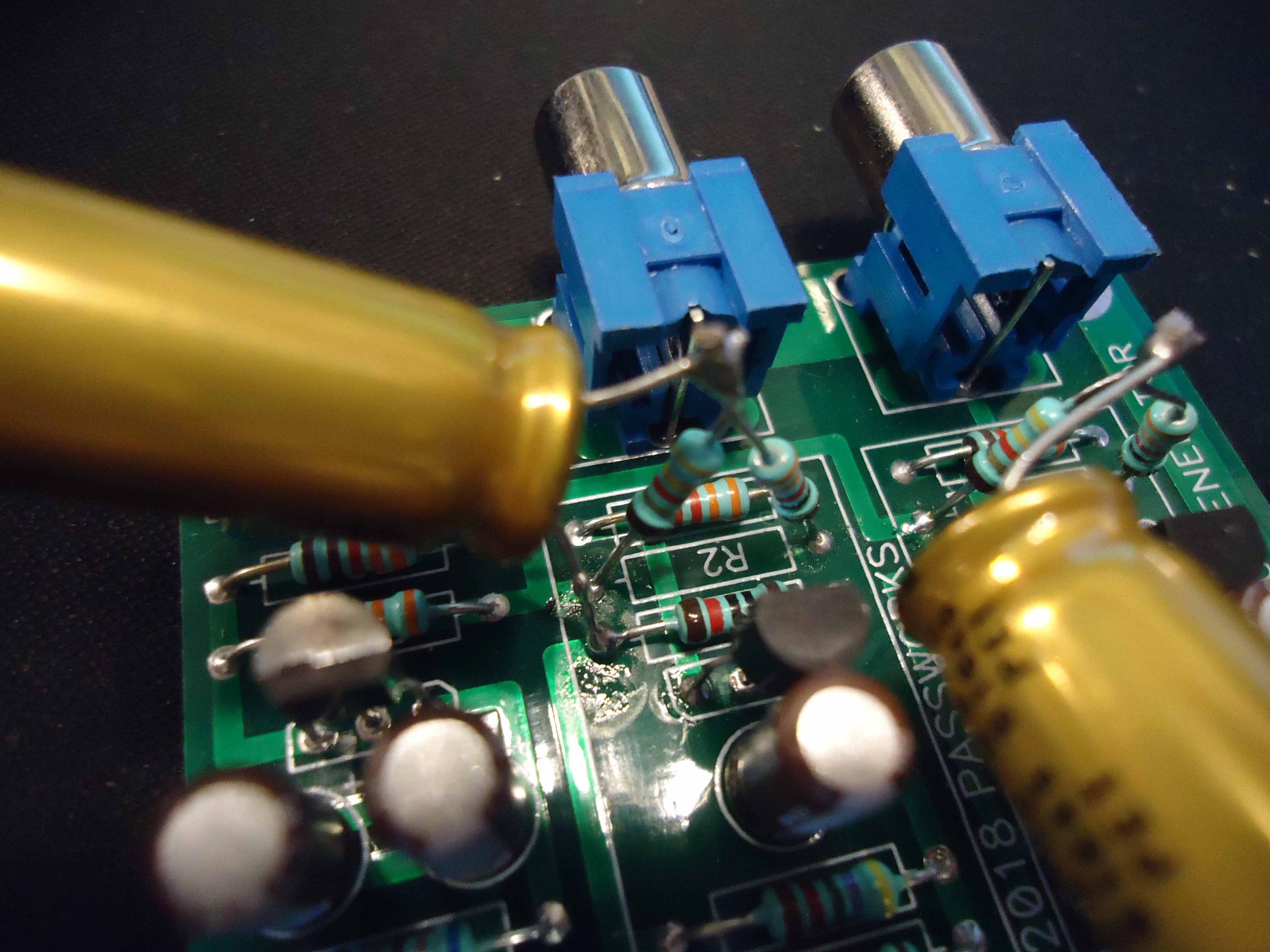

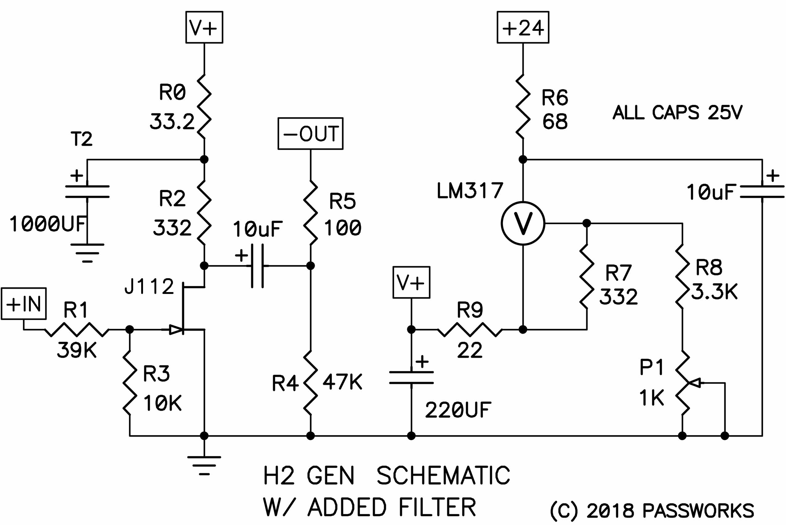

I've had more than one request for the information to modify the
original (more noisy) H2 (2018) so as to have the lower noise of the
later one (2019).
In the schematic you will see that I have split R2 into two resistors,
with the 332 ohm original value joined in series by a 33.2 ohm resistor
which goes to the supply. The other end of the 332 ohm goes to the
Drain of the Fet on each channel. The point at which these two resistors
join becomes the new T2, and this is filtered to ground with a 1000uF cap.
I have also attached two photos showing an actual board that I have
modified.
After this modification, the voltage at T2 should be set to the same
voltage as originally, so you want to make note of that voltage before
you start and check it again with a voltmeter.
later one (2019).
modified.
