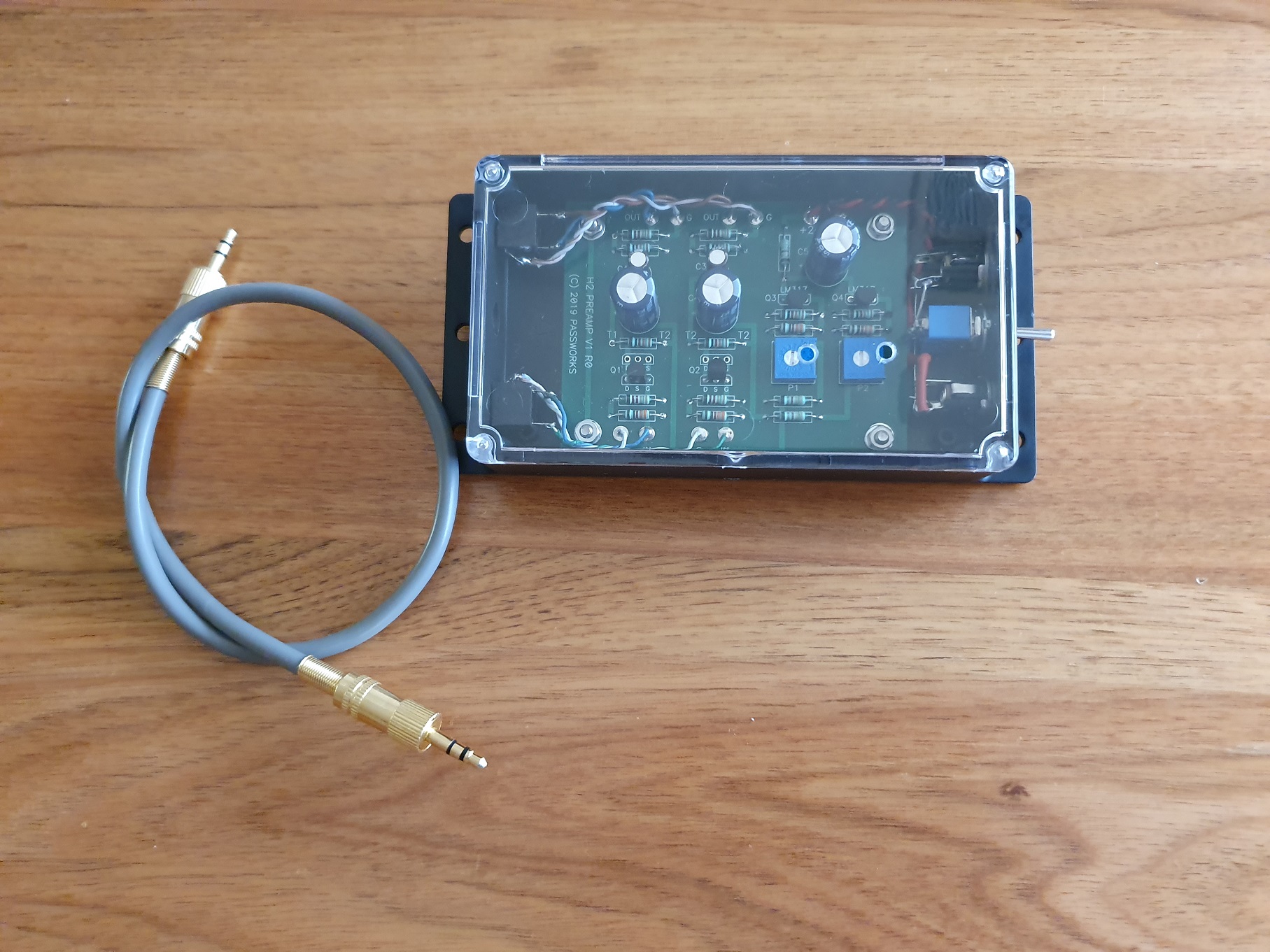

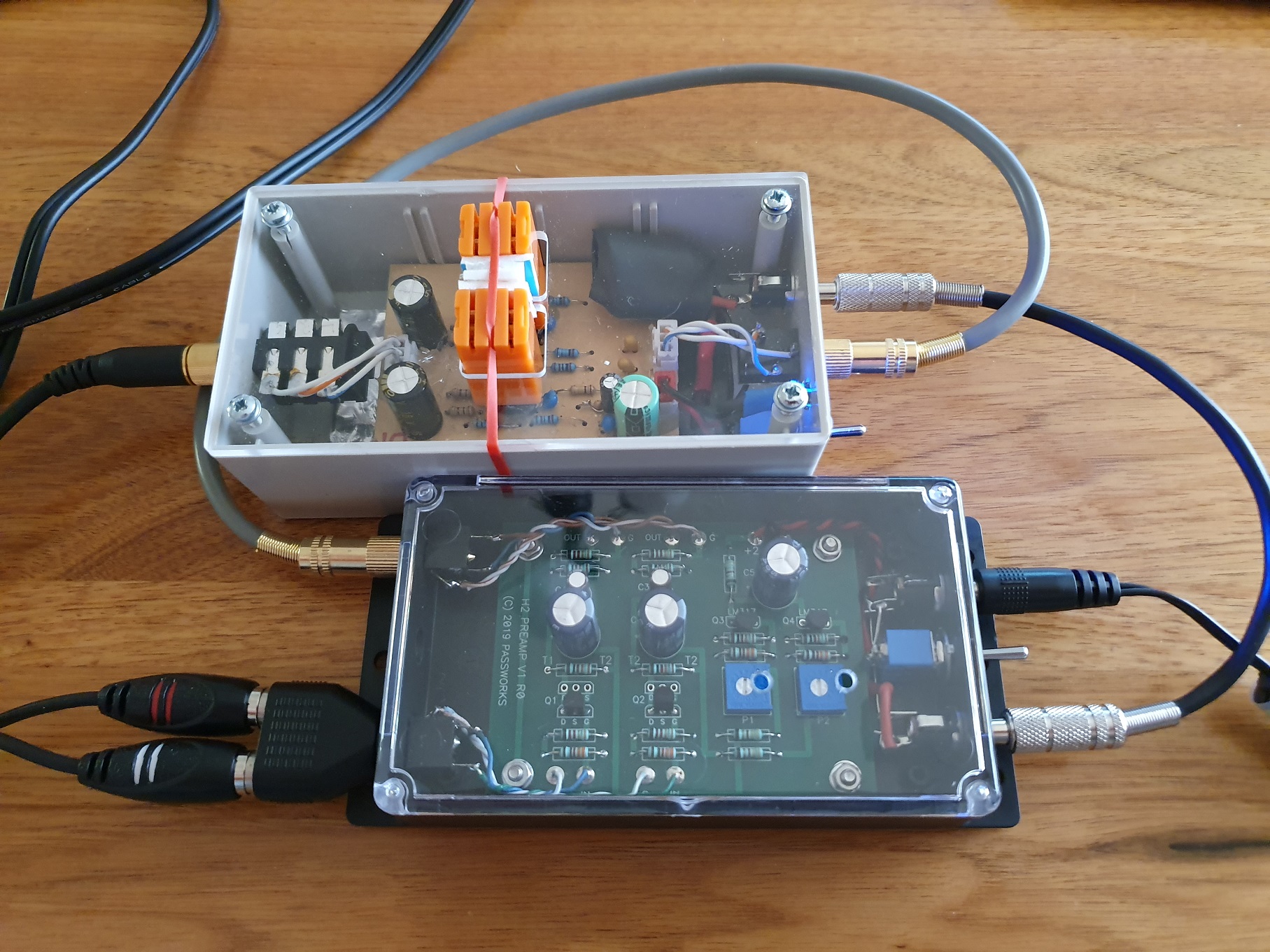

Finally got an hour spare to put the H2 together 🙂
3.5mm In and Out with a 24v pass through to power other 24v devices, and a screened, shielded 3.5mm cable.
Very pleased with the sound so far. I'll give it a good listen over the next few weeks and see how it goes.

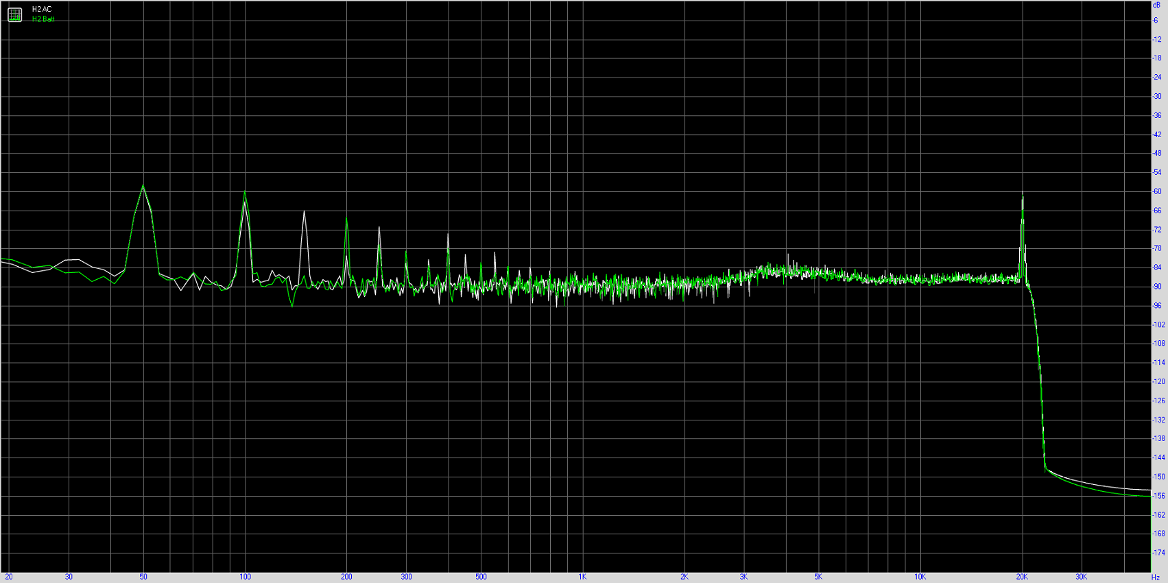

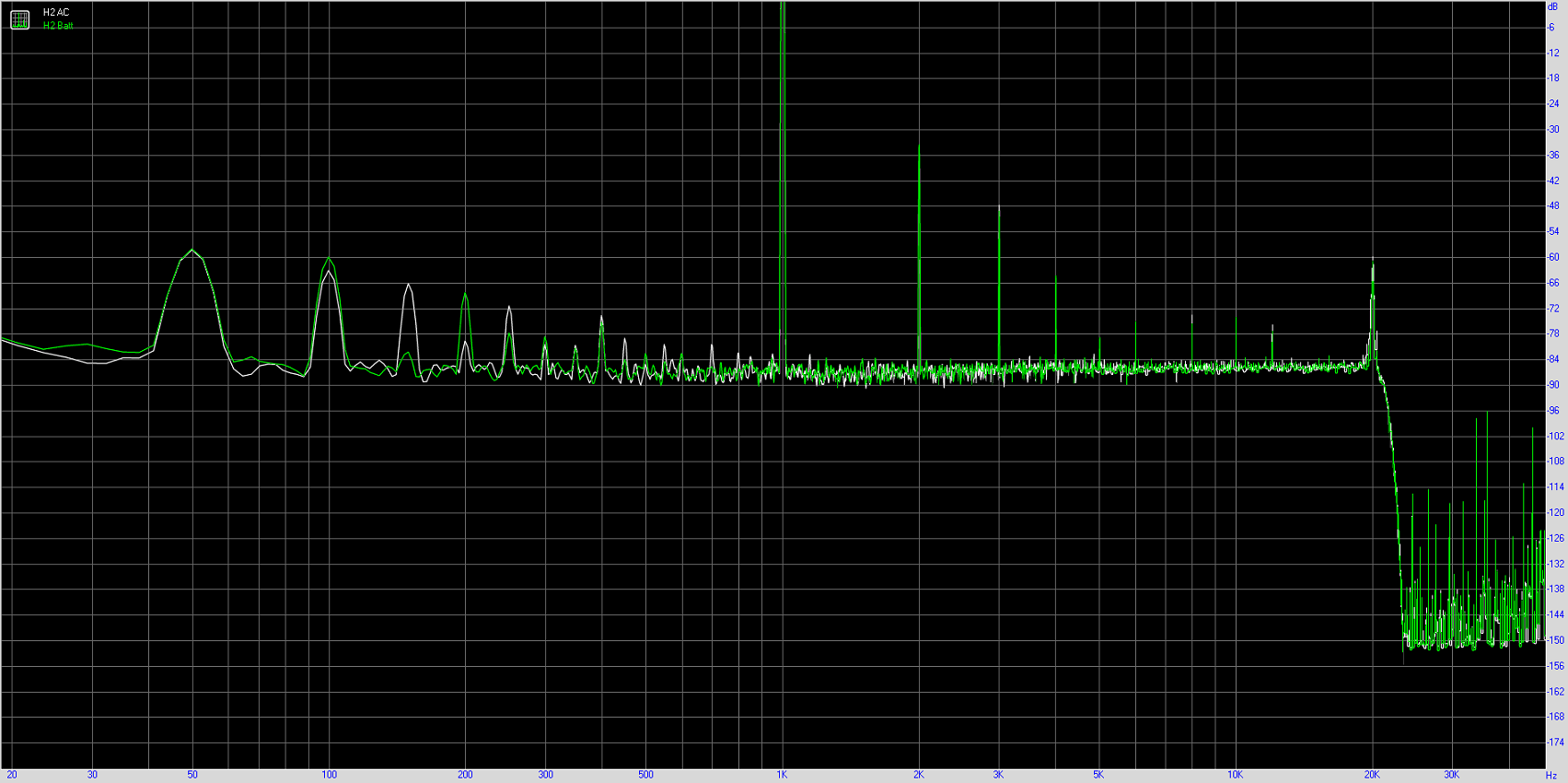

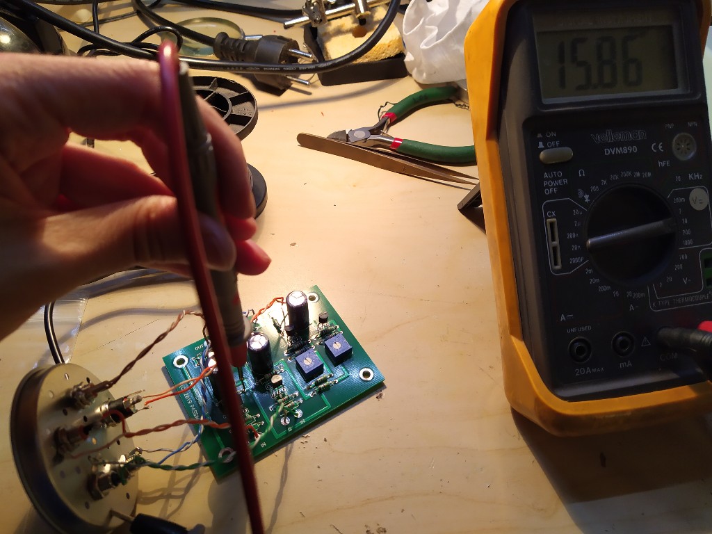

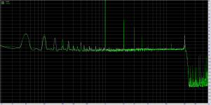

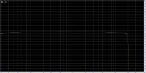

I took some measurements with the voltages set at 16.00 at T2, giving 1% on the graph:
[H2 THD]
Definitely a dominant H2 🙂
[H2 Noise]
Noise floor is a little high

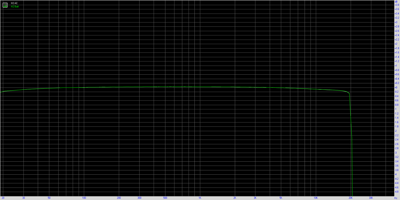

[H2 Frequency Response]
I wish I could travel with the Korg B1 that I am using as a headphone amp, so I'm going to try using this to produce the H2 and then feed into the inverting opamp buffer that I made using the samples from Burson (thread here https://www.diyaudio.com/forums/parts/346728-burson-supreme-sound-projects.html):
[H2 THD]
[H2 Noise]

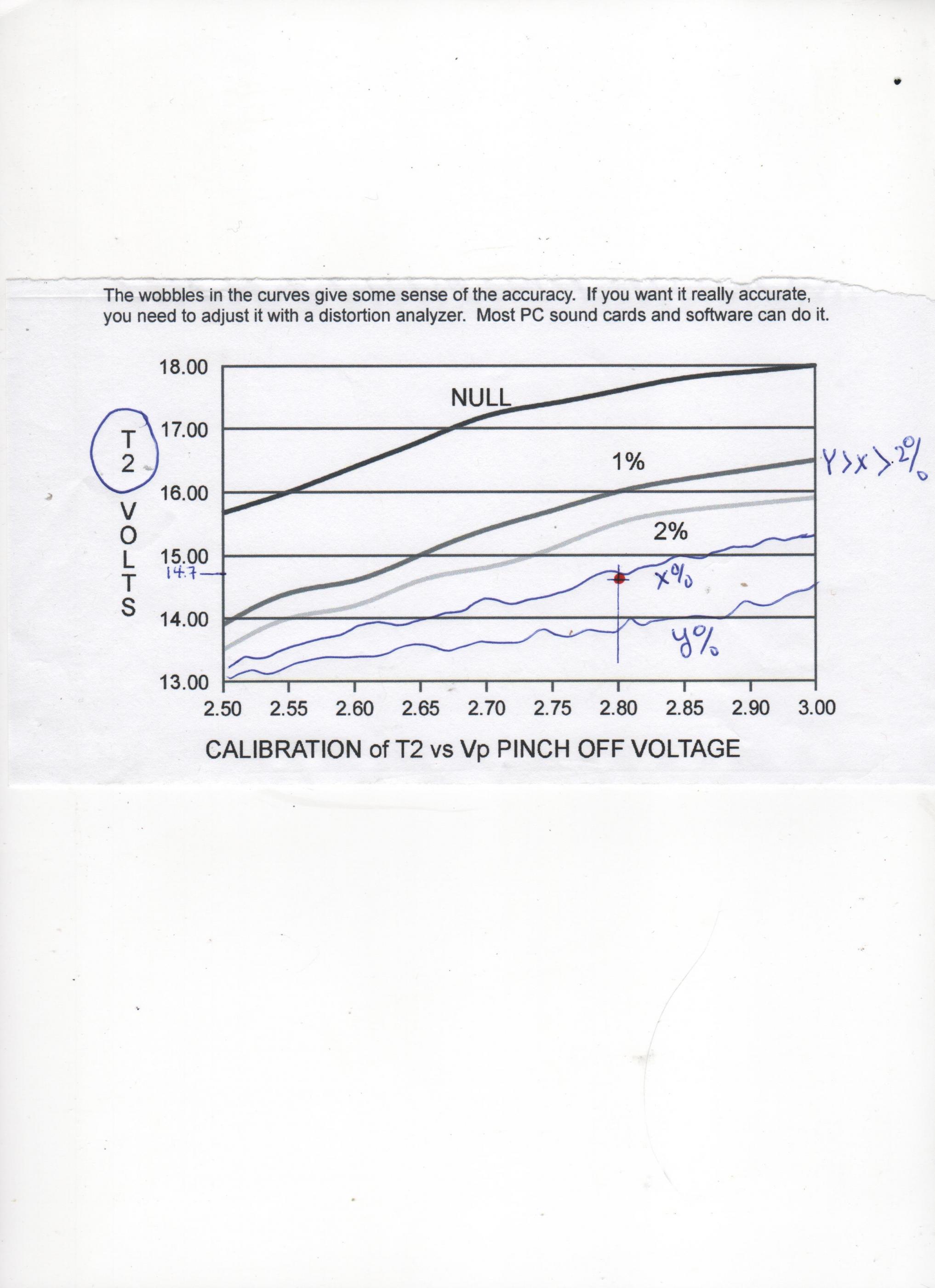

Another look at 19V5 SMPS main PSU for H2 Ptreamp V1.
The revised measurement which is relevant to the following discussion is T2 =14.7 V for either channel. It resulted from the use of a 19V5 SMPS main PSU instead of the recommended 24 V. The attached graph is/shows:
1. A copy of the original and last graph in the second article on H2.
2. The trends of the data-driven plots by Mr. Pass for Null, 1%H2 and 2%H2 suggested that I can add a couple "theoretical" graphs below the aforementioned ones. They are X% and Y%; noting that the suggested magnitude of Y% is greater than X% which is greater than 2%.
3. I next used the coordinates of T2 = 14.7 V and Vpinch = 2.8V to generate the red dot. It is >X%. Operation of the H2 generator is contraindicated at this distortion level which is >>2% [excessive!].
4. But wait! I know from the first gragh on page 7 of either article that % Distortion is Directly Proportional to Vout at the drain of the FET. So I arbitrarily lowered the FETs' Vout from 1 Vp-p to 150 mVp-p.
5. The resultant sound impression at this FETs' Vout = 150 mVp-p is the same as that described by Mr. Pass in his articles for H2 negative phase; meaning recessed, and localized where it fit.
6. This lowered FETs' Vout may allow for a better "Volume Control" than for say a must 1 Vp-p inside the downrange equipment of preamp and power amp.
In conclusion, H2 Preamp V1 is flexible in using either a 24 V or 19V5 SMPS.

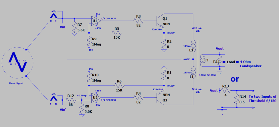

The Introduction in the two articles by Mr. Pass which are entitled "H2 Harmonic Generatior" shows this statement:
"Looking back at the glory days of tube sound, some speculate that the 2nd harmonic character of single-ended tube amplifier circuits is an important element of the sound quality they want."
The attached schematic reinforces the above speculation by demonstrating a facet or more of tube amplifiers' sound.
1. The schematic is for an assembled Class aP mono-power amplifier. I'll explain its works in a follow-up post with links to posts in the thread "Class aP amplifiers.
2. It is is essentially a Class AB push-pull amp with added operational flexibilty. It has components which resemble those in vacuum tube amps. Namely, an output power transformer [OPT], and an NPN which has Electrical Characteristics which resemble those for a pentode [meaning a voltage-variable current source].
3. An aP generator [not shown] is a precision rectifier. Its has two output pulses which are positive-going [in phase], of equal amplitude and which are diplaced in time as shown under the pulses [0 to t and t to t1] from the parent music signal at the left of the view.
4. The secondary output of [OPT] drives the two inputs of Threshold S/150 which drives two ADS L730 loudspeakers.
Its Sound Impressions:
Very pleasing and likeable. It is as articulated by Mr. Pass: "a deeper soundstage and improved localization than otherwise" . Achieved by simply decreasing the amplitude of the input pulse [t to t1] from +Vp to 0.99Vp relative to the other pulse [0 to t].
1. As shown in the schematic, its power amp/loudspeakers combo has the sound of H2 negative phase [H2np]/its attributes.
2. Shorting [on the fly] the value of the input resistor [68 Ohm] for the pulse [t to t1] generates the sound of the fundamental which is void of the above [H2np] attributes. Unmistakable.
3. The localization attribute of [H2np] is readily discernible for this mono power sound output. The instruments are found in a "layered" fashion behing the loudspeakers and in front of me.

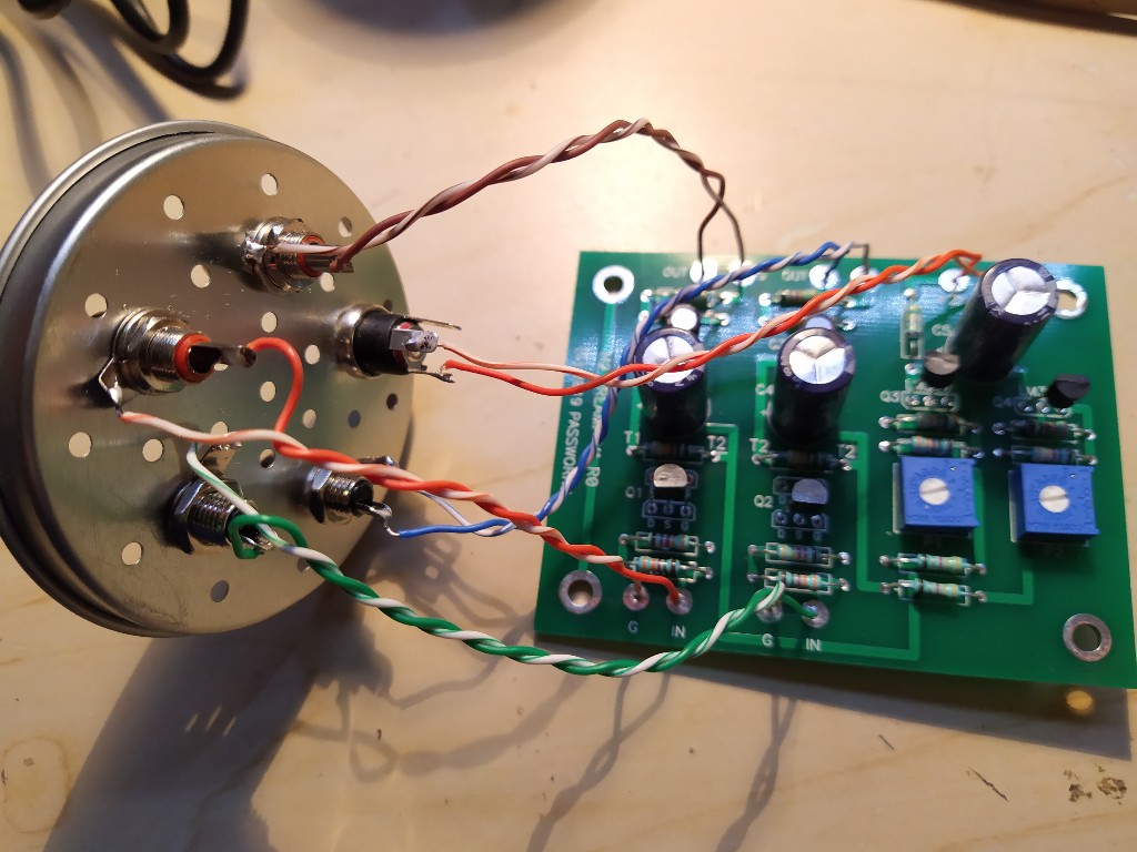

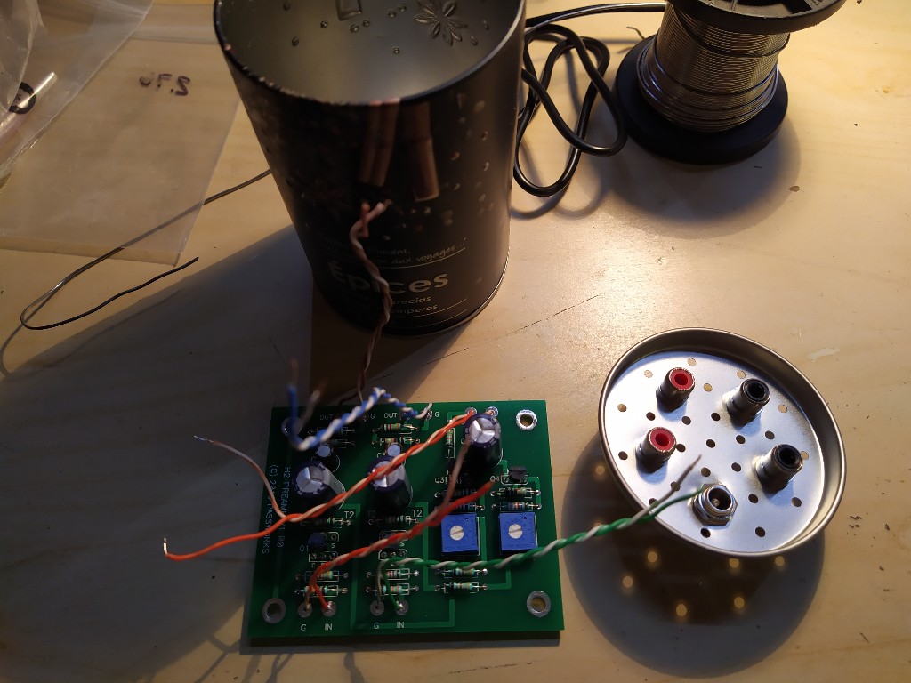

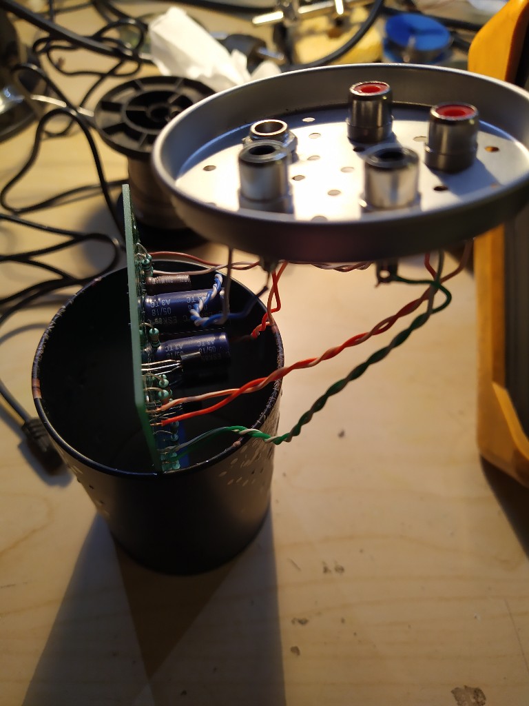

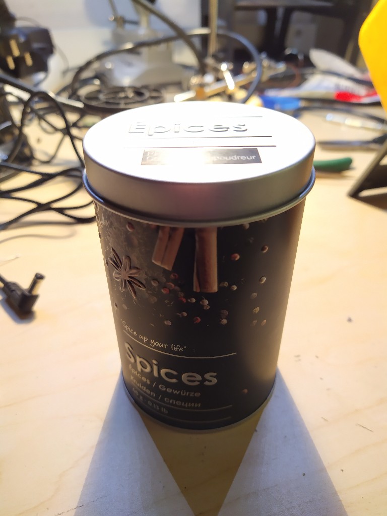

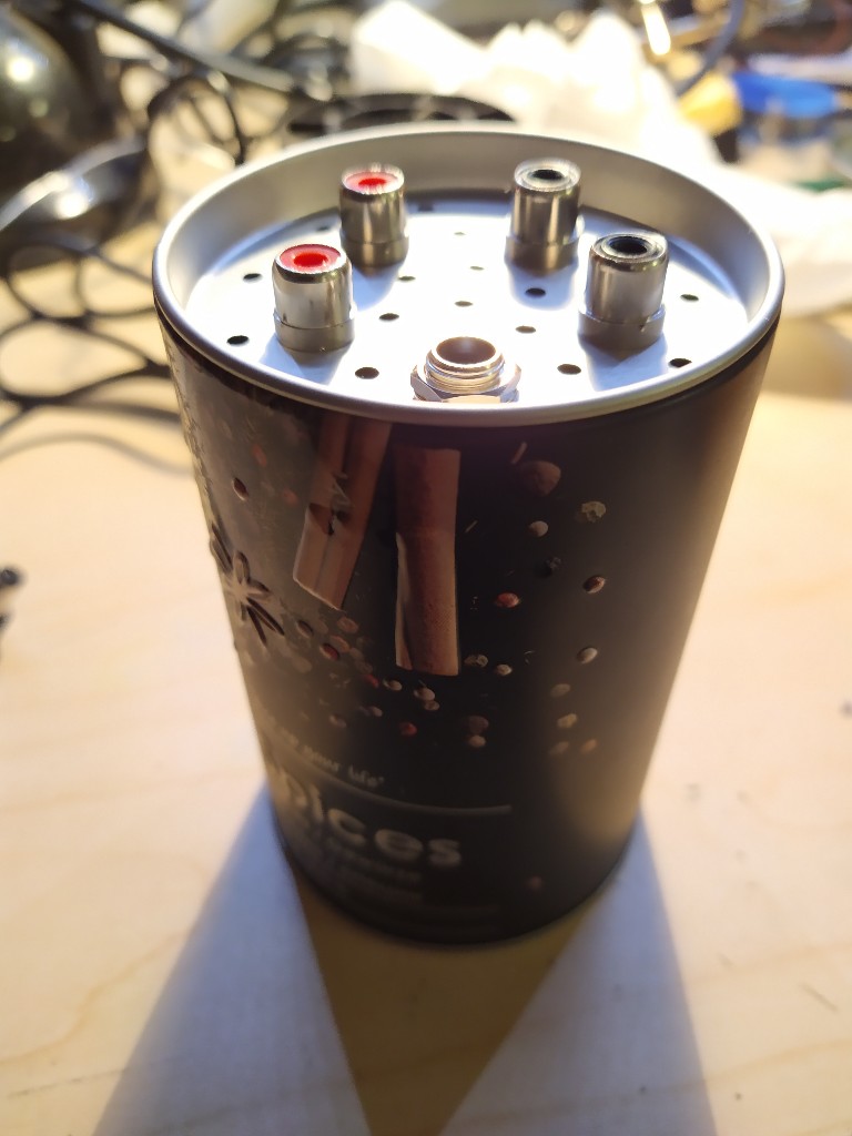

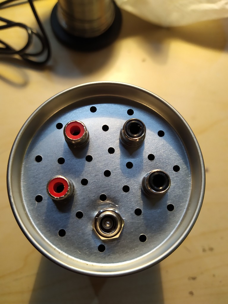

Hi there,
Just tonight I managed to make some spice for the sound 😀
I would like to thank Nelson for providing free kits, and also to Max (member "coolnose"), who took care of the shipment for Europe, amd who sent one H2 to me
I had no time for a proper listen yet, hopefully I will post my impressions in a few days...
