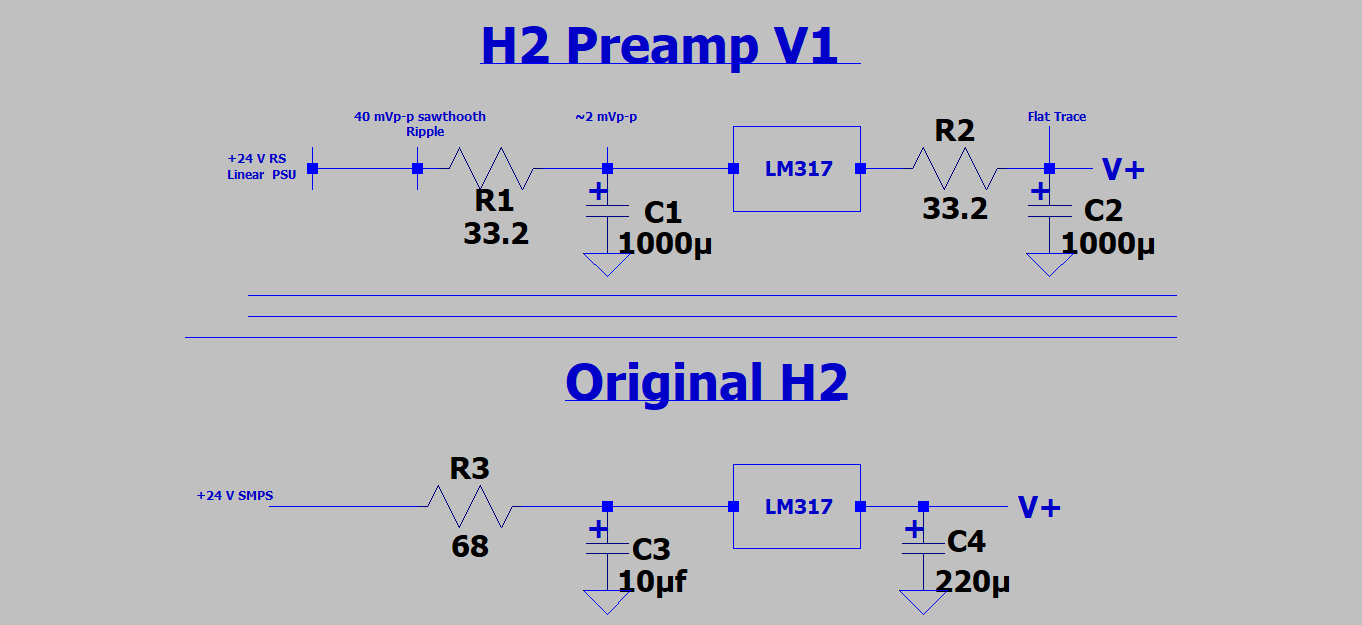

Hello Big Guy,
Please find attached the schematic of the on-board [LM317]-regulated PSUs for H2 Preamp V1 and below it that of the Original H2. Note:
1. The on-board regulated PSU for H2 Preamp V1 has a PRE-LM317 and a POST-LM317 low pass filters which are comprised of R1=R2 = [33.2 Ohms] and C1=C2= [1000uf]. Very effective!
2. My RS linear and unregulated PSU brings to my H2 Preamp V1 a 40 mVp-p sawtooth ripple as seen on the scope. This noise became a diagnostic tool.
3. The first R1C1 pre-filter drops the magnitude of the parent ripple to ~2 mVp-p.
4. The second R2C2 filter wipes clean all ripple at the +V output as seen by a flat scope trace.
5. The on-board regulated PSU of the Original H2 is shown below that of H2 Preamp V1. It is simpler and may appear less potent than the later. BUT the +24 V output of the suggested SMPS [TRIAD..] is already pre-regulated as shown in paragraphs [4 and also see 5] on page 6 of the parent H2 article.
IF the noise in your system is riding the +24 V output of the SMPS [or the new linear PSU] as determined by scope, then this suggested solution will knock its amplitude way down. Parallel a 1000uF with the existing 10uF; by example/copy of points 1-3 above done by Mr. Pass. This new pre filter is comprised of R=68 Ohms and C =1010 uF. It has an F3 of 2.3 Hz.
IF the amplitude of the above noise; say is 1 mVp-p, it'll be amplified by 20 times from XA60.8 times 2. A net 40 mVp-p emanating from both loudspeakers maybe audible.
Best
Anton

Phew! Did NOT understand much of what you wrote, Anton. Sorry.
I do not have scope or access to one so much of your commentary is not relevant for me. That being said, I am OK with "Betty Crocker" instructions...I CAN follow directions.
Given that my LRPS wall wart just arrived, it makes sense that I should use the circuit mods that you show for linear PS. I will compare the original with your schematic to see if I understand.
BTW, how can I print the schematic in your post?
BTW, how can I print the schematic in your post? [Save image as by Right click of mouse on/in it as a picture on your desktop. Print it after this].
