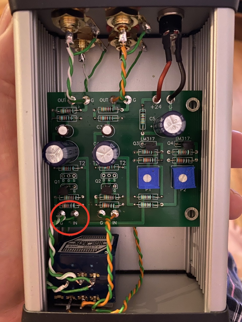

I can see you have the fets correct. So now all you need to do is connect the OV lead of your DMM to a power supply GND point and with the positive DMM lead and a schematic and the pcb layout drawing work your way through the circuit comparing the same point on each channel and write the voltage down on the schematic as measured for each channel.
At some point you must see a voltage difference highlighting the area on the dead or faulty channel as to where the fault lies.
Your soldering looks Ok, but it might be a simple bad solder joint - also did you measure all resistors with the DMM before soldering them to the board?
Good luck with it.
Gary..
Ahah! I’ve spotted a wiring boo boo.
I’ve been using green wire for ground. Except on the left input..

In addition to the wiring error discovered above I found the white wire connecting the centre pin of the pot to the board input is broken.
I’d suggest if anyone else is planning to use this Hammond case they should use more flexible hook up wire. To slide the lid in and out one end plate needs to move down. This has caused my cat6 solid core wire to fatigue and break where it’s been bent before.

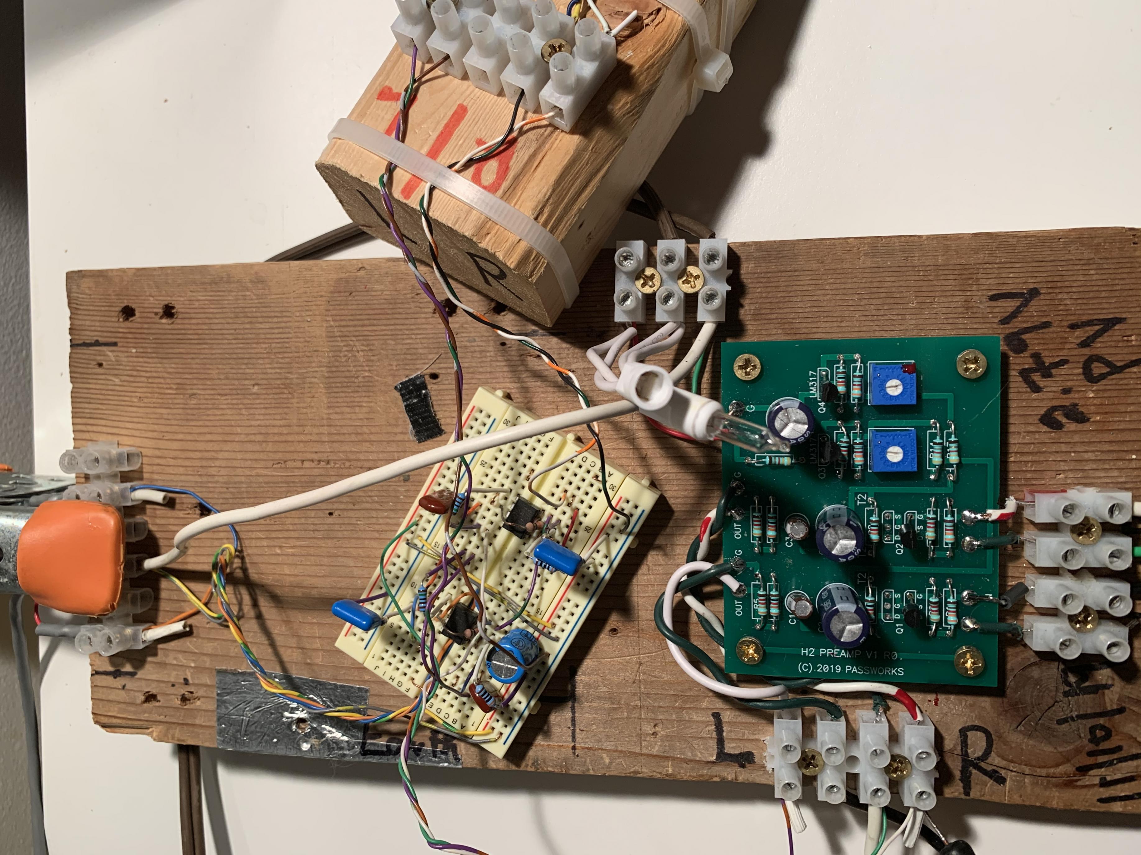

The results I reported in post#351 suggested a slight mismatch of %H2 between the L and R channels. The Left channel has a higher magnitude of % H2; numerically shown as 1.08 and 1.04 for L and R respectively.
The attached is a picture of the prototype for the schematic I posted earlier. The woodblock [at the top of the view] has the independent connections of the phones in the Grado Labs headphones. The leads of each phone are connected to deliver H2 negative phase [H2np]. I streamed YouTube music via the headphones output of the hp laptop.
A revealing experiment
1. The output of [H2PV1] was adjusted to a maximum of 0.5 V peak to peak [0.18 Vrms]. The graph on page 7 of Mr Pass' article [Distortion% VS output Voltage]; showed ~0.3% H2. I used the scope to enforce this output level of [H2PV1] by displaying it in real time.
2. Started listening to [H2np] via the headphones. As the music played, I reversed the leads of only the Left channel. Got a totally different sound.. Please follow this situation:
2a. The R ear/channel operated [H2np], and the L ear/channel opereated H2 positive phase [H2pp]. My brain suggested that I am now hearing the Music Fundamental [MF].
3. I repeated steps 2 and 2a; but now I reversed the leads of the R channel. The difference between the two sounds was less pronounced than in the earlier case. The slight mismatch in the % H2 between R and L channels is responsible. It suggested that the sound of R channel was closer in character to that of [MF].
I next listened to a YouTube music video which is entitled " Take a tour of Nelson Pass' listening room" The voice of Mr Pass [especially] and Mr. Guttenberg were the music to my ears.
I repeated the above experiments; meaning one ear received [H2np] andthe other ear got [H2pp]. Got the same differences in their sound impressions. Repeatable.

1. The above experiments were done by using headphones which have independent leads.; but may not be as meaningful with loudspeakers; because the bass is expected to be attenuated and/or lost. I'll still do this experiment and report back.
2. I believe that my brain reconstructed [MF] from the simultaneous use of [H2np] to one ear, and [H2pp] to the other. Revealing?

I’ve repaired my dodgy wiring and now have the H2 operating in stereo. My “sophisticated” listening tests with a bit of ACDC have been curtailed for the evening. I think I want to try a touch more distortion when I get the chance to reduce the input attenuation 😉
