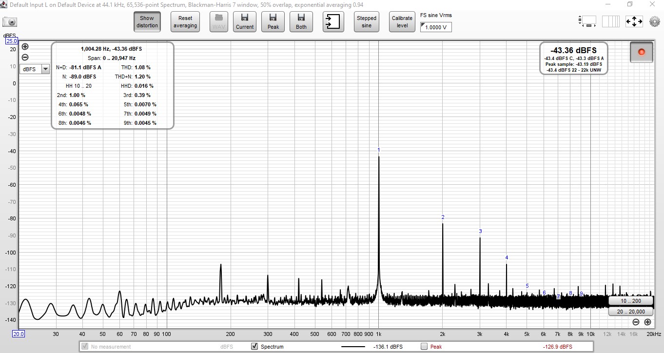

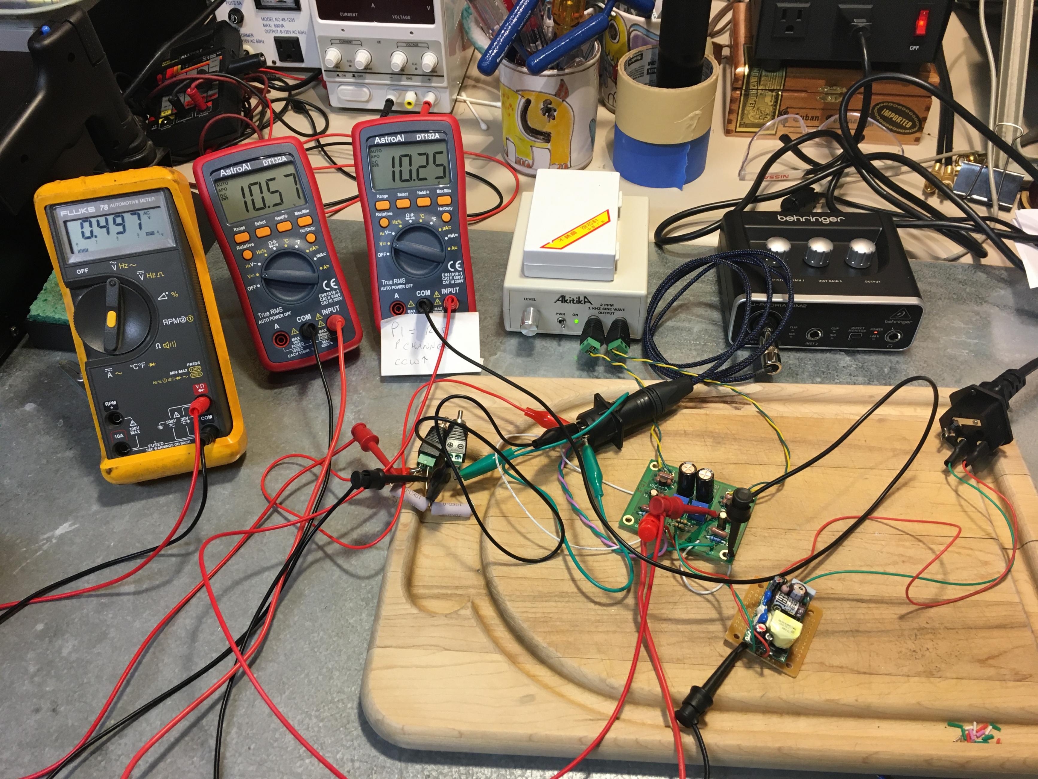

Here are pictures of the "Left" channel H2V2 PCB wired with an XLR connector with one side to Pin 2 and the other side to Pin 3 with Pin 1 to ground. Adjustment was easy, it did take some time to get the T2 values on each side of the board to achieve the lowest H3 value.
T2 values (0.5 VAC output into 10K ohm load):
L+ = 10.57 VDC
L- = 10.25 VDC
The single stereo board measured 0.30 & 0.31% H3 with 1% H2, with the balanced board the best I could get was 0.39% H3 at 1% H2.

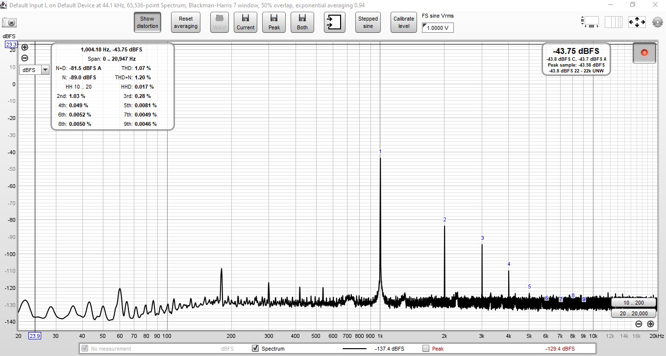

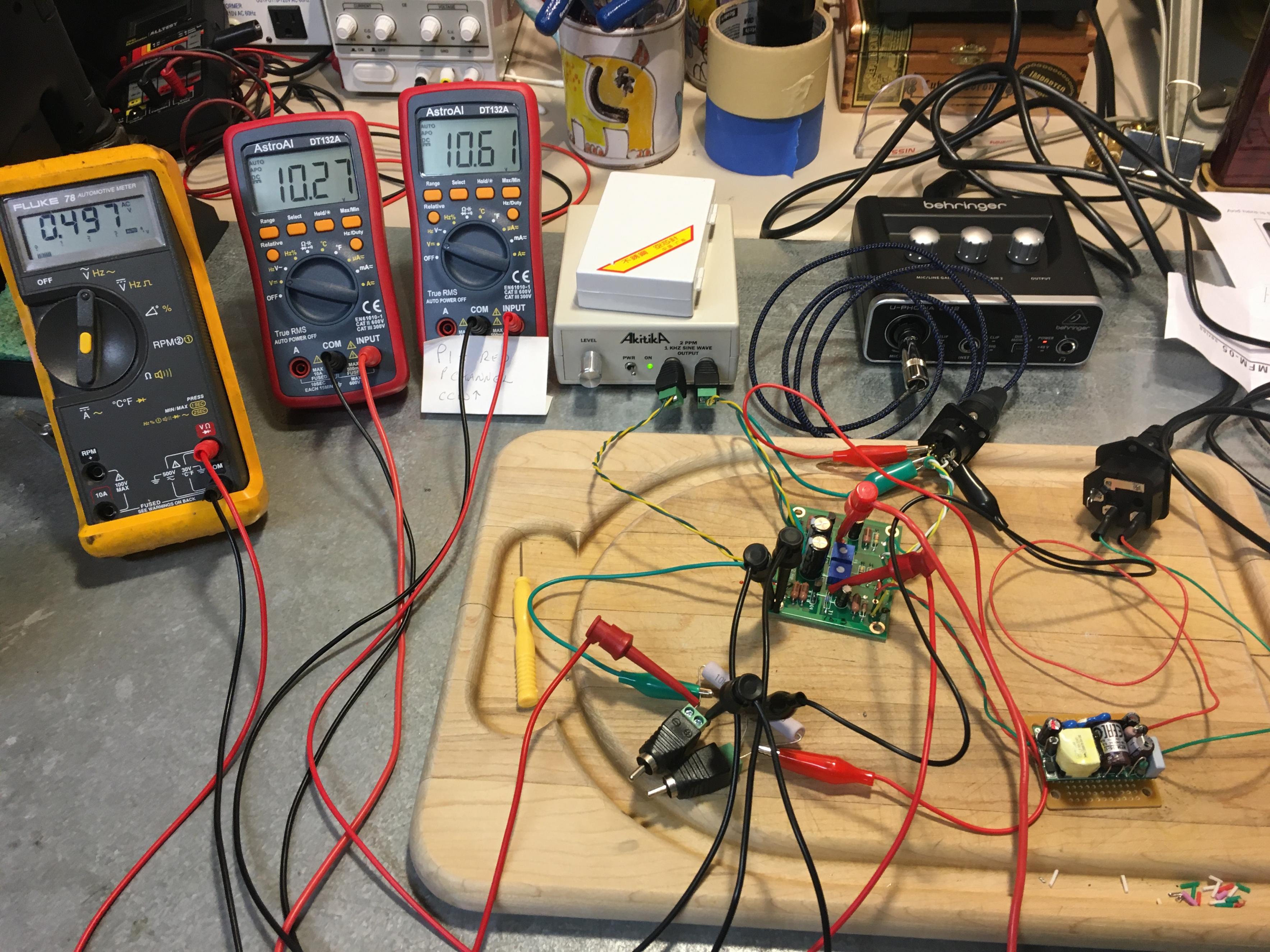

Here is the Right channel, wired the same as the left channel.
T2 values (0.5 VAC output into a 10K ohm load):
Right + = 10.61 VDC
Right - = 10.27 VDC
This channel I was able to reduce H3 to 0.28% with 1% H2.
The "left" kit JFETs bag was marked 10.3 & the "right" kit was marked 10.5. I wrote this number on each PCB with a Sharpie.
