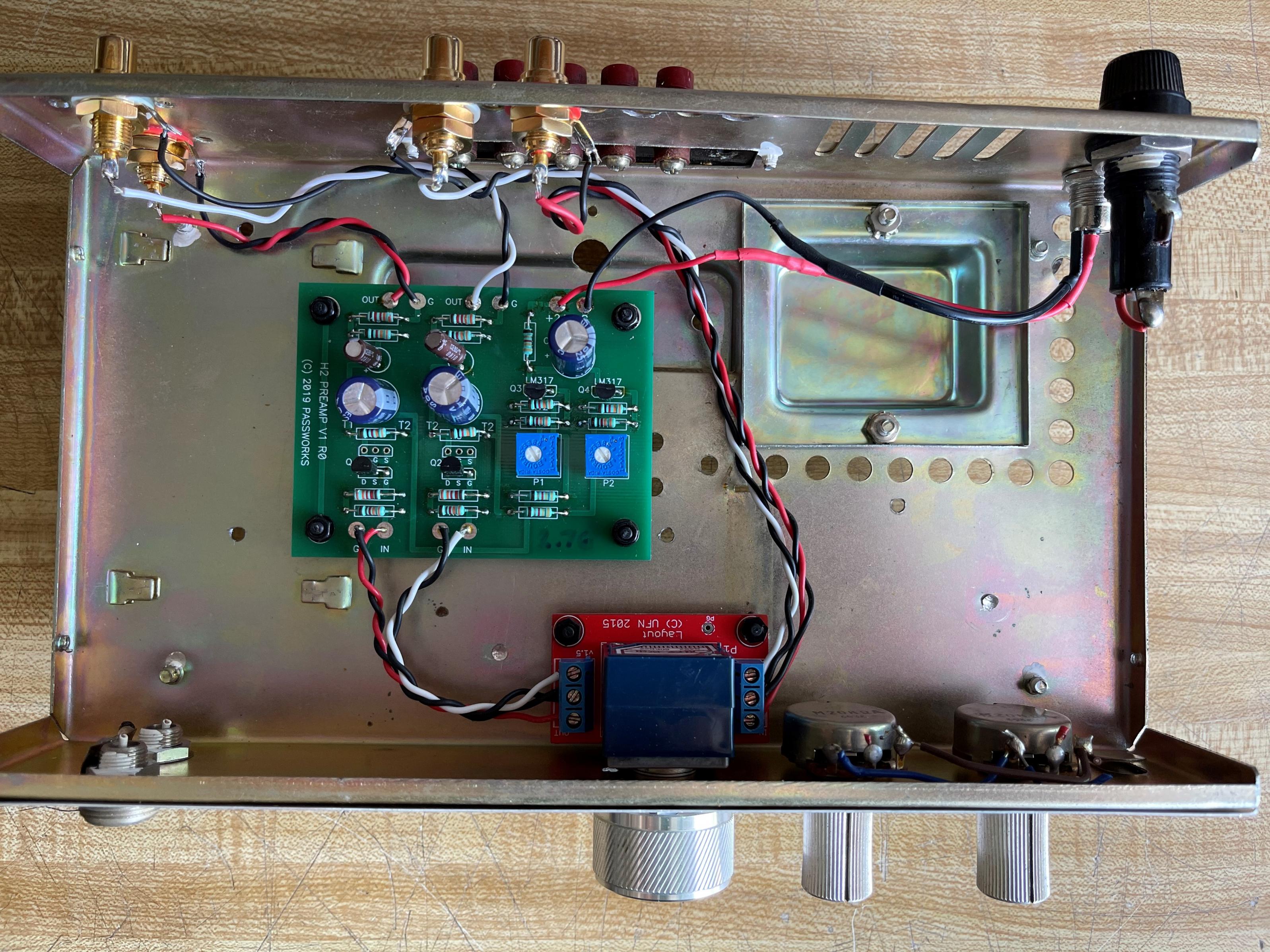

Here's a photo of the previous H2 that I am using as a preamp. Briefly-
RCA L/R in to Alps Pot.
Alps out to H2 IN.
H2 OUT to RCA L/R OUT
I used a small PCB to make my connections to the Alps pot. You can now buy those from the store.
The chassis is an old PA amp that I repurposed.

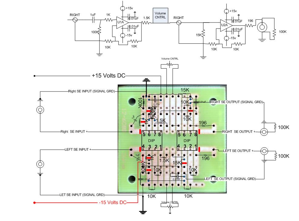

The build guide to the B1 Korg Preamp is a great guide on hooking up the pot, input switch, etc., and would adapt directly to the H2.
This picture from the B1 with Korg Nutube build guide answers the other question I had; What happens to the open end of the pot? It stays unconnected.
Thanks, I missed that. Wish I could see it in a circuit diagram. That board is obviously double sided.See step #30
Edit: I now see there is a circuit diagram. One has to click on the other pictures to view them.
Not sure this is the correct one, but I'll figure it out later.

Adding a volume control (pot)to this circuit
This is the normal way to connect a volume control potentiometer.

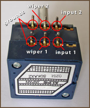

I thought this picture was pretty straightforward Skylar88. It obviously simplifies if one removes one set of inputs and the toggle switch. I always have to keep this picture in front of me when wiring up an ALPS pot but the other brands should be the same.

I got it from this forum: Wiring up an ALPS RK27 50K Potentiometer

Skylar88: just remember the “ground” on the pot goes to the return (-) signal on the incoming RCA connections and not to the earth or chassis grounding (prevents any potential ground loops).

Thanks Pete, that helps. I didn't know that the "other" pins should go to ground. It makes sense now.
