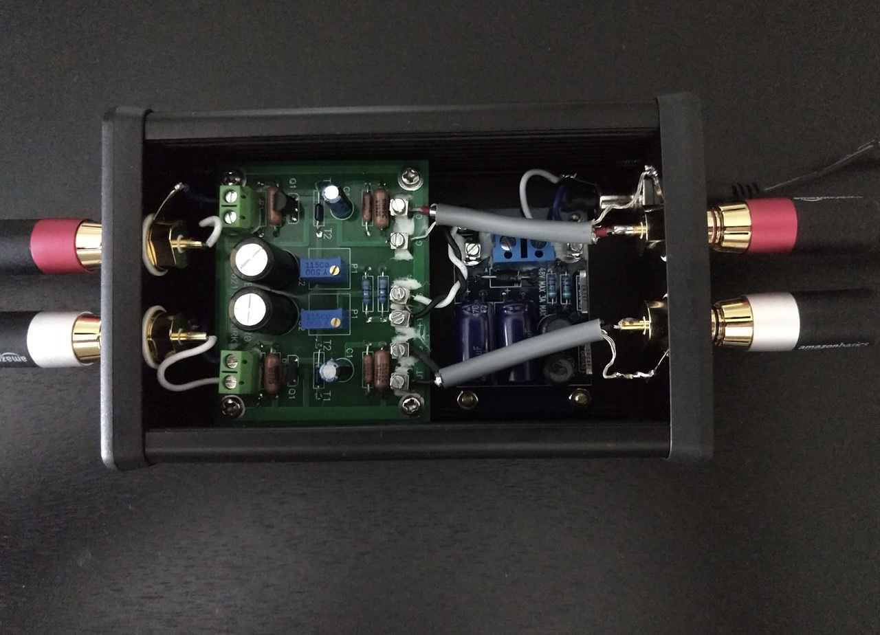

The H2V2 in its case
Finally got the H2V2 in it’s Hammond case (1455K1201BK) along with M.J.’s PO89ZB wall wart filter. Running it with Nelson’s B1 preamp/buffer for now. Very nice soundstage but have to do more comparisons with & w/o. A nuisance a keep flipping the speaker leads…LOL…gotta build a lead flipping box of some sort.

Looks good Pete!
I've been enjoying mine with a GlassWare FrontPanel stepped attenuator and thinking that's a good match, so will likely buy a case to fit. I'll have to try it with my B1 and maybe just case it up as an add-on as you have done so that I can move it around to various preamps.

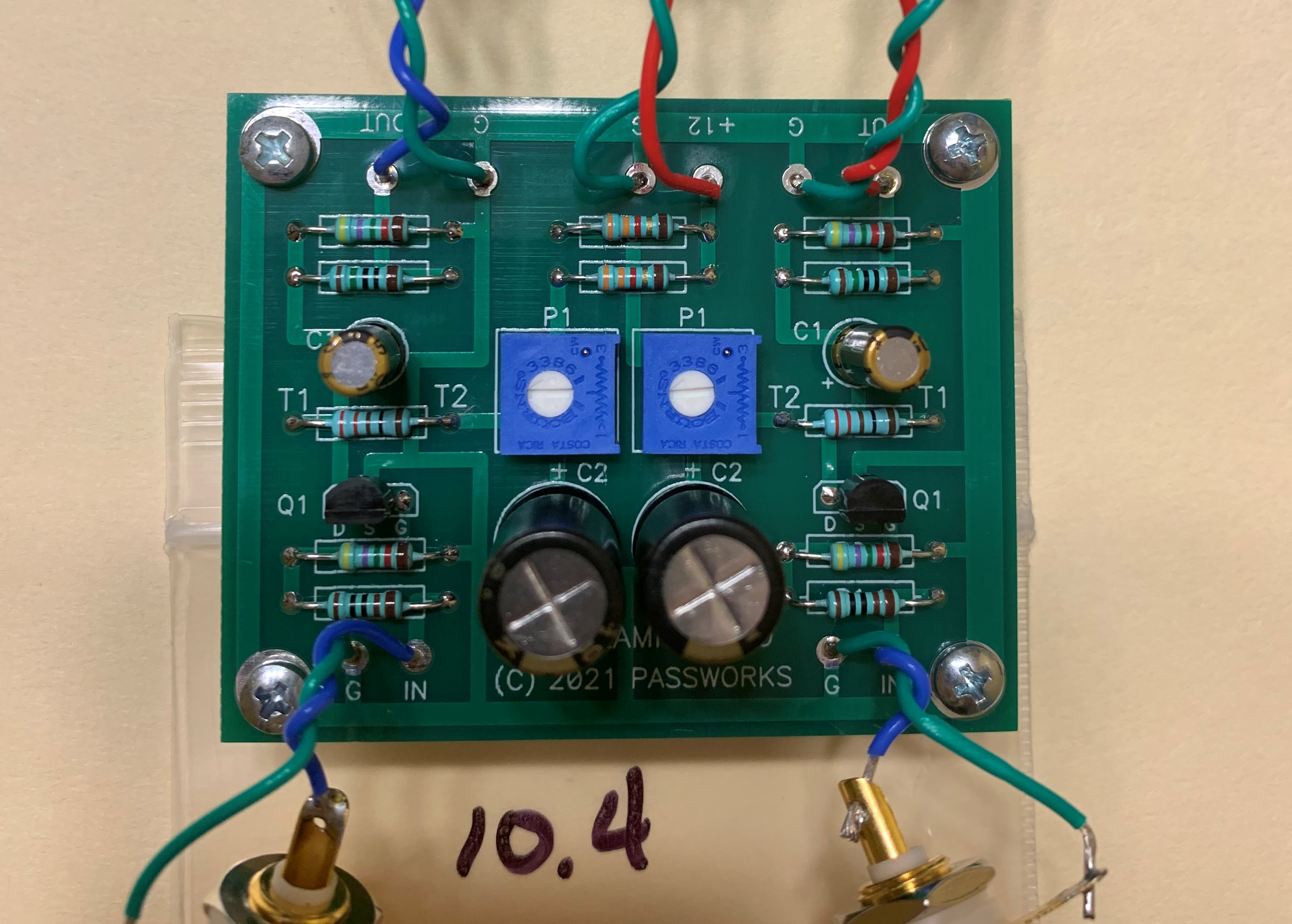

While I wait for my H2 parts to arrive, I ordered some cheap toys from Aliexpress. The idea behind this is to be able to change the voltage on the jfet repeatedly without opening the case.
A 100R multiturn pot to replace P1 and R6 and a digital voltmeters to check the voltage. No idea if it will work, but worth trying
Hopefully the meters are accurate.
I like my Hammond case since the top slides out so I can just leave it open until I’m happy with the voltage setting vs H2 level.

I'm new to all of this (received my kit, will hopefully find the time to build it soon), how do you measure the distortion?I don't have a B1K to compare it to, but mine sounds absolutely wonderful. The soundstage has opened up completely with excellent imaging.
Have you experimented with slightly lower voltage at T2 for more than 1% distortion? My H2 V1 sounds best with 1.5% distortion.
I don’t have a distortion meter so I’m gonna have to do it by ear. A 1.5% setting is obviously gonna be a guess on my part.
The B1K adds the warmth of of kinda-tube. Not having a real "valve" preamp I don’t have a basis for comparison but the H2V2 definitely is an easy & positive addition…and I do have the speaker leads switched FYI.
